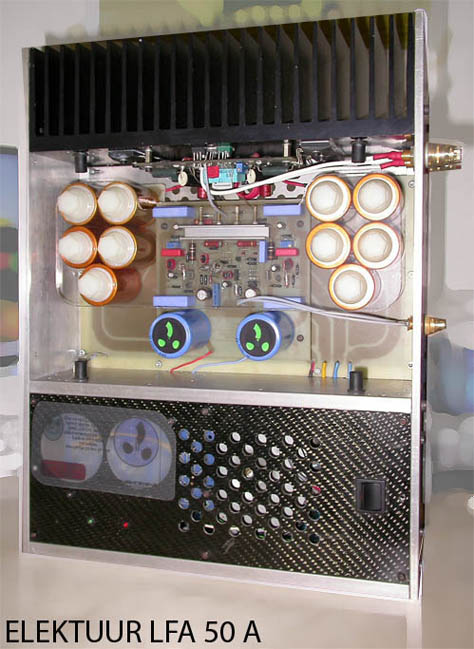

A few years ago I fully redid the layoutdesign for my elektuur lfa50a.
the componentplacement is about the same but there is more room voor biggercaps and foil c's. I also made a large board for the big powercaps. As you can see on the attachment. So there are almost no wires anymore. I think that looks very cool. And the best thing is its sounds really great too.
I have an 2sk389 as inputdifamp because 2sk146v was not avaliable anymore. And no inputcap. Because my preamp has outputcaps. But I can always put room for one on the layout if you want one.
Let me know, Roy
To me the lfa50a is a great amplifier

Looks great! I have the LFA50-OA as well, but in the original configuration. Great sounding amp!

I have it for 15 years now but never had a thoughd about replacing it. A friend of mine Who has worked for an highendstore who has had a lot of amplifiers in his system had them on loan for a while said that overal the lfa50a was the best amp for his system.
Its a real great amp.
Thanks roy

The parts are not that hard to find, there's still someone active overhere who offers a replacement for some of the CRD's you need.
Major issue with the design is the heatsinking for power levels above 50W, my strong advice is to use fan operated high performance heatsinks.
A big help is the availability of Kerafol insulating foil, 7.5'' x 7.5'' sheets can be ordered from Conrad. (one of EUVL's great pointers)
I originally used thin aluminum oxyde TO247 insulators, adapted to size to fit under the big Sanken cases.
The Kerafol sheets are easy to slice into MT200 case sizes with an office paper cutter, saves quite a few temperature points compared to Mica, any other insulator sheet make is not to my liking.
