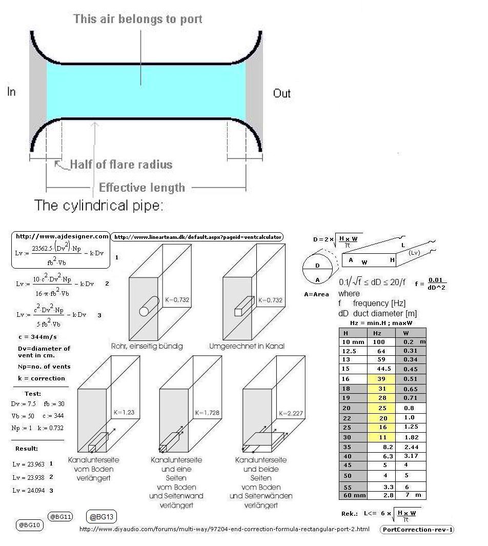

I need to calculate the area of a rectangular aperture (or Vb needed for a given Fb and port area) for an old style Bass Reflex box.
The port will not be ducted nor will it be close to any wall of the cabinet, i.e. just below the woofer. Consider a 10-by-4-inch square opening under a 12-inch woofer, for example.
Now I'm sure there is some final correction and the virtual length will be more than just the wall thickness (air viscosity and other factors).
So what would be an estimate to add to the wall thickness?

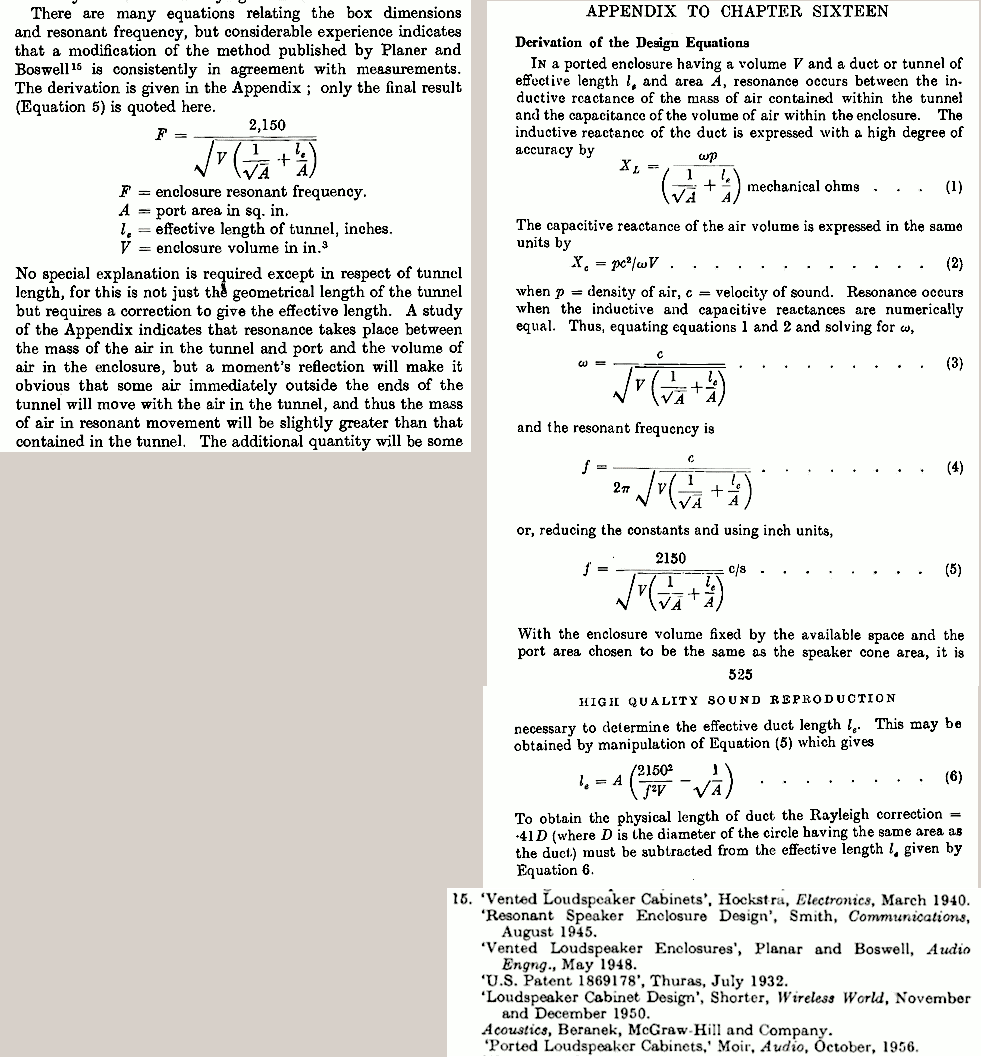

@Mosquito
I have found a note I made many moons ago relating to traditional reflex tuning using a tube or rectangular tunnel.
This time a length correction is included.
The information is from the book "High Quality Sound Reproduction" by James Moir:
Le = A (2150²/f²V - 1/√A)
L = Le - 0.41D
where,
Le = effective length of tube or tunnel in inches
L = physical length of tube or tunnel in inches
D = diameter of tube or equivalent diameter of tunnel in inches
f = enclosure resonance frequency in hertz
A = area of tube or tunnel in square inches
V = enclosure volume in cubic inches
(The volume of the tube or tunnel was not to be subtracted from the volume of the enclosure to obtain the effective volume.)
I'd be interested in knowing how the result of Moir's method compares with that of Briggs.

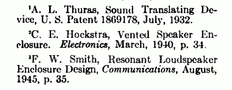

@Mosquito
At least on this side of the Atlantic, a lot of the old papers (Planer & Boswell included) funnel down through Hoekstra on the way to Thuras. For posterity, here's Moir's derivation and citations...and Planer & Boswell's while I'm at it.
