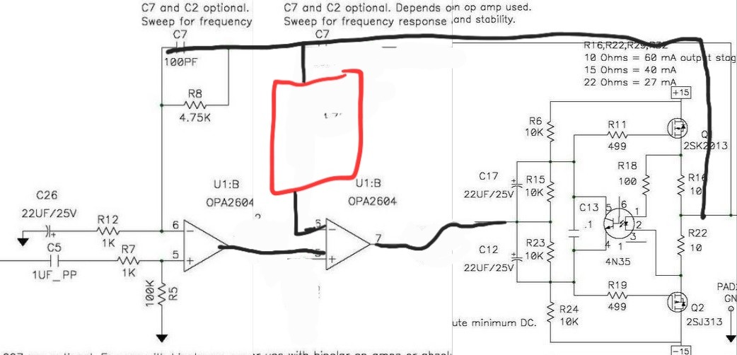

In the red block would be the omicron feedback network- the 3 caps and 3 resistors
I never tried it in hardware but a quick simulation shows nothing untoward - but also shows no benefit vs. the simpler Omicron output stage. Wait, did I say something similar before? :cool:
Did you change Whammy's feedback network values to Omicron's? You might be able to get away with plugging Whammy's output stage into an Omicron, but you cannot just plug Omicron's second opamp with its local feedback loop into a Whammy and expect it to work. I am particularly concerned about the missing diodes around the first opamp and that 100pF capacitor. Generally speaking, the lead compensation capacitor needs to have an optimal value. Too little may not work and too much may make things worse. Have a look here for a more technical discussion. :geek:
Another point to keep in mind is that Whammy is non-inverting. Most opamps, including the OPA2604, will add common mode distortion in the non-inverting configuration, which will be an order of magnitude higher than Omicron's.
Reactions: 1 user
Ah bummer, i was hoping it to be a simple plug and play endavor. And yes, i wrapped the 2nd opamp's feedback around whammy's output.
I still would like to explore different outputs besides the nice one you have shown us for the omicron.
How about the classic diamond buffer? Or mosfet cathode follower?
And also i thought the 4 diodes for the 1st opamp was for soft clipping. Was i right in supposing so?

You may be able to plug Whammy's output stage into Omicron (or another output stage) and have it work, but it will bring you no benefit. You cannot plug the inner opamp of Omicron into Whammy, not without making changes to frequency compensation.
The four diodes have a more subtle role: they adjust the loop gain in certain cases (see the text under spoiler in post #2).

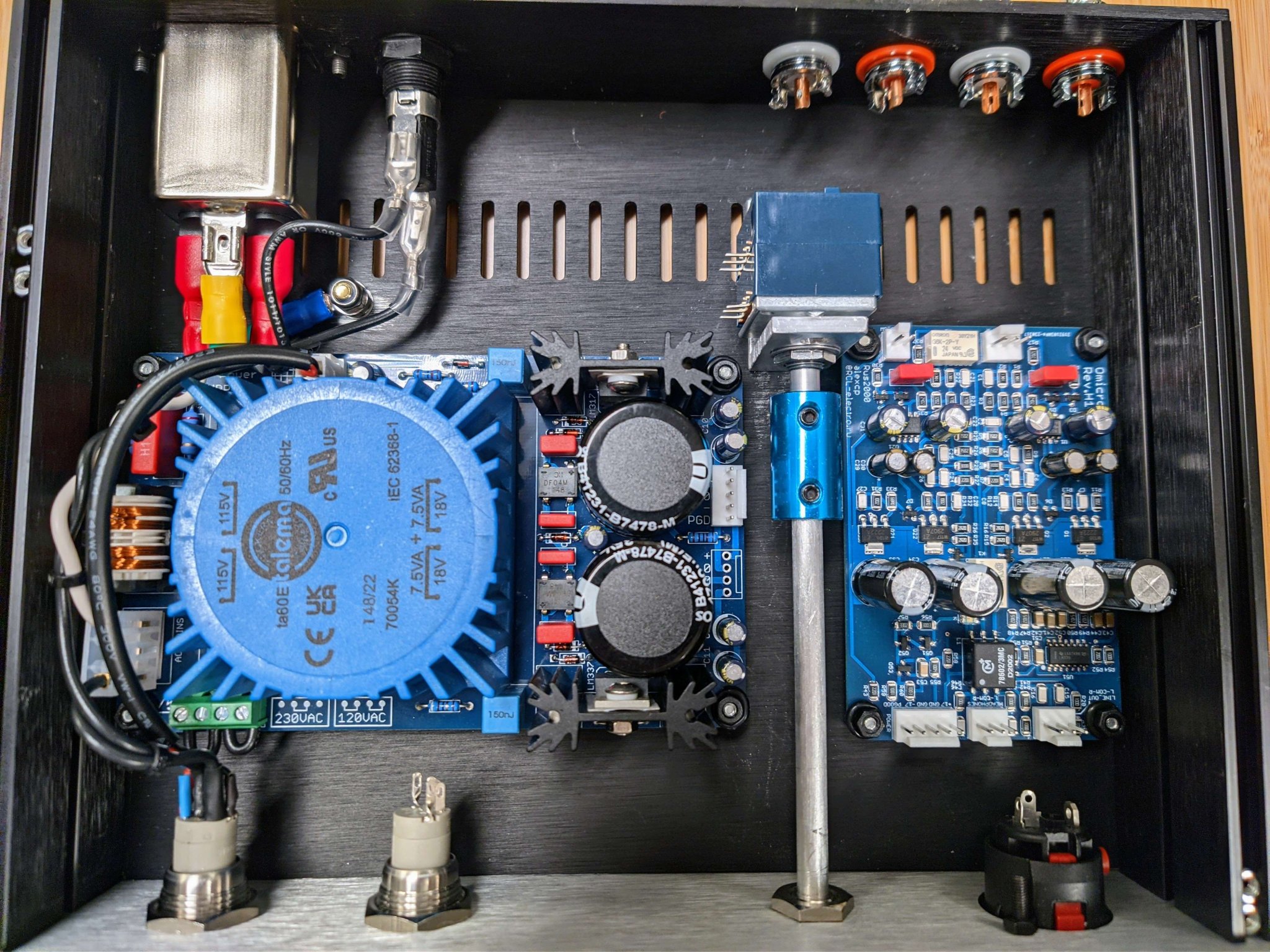

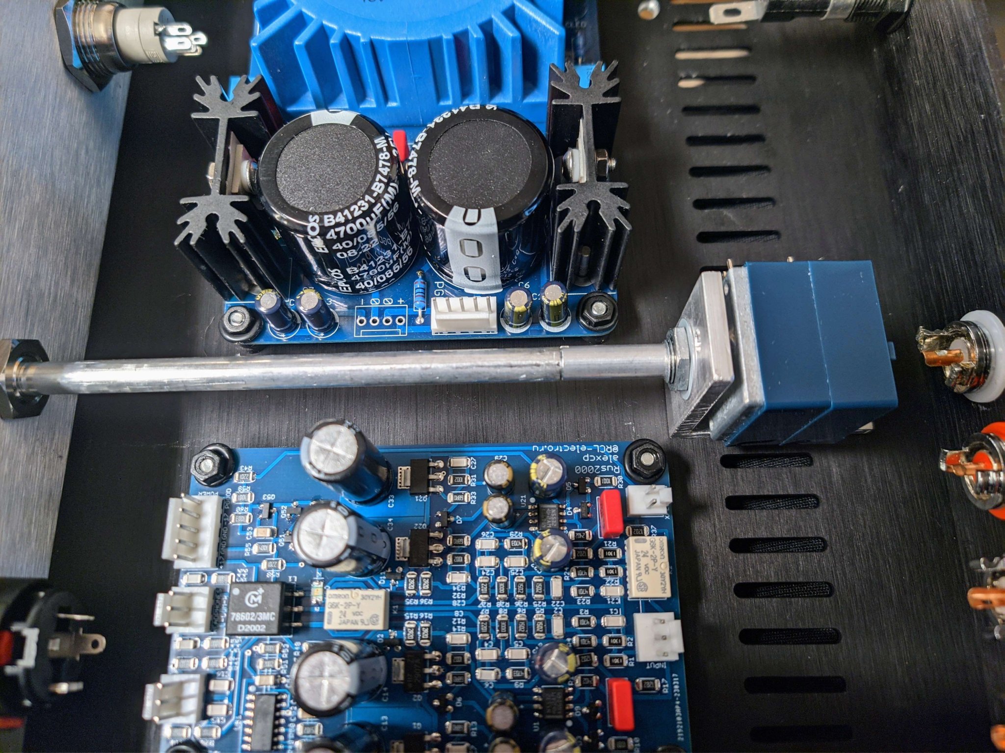

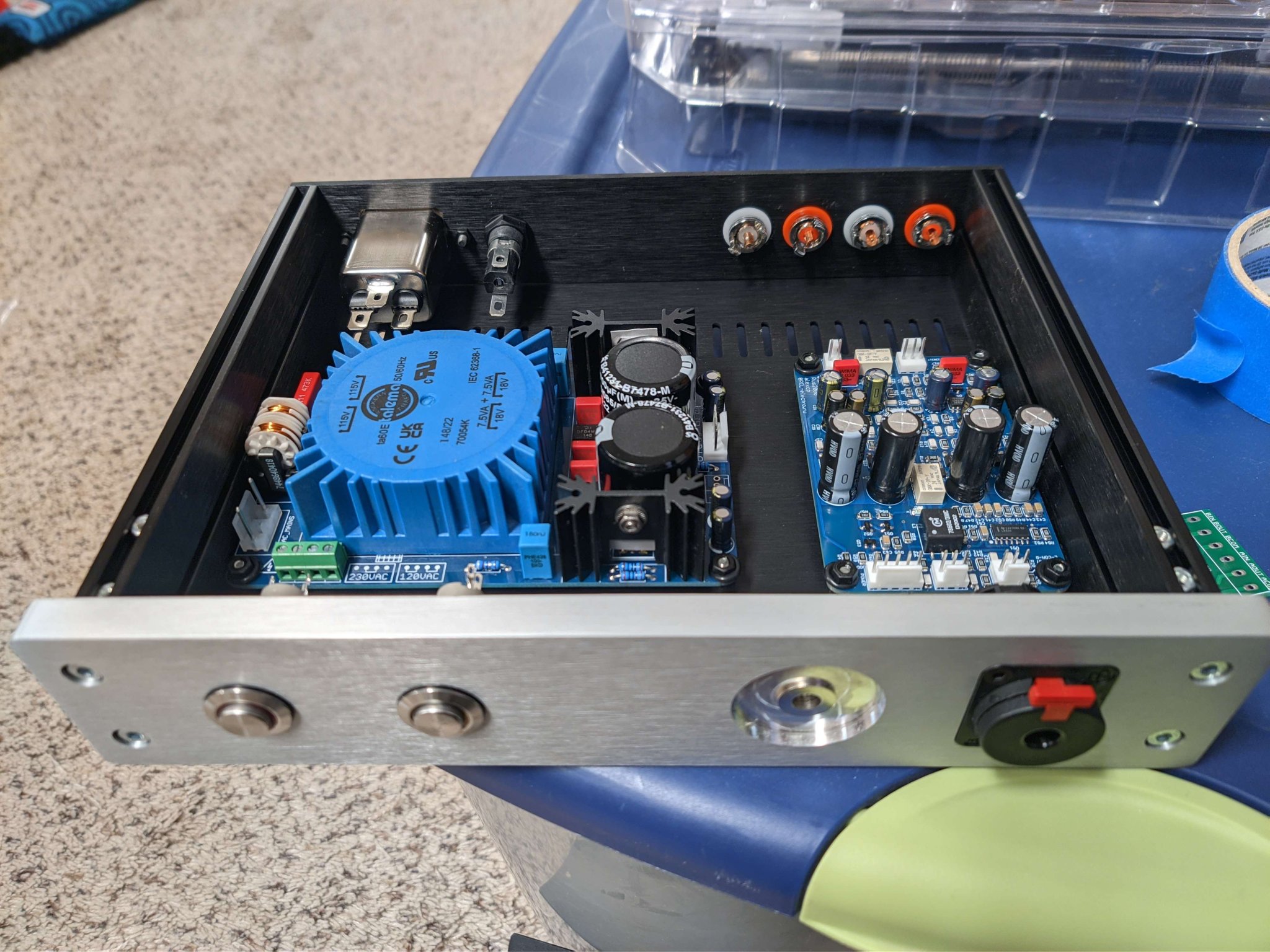

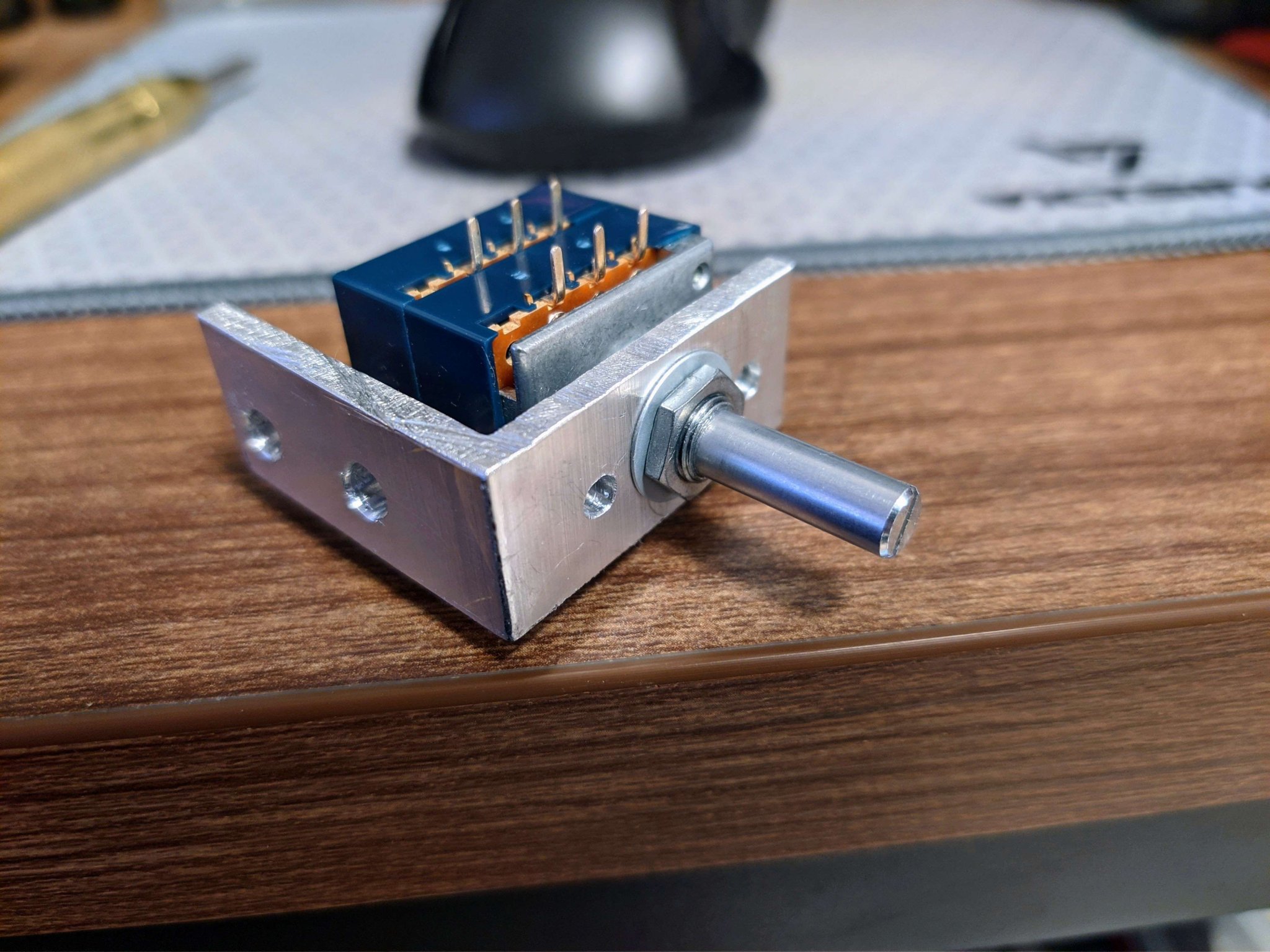

I am making progress, albeit slowly, only 2 more holes to drill for my potentiometer mounting bracket, have to sand around where the ground will connect to chassis, boards are already mounted. Then I can build a few cables and get this bad boy fired up!
I had my chassis front and rear panels machined by gianluca over at modushop, worth every penny and the time spent drawing it in CAD. The chassis chosen was the GX247, which is 230 x 170 x 40mm in size, aiming to keep it as compact as I could. I wanted to get engraving for all the buttons/connections, etc, but I just couldn't justify that extra cost, I'll probably look into transfer decals. I would be happy to share the files if anyone wanted. 16mm holes for the power/xfeed switches, 31mm inset hole for the volume knob, center hole for volume is 9mm to house a shaft bearing, and finally an inset for NJ3FP6C/NJ3FP6C-B headphone jacks. Back panel has 4x 11.10mm holes for RCA sockets, a double D hole for a Littelfuse 03450633H, and finally a 28.50 x 21.50mm IEC socket (I specifically used Schaffner FN9244R-3-06's).
I am pleased with how my shaft extension bracket lined up, I couldn't find height dimensions for some extension kits online and with my luck they would have been too tall, so I went to the hardware store for a piece of angle aluminum, and went at it with a hacksaw, hand drill, de-burring blade, and some sandpaper. I am hoping to have the first of 3 Omicrons I am building complete by Sunday!
Reactions: 7 users

Copy away! It's a 1.5" x 1.5" x 1/8" angle aluminum from Home Depot, I wanted 1/16" but it was 96" and my car isn't that big. First I cut a 15mm wide piece with a hacksaw, sanded it clean, then lined it up to the hole in the front, and used a 6mm drill bit through the hole to give it a little mark where I need to drill. It probably would have looked a little cleaner if my drill bits weren't mostly shot. I ended up going with a 9.5mm hole with a 5mm hole 10mm away (check the RK27 datasheets) to fit the notch. Making the holes on the bracket a bit bigger gave me some wiggle room.

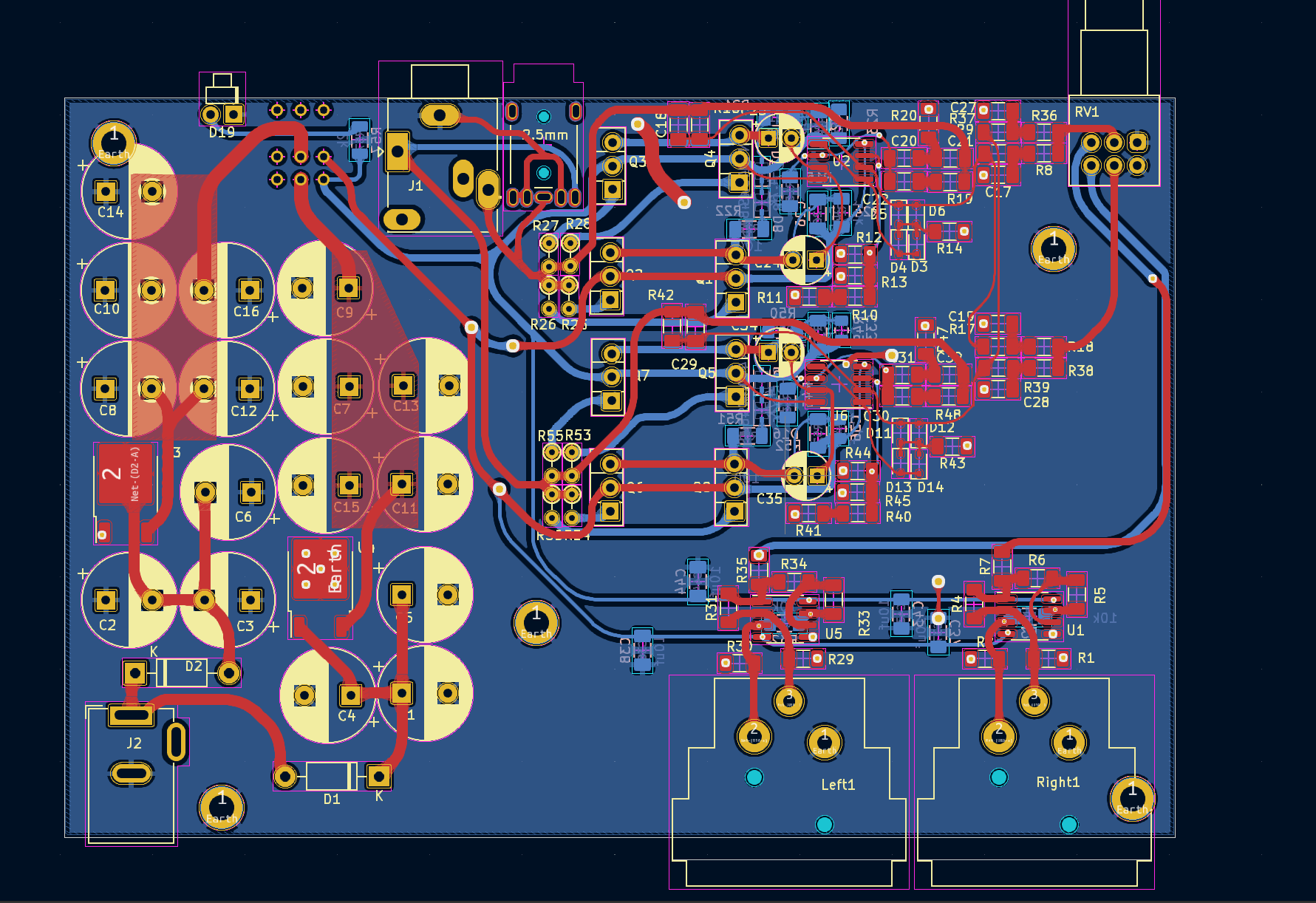

  • The routing of the PCB, in particular of the ground and feedback nets, will not allow this amplifier to achieve the performance it is capable of. This has been discussed earlier in this thread.
  • AD8620 is a fine opamp but has not been tested with Omicron frequency compensation, so there may be surprises. In that case, you can always replace it with something else that in SOIC-8 that has been proved to work. The OPA1642 would be a fine choice at less than 10% the price, and of course the NE5532 works great. Remember, Omicron is not about super impressive or expensive components - it is about outstanding performance of the amp as a whole.
  • Two pairs of BD139/BD140 per channel is excessive, esp. given that AD8620 will run from +/-12V.
  • The output filter is mandatory - I mentioned that before - but is missing on your board.
  • Balanced input receiver will distort more than the rest of the amplifier, esp. at the high end of audio range of frequencies.
Perhaps I need to offer a class on PCB routing for ultra low distortion feedback amplifiers...

.Yeah i am yet to make optimise the ground in order to reduce ground loops.
How do you suggest i trace the feedback loops? Like what changes would be a good idean
.Yeah i am actually not using the ad8620 am just using the package footprint for convenience, I would be using the opa 1642 on them
.Ok I shall def add the filter to it.
.Yeah the balanced reviewer is more convience and than improving the fidelity
