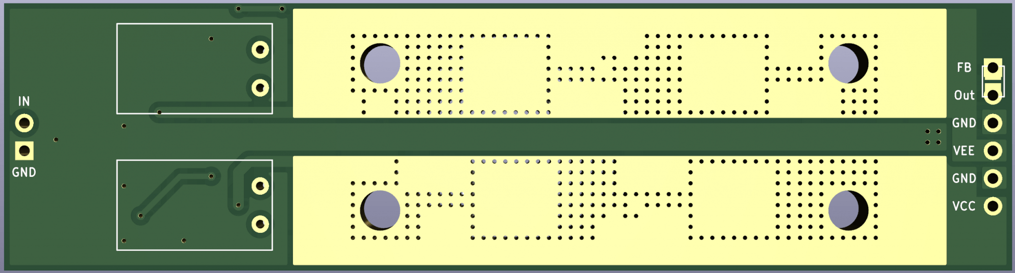

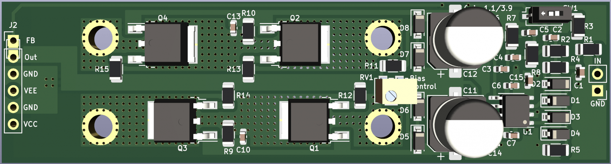

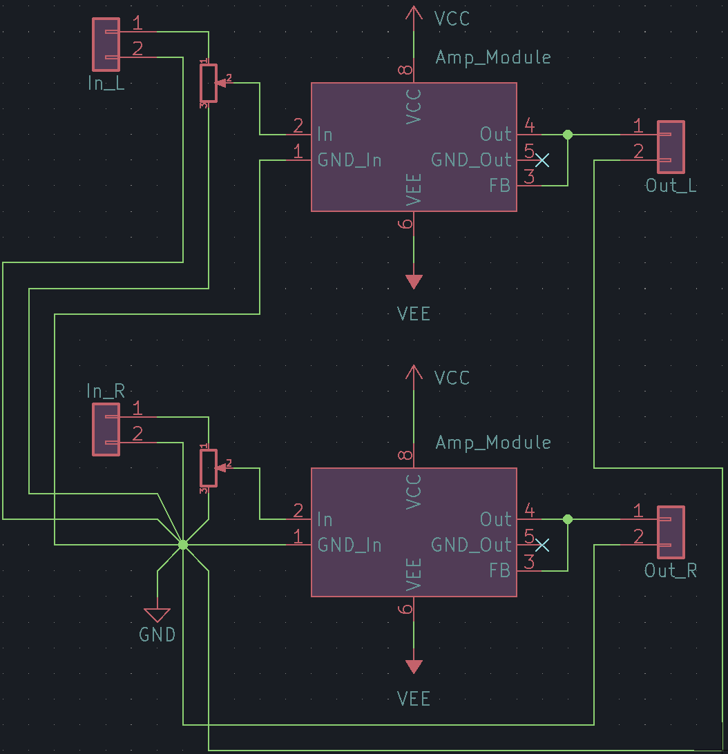

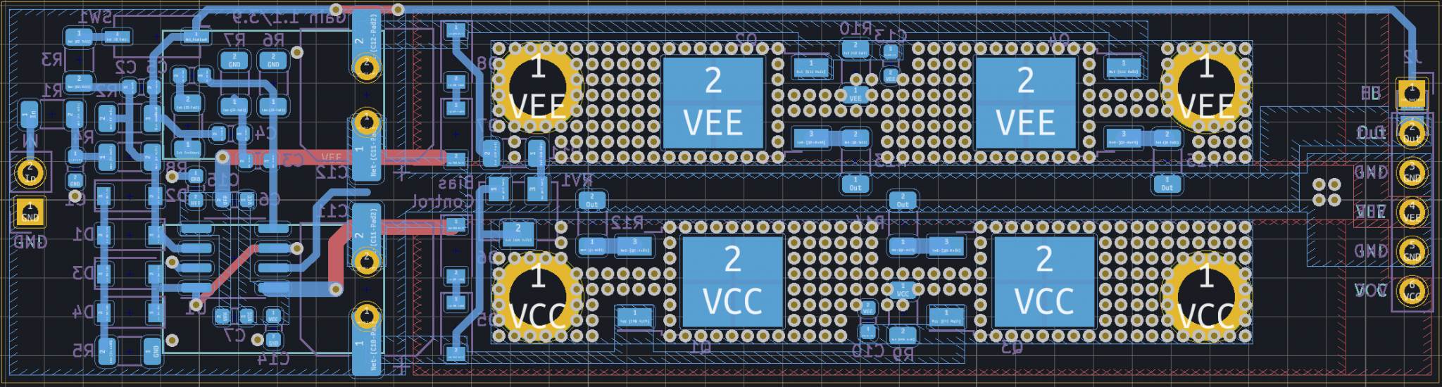

There are a few potential problems with your schematic and PCB. It will probably work, but expect performance issues.I've been working on one!

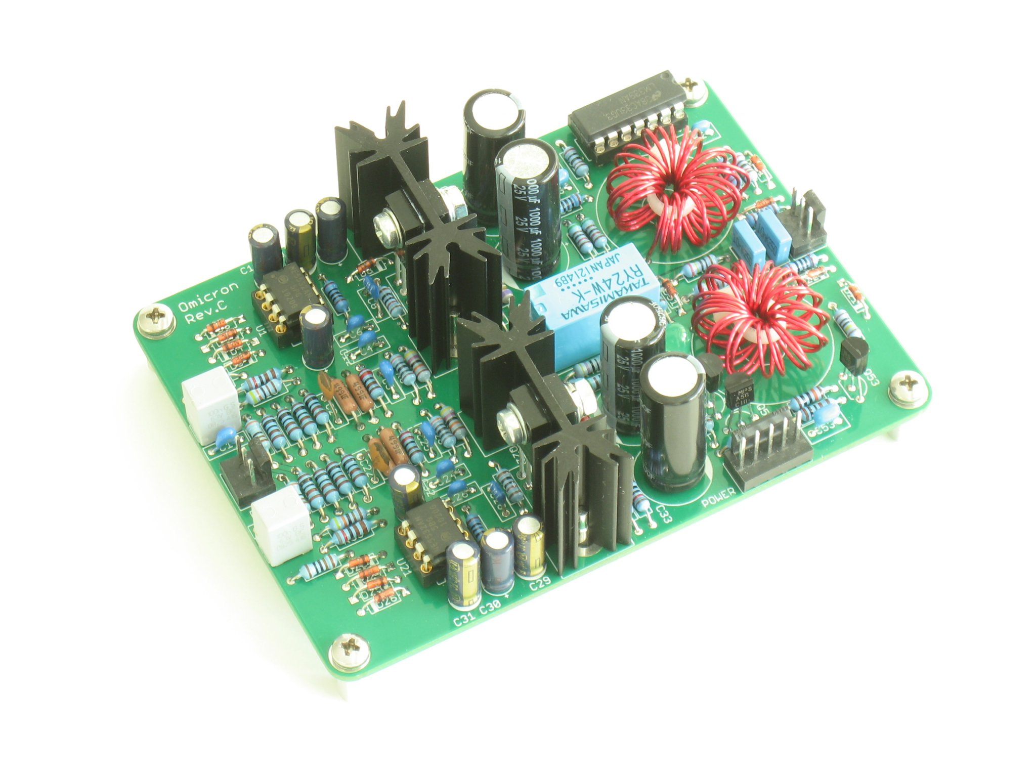

Omicron construction, as mentioned before, is a single, all-through-hole, 78x108mm PCB that holds two amplification channels plus output filters and protection.
Using one board for two channels simplifies proper grounding, which is essential - and I cannot stress this enough - for the distortion performance of any amplifier with single-ended input. It also makes it easy to use a single power supply for both channels; I believe using one power transformer per channel of even a high-performance headphone amplifier is unnecessary (and costly).

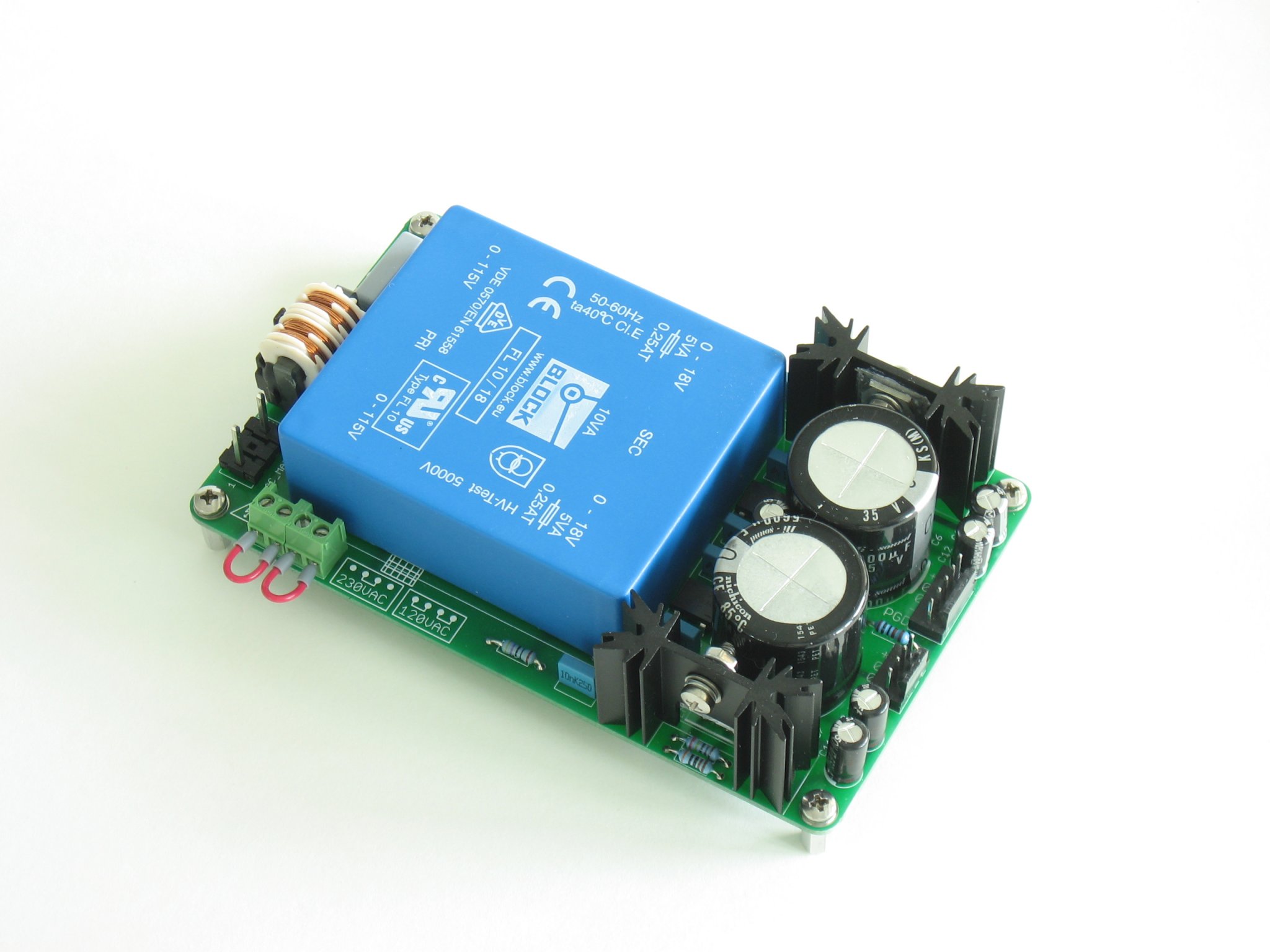

The power supply is on a separate, slightly larger (78x128mm), board:
Both boards are designed for commonly available parts, including axial 0.25W metal film resistors, radial NP0 or film capacitors (5mm lead spacing), an Omron G6A small-signal relay, Aavid 5310 board-level heatsinks, and so on. Two handmade components are theb toroidal air core inductors for the output filters - I will discuss them in a separate post. The connectors are Molex KK254 or similar, but the boards will happily accommodate 0.1" screw terminal blocks, other 0.1" connectors, or bare wire.
Most parts, including the output transistors allow, broad substitution. One that I do not recommend replacing is the 5532 opamp. In testing, it demonstrated best overall performance and is strongly recommended. Having said that, other opamps with GBW of 8 to 16 MHz (e.g. OPA2134) may work, but one needs to check for stability and clean clipping. Even the TL072 works well. although its lower gain shows in the slightly higher distortion:
Faster opamps (e.g. the 55MHz LM4562) require changes in the frequency compensation and are not recommended.

Other than the grounding issue (which can be fixed with good technique), what issues are there?That one is no so insightful. Only H2 is in-band - that is, withing the audio range of frequencies. H3 and above are out-of-band, where the loop gain, by design, rapidly falls with frequency. Because of that, THD 10k doesn't give you a meaningful picture beyond H2.
First, the input and output filters are not optional. You said you'd place the output filter someplace else, which is fine, but the input LPF is nowhere to be found.Other than the grounding issue (which can be fixed with good technique), what issues are there?

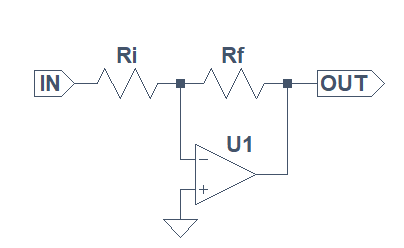

Second, the grounding issue is not going to be so simple to fix. In simulation, an inverting amplifier is quite simple:
What sometimes is not appreciated - and what I think your PCB does not quite take into account - is that both IN and OUT have the non-inverting input of the opamp as the reference.
Any voltage is measured between two points. Frequently, one of these points is the "ground". In simulation, the "global node 0", marked with the "GND" symbol, is always the same "ground". On a real PCB this is never the case - there is no single "ground". Each and every signal has its own reference.
As a suggestion, before sending the PCB to production, try building one channel on a breadboard - it has a relatively low NFB crossover frequency and no high-impedance nodes, so it will work fine - and getting low distortion numbers. I am sure there will be some frustration and a a few surprises.

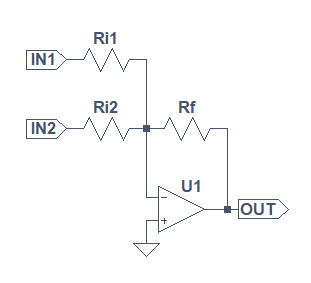

What is happening is an implementation of crossfeed as a textbook "inverting adder":I do not understand what is happening
with a slight twist that both inputs are first low pass filtered - one with a high corner frequency, the other, with low. See post #33 for additional details.
Have a look at how the inverting adder (aka the summing amplifier) works. There are many sources online; this one seems to be brief and to the point.why would you mix the input of one channel with output (feedback) from the other channel?
It seems that the output of one channel is fed back to the input of the other channel...

Sorry, that's not what is happening in a crossfeed. Please have a look at how the inverting adder (aka the summing amplifier) works.mixing the output of one channel - with the input of the other channel.

I will!try building one channel on a breadboard
That's because it doesn't, just provides the pins to wire to. The ground pins at the output are just to separate the out pin from the voltage rails. The idea is to tie all the grounds together at a single point somewhere, and have them separated the rest of the way throughout the amp. Essentially, a star ground topology (greatly simplified diagram here):(snip)...I don't see how your PCB takes care of that even for one channel...(snip)...the input LPF is nowhere to be found.
Let me know if my theory is totally off though
I also had the input filter on the backplane board these modules are going on, just before the inputs, but I've added it to the board itself! I have also added a gain switch and bias control, in case I want the amp plugged into IEMs or running cooler during the summer. Adding the 1.5k in parallel sets the gain to around 1.08, close enough using standard E12 parts.

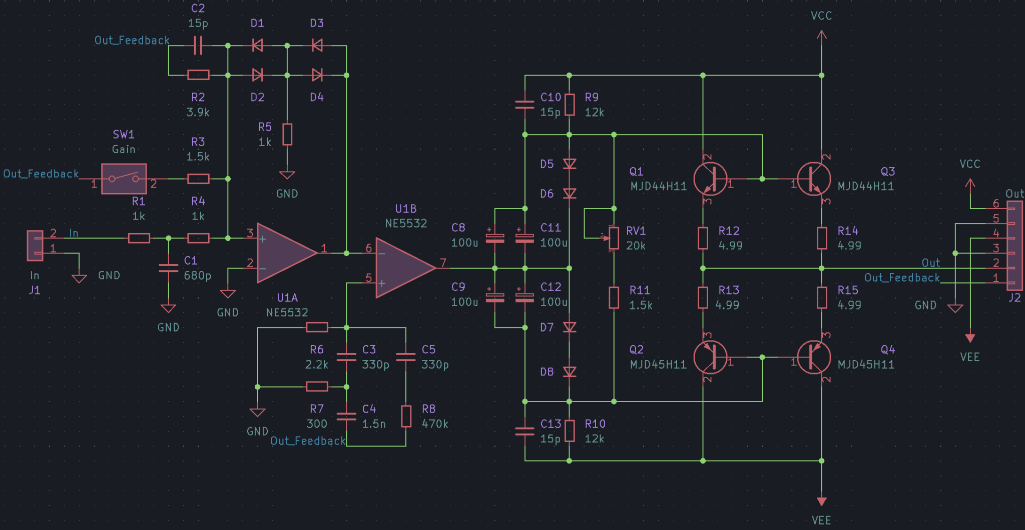

Wonderful circuit alex. I too like to have a go at my own layout of it.

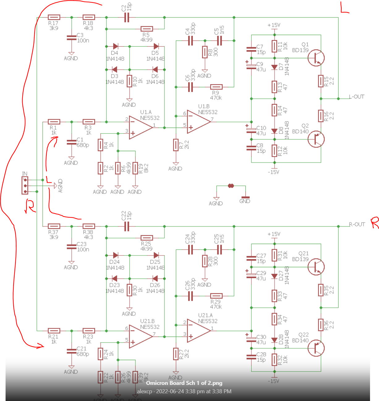

Couple questions tho- what was the purpose of R2 4 6 19? Why multiple parallels?

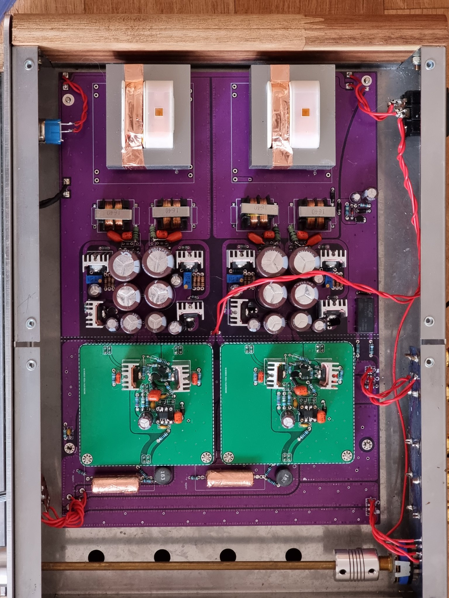

Pic is my dual mono headphone amp. Its modular and the module pinout allows for a textbook perfect opamp layout. The best output stage ive made for it so far has been the composite with diamond buffer (green boards). I feel that your circuit will perform even better. 👍

I'd imagine you only populate some of them to adjust gain based on your preferencesthe purpose of R2 4 6 19? Why multiple parallels?
The problem with grounding is in the PCB artwork and is not fixable by external connections. Oh, and I just noticed your opamp is connected incorrectly.Let me know if my theory is totally off though
The purpose is to balance the impedances at the inverting and non-inverting inputs.what was the purpose of R2 4 6 19? Why multiple parallels?

Pretty looking boards. How is measured performance?textbook perfect opamp layout

Thank you for the complement. I plan on taking it to a professional to have it measured. After that, will make a thread about the design.
Subjectively its as good as any commercial designs (sub $10k stuff) that its been compared against. The treble is particularly smooth/inoffensive whichs always a good sign.
Ah, its exact mirror of the inverting input resistors! Very clever!

Before the quality of the PCB pattern, it seems that the inverting input and non-inverting input of OP-AMP are reversed in both the circuit diagram and the board.I also had the input filter on the backplane board these modules are going on, just before the inputs, but I've added it to the board itself! I have also added a gain switch and bias control, in case I want the amp plugged into IEMs or running cooler during the summer. Adding the 1.5k in parallel sets the gain to around 1.08, close enough using standard E12 parts.

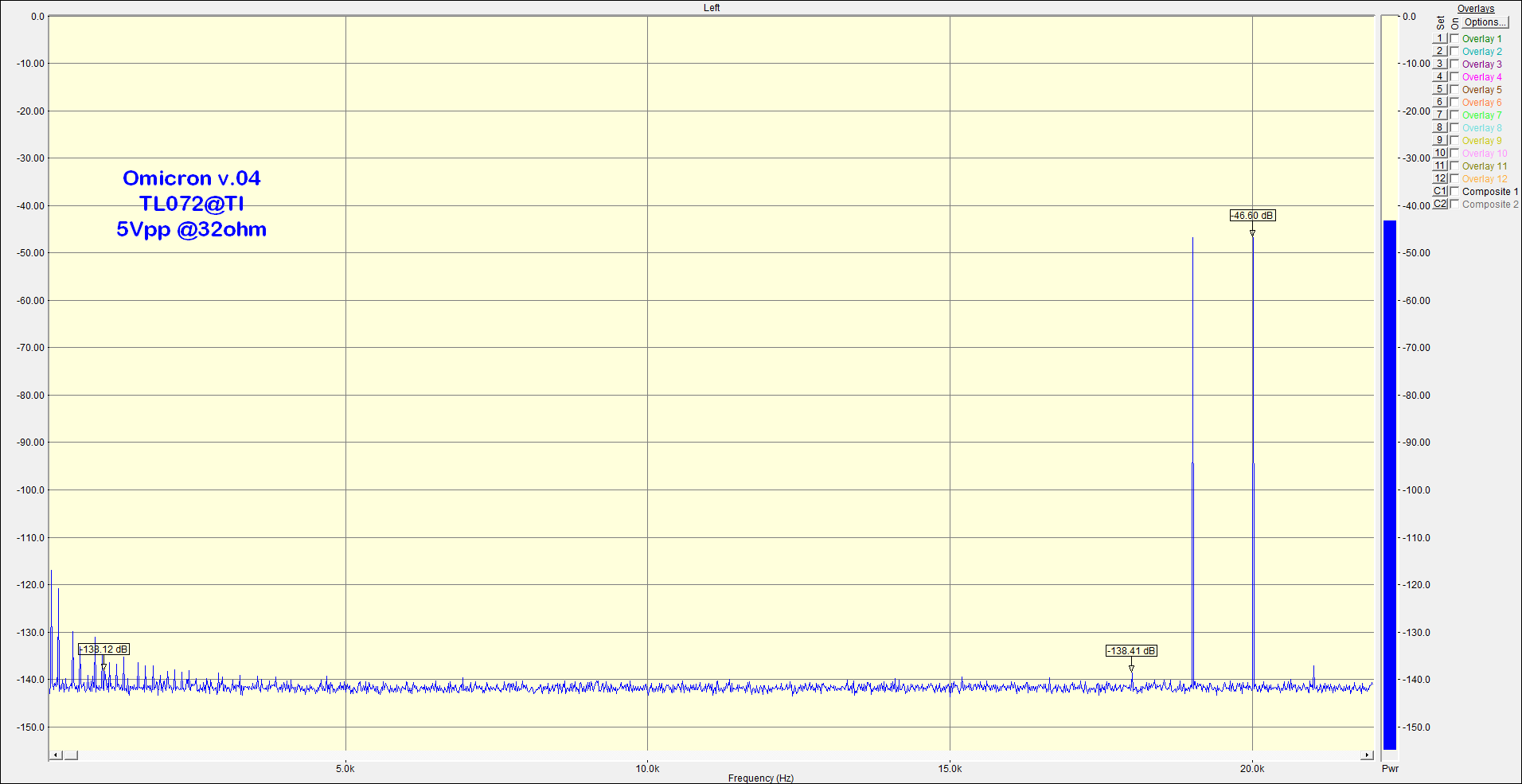

- Omicron, a compact headphone amp with -140dB distortion
