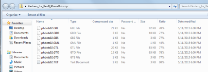

I have found that the Gerber file naming convention (within a Gerber .zip archive) stated by seeed studio with three e's , works at every single PCB fab in China that accepts online orders. Every one. And this has been true since 2014 or sooner.
Take a look at the seeed documentation (link), screen captured below. Also take a look at the contents of the example Gerber .zip archive attached to post #1. Same file extensions. Also take a look at the file creation dates of the .zip archive contents. Eight years old and still works fine at every online fab in China.

I have never played with trying all drill format files to see if they mess it up. Just use 274X and they will figure it out. No embedded drill stuff, separate combined drill file. They can figure it out if its inch or metric. and size format. Slot info goes in the drill schedule in the gko file and a fab drawing showing the slots, v-cuts etc.

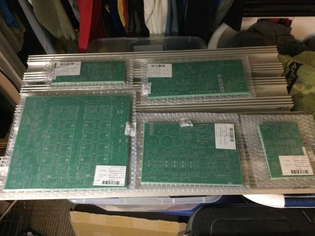

$100 haul from JLC. Five of each design, the largest will get reordered at some point (need>5). Shipping was another $70, but I only ordered this a week ago and it’s already here. Sunstone wouldn’t have been much faster, but more than add a zero to the price.
Their online tool seems to interpret gerbers from my ancient PCB software just fine. Dont even have to tell it where the decimal point is - it figures it out. And they do take the ONE card, which all online shopping will be moved over to after the 1st of the year (even a Mouser and PE). Ordering production run for the 5k-watter probably after the holidays. It’s a 5 board set - motherboard/daugherboard for each channel plus a power supervisor. Several units of course. That alone would be a $1600 worth made in the states.
