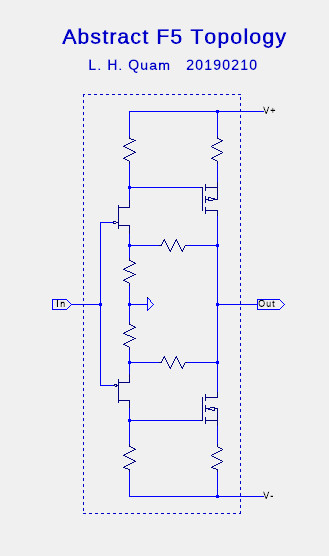

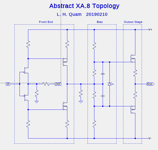

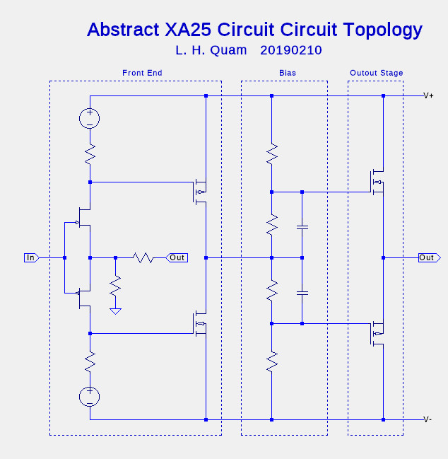

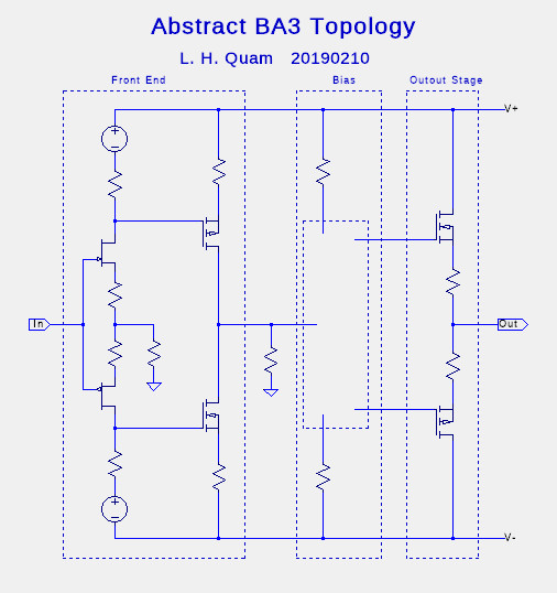

This is probably a better representation of the essential elements of the actual circuit. I believe that it addresses the elements that define the open-loop gain.
Thank you so much for providing these abstract topologies. They make it easy to spot things not easily understood; at least by me. For example, I am making it my business to figure out why the bias resisters connect to the for XA connect to the VAS out rather than to ground. I suspect the reason is fundamental. Back to the project descriptions. Better to figure it out now than to burn the house down.
For the XA25 typology, the VAS load was removed as were the gate resistors compared to your 20190114 account. I don't understand how this "addresses the elements that define the open-loop gain." I will get there.
The gate stopper resistors were removes from the daigram since they are not essential in presenting the topology.
The open-loop gain depends on the FET transconductances and the resistors shown, except that the feedback resistor from Out is removed.
An additional drawing is in the works that explains this in more detail.

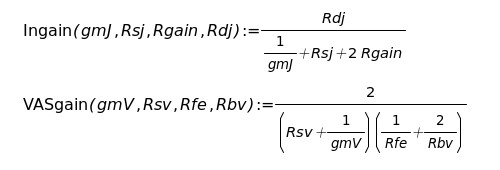

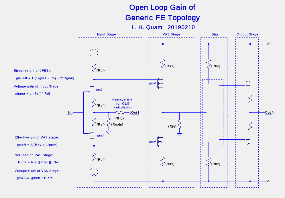

Here is a generic schematic for XA25, XA.8, ... front-end topology and the calculations for the voltage gains of the Input and VAS stages. This is simplified in that the FETs are assumed to be ideal complements, ie. have identical transconductances.
"Remove Rfb for OLG calculation?" Remove Rfb and, thus, break connection? That is, remove negative feedback from the OS output? Hence, open the loop? Rfe (load) causes the "puppy" to be tired and, thus, "happy?" Wild guesses. Thanks so much for posting this information.
