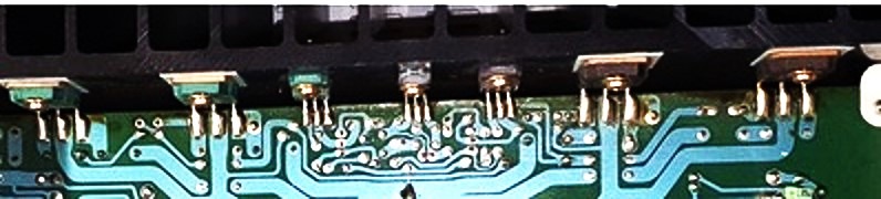

I bought Philips FA960 MKII. After reconnection transformer from 220V to 240 V, recapping, changing voltage regulators in power supply, and putting some new resistors,everything sounds nice and clean, without any noise or hiss.This amp is the first one, what is completely quiet. You don´t even know, if it is turned on or off.

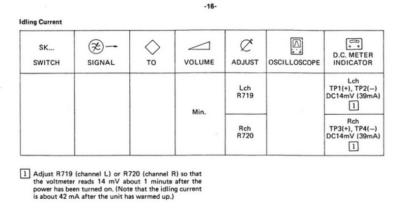

But one thing is very interesting.I measured idle current of STK 3102II (someone replaced the old one 3102 III).
Left side 2,3mV, right side 3,0mV.The manual says it should be 14mV (39mA).So I tried to put R-side very carefully to 6-7 mV while I was touching the cooler on the STK.It was getting too HOT very quickly.So I put it down immediately to 2,3mV like on the left-side. I have tried to adjust 3,6mV on both channels.STK got hotter and the sound has changed (in middle frequencies it was very nice and tight, but treble sounded much sharper....).
So now it is idling at 2,3mV. Amp is without distortion, just slightly warm and the heat sink with output transistors is nearly cold.
Maybe it is normal, that at 6mV it gets so hot, you can´t even touch the cooler of the STK.
.... But then you have to replace STK and all the caps around very often due the heat.
Could someone tell me, is so low idle current normal?
Thank you very much. Jan.

I am the designer of a clone STK3102, to be found on this site. There are zilch genuine originals still around and any substitute may now be oscillating. There are fakes out there that don't admit to being clones and some of these are very substandard, not equivalent at all.

If it is on the edge of oscillation, it might start off and blow the outputs and then the woofer
Low bias means lots of crossover distortion
Sorry I'm not David, but answer:
Temperature is not high(about 50-60 grad celc) because stk is VAS and work with small current of cascade, stk dissipation 2-3 Watt.
Why only 2 mV, this means middle current only 0.002/0.22=1 mA is very low. Normal is 50 mA on pair this not big power dissipation and normal level of distortion.

Hi David.
I have already adjusted it to 14 mV - according to the manual. This value remains after it has been on for 30 minutes.
I know it should be 14 mV after one minute, but I would like to stay safe.
The amp is just warm, but not hot. And it is working, as it should.
Jan

With small idle current you have big distortion. And small idle current not safe your STK. STK you was safe if your loudspeaker have normal impedance with minimum higher than 4 Ohm and you don't use your amplifier on big output power and if voltage in power net normal without big undervoltage and state of condencators in power supply in amplifier is good.
It’s strange, but according to the manual, the Luxman L-435 also needs to be set to a very low quiescent current of the output transistors of 24 mA per pair (emitter resistors 0.22 Ohm). Maybe that's enough. How many pairs of output transistors do you have in your Philips FA960 and which ones?
