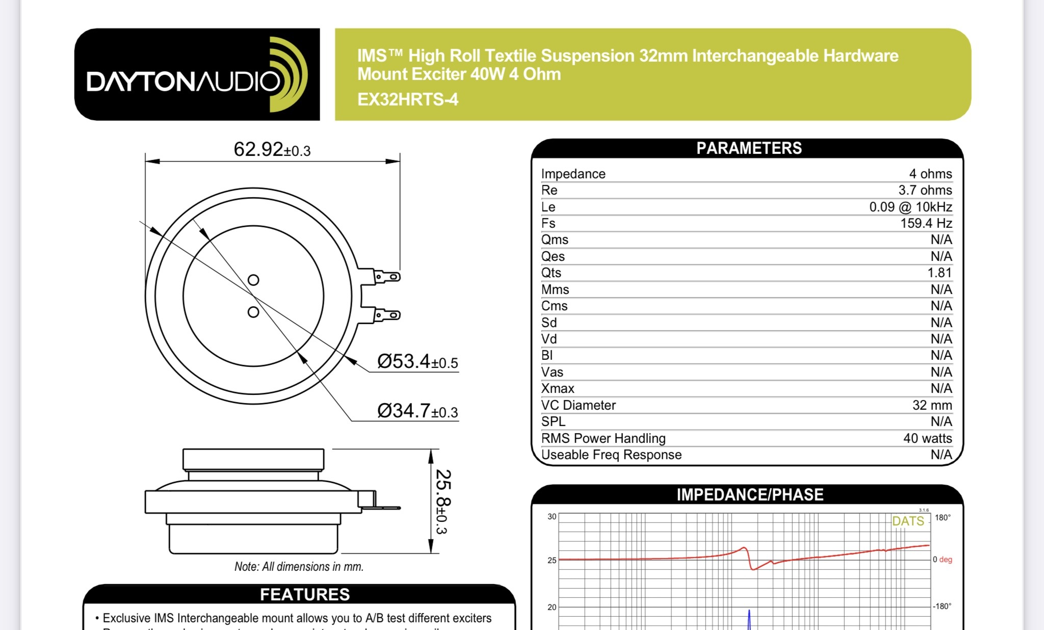

are the diamonds in the first photos there to have something more substantial to which you fasten the drivers. or ... ?

Yes. Full wood baffle and back is obviously best but a number of these were prototypes. I made them from 20” up to 48”.@Cal Weldon
These picture frame speakers work pretty fine for nearfield listening. I think they would work well for surround as well. https://www.diyaudio.com/community/threads/dml-system-1-0.395246/post-7257014
