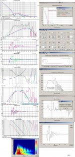

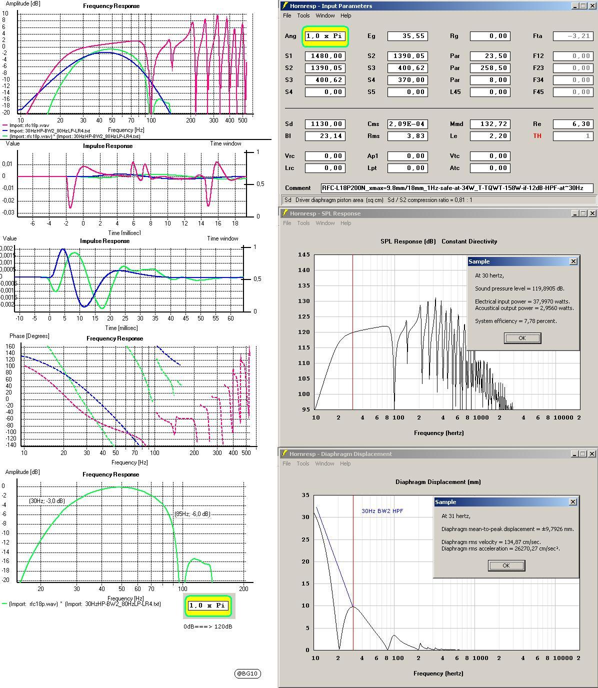

I still don't know if the requested design for the RFC driver is for Home or Live but if for home:IMO a T-TQWT would be superior(size,performance...) if XO at 80 Hz using no HPF for the lower end and pushed close to a wall and corner.
First of the pictures.
FYI, The HR data(epa's) from post# 13 exported and processed and entered into HOLMimpulse program to show impact on excursion using suitable filters (limiting distortion due to exceeding x-max at 9.8mm).
Note: This TH suggestion(epa's) is IME very suitable for to be stuffed with damping materials of the very first third of the expanding 'horn' length as the throat area is comparable to driver Sd.
No more than maximum a dB would be lost at very low frequencies and a few at the upper boundary of the BW making this design converted to a true Hi-Fi TH if suitable cross bracings are included too : Second of submitted pictures.

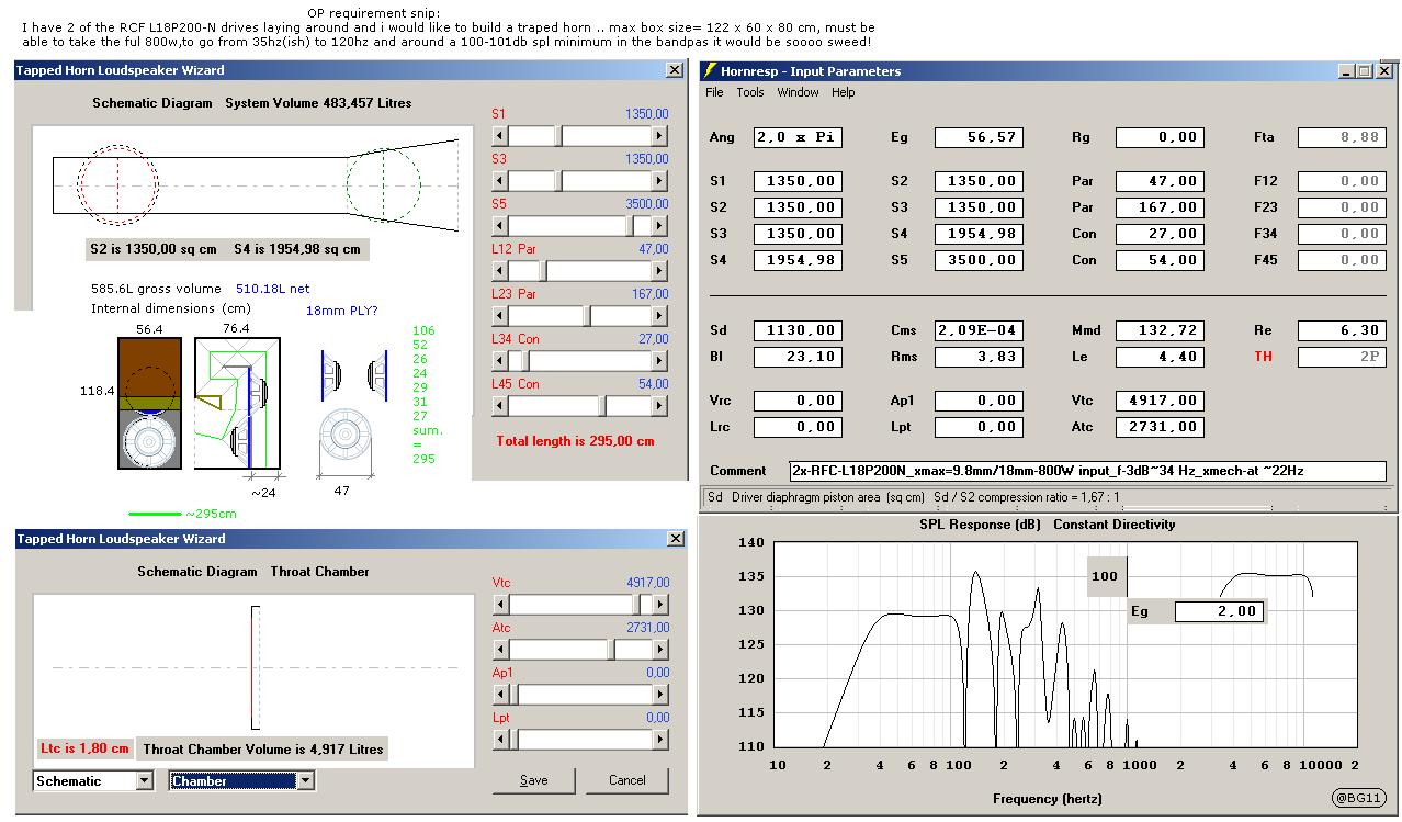

Okay guys now i have to keep up here
fist of all this is going to be a PA sub, and there for the system must be able to take the ful 800w in order to reach max db wiht a minimum of distortion.
djk: I have a DCX2494 for processing and i don't think it can make the filter type your talking about. Also i don't know what Q=1 means in filter terms, i only know of the "Q" used in the Eq setings?
epa: Is you could design a new cab for me i would be great! As im not a expert carpenter, and have only done BR cabs befor and a "simpel" build would be best (more 90degres, and fewer odd angel cuts are better, but i have to learn it some day ;p)
in terms of size, if the outer mesurments can be kept to or under: 122 x 60 x 80 cm it would be good
Hope im not to much truble
Cheers Toby

Still fishing in the DIYaudio pond with new design constraints?
Do some homework and present your own design..Here is a quick attempt again:

ive been playing with hr some more,but can't realy get it much beter.
the easyer the bild the less can go wrong.
i can adjust the height to make f3 lower or higher.
(usualy it plays ~1 or 2 hz lower than the sim)
lower = less efficient,higher = more efficient.
cab is ~60 wide 524 ltr wich is 50ltr less then your 60*80*120 sugestion.
lett me know if u wan't bild details
