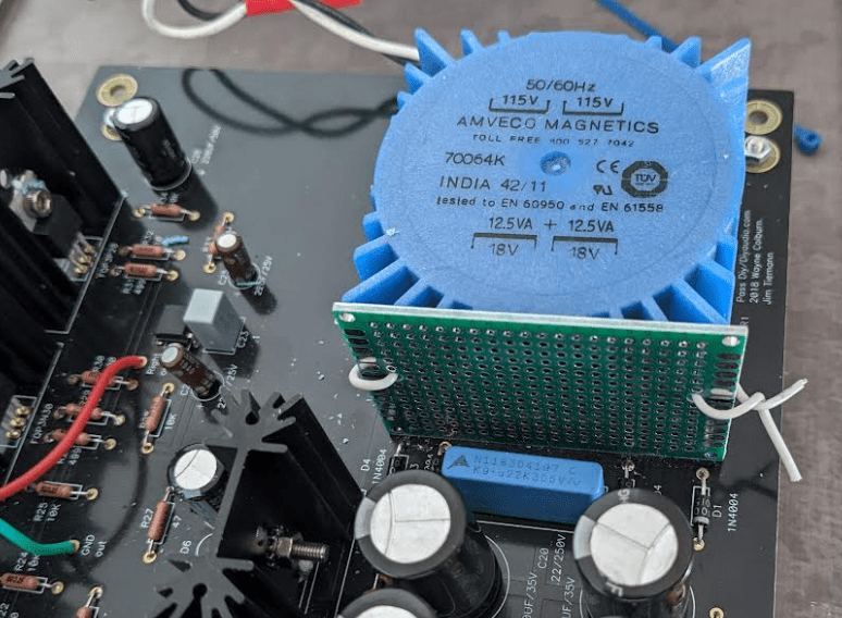

Be pleased that you have the 2x15vac version which will rectify to +-21vdc. My unit has the Amveco 70064K which outputs 2x18vac which inputs +-25vdc to the regulators. The 7815, for example, only needs about 18vdc. Higher voltage creates excessive heat in the unit.
The 3.3ohms in your unit make little difference because the big caps and the regulators manage the ripple.

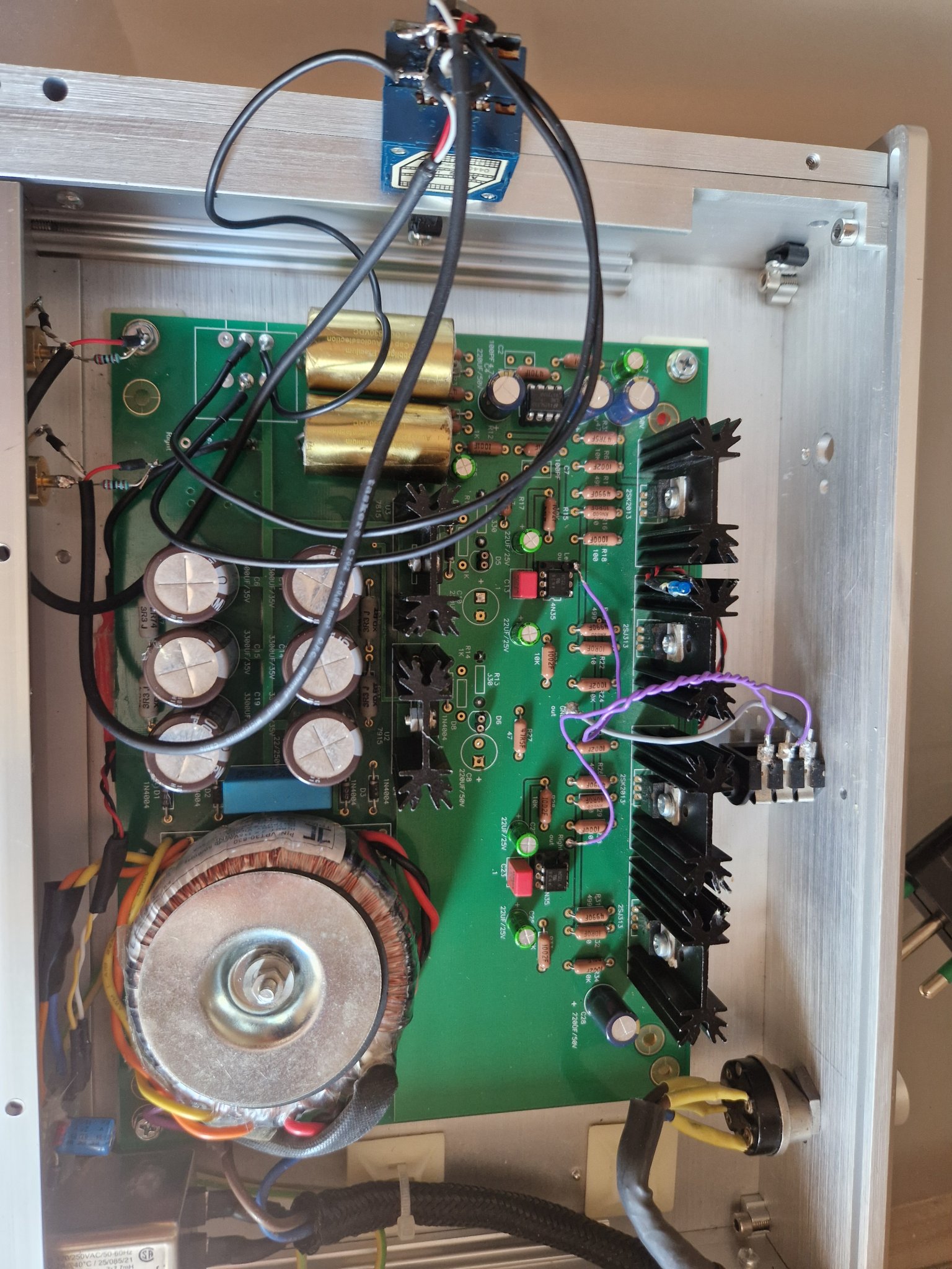

I reconnected the potentiometer and checked the connections several times.
I replaced the op amp.
Everything sounded great then I changed the wires to the potentiometer.
Only one channel was playing because there was a small short circuit at the input.
Once the short circuit was solved, nothing would sound anymore.
I thought maybe the volts were high and tried to bring it to 15V.
For a moment I had more than 21V.
Now the configuration is 15V.
There aren't many things that can go wrong, maybe op-amp/Mosfet/ optocoupler, but I can't find the solution.
Not the slightest sound comes out, not even a rustle, absolute silence.

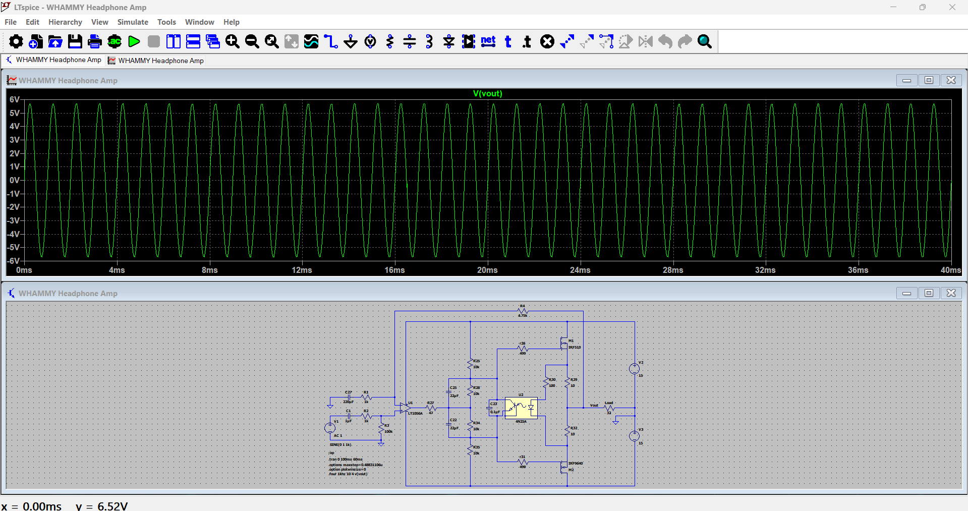

Look at the circuit diagram. This is a working simulation of the Whammy:

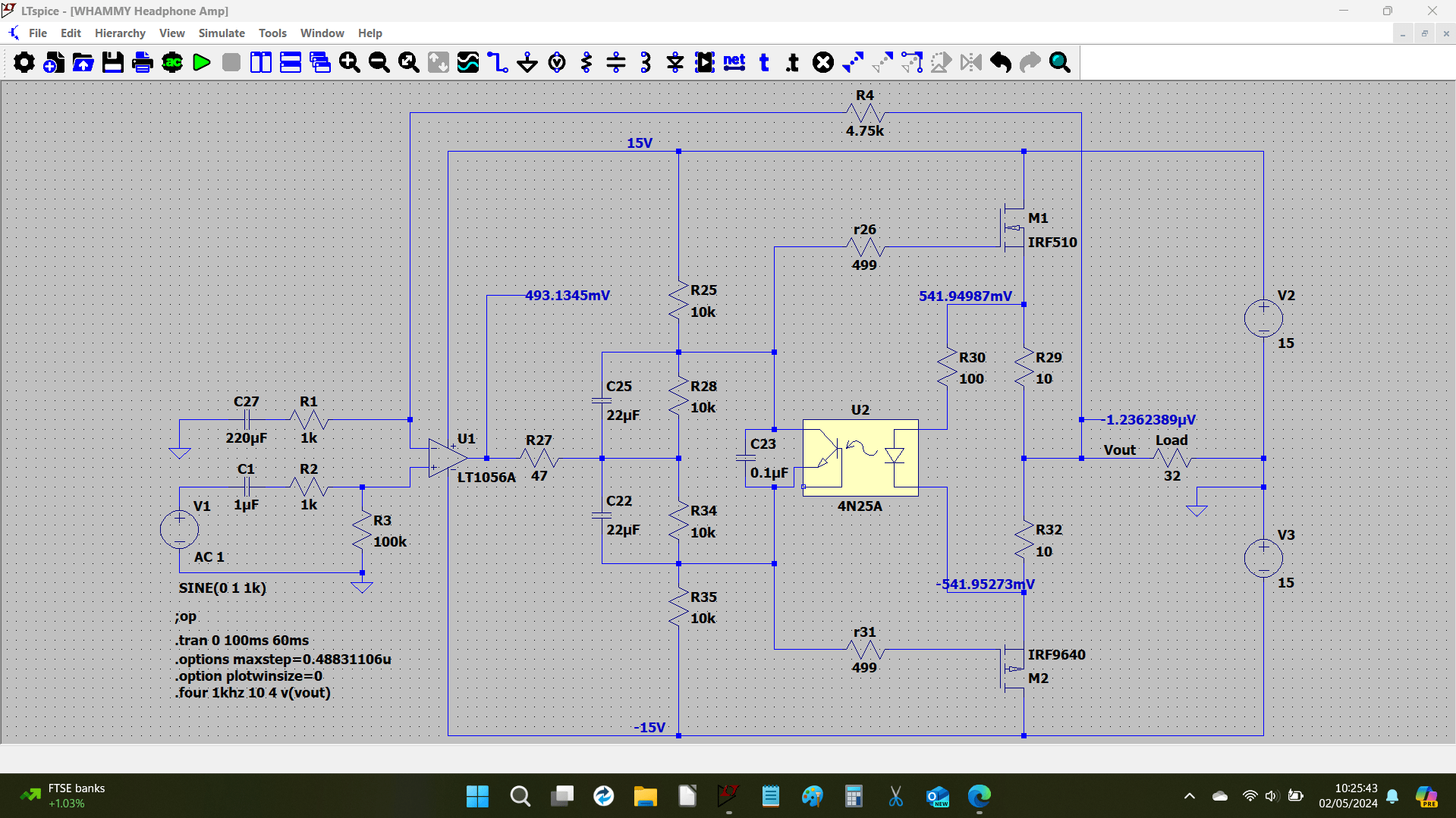

And this shows typical DC voltage conditions:
Can you just check that the voltage at the opamp output (measure on either end of the 47 ohm resistor on the opamp output) is at approx 0.5 volts and not either very high or very low which might indicate a short at the output somewhere.
Here I am.
On the 47ohm resistors (op-amp output) I measure 0.2 Volt.
On R30 (from octocoupler) 0.5Volt.
It seems ok.

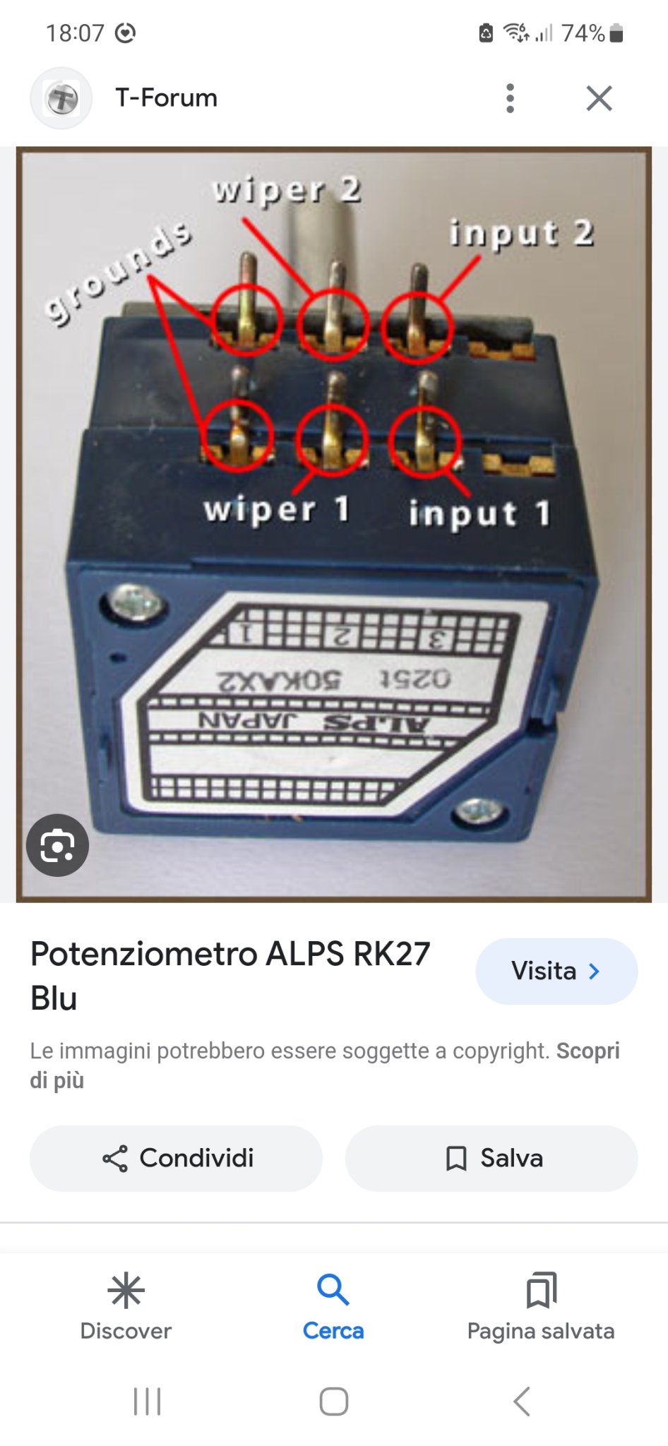

I go from the RCA direct to potentiometer input 1/2 and relative ground on the opposite site
I then exit from "wiper" and connect to central pin on the pcb.
The groung from the potentiometer to ground pins of the PCB.

The pot looks correct, certainly the way you have marked it.
Just looking at the first picture. Have you used the correct set of pins on the headphone socket? Some sockets have switched contacts with continuity from side to side when nothing is plugged in and then one side goes open circuit when you plug in.
