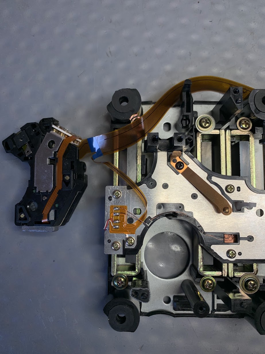

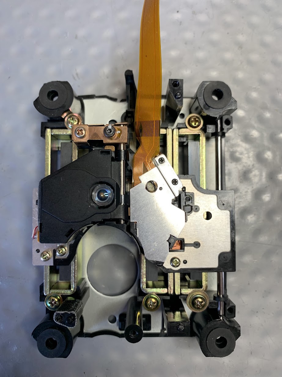

Assuming the PWY1011 has been already removed from the player, these are my LD replacement steps:
1. Check the power trimmer and adjust it to the maximum resistance
2. Shortcut the pads on the laser head flex near the trimmer
3. Desolder the 4 pads responsible for linear motor and linear sensor
4. Remove spindle motor and detach the laser head from the rest of the mechanism
5. Loosen the flex around the LD
5. Desolder the 3 pads of the LD
6. Unscrew the metal plate holding the LD
7. Remove the LD and clean up the flex pads removing welding paste residues
8. Insert the new LD paying attention to orientation
9. Reposition the metal plate
10. Reposition the flex and solder the pads
11. Remount the laser head and the spindle motor on the mechanism
12. Re-solder the 4 pads responsible for linear motor and linear sensor
13. Check all connections between the flex connector and the different pads that have been soldered
14. Reposition the PWY1011 assy in the player
15. Reconnect ground screw
16. Reconnect spindle connector
17. Reconnect the flex connector
18. Remove the shortcut added on step 2
19. Check the LD (even with the trimmer set at maximum resistance the light is visible)
After the physical replacement has been accomplished and the LD has been proved to work, execute the adjustment as described in the Service manual.

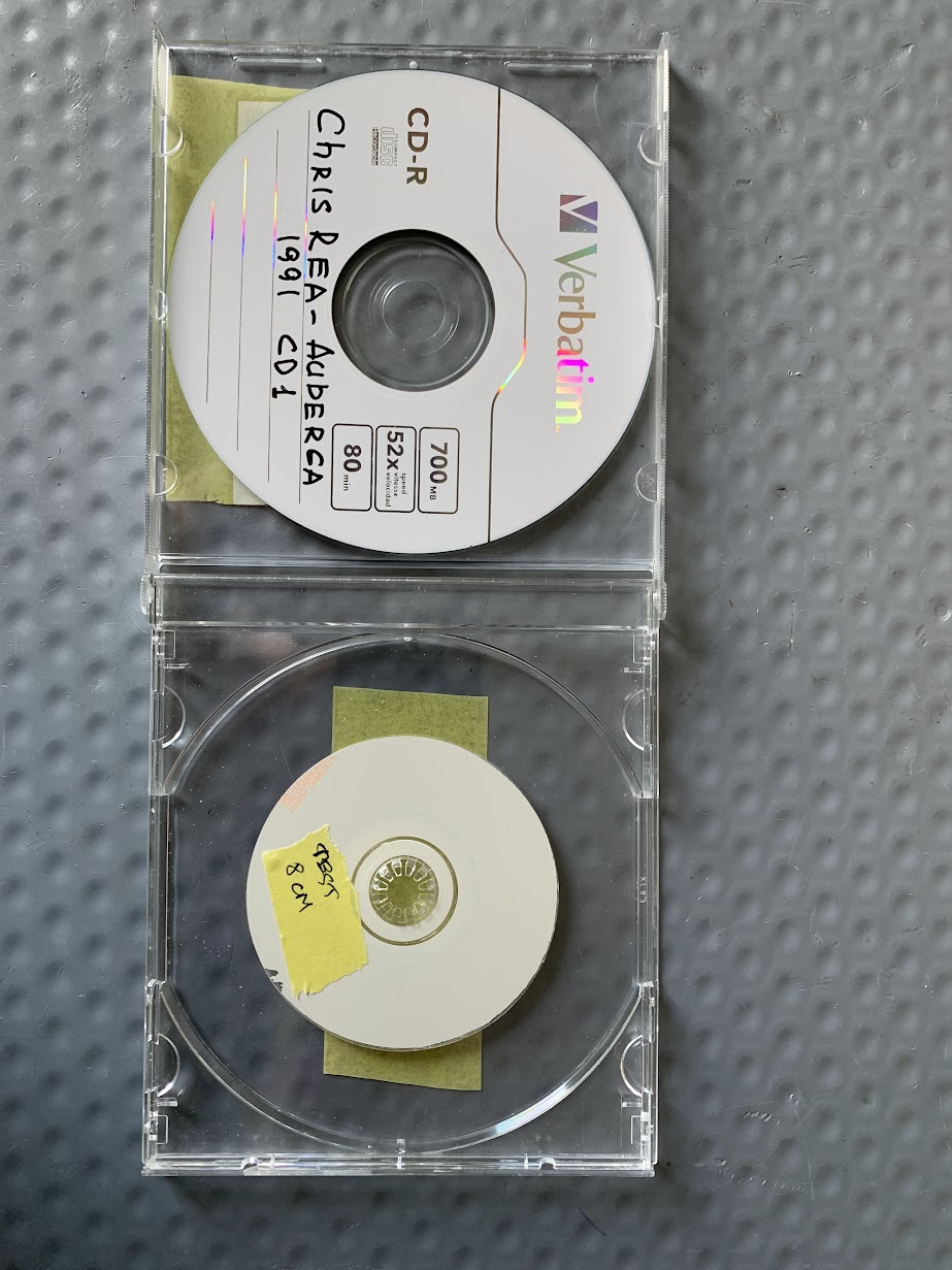

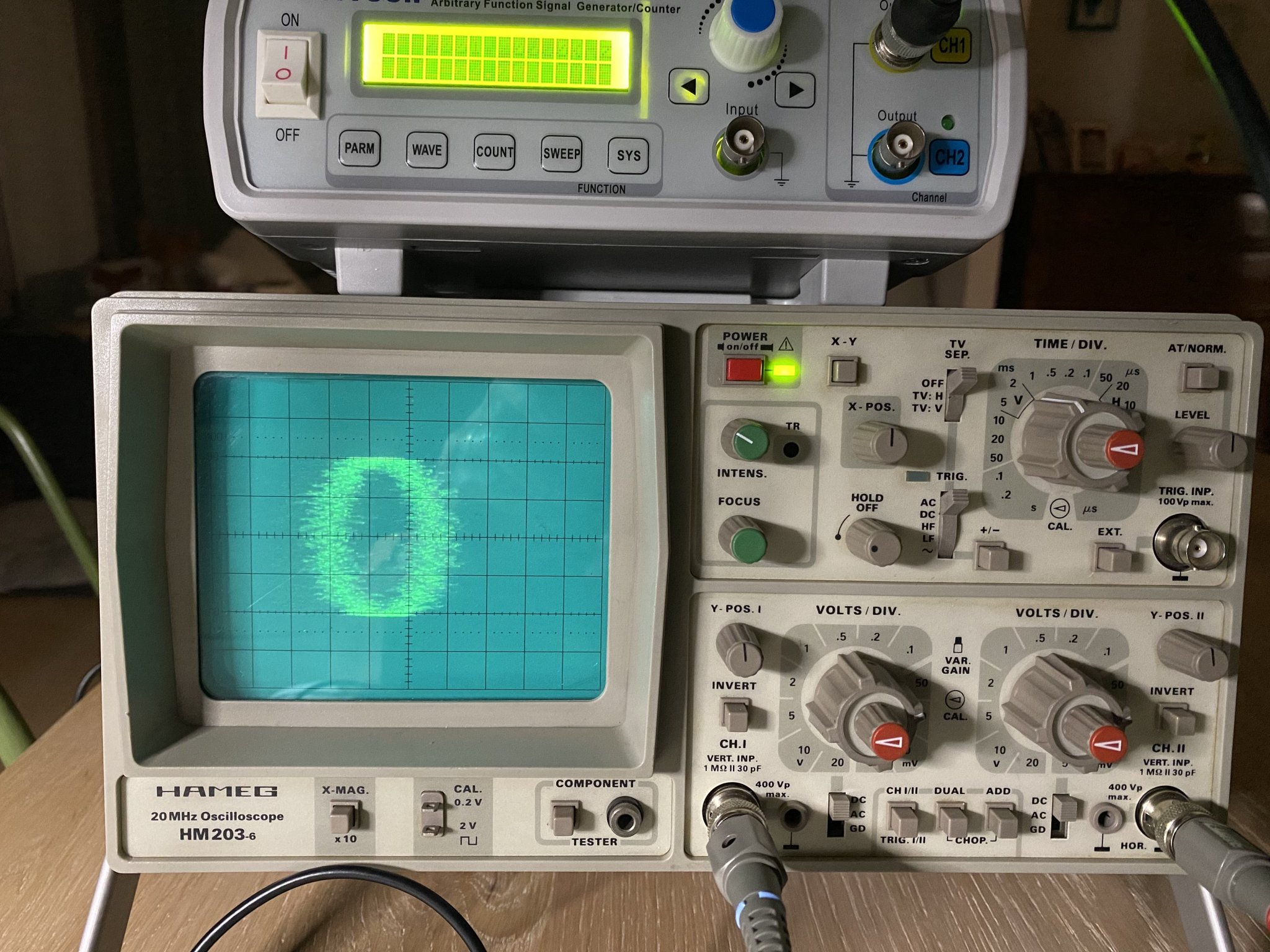

After the calibration I ended up with the following state respectively playing 8cm and 12cm discs:
Although the replacement procedure opens the door for resurrecting many Pioneer players (I'll try more in the next weeks and I'll also try using Rohm) I still need to fix, in this first exercise, an annoying issue due the the linear motor/sensor constantly fluctuating and causing tracking issues on other tracks (any hint/clue/suggestion is more than welcome)
Enjoy and have fun!

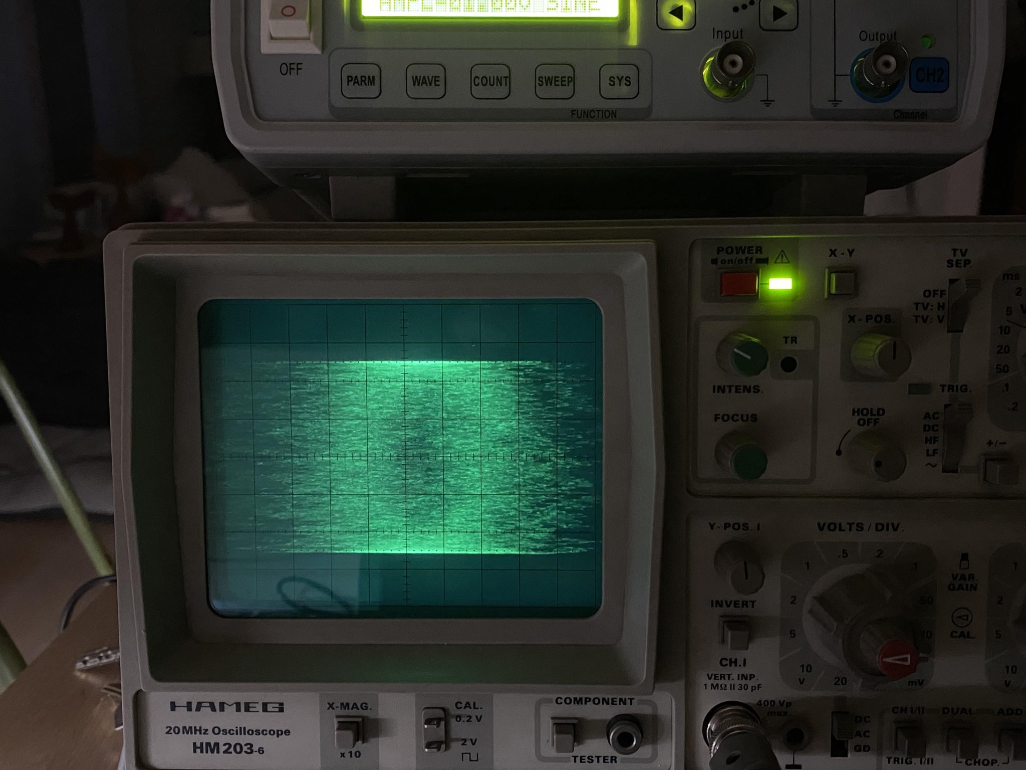

I've also executed the gain calibration for Tracking and Focus, but while the former came with a very clean picture, the latter (the Focus Gain) came up with a very noisy one
Focus gain calibrationTracking gain calibration

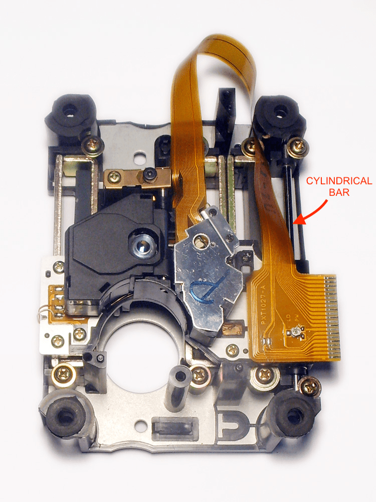

Thanks a lot Mauricio for the hint... you just helped me awaken from my mechanical torpor. The problem was not the mass, not the "spring" but rather the damping element. In my reach for the perfect restoration, I wrongly cleaned up the cylindrical bar and added on the bushings a few micro drop of super fine oil. This was way too frictionless causing the system to go wild.
This morning I re-cleaned the bar and the bushing adding a small amount of PTFE grease and voilà the magic happened with the transfer function being now "proper".
The tracking system works like a charm, tracks are reached in 2 secs, and the seesawing is totally gone!
Cheers, Riccardo

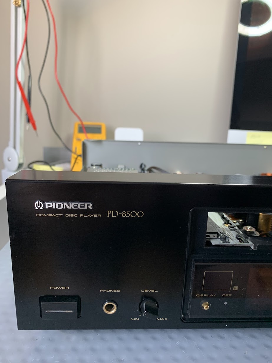

Hi guys!
I opened the site and found your discussions.
Have fun with lasers.
You did a great job, which made me dig out my dust-covered Pioneer PD-8500.
The laser was dead for a long time, but today it is resurrected.
The diode itself was replaced with a new one, your discussion and photos and videos helped.
I set up the mechanics, all that remains is the electronics.
When I'm finished, I'll post my work.
Good luck guys.

Thanks guys.
I stopped, there is no remote control.
It was not possible to go further, since working with electronics in test mode is not possible without a remote control.
Many commands via the remote control to launch the laser.
I ordered the remote control, I will wait and return in a week.
But even now, approximate adjustment of the laser horizontally and vertically brought results.
Now it confidently reads discs and there is a rare failure when playing 15 discs 1.2 failure.
I made a test disc from a standard 12 cm x 8 cm CD.
I glued it with tape to a wooden plane, took a screwdriver and an 80 mm wood cutter. I installed a 120 mm (CD) disk in the center and went through it with the cutter at low speeds. I received a recorded disk for testing and the CD Pioneer tincture.
Something like this.
Thank you for asking.
Good luck to all.

  • although radial and tangential calibration can be done with a 12 cm disc I recommend checking on eBay for 3" or 8cm discs. The approach you've tried can create scratches on the disc surface plus can generate unbalanced discs that could make the adjustments even harder (long story short buy a used 3" CD on eBay)

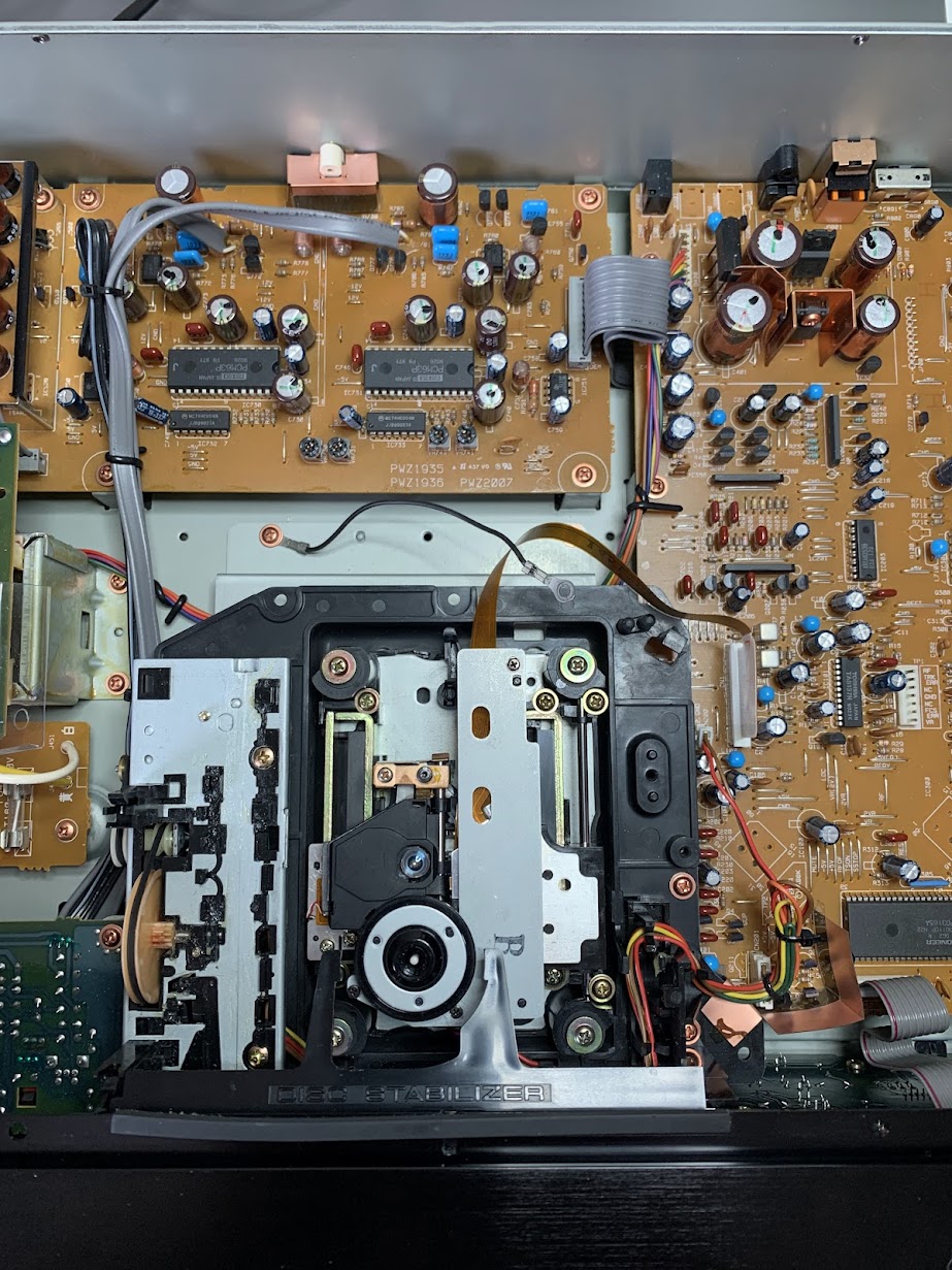

Hello again Riccardo!

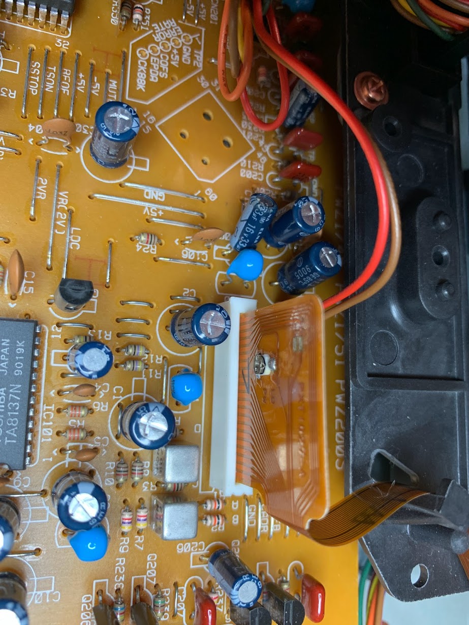

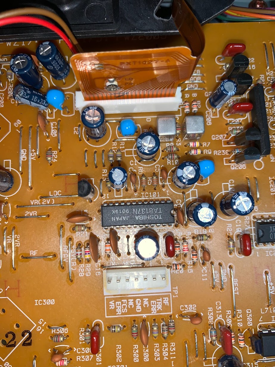

One more thing, this Pioneer PD-8500 model does not have adjustment resistors on the board like the PD-9300, PD-91 and others.
Which are needed for focus, tracking, etc.....
In test mode, adjustment using an oscilloscope and after fine adjustment in the X-Y planes, we mechanically exit the test mode.
We reboot the SD and then the electronics do everything.
After this you can't configure anything else.
This is such a tricky player.
Attached a photo of the boards.
Best regards, Vladislav
