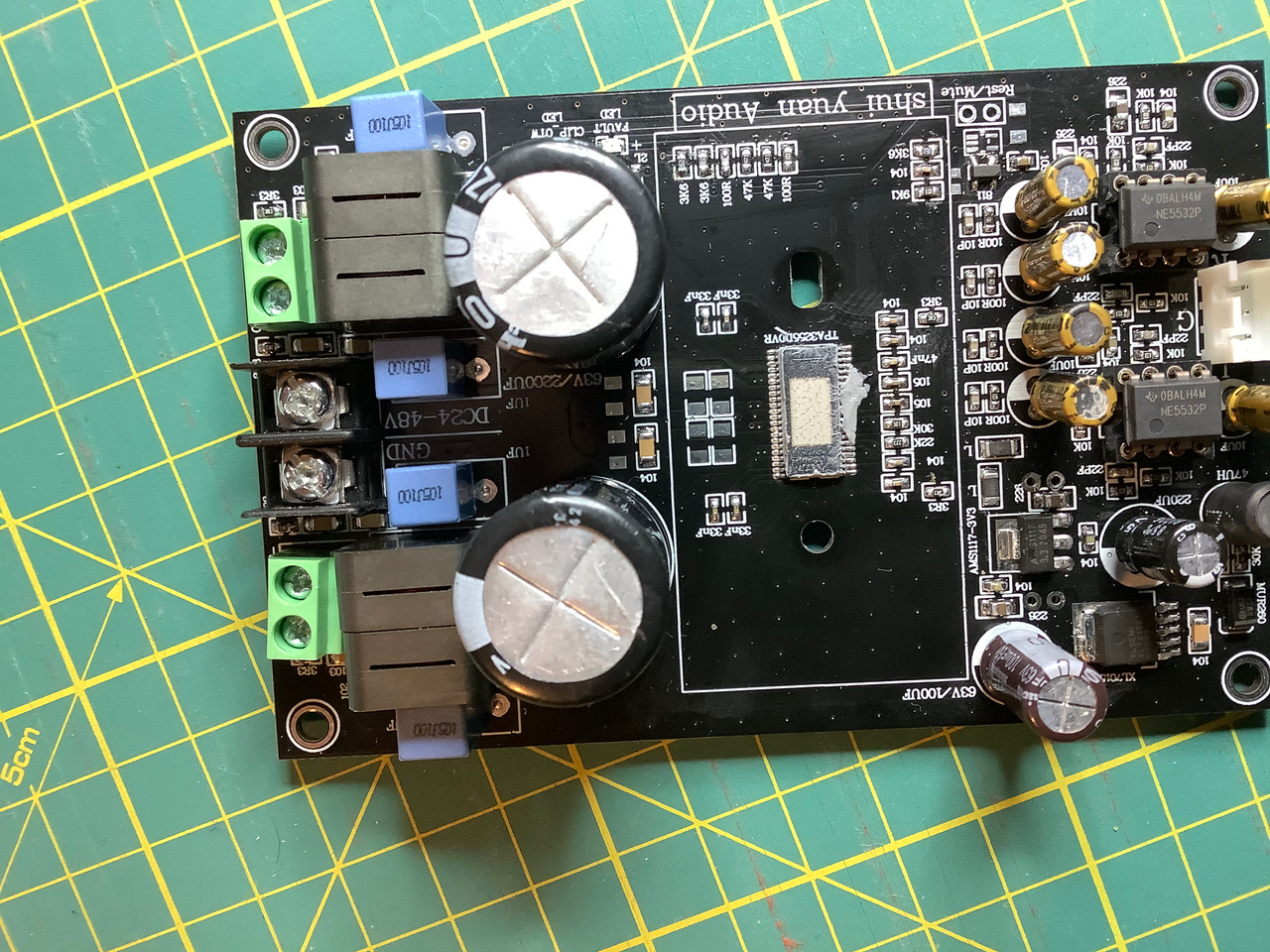

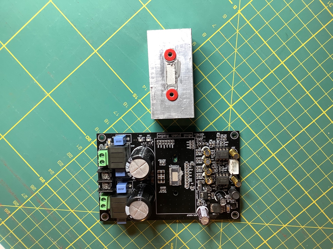

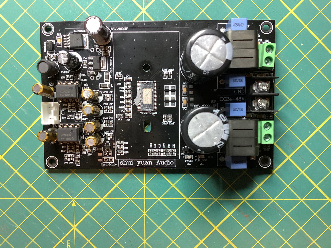

Some pictures of the board with the heatsink removed.
Appears to be hand soldered !! The board follows the Texas Evaluation Circuit almost to the letter. The 12 volt power supply is a little different but otherwise all the components (and values) follow the reference design. The output inductors are 10uH and the output capacitors are 1uF. I can't remember what impedance of speaker this would be optimised for ?? The physical size of the inductors is very small !! - see later comparison with 3e-Audio board. I think some of the Breeze Audio amplifiers use these small inductors. There is no visible branding.
Picture of whole Board

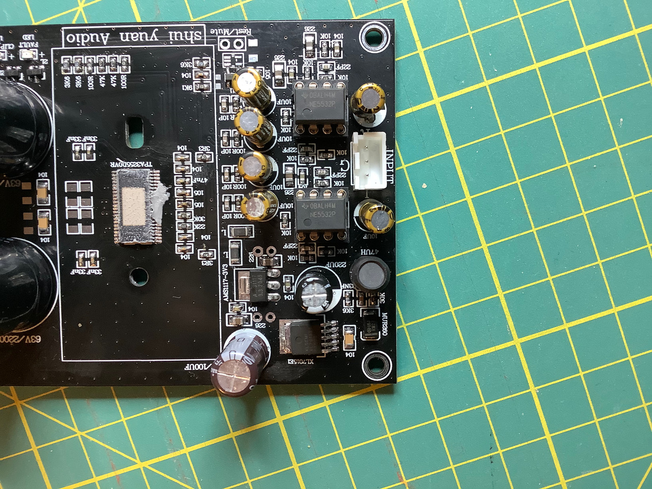

Picture of Op-Amp end
Picture of Inductor end

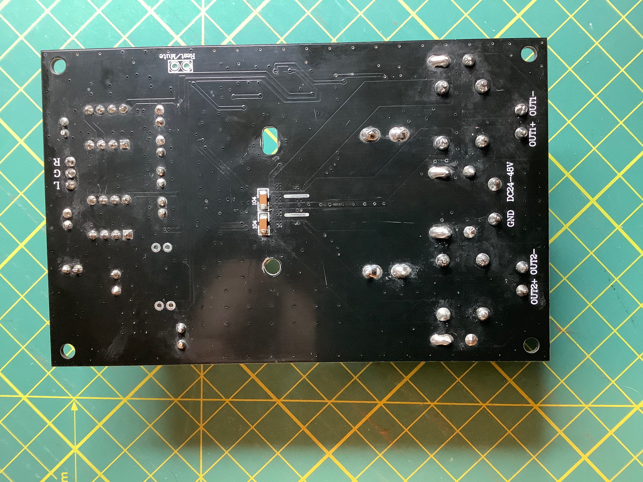

Picture of the back of the board

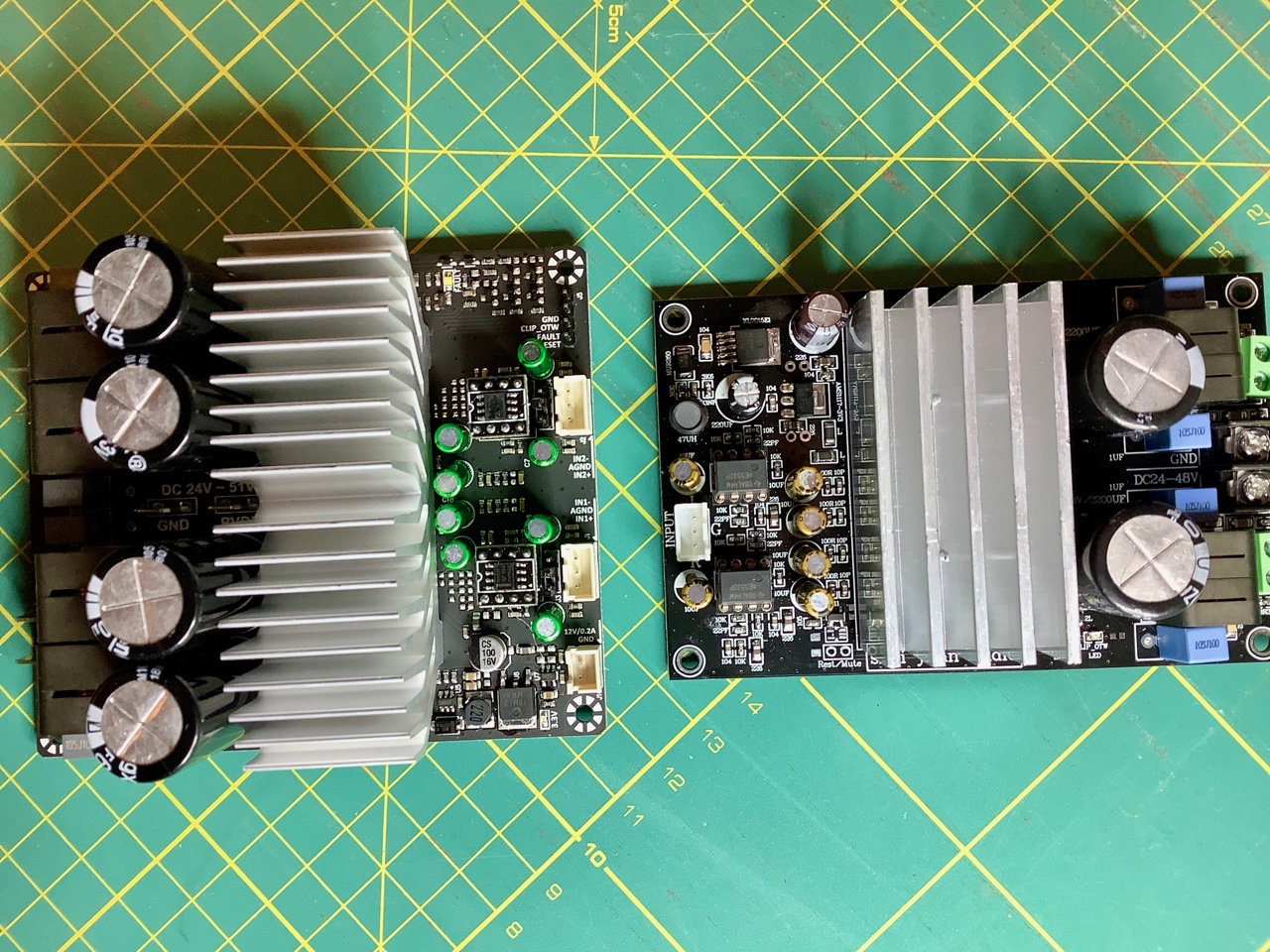

Some more photos and comparison of the Shui Yuan board with 3e-Audio TPA3255 Amplifier board.
5. Details of Heatsink. Just spaced away from the PCB with two fibre washers.

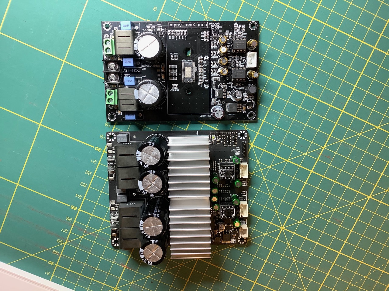

6. Comparison of the Shui Yuan board v 3e-Audio board.
7. Comparison of the Op-Amps - Both boards have their original Op-Amps installed.
8. Comparison of the Inductors - The Shui Yuan inductors are tiny. Unlikely these would allow the full capability of the board to be realised due to current limitations. There are no manufacture names on the inductors so no specification !!?? Also note the PCB tracks on this board are small. I don't know what the weight of the copper tracks are on the PCB but they seem quite thin compared to other boards.

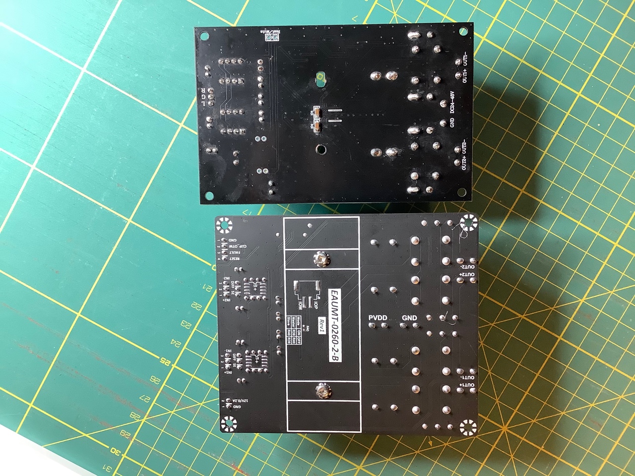

9. Comparison of the back of the two boards. Clearly see the hand soldering of the Shui board compared with the Automated Solder Flow of the 3e-Audio board. The excess leads of the through hole components have been hand trimmed. Does make you wonder who manufactures this board and what quantities will be available.
I think it is quite clear from a manufacturing quality point of view what you get by paying more for the 3e-Audio board.

here the spec of the Shui Yuan :
A small 110*70*35MM PCB
SAGAMI 7W14A inductors
Nichicon 2200UF/63V VZ serie power caps
Nichicon FW serie Buffer caps
TDK / Epcos fil caps (to confirm)
DIP8 OP amps socket
About inductors :
oddly ... it seems to heat up less than the 3 audio ...
This is really a must have this board !!!
Enjoy!!!
Well, if you have two amplifiers with the same chip and thus same idle current/dissipation, you´d ideally have similar temperatures (if heatsinks are of similar size)!
If one heatsink is colder than the other (assuming there is no oscillation/defect), what does it mean? It means the connection between chip and heatsink is not of low thermal resistance and so not very well "executed".
It also means the chip runs hotter on the amp with the cold heatsink.
Most of these class-d amplifiers have great value, don´t get me wrong but these are not manufactured to the 1/10th of a [mmm] and thus you can expect relatively high thermal resistances between chip and heatsink.
I would definitely take the amp with the hotter heatsink (again assuming there is no oscillation or similar).
