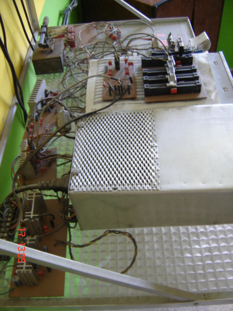

Look at the aluminium box. This is my DIY SMPS. UC3842 + STPS7N60 + BYW98 * 3, TL431 + PC817. The SMPS gives ±14V and 12V more or less well regulated.
Once I had only 30VAC (Nominal 220VAC) in the mains, once the SMPS started up, then it continued working down to 30VAC. Believe it or not, but I saw it.
Not necessarily. Reading the Marty Brown and the Abraham Pressman's books was all I need to build this old fashioned SMPS. Plus some "copy and paste", for example, no one of the authors sais how to design the clamp in the primary of the fly back transformer. Ergo, I took the values from dozens of SMPS's I repaired (CRT monitors and TVS, notebook chargers, etc,) then I got an approximate value, and use it (Diode, capacitor and resistor). Hurra, it worked from several years. Not to mention, that when the the SMPS still haven't its box, and the PCB was open at the air, a drop of water-based wall pain drop in the SMPS, just in the MOSFET insulator to the grounded heat sink...Some few sparks, but the SMPS survived OK.
As only a suggestion, start with a simple project. My first was only a 220AC to 12VDC 3A converter. It is very easy. Check and take note of the difficulties encountered, and learn from them. Once the simple one is at your satisfaction, and if and only if is at your satisfaction, then start a new more complicated one. But do not start from a ±12V, plus a 5V and 250V DC.
