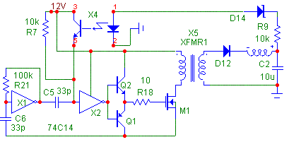

I like that 7414-based circuit, short and sweet... I'll check my IC pile (gasp!) to see if I have any in there, might have to build that one. Er.. will 200V work for the MOSFET? That's the best I seem to have right now...
OBTW half-wave choke input won't work. It needs a second diode to clamp the inductor, IIRC. Cap input would be easier.

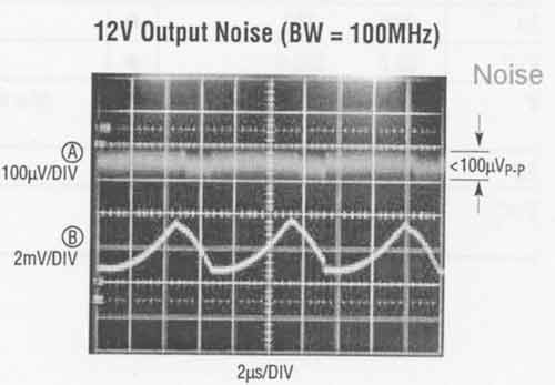

The 100uV is from the LT1533 ultra low noise switcher. Most SMPS are a 100 times worse, at least.

Sch3mat1c said:Well gee, 100uV is too low to care about unless maybe you're powering a phono amp.
they get the noise low enough to use in ultrasonic medical equipment, hydrophones etc.

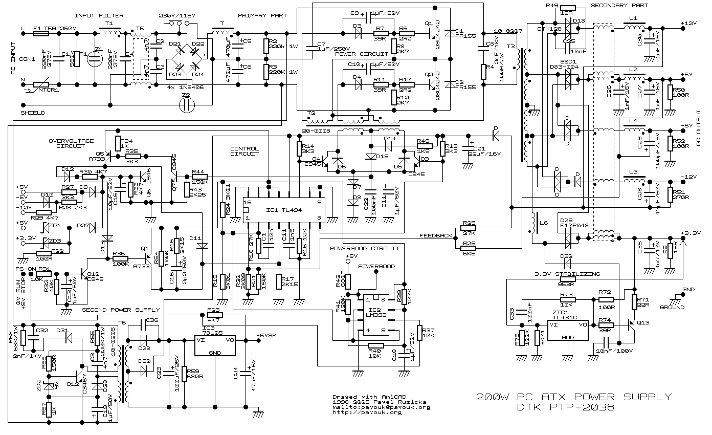

Having some SMPS understanding, it´s relatively easy to modify for your needs an old AT or ATX computer supply, that costs almost nothing
A model with complete mains filtering should be selected as some models lack common mode or diferential mode filters because in theory can pass EMI tests without them
Originally these power supplies have a few mV of ripple and ringing on their outputs but this is due to cost cutting in output filters and poor PCB layout to be able to put all the components in so little space
Usable things from these supplies include input filtering, rectification, half bridge driving, switching transistors, driver transformer for them [made from a saturable reactor in AT units to make them self oscillate to be able to start as control circuit is powered from output side], control circuit usually based on a TL494 or equivalent, heat sinks, fan and little more
Letting the primary-driving intact you can get about 250W of output and wiht some modifications maybe 500W, but in the units I modified It was enough with 250W
ATX units are a bit trickier because you have to mantain the standby auxiliar supply to power the control circuit

Typical ATX PS schematic :
