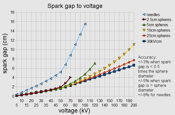

When electrode is sphere with radius larger than gap, then breakdown voltage is more consistent.

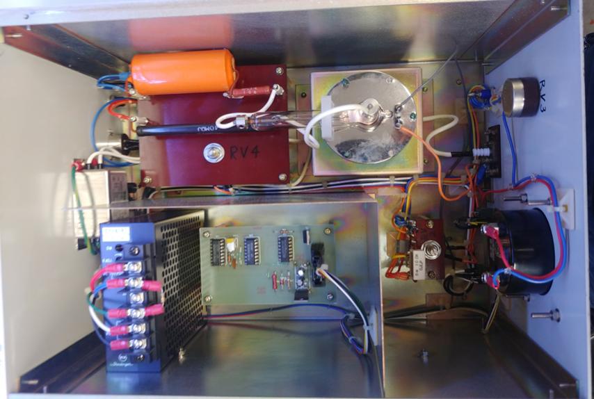

Lots of interesting ideas for spark generators. I happen to have this box, a Honda (really) impulse noise generator for testing AC power stuff. It has the right parts to make a pretty serious spark. In the middle is a vacuum HV relay and seems to be good for 20 KV and 10 or 20A at least. My current plan is to modify the relay drive so I can run it from my software to trigger it whci will enable much better data acquisition and analysis.
Also current plays a major part in how loud the spark is. its really energy in to energy out. And I can attest that a 100 uS spark from a big surge generator (3KA) can be really loud. I hope to get something not quite so serious. I do want a decent SNR for the testing.
I did look up the Taser like device. It can be had for as little at $15 and it could be interesting but not triggerable Ais seems. I will also get a gas grill sparker but again not triggerable.
My current plan is to use a surface gap spark plug for the spark (illustrated below) so I can have a stable predictable gap with no local resonant cavities. It seems Mercedes has shielded connectors for the spark plugs to control EMI and I'm chasing one of those as well so I can minimize the inductance in the loop.
Its a somewhat involved project. It should be interesting. If it can be transferred to a simpler solution using cheap parts (the grill sparker is $8 or so) that would be great.
Measuring High Voltage In Millimeters (and Other HV Probe Tricks) | Hackaday.
I did read the article, I see that he uses a CRT HV supply, most likely a diode-capacitor multiplier, such device ramps up slowly and may be contributing to the inaccuracy such as the build up of the ionization cloud in front of the tip of the HV electrodes which can be sensitive to things such as breathing on it but also variation in mains voltage supply, however, with respect to the accuracy I can't see much in that article which would be of concern for us if using a spark circuit as I described earlier using a spark coil where such device is producing the spark dictated by the timer, not when the condition for the spark to leap by itself is seen as fit.

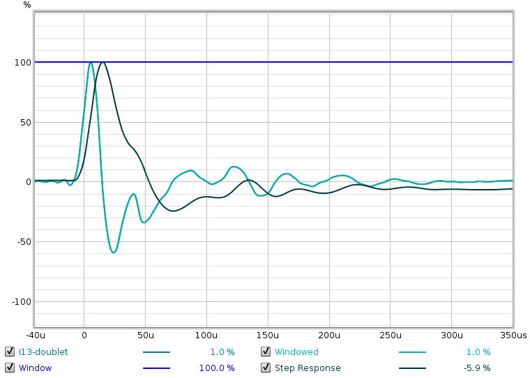

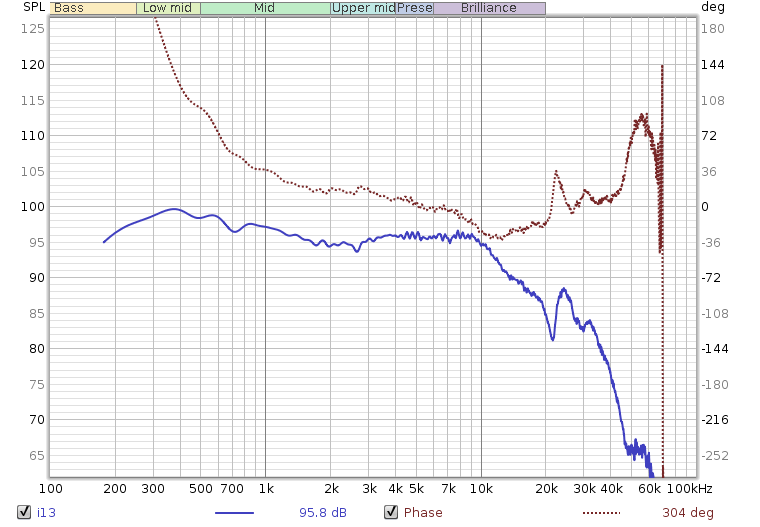

Today I suspected my microphone was bad as I measured 2 speakers, one used and one very unused, and both of them had lost sensitivity in the treble since the last time I measured them.
So I retrieved the old Ford V6 coilpack I had and triggered it with a 9V battery. I can get spark this way with gaps under 1mm. Across the gap I have a 560pF 1KV ceramic capacitor. It takes a number of tries to get a good spark as you tend to get trains of sparks instead.
With my EM172 microphone and 192KHz motherboard sound, the impulse response I get is remarkably similar to figure 2a in this reference:
http://www.sea-acustica.es/WEB_ICA_07/fchrs/papers/nla-02-004.pdf
However while that is presumably a direct pressure measurement, what I measured was a doublet which I had to convert to an impulse with a LP filter. I then fed that into REW.
So I don't know why my measurement looks like a doublet (N-wave) while theirs looks like the impulse form of that doublet. The blue line is the doublet, the black line is the impulse response (abusing REW by importing the doublet as audio data). Note that I have the same T=25uS as in the 1974 reference, which corresponds to figure 5.
I've tried this in various incarnations using tasers, grill sparkers, and now a Ford coilpack. These results are very indicative of what I've seen every time. The main thing to watch out for seems to be that your sparker is generating single sparks and not spark trains. You can hear the difference, the spark trains fizzle out in the room rather than a normal sounding spark reverberation.
I don't really know how useful this is and I don't have a reference mic. But I'm dumb enough to try spark calibration. The rising response under 2KHz is due to white noise. Here is the REW file:
Spark Calibration for DIYAudio - Google Drive

The most troubling issue right now is the rising response below 2KHz. So far any time I've seen other kinds of response variations, it's been due to pulse trains more than anything else.
I've had this issue with the >2KHz response since the first experiments with different spark sources. I put a metal screen in front of the microphone and it's still there. It's possible to make it worse with different arrangements but I don't think I have gotten it below 2KHz with this microphone. I wonder if it could be an absorption type effect in the electret capsule or a settling time effect of the internal circuit.
The other possibility is that the rising response is actually part of the microphone response, but I don't think so.
