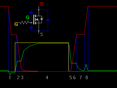

Unloaded at gate
Loaded at gate
Loaded at gate

About gate waveforms, they seem to have too fast rise and fall times to be measured at the gate of the devices instead of at the output of the IC [there should be at least a resistor inbetween to limit peak current and rise times]. Were you measuring directly at the gates as I've said?. Were you taking ground at one of the sources of the MOSFETS?.
Sometimes switching MOSFETS are not doing what you want and the only way too see it is to measure direcly at its legs
Gate waveforms with no load look right, but they show only about 200nS dead time and this is very small for your converter, you should increase dead time to about 500nS-1uS for the reasons I've already explained
Gate waveforms with load show a spike in an asymetric fashion and this means something is still going terribly wrong in the primary side. You should look for the origin of this spike [increasing dead time may make it go away if it was due to cross-conduction]
I suspect your waveforms were measured before gate resistors, and since gate waveforms are delayed [due to the effect of the R and te C of the gate] and altered [due to drain-gate capacitance], these spikes may be huge voltage drops caused by huge currents flowing when both MOSFETS are on at the same time [during a fraction of microsecond]
Beware of where you connect the ground of your probes since in SMPS ground may not have the same potential everywhere, specially if someting is going wrong and is causing fast high current transients and huge voltage drops at PCB traces
Also, beware of what is being induced in the ground wire of the probe and the probe itself since SMPS create magnetic fields, that may be huge when something is going wrong and is causing severe ringing or high current transients [most EMI is actually due to bad design]
When in doubt, try to move the probe or the ground point and look for changes in the measurements

This drawing represents all you should find in the waveforms of a switching mosfet under load, details are a bit exagerated
In your circuit the upper gate waveform looks like the one from a mosfet that is not conducting while the lower waveform looks like the one from a mosfet that is conducting [and conducting more heavily under no load than under load, curious, isn't it?
Transformer saturation in the direction of the lower mosfet is obvious, try to increase a bit dead time or switching frequency
As you would see, you allways need more dead time than expected since MOSFETs take some time to turn off and gates take some more time to discharge
In your circuit, even having 1.8uS dead time, gate waveforms are 'too close', maybe less than 500ns clearance between them, look at them in detail...
I willl describe later the processes I've marked with numbers in the drawing
So at the gate, I am looking for something that looks like the green line you have in your artwork? Is this getting closer?(loaded, 54.8 watts in, 50.15 watts out)
Yep, these waveforms are much more like the ones you will find in a converter working properly
