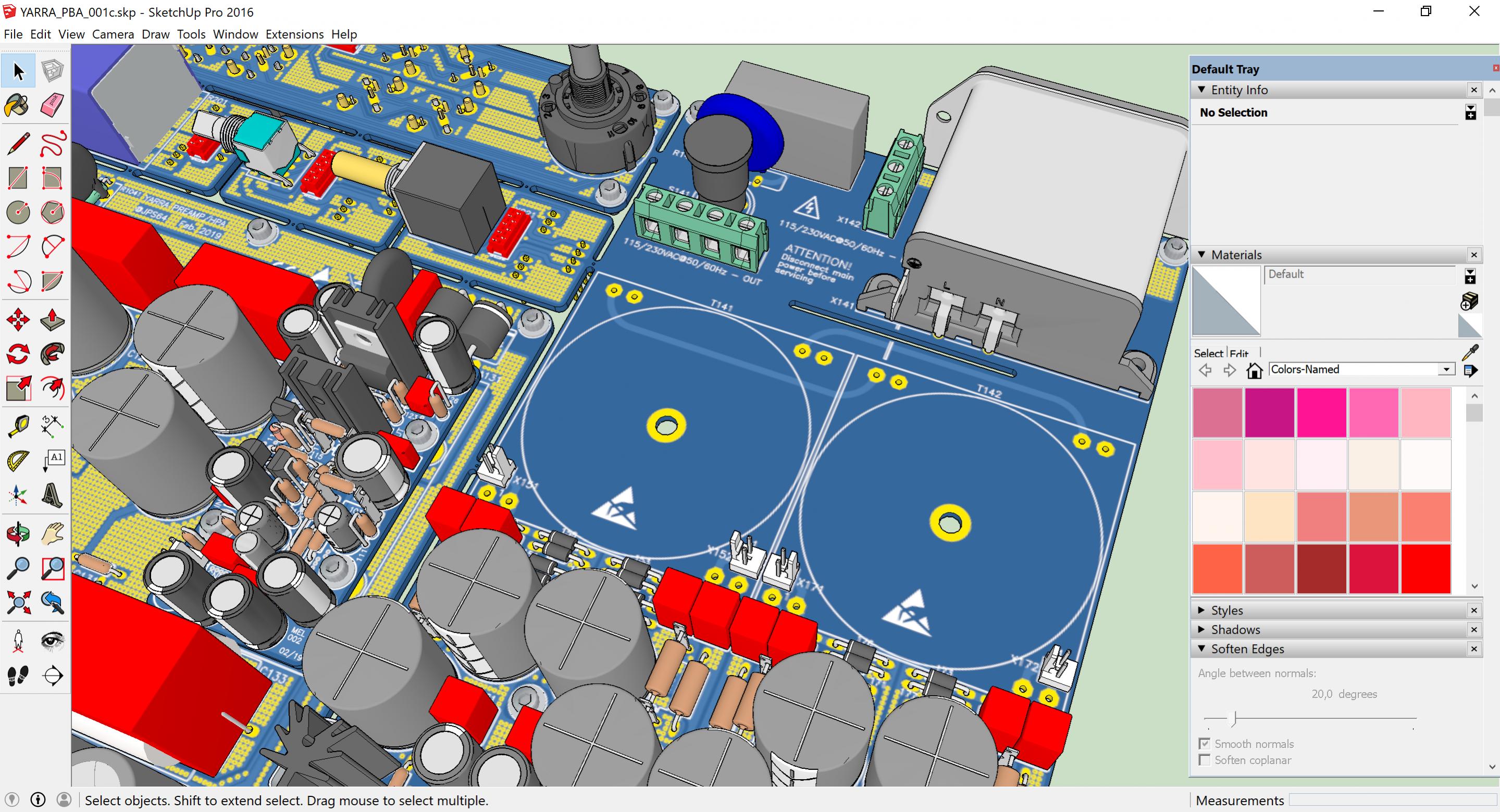

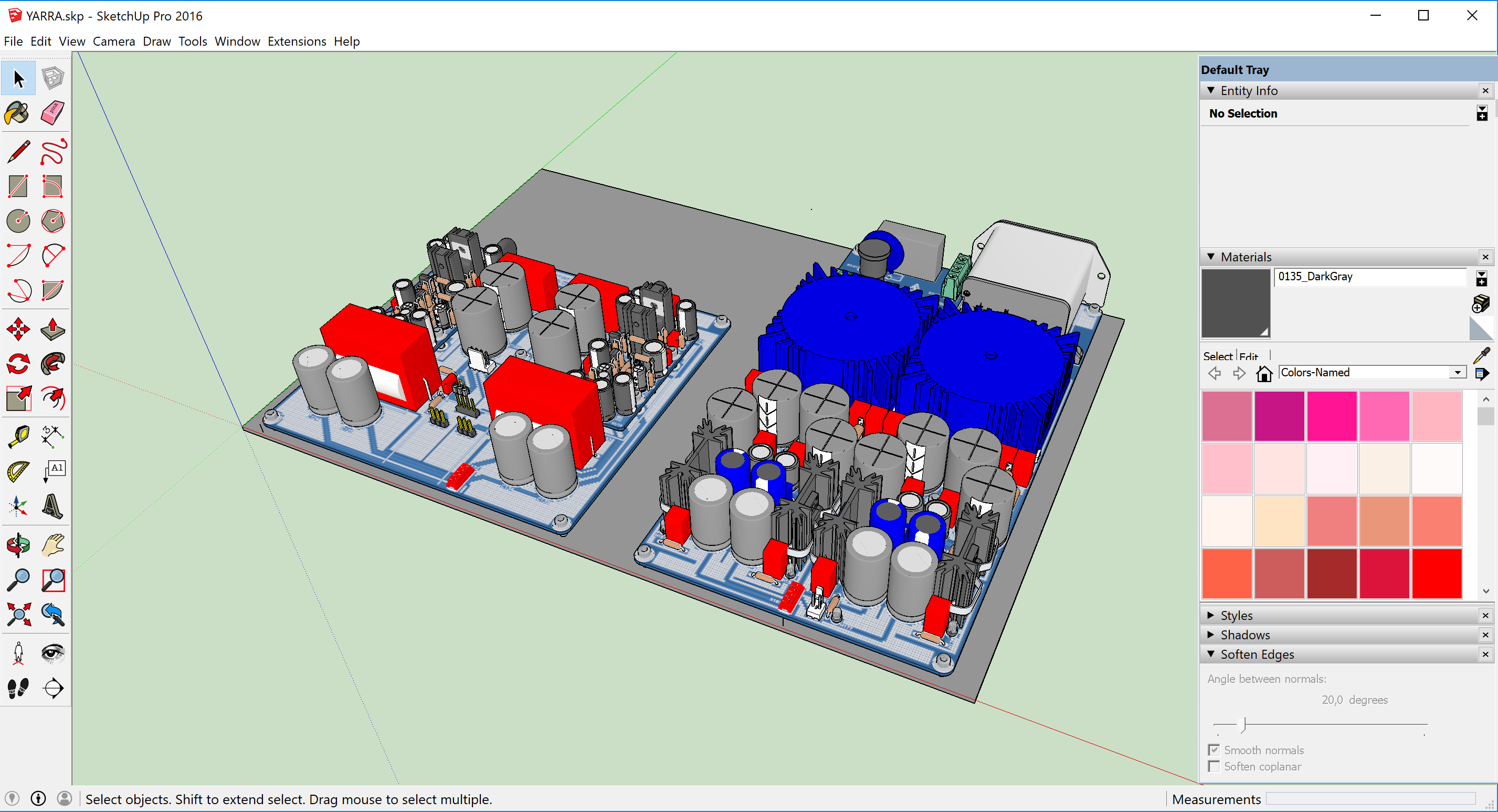

Hello guys,
big diode added; option for standard donut; option for low cost RCA connector (Product – Lumberg).
JP

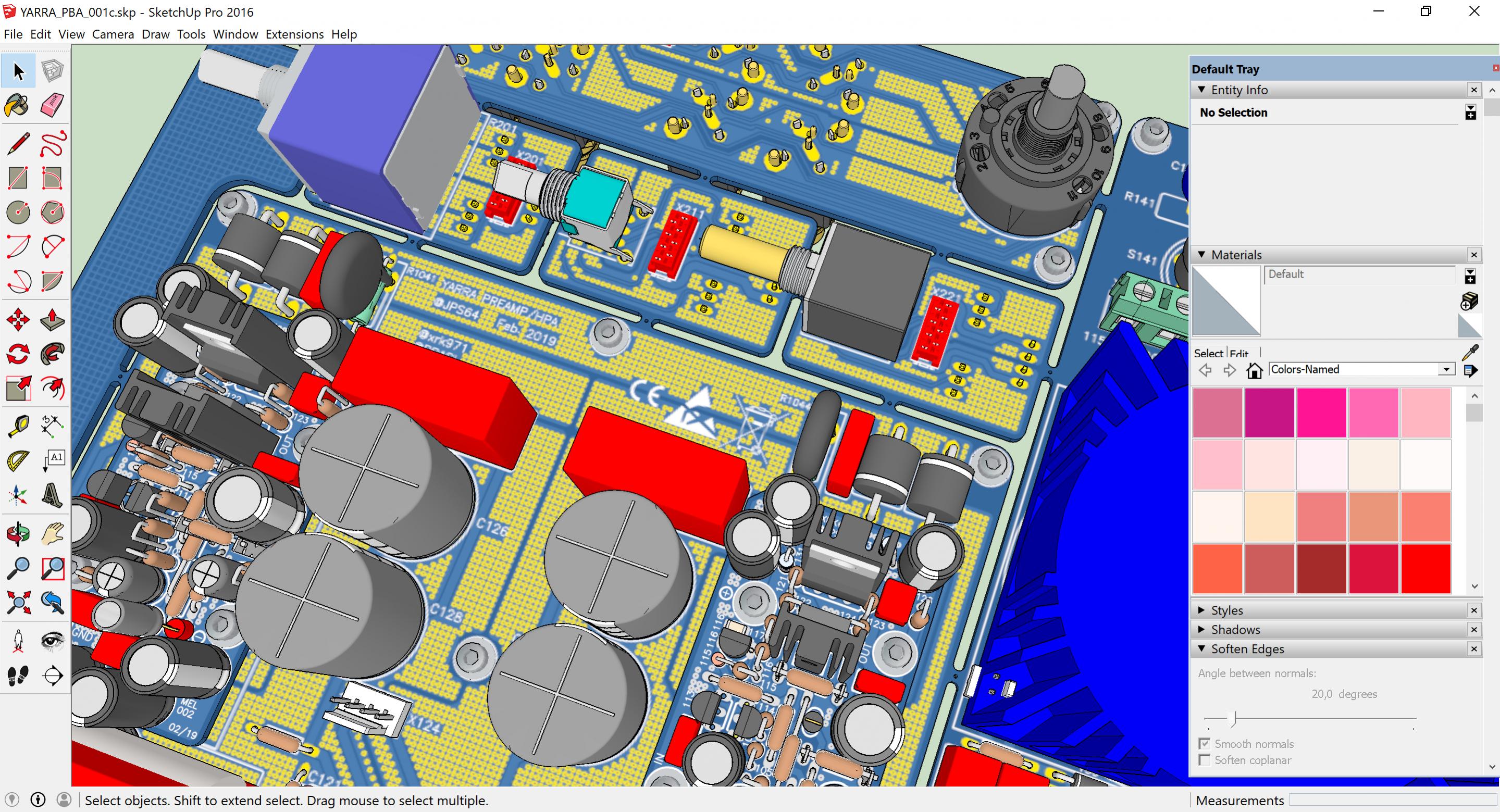

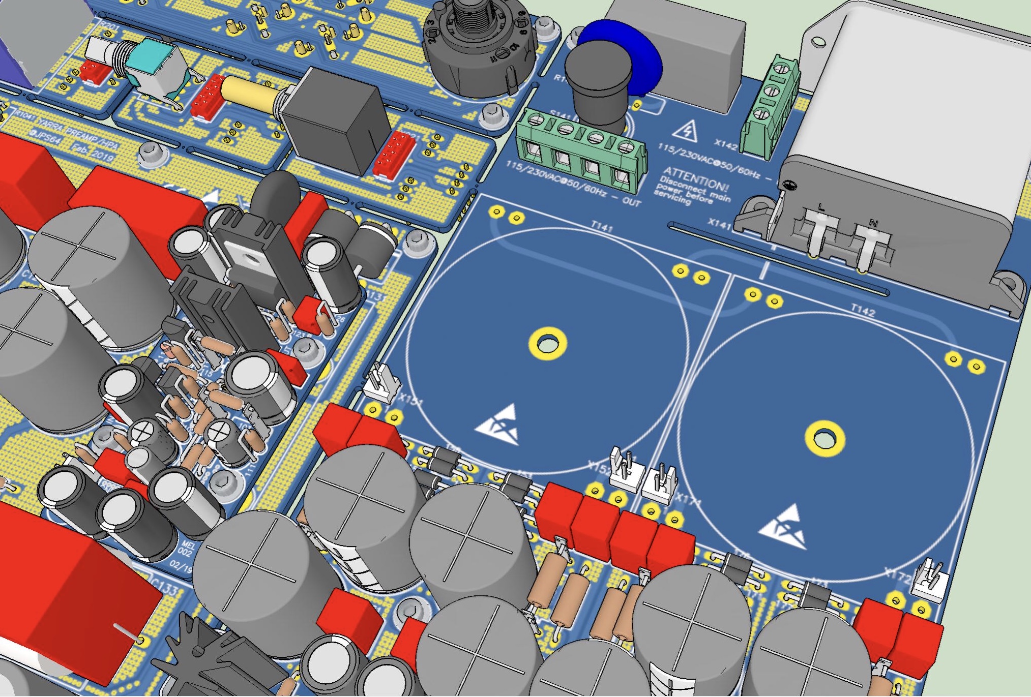

Hi Hugh,
thank you for this hearten words, but only give my best for this nice community.
Builders find printed board assembly dimensions.
Don´t forget, no wires using Micro-maTch cable assemblies (available at Mouser): Micro-maTch in Cable Assemblies | TE Connectivity
SketchUp files (using HIFI2000 1U enclosure) are too big (66MB) and I don´t know how to send it?!
JP
  • YARRA-PBA-mounting.pdf

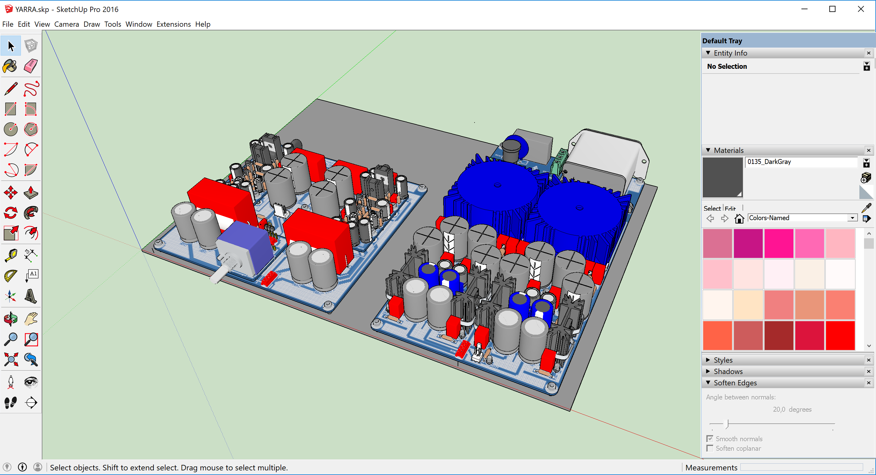

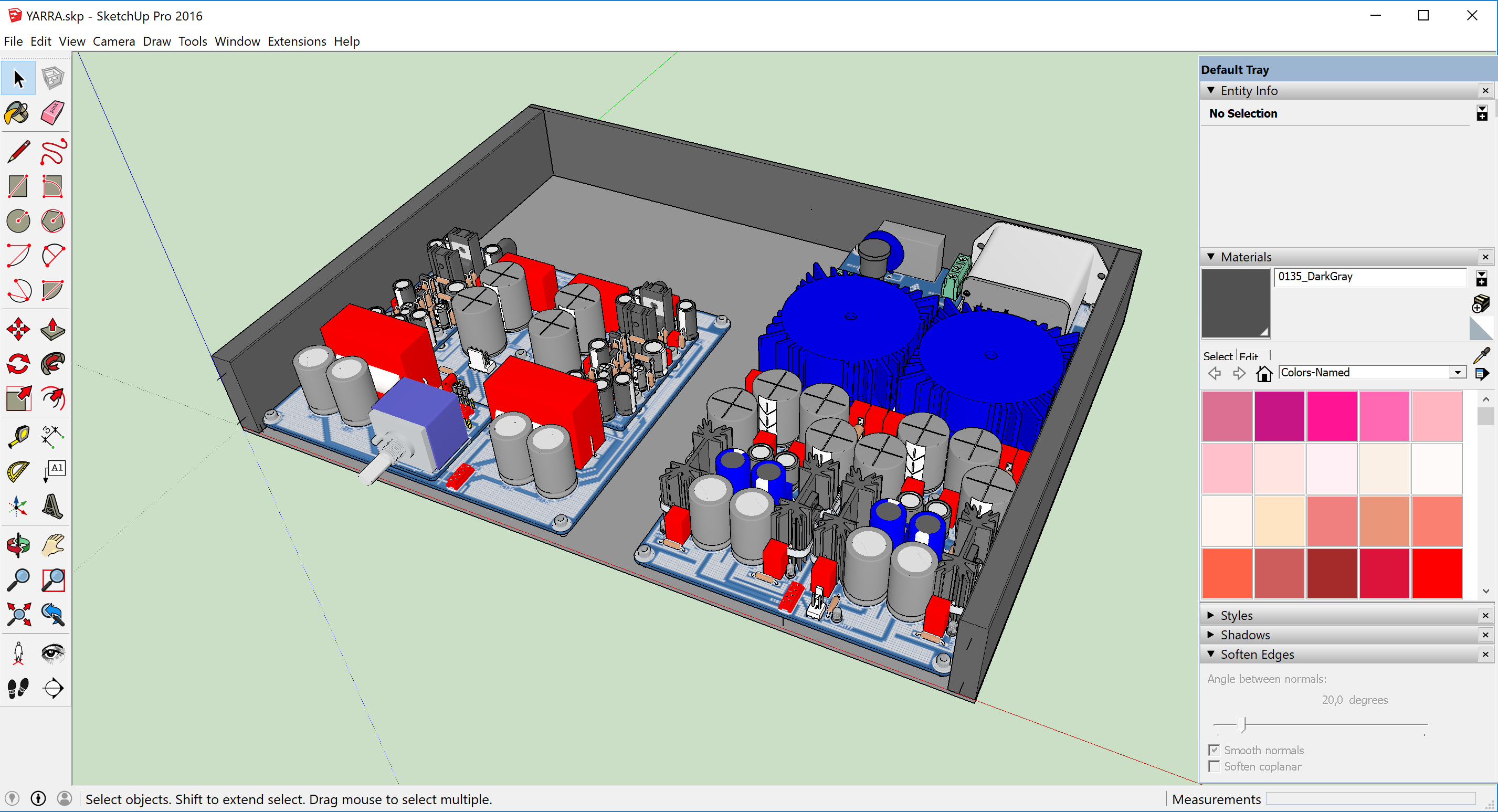

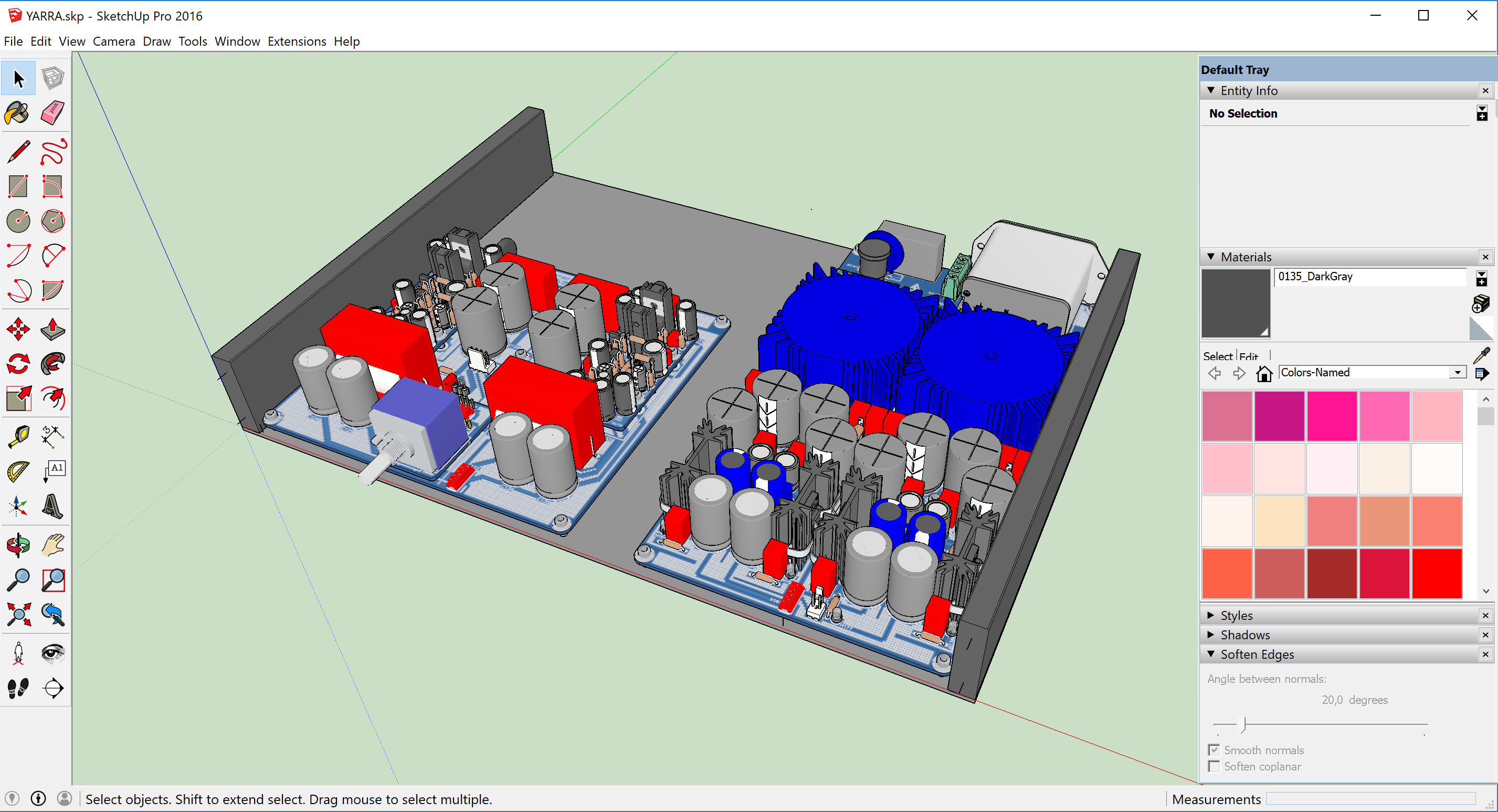

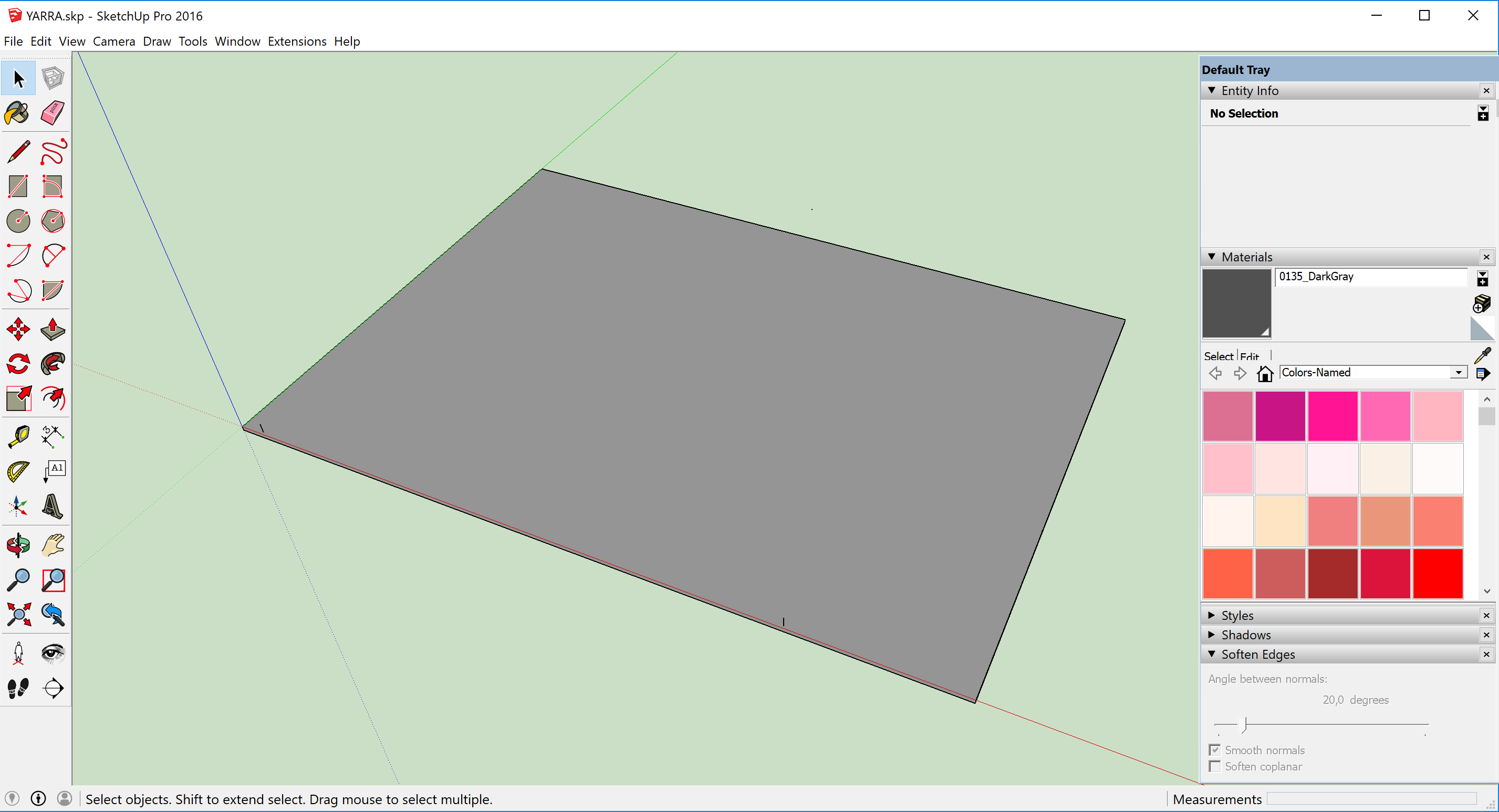

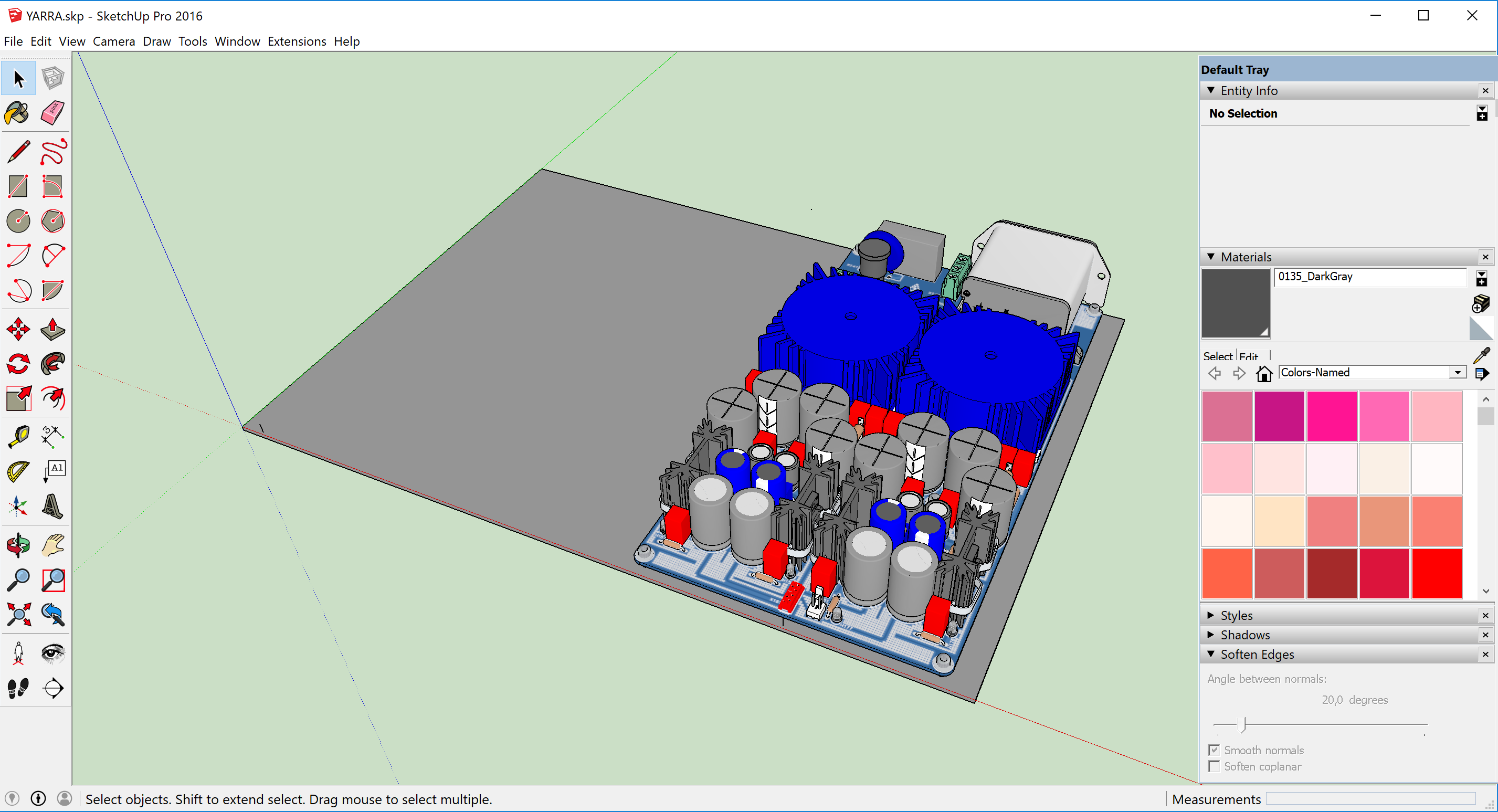

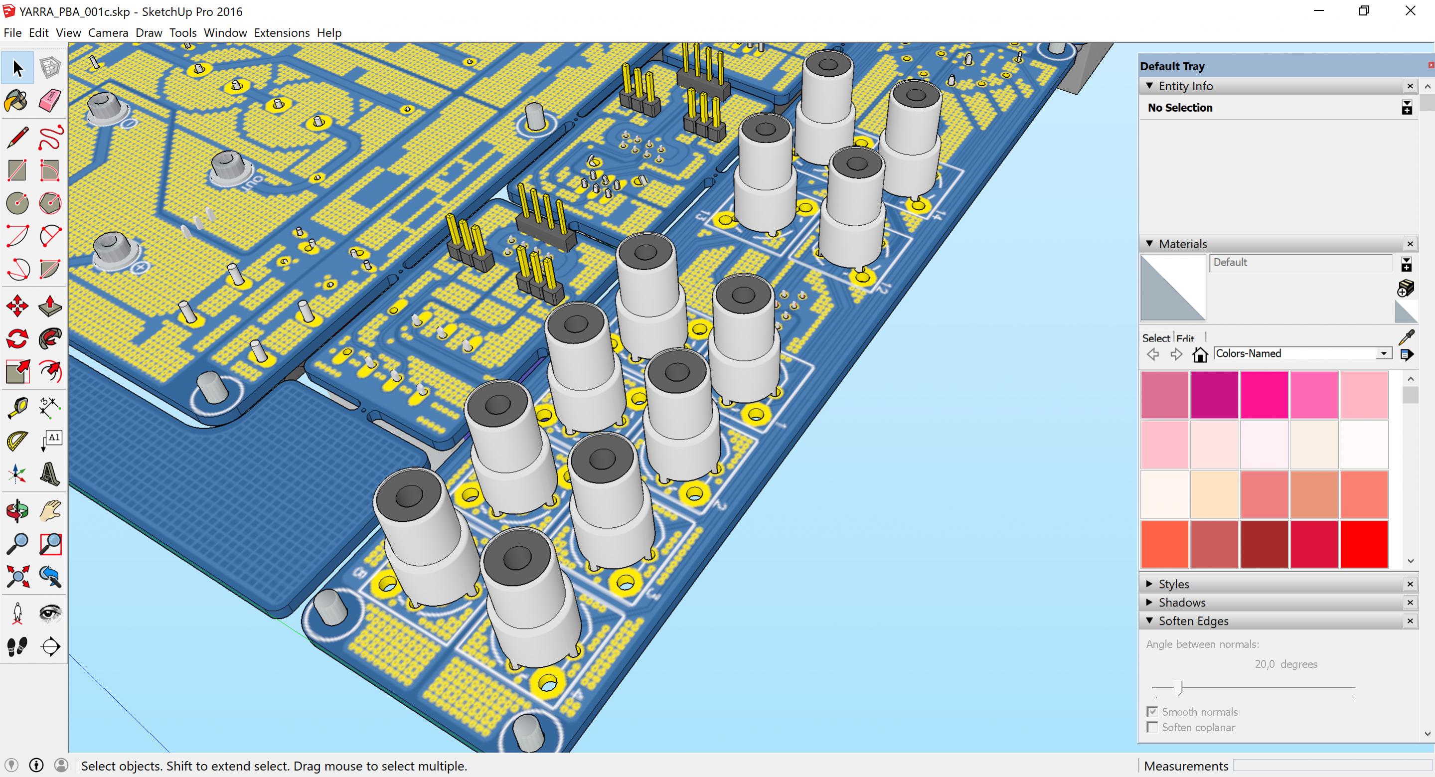

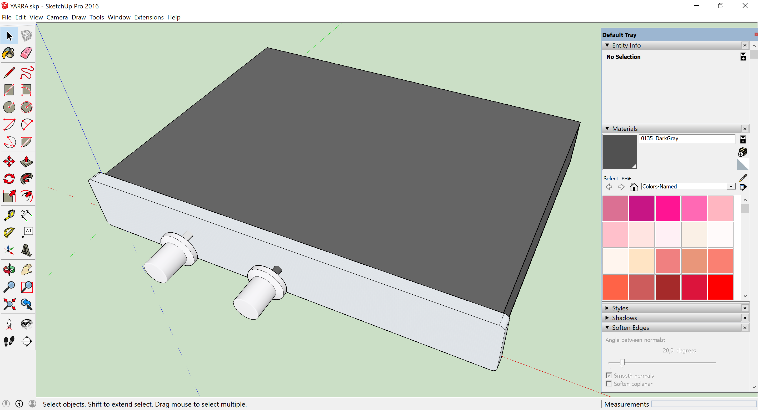

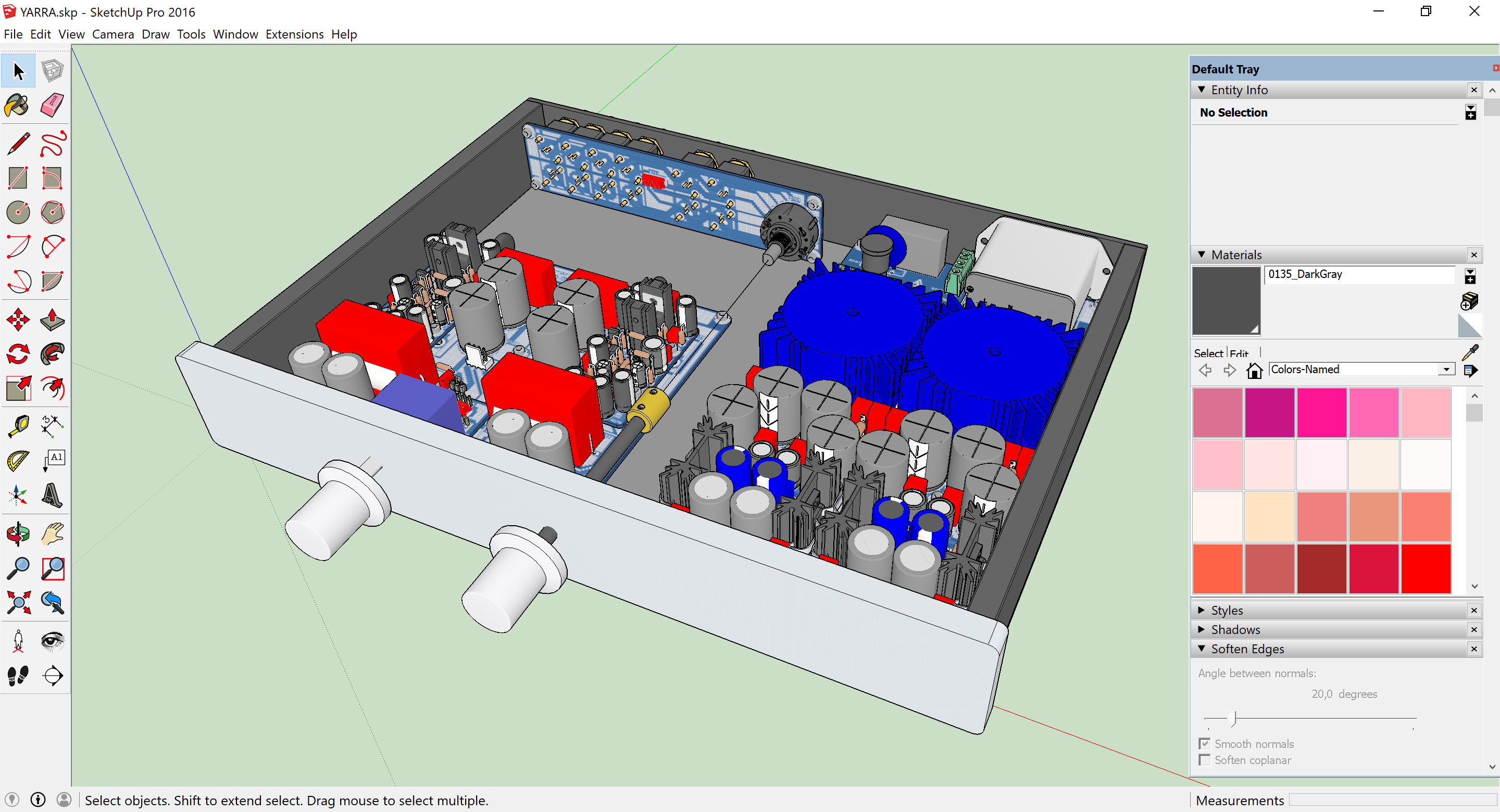

Thank you @zman01.
First the bottom plate HIFI2000 Galaxy GX343 (10mm front; 2mm panels).
Then power supply part (using 5mm spacer and don´t forget to foil isolate bottom panel from the main power section).
Then preamplifier part.
Connect both together using Micro-maTch cable assembly.
Mounting potentiometer board of your choice.
Mounting side panels.
Rear panel.
IO board and connect potentiometer board using Micro-maTch cable assembly.
Mounting axis and knobs.
Finishing with top plate.
Enjoy.
JP
