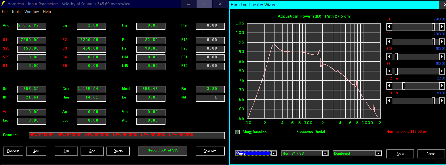

What physics are there to know when I can PHYSICALLY see the difference between
THIS
THAT

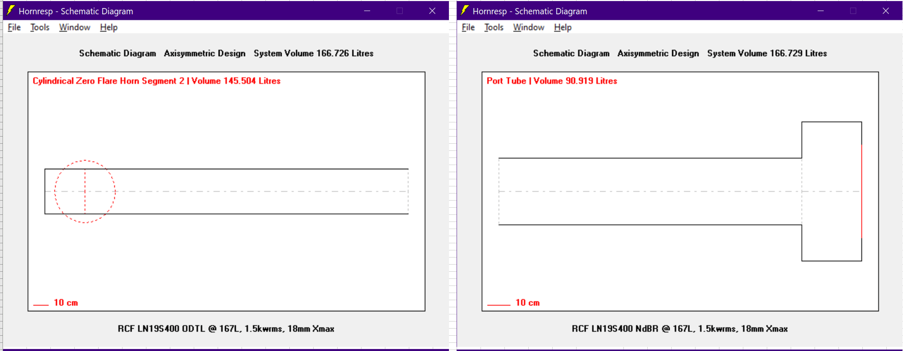

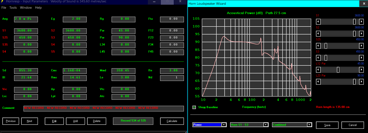

I PHYSICALLY have to use a different function in HR to model a TL than a TH.
There are multiple TH functions in HR due to the PHYSICAL location of the TAP is critical to getting the rear wave and front wave of driver to work as 1 output in series tuned 6th order enclosure.

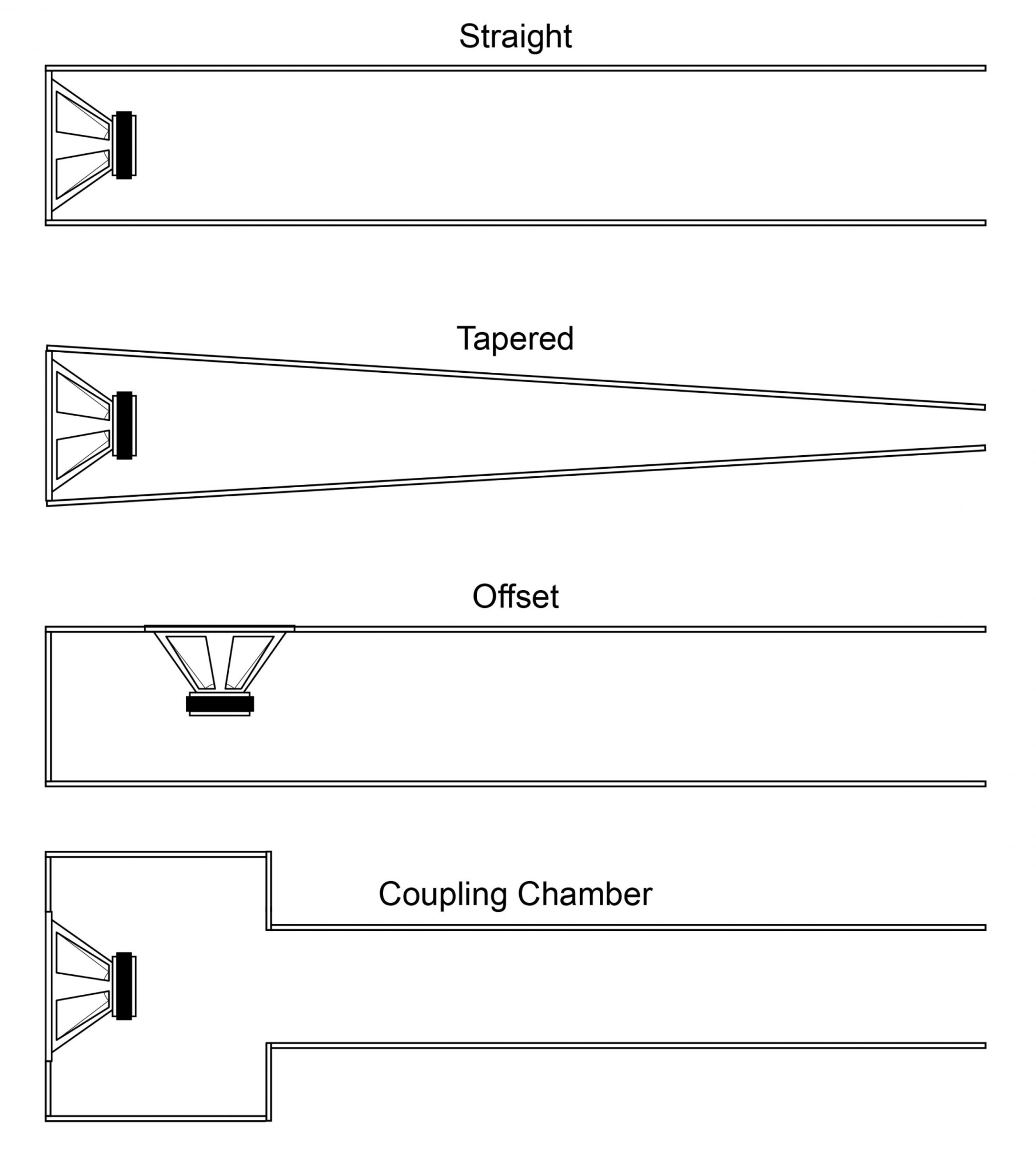

I can use the EXACT SAME function AND inputs in HR to model a standard BR enclosure and Coupling Chamber TL enclosure. The 2 enclosure are PHYSICALLY the same enclosure.
TL doesn't stand for TAPPED line.
TH doesn't stand for TRANSMISSION horn.
BR = 2nd order enclosure.
TL = 2nd order enclosure.
TH = 6th order enclosure.
Do you PHYSICALLY get that?

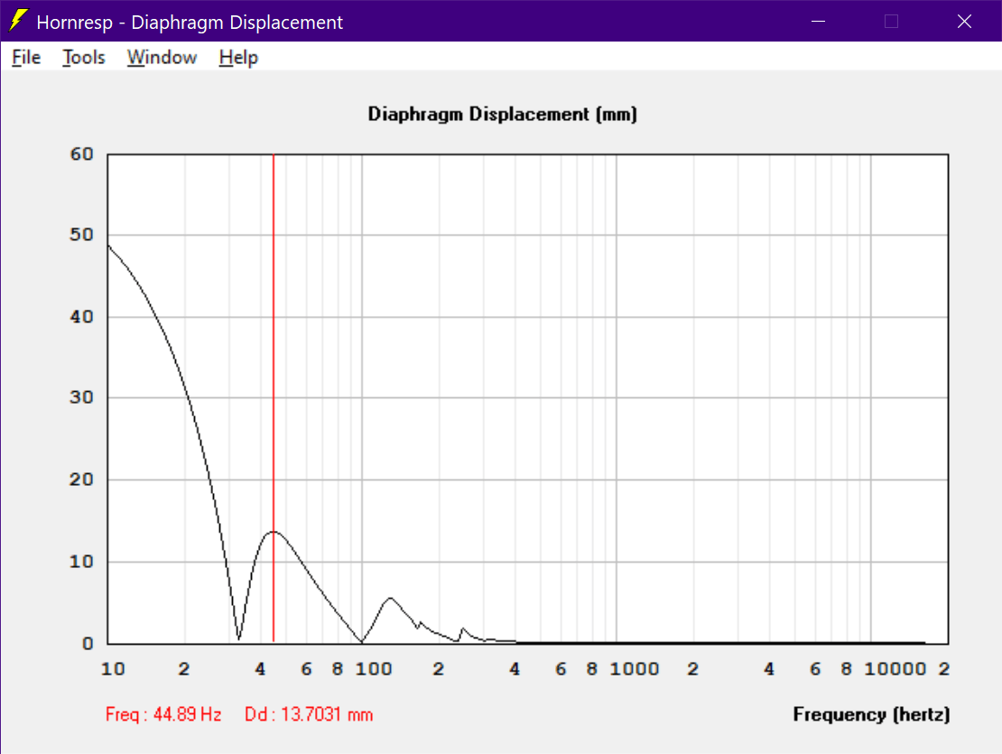

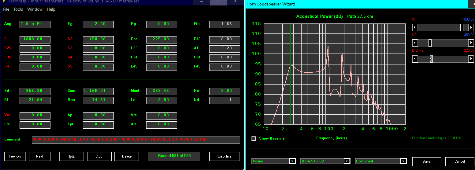

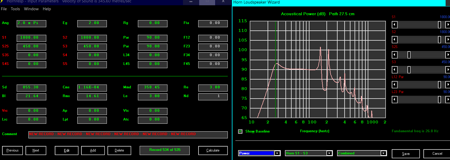

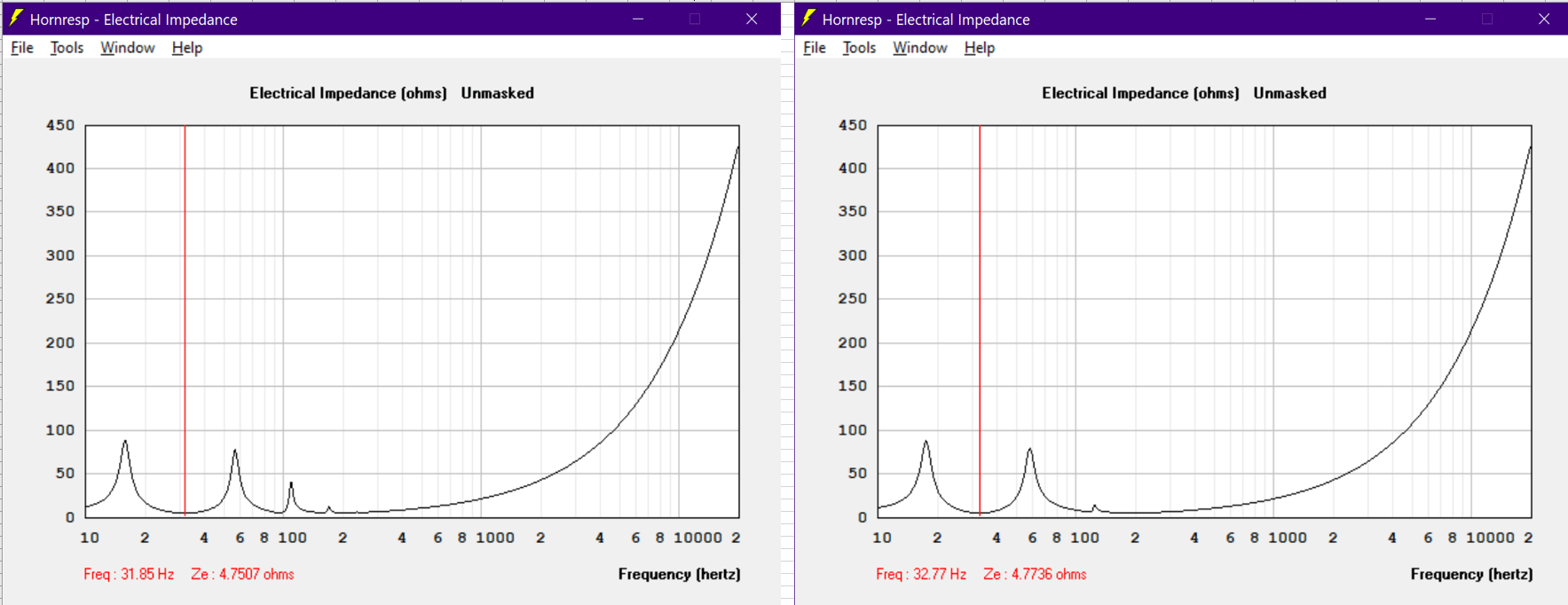

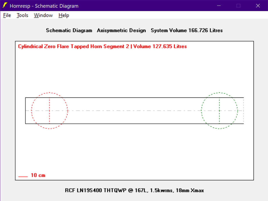

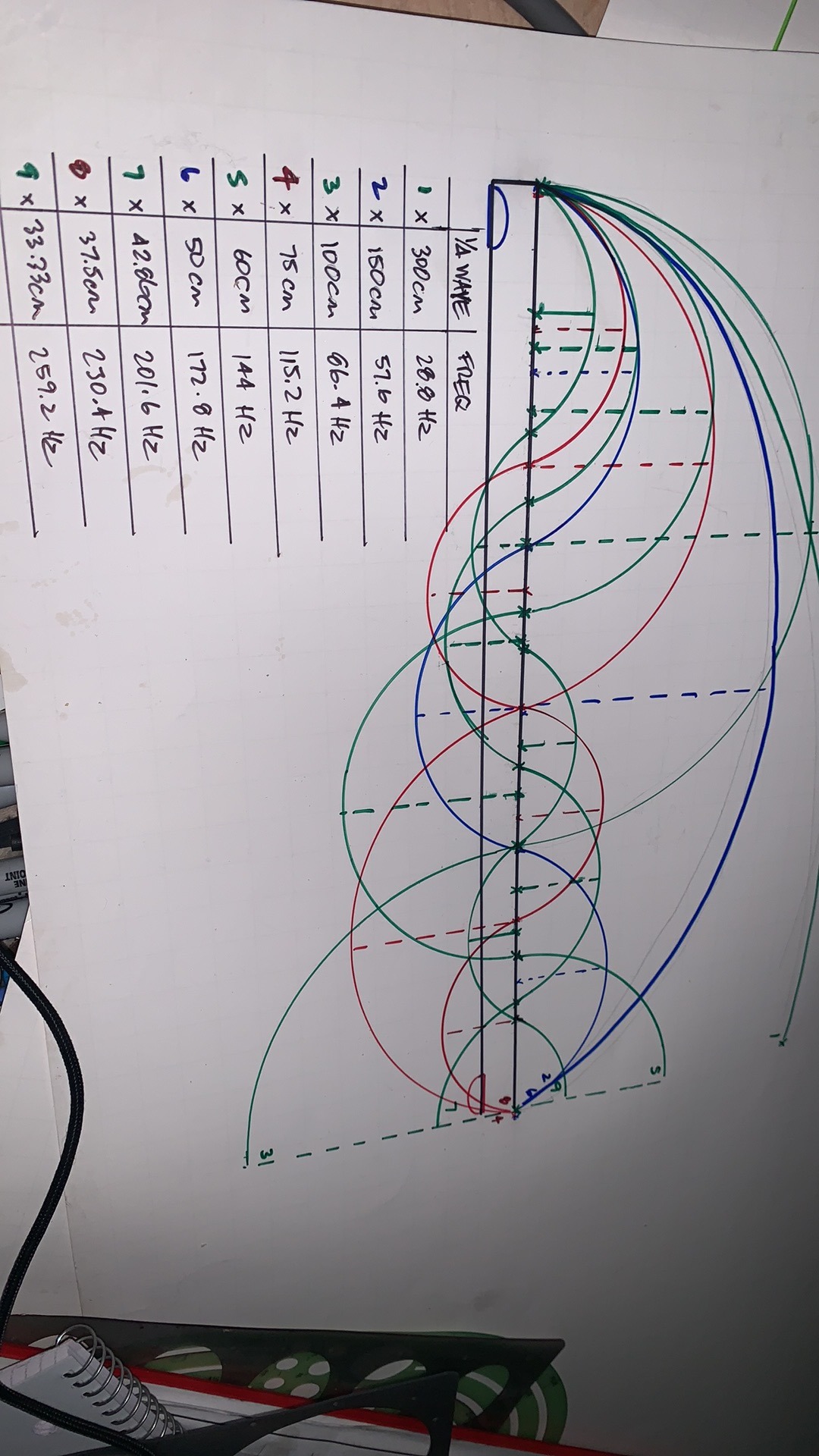

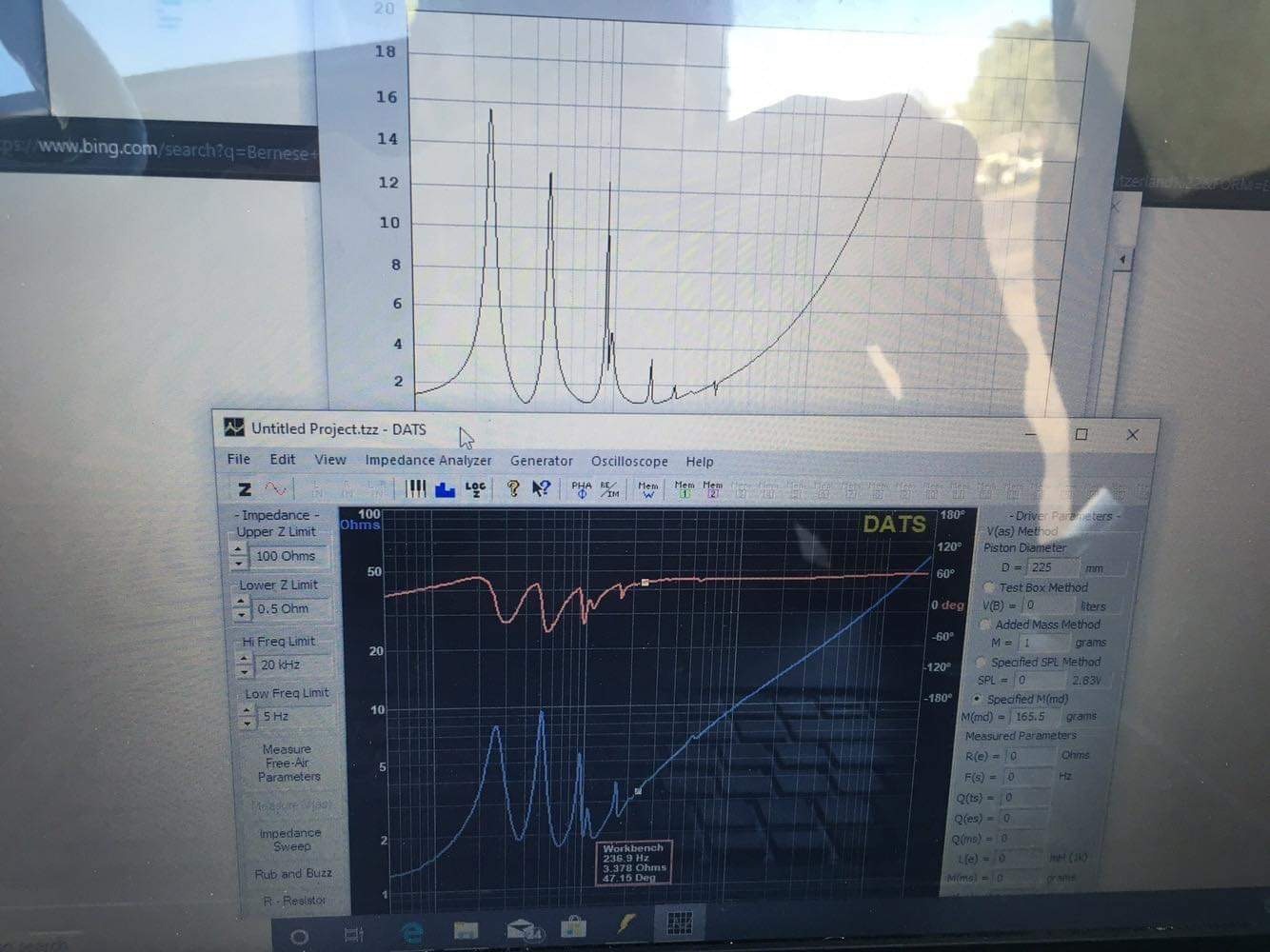

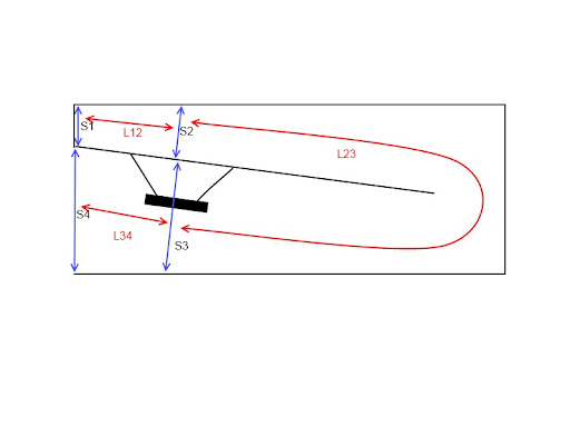

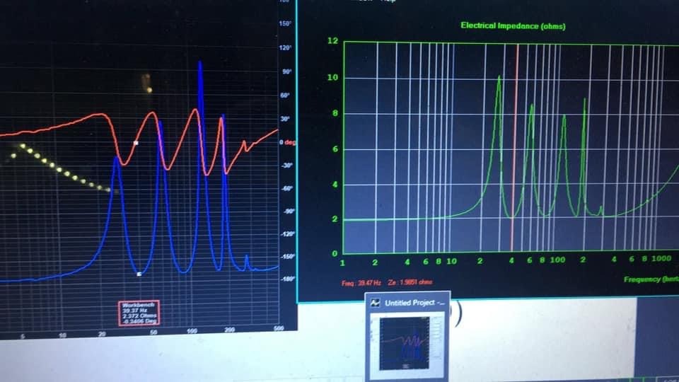

Tapped pipes or TL with the driver inputs at both ends are easy to figure out with pen and paper @ 1/4 wavelength parts of resonances and cancelation freqs that ‘fit’) or horn response for the appropriate length and csa to make a decent subwoofer.
the ‘TL‘ with exit and driver front output seperated merely dilutes this I think ? (Path in horn response)
the front and back wave dont have any choice but to work together at resonace (90 degrees off driver motion) or cancelation (180 out of phase) Or neither (in phase) ?

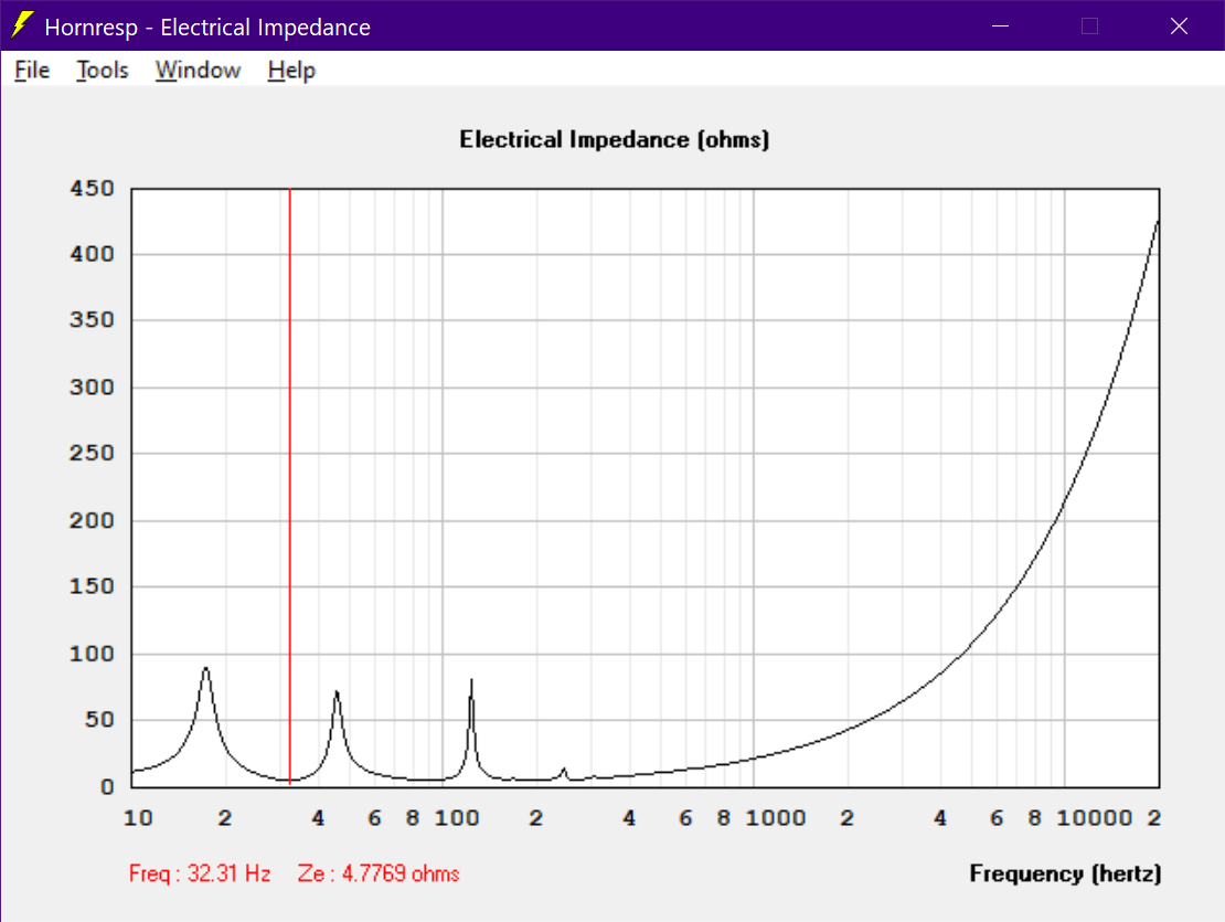

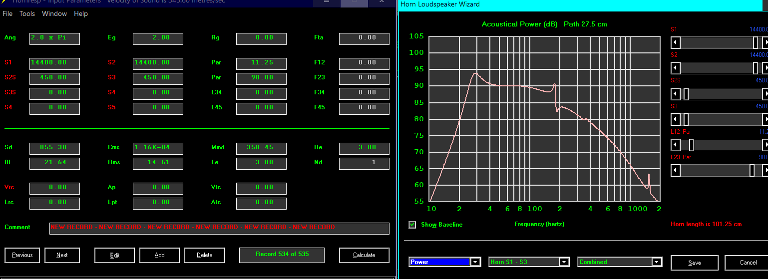

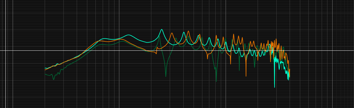

Fb x2,3,4,5,6,7,8,9…, Like a musical instrument or even some antenas? Measure the exit with a microphone (or both) and it’s the same stuff(or try and line up the driver tap from the start to cancel out the second resonance like the orange graph in the REW graph(I came up short on the dark green))

A TL is a 2nd order BR enclosure with a fancy (positive, straight, or negative flare) port.
Both enclosures will look EXACTLY the same internally and externally.
I rest my case.
All you did was stretch a BR box out until pipe resonances and 4/4 cancelation freqs started forming and it’s now a ‘TL’ as a result ?
but sir, The ‘bandpass’ part lost the battle with pipe resonance and funk 🤷‍♂️. You ever hear this stuff Or study it? It sounds goofy as heck and rings …

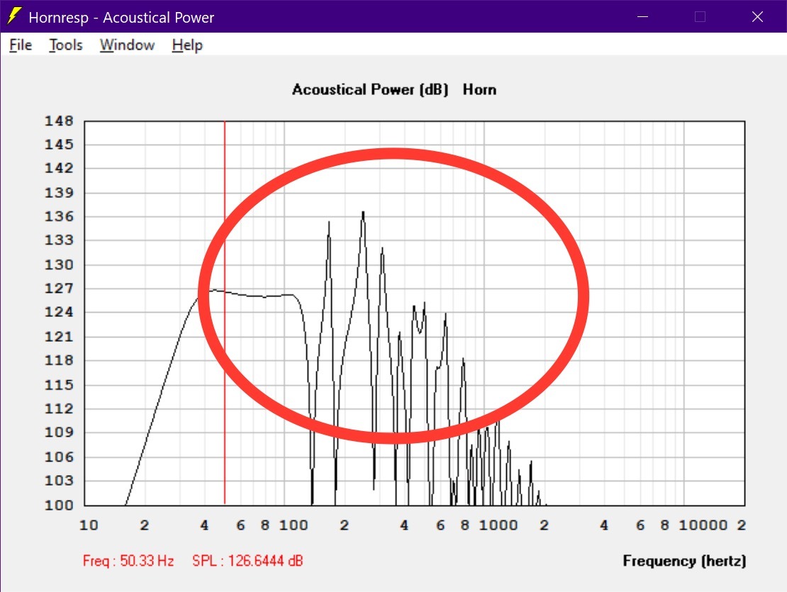

I really don't care what happens above 100hz when modeling a SUBwoofer. Anything after that can be tuned out with DSP, EQ, or higher order low pass filter. And, I KNOW all you Pro Audio folks use all that magic on simple BR enclosures. The same filtering principles can be applied to bandpass enclosures.

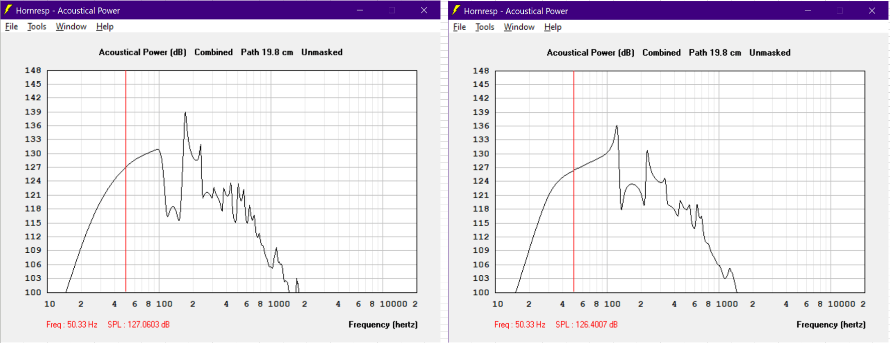

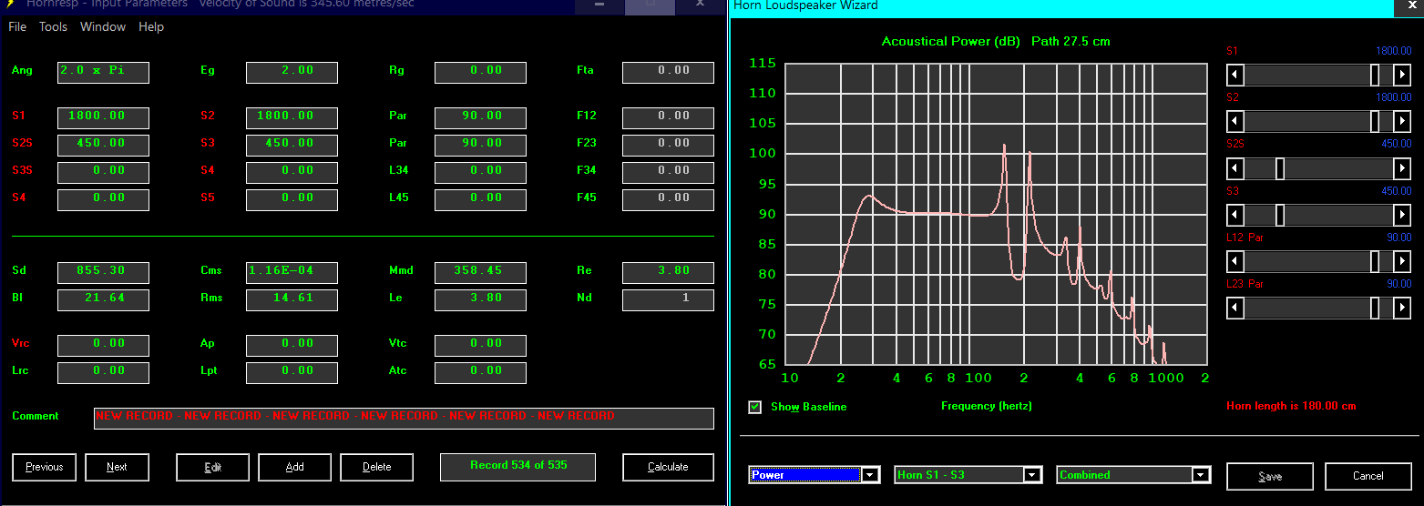

The 45 cm 1/4 wave (3/4) closed pipe resonance in the ‘TL’ becomes a 90 cm open pipe resonance in the BR ? (Or am I overthinking)

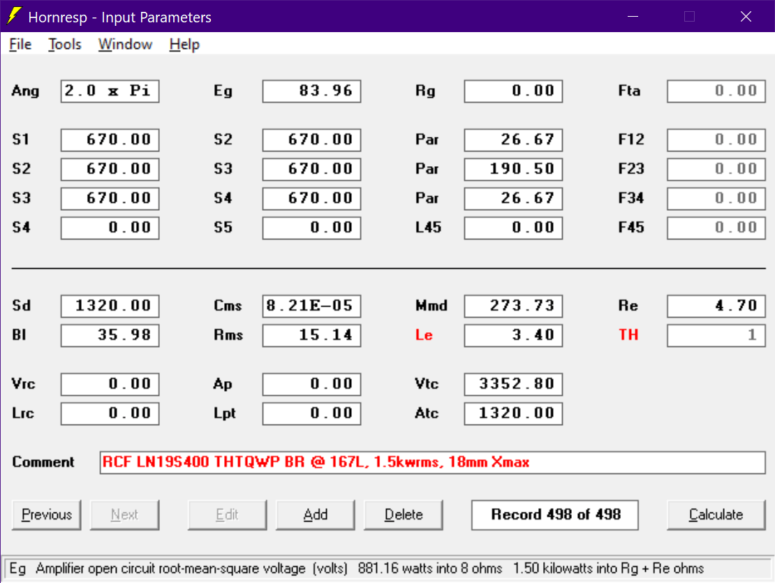

Because they are both 2nd order enclosures!

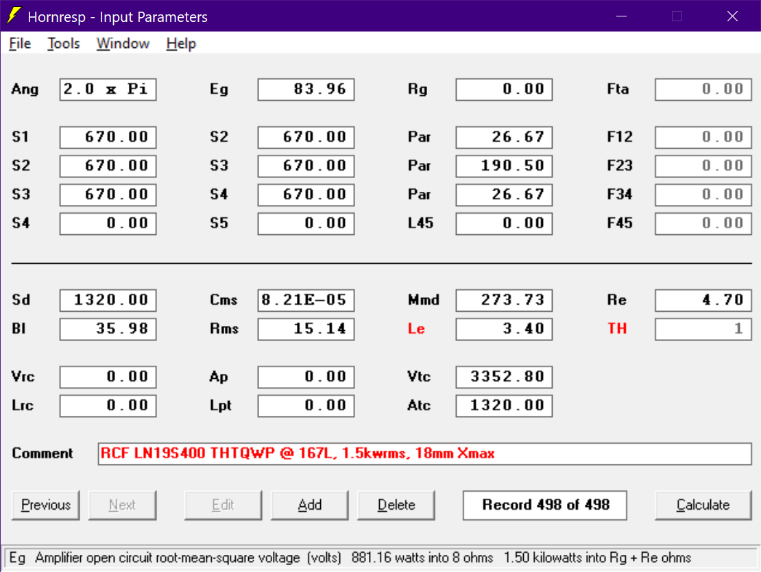

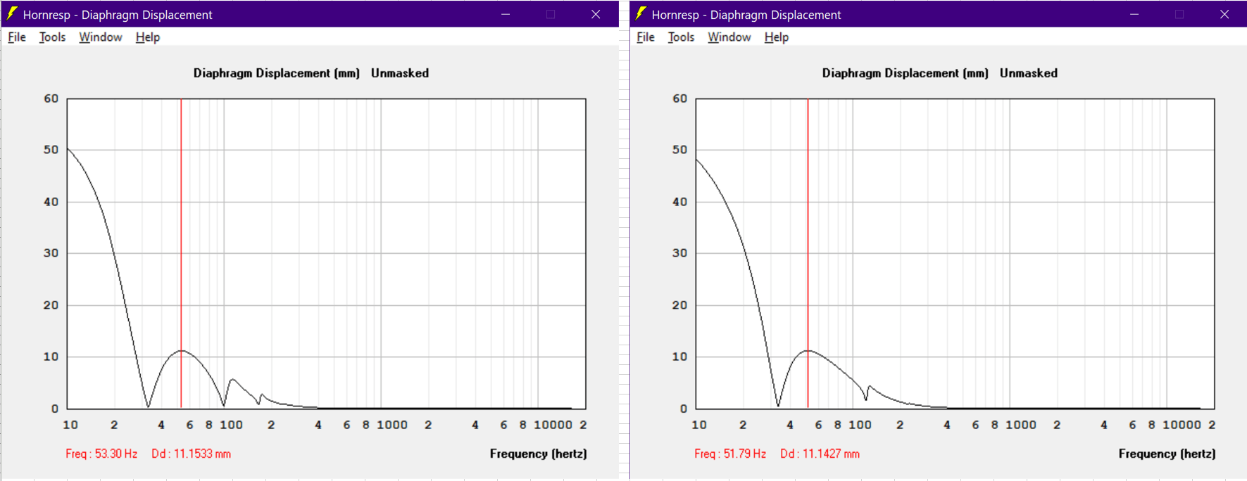

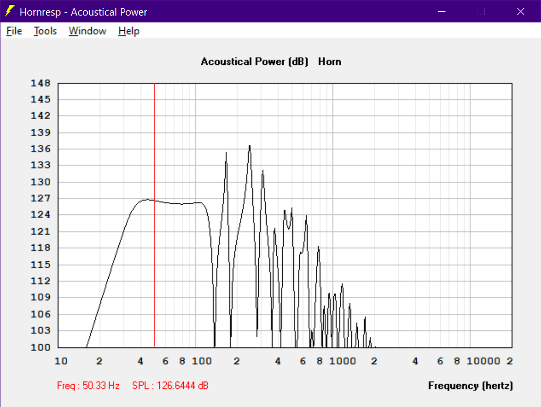

BP4 & FLH are 4th order enclosures.
TH, Keystone, Paraflex, THAM, ROAR, T-TQWT, TappedQWP, and Devastator are 6th order enclosures.
Devastator = BP6Parallel tune.
The other 7 = BP6Series tune.
K.I.S.S!

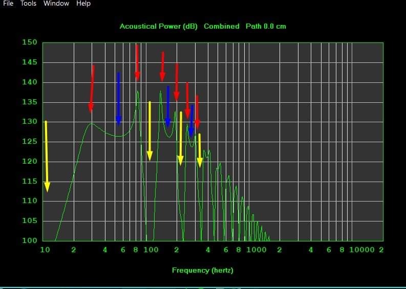

I like to measure my boxes instead of give them funny names and ‘orders’. What ‘orders’ are these And what are they called?
