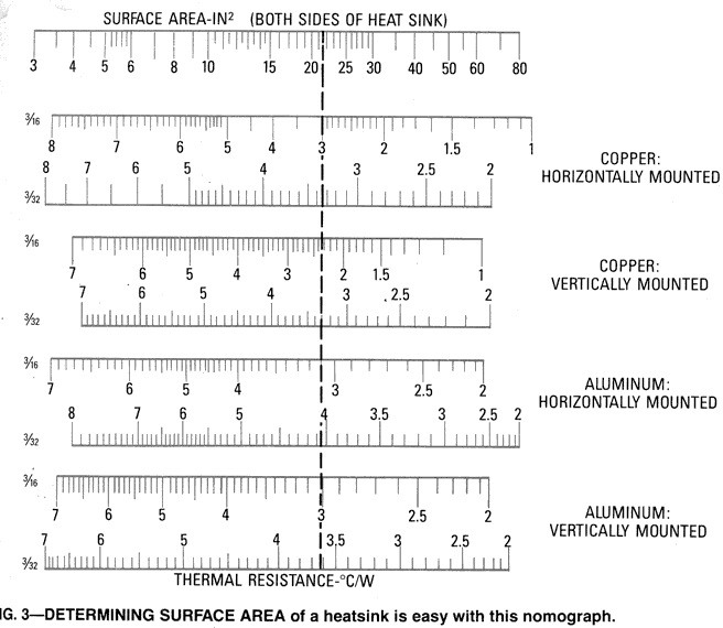

"100 degrees C per Watt per Square Inch."
(Sorry for the antique unit, but I learned this long ago.)
100x50 is 4"x2" or 8 square inches, one side. If both sides get fresh air, 16 square inches. 1 Watt on 16sqin is about 6 deg C rise. 6 Watts is 38 deg rise. This seems OK.
I have often been surprised how hot sinks run from such rule-of-thumb estimates. And 38C rise on your (reasonable for Mexico) 40C ambient makes 78C, which here in Maine is 178 degrees F, which is HOT. Too hot for drinking coffee. Too hot to hold. If it is inside a case it will run hotter. When I did such a thing using the case as heatsink, I didn't like it for live recording because if I carelessly set my hand on it, it hurt.

When I get back to NJ will post a nomograph of heat sink resistance for aluminum and copper -- no access to it right now.
