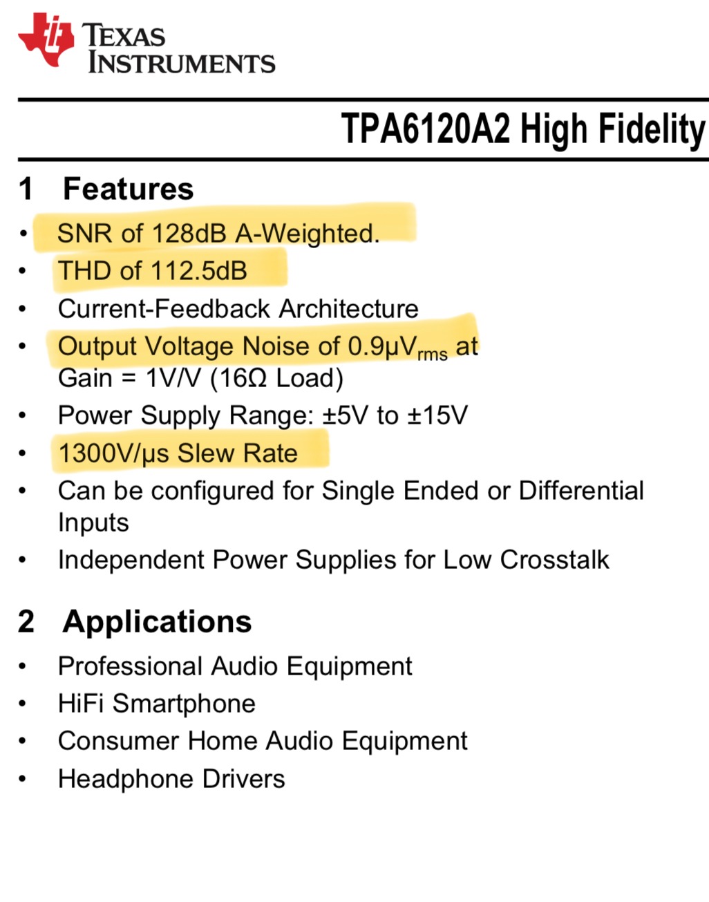

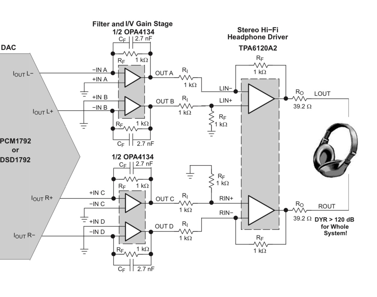

Yes, like the TPA6120A2. Very nice Class AB headphone amp chip with insane slew rate.

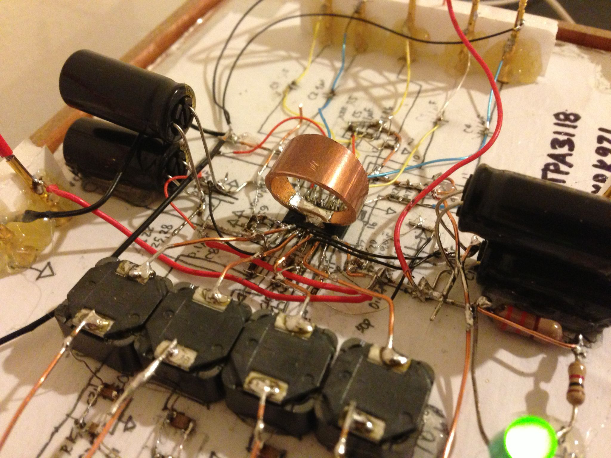

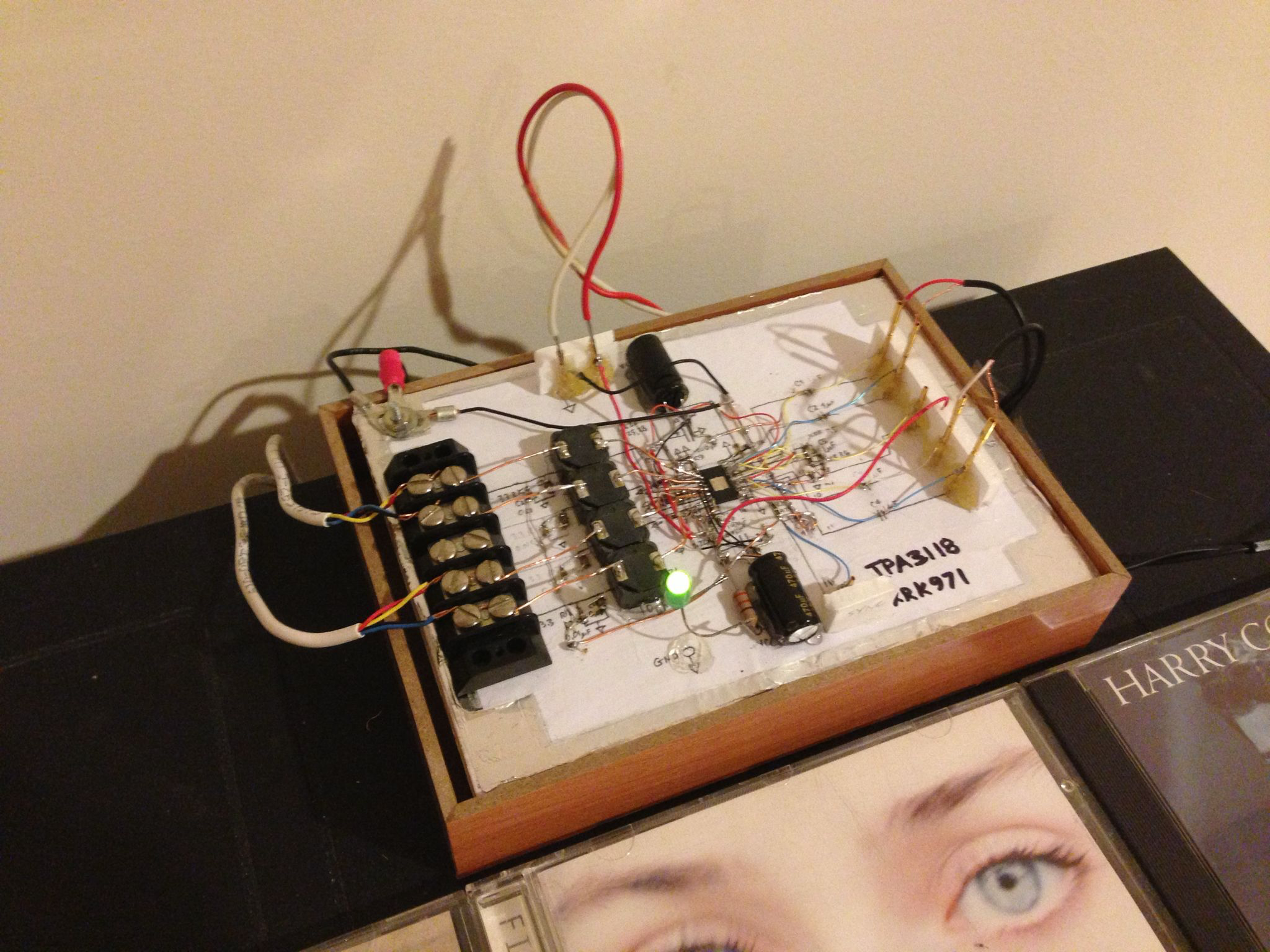

Blast from the past, I just ran across this old photo as I was cleaning up my hard drive. I built a TPA3118 with point to point wiring before cheap Chinese boards were available. This was about 10 years ago.
It was my main amp in the beginning for a while until I got my hands on DUG’s PCB for the TPA3116.

I think you might hear some high freq hash when using Class D for headphones. Having non zero DC offset for sensitive voice coils and requiring balanced separate lines to each can causes some complications. One mistake - and turn on thump from TPA3116 can instantly fry your voice coil. I do not recommend pursuing this when TPA6120A2 chip is infinitely superior in every way for a HPA.
$2.29ea at Mouser and thousands in stock.

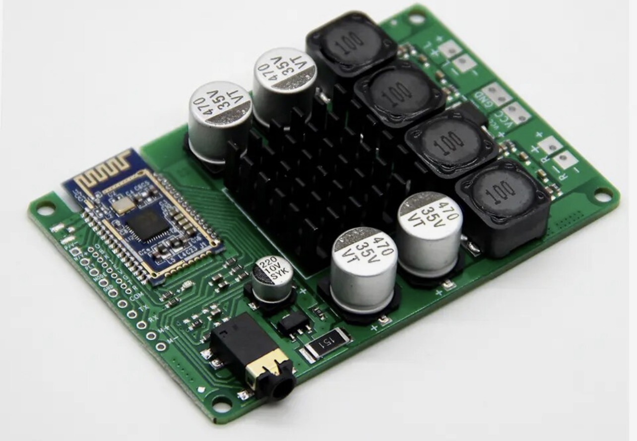

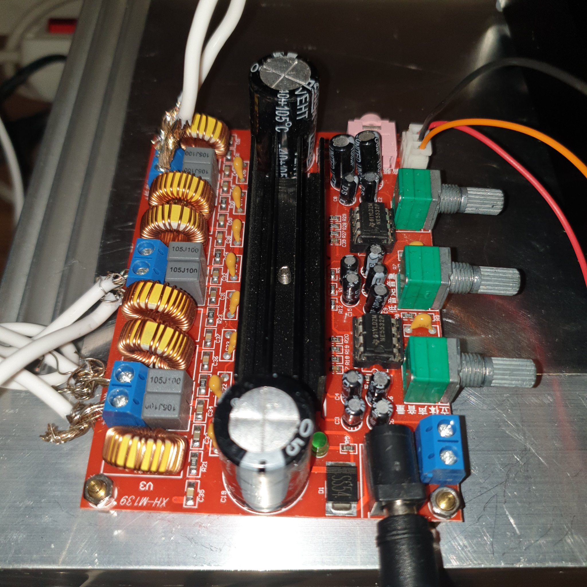

Hi.I have this version of tpa3116d2
https://www.aliexpress.us/item/3256...martRedirect=y&gatewayAdapt=glo2usa4itemAdapt
Is it ok to leave subwoofer output unconnected and work only 2 channels? Will it damage the sub output? ( i have irs2092 2x500w amp, i did not connect the outputs and it smelled and after that i read outputs should not be left unconnected)
As I can see from the back side of the board and the "choice" ;) "Other chip" the chips are SOAP-16 meaning "domestic professional chip" rebaged as TPA3116D2 with the heat contacting surface at the bottom side of the chip. I have an amplifier with this chip (probably the CS8673E - NOT a bad one) but you have to do your homework to listen clear not screaming "hies".
For 8 Ohm drivers worked for me with 22nH ( marked as 220) and replacement of the ceramic bootstrap capacitors (4 pcs for stereo) with non-polarity MUSE (Nichicon) 1μF/50V . During test I left many times one of the outputs "open" and nothing bad happen (Supply Voltage 19.2VDC, A laptop brick) but "that surgery" is very tricky to left the cooper tracks "as they should be"
Elias
Reactions: 1 user

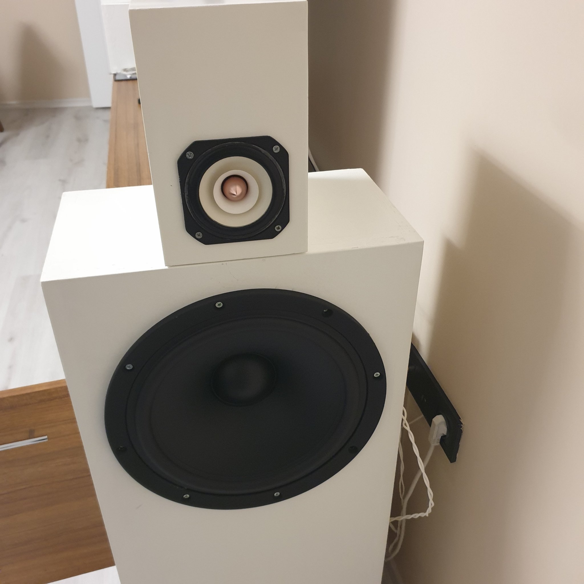

Oh I did not know that they use another chip ( I saw some versions in last days they make selection original chip and domestic chip ) If it sound as good as original chip it is no problem for me :) I connected all outputs ( PTFE speaker cables very thick so it looks bad now sorry but they do not touch eachother lol) and sound is good now with 20v 3a Topping adapter. There is no problem.
When listening class d ta2022 I said it sounds good but when switched to an amplifier like Jlh it sounds different and better imo.
Now it is playing 2+1 but there is too much cables. I should build something on the back of the my woofer towers ,it is better for waf. It will also be a 2.2 system and system should be altogether with crossovers and be small as possible
