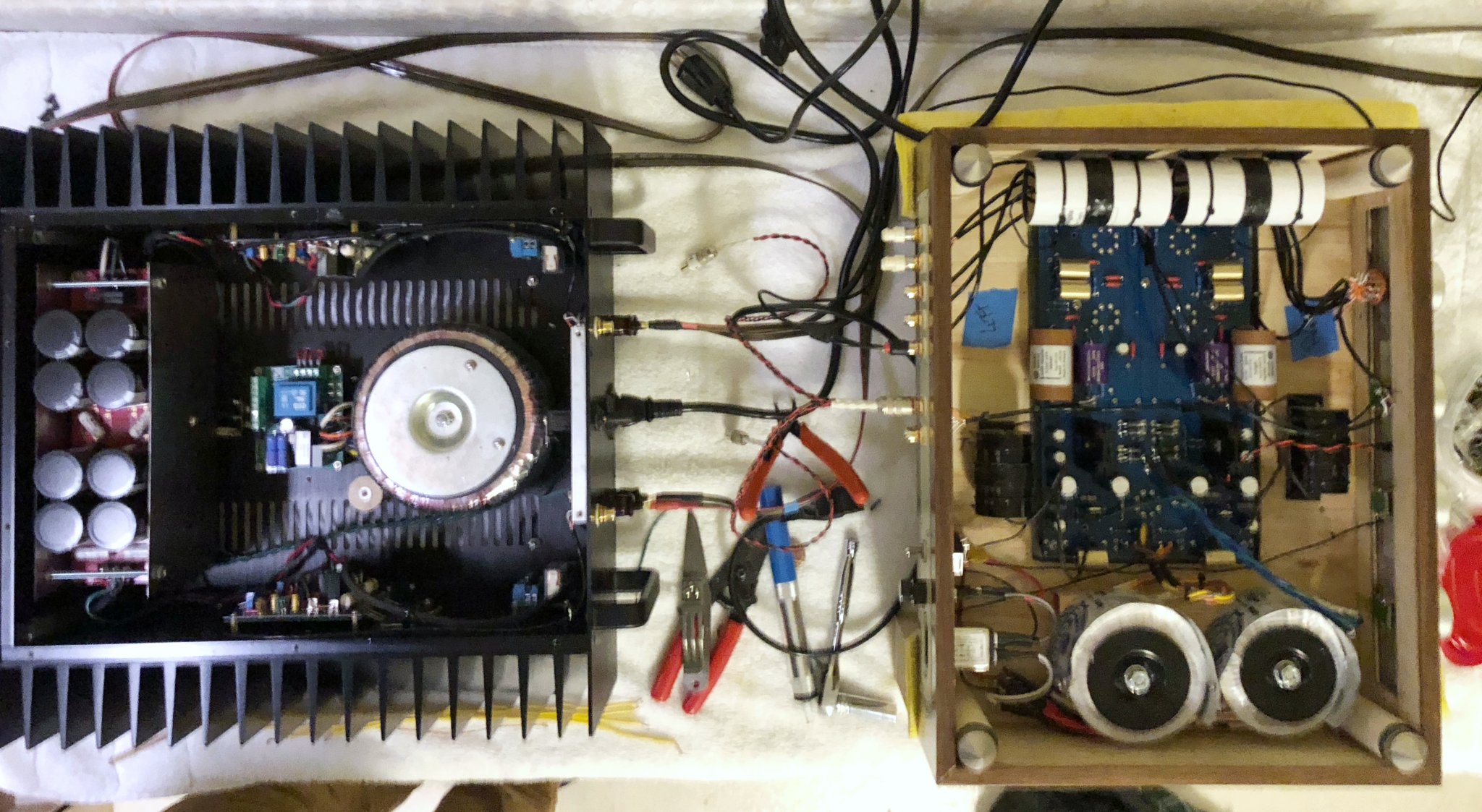

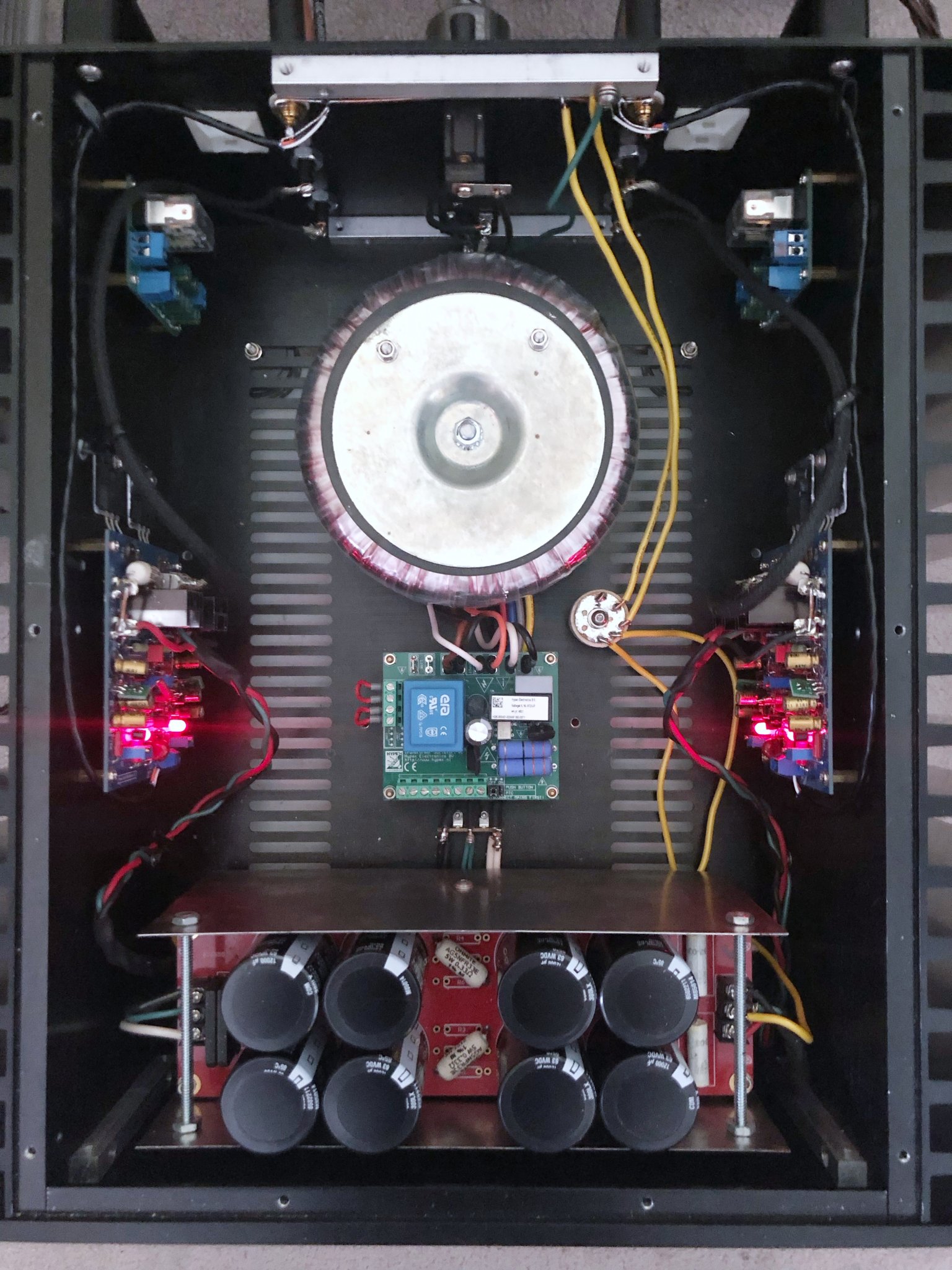

Here is a photo of the Hiraga
IEC ground goes to chassis, and from chassis to the star ground.
Star ground is isolated from the chassis
RCA input grounds are tied together, and go to start ground.

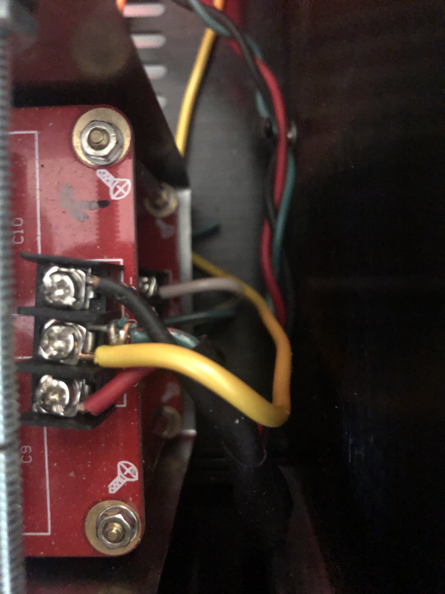

Center of each of the two power supply boards go to the star ground, and to the power supply in on the amp boards from the power supply boards. It’s difficult to see from the closeup, but there are two wires from the center - yellow and green
Shield around the power supply boards is grounded to the chassis

If I use the same power cord that is on the VFet (no ground) on the Hiraga, the noise returns at the same level as with a regular power cable.
Going to take me a second to digest the preamp grounding protocol you’re suggesting. As a visual thinker, I need to draw it out
If I use my Adcom GFA545 with the preamp, I have the same issue w noise - and it only has a two prong power cord.
The signal ground is attached to the PCB in two places. The ground bus wire of the RCA input/output (single wire from bus to board), and the ground from the volume pot goes to the signal input on the PCB
The power ground is connected to the PCB from the chassis/star ground. The star ground has the front, top and rear panels connected to it, as well as the power/earth, the transformer grounds and the PCB ground.
