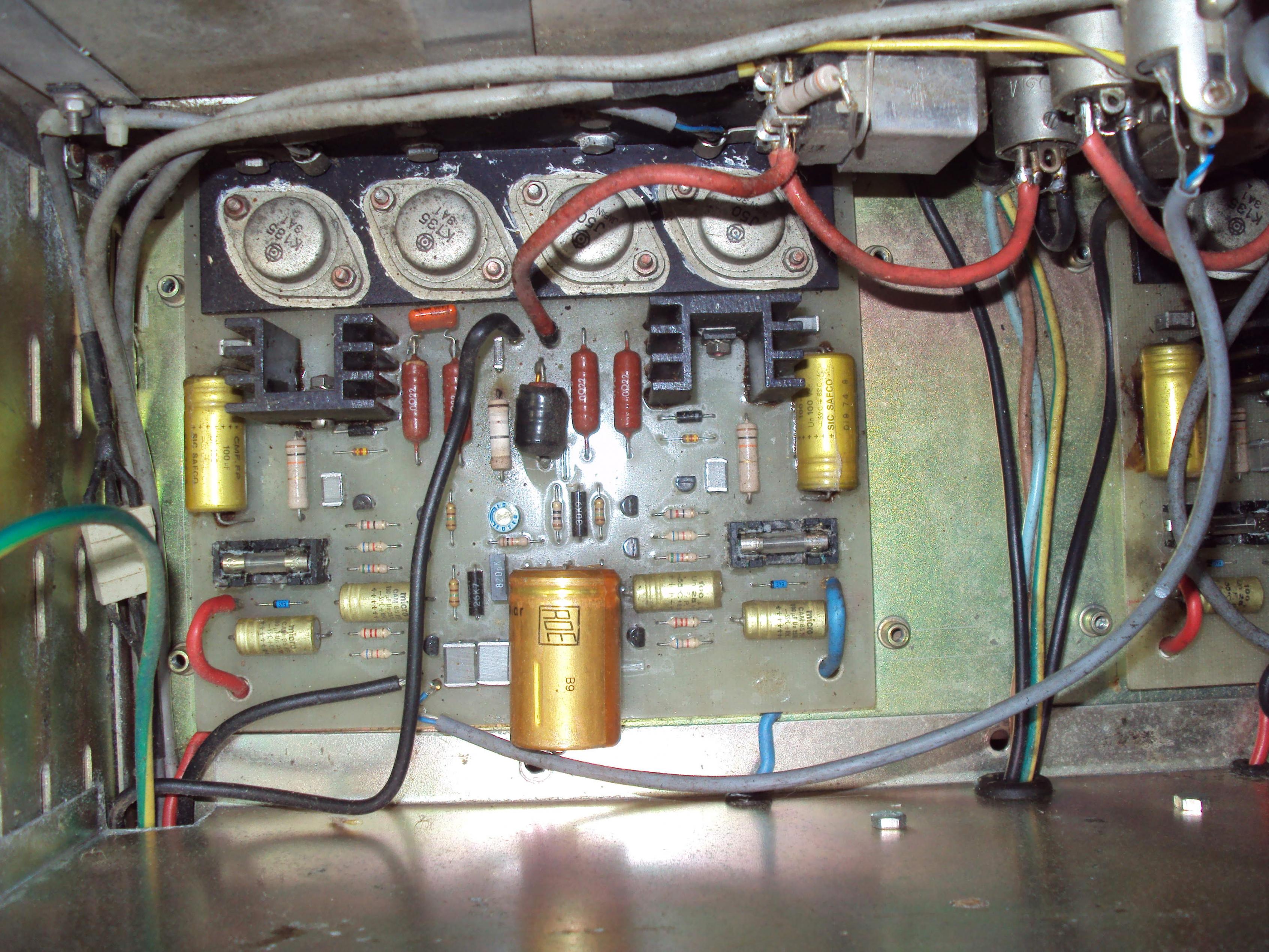

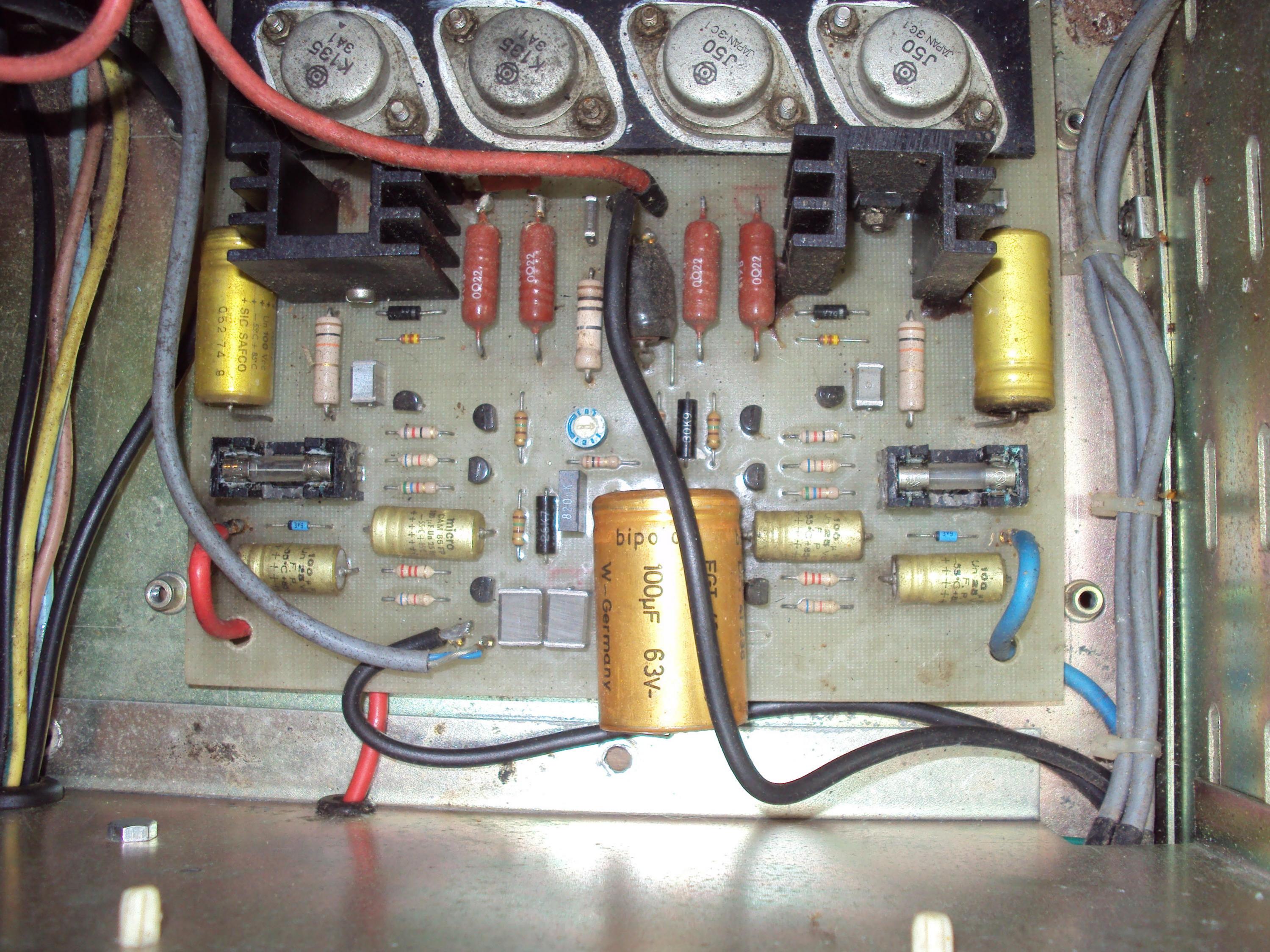

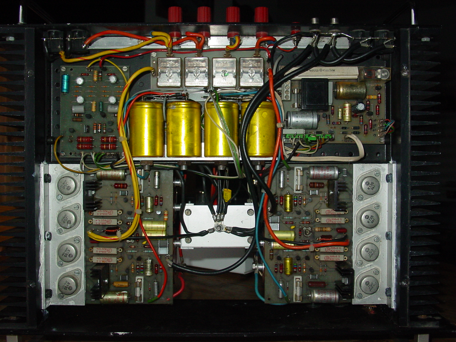

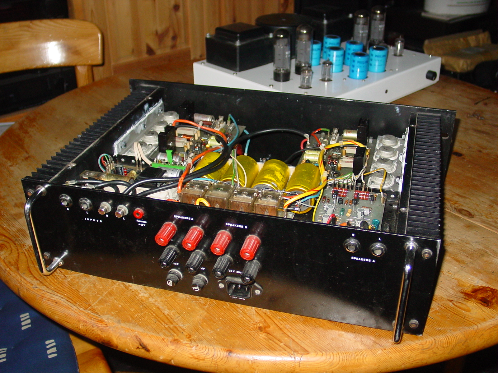

Hi dungdochi,
finally here are some pics of my CRESCENDO stereo power amp. Have fun and thanks for waiting!

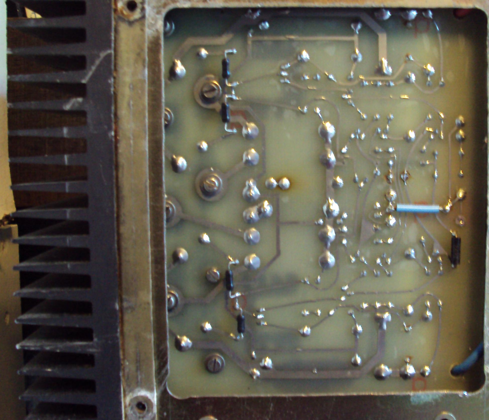

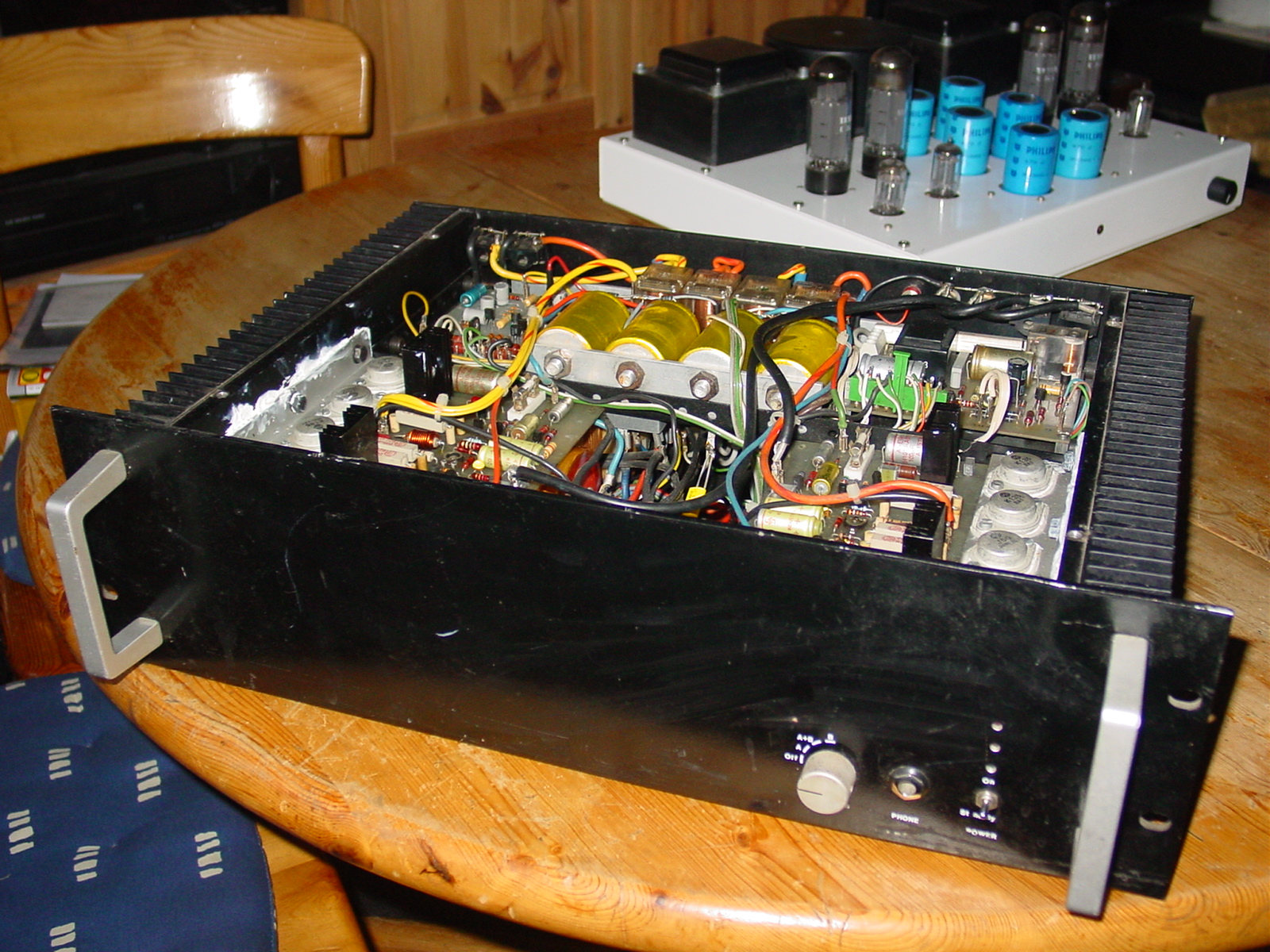

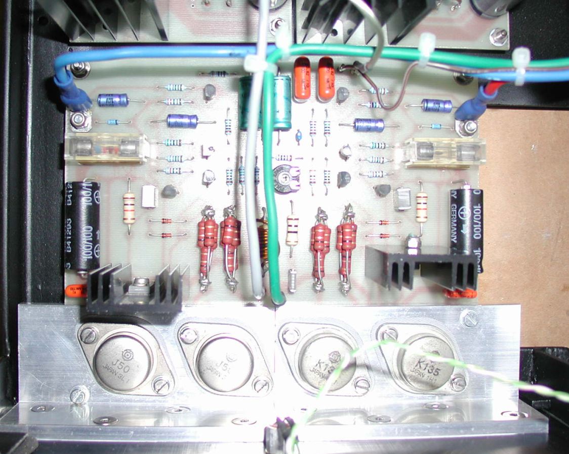

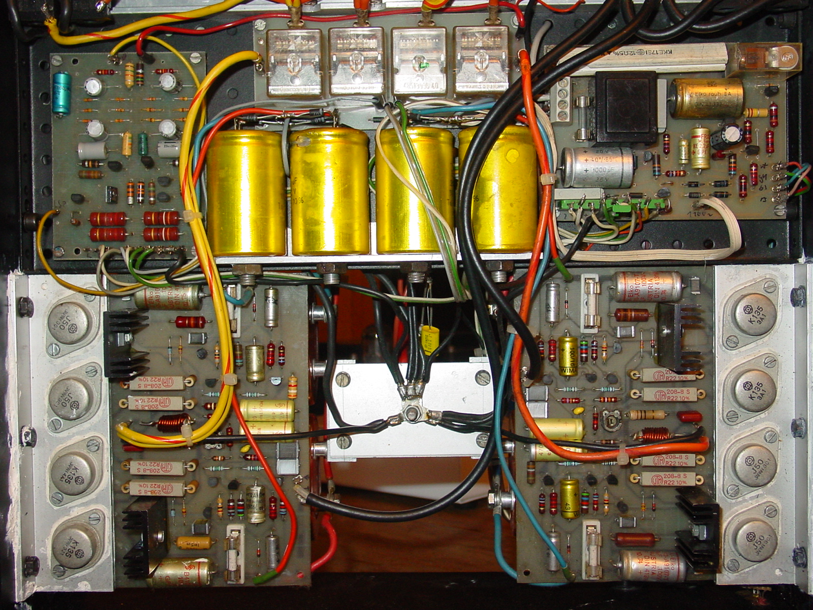

I did it in 83/84 and used it for 10 years, then I moved in a little house where I didn't have room enough to host it... the beast is huge and heavy 30kg...

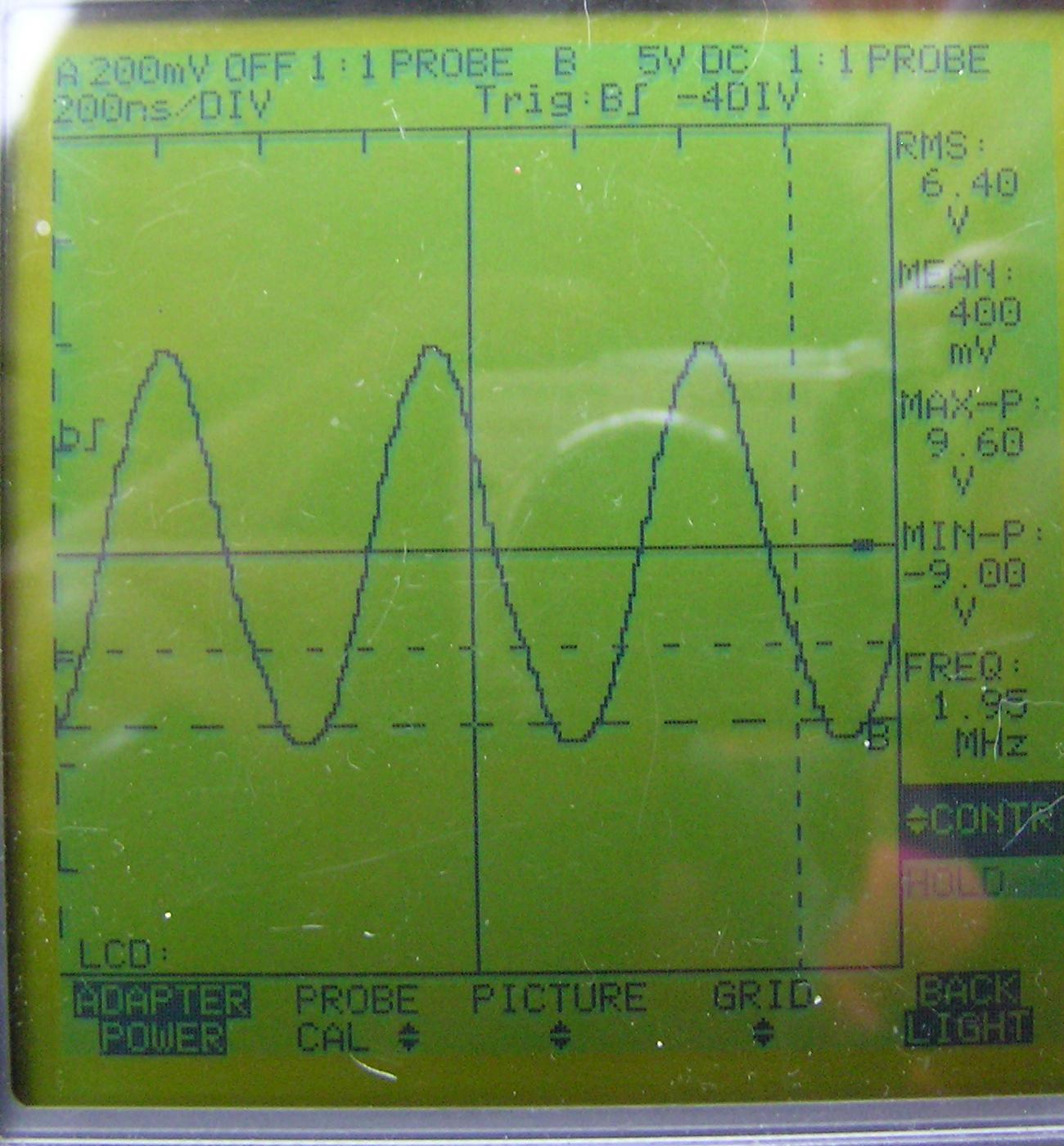

Some days ago I decided to bring it back to life after a 15 years sleep in the idea to use it as the bass amp for an active 3 ways system around a DCX2496, but I noticed after removing the dust that there was hum in the speakers as soon as I plugged in the second input, left or right. I broke the ground in one cable and also isolated the earth.... still same behaviour... the I saw R32 comes very hot when I plug the output wires (checked for short-cuts)... although, the amp works on both channel even together, and DC out seems OK on one (20mV) and the other seems to near to zero to be honest
I never watched the outputs with a scope so I asked a friend to lend me one and I saw a "nice" 2MHz sinus as soon as I plug a wire on the outputs, even with-w/o the speakers... and even with the passive filters .
My amp is a bit tweaked: I didn't wired the 470VA transfos like in Elektor. Instead I used one for each channel with the idea to be able later to have the two channels completely independent from each other.
Any advise please?
Thank you in advance.

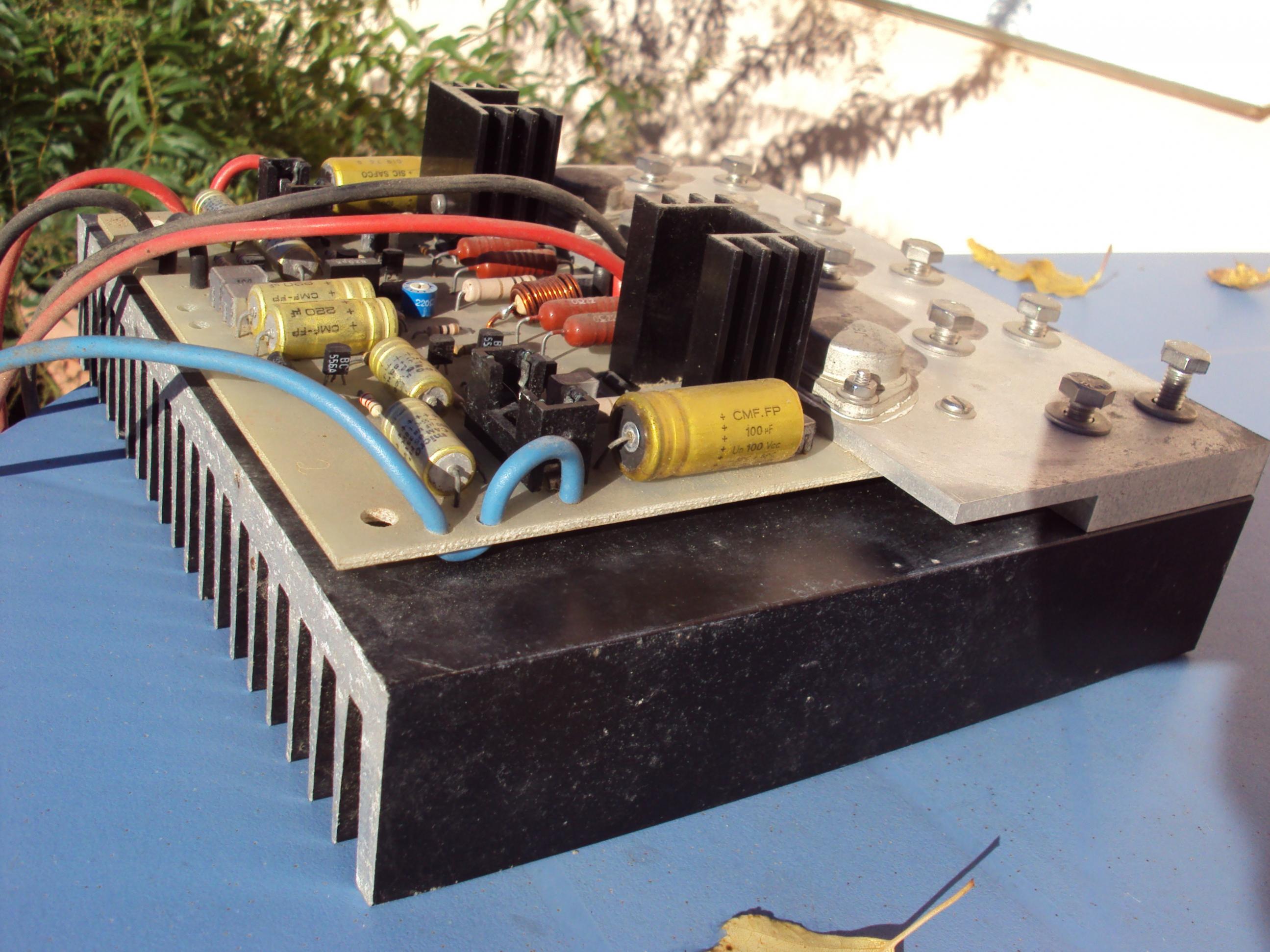

[Edit]
R32 on left channel rosted (one whole night under oscillation condition) the CF4 24/10mm stained 70µm copper.

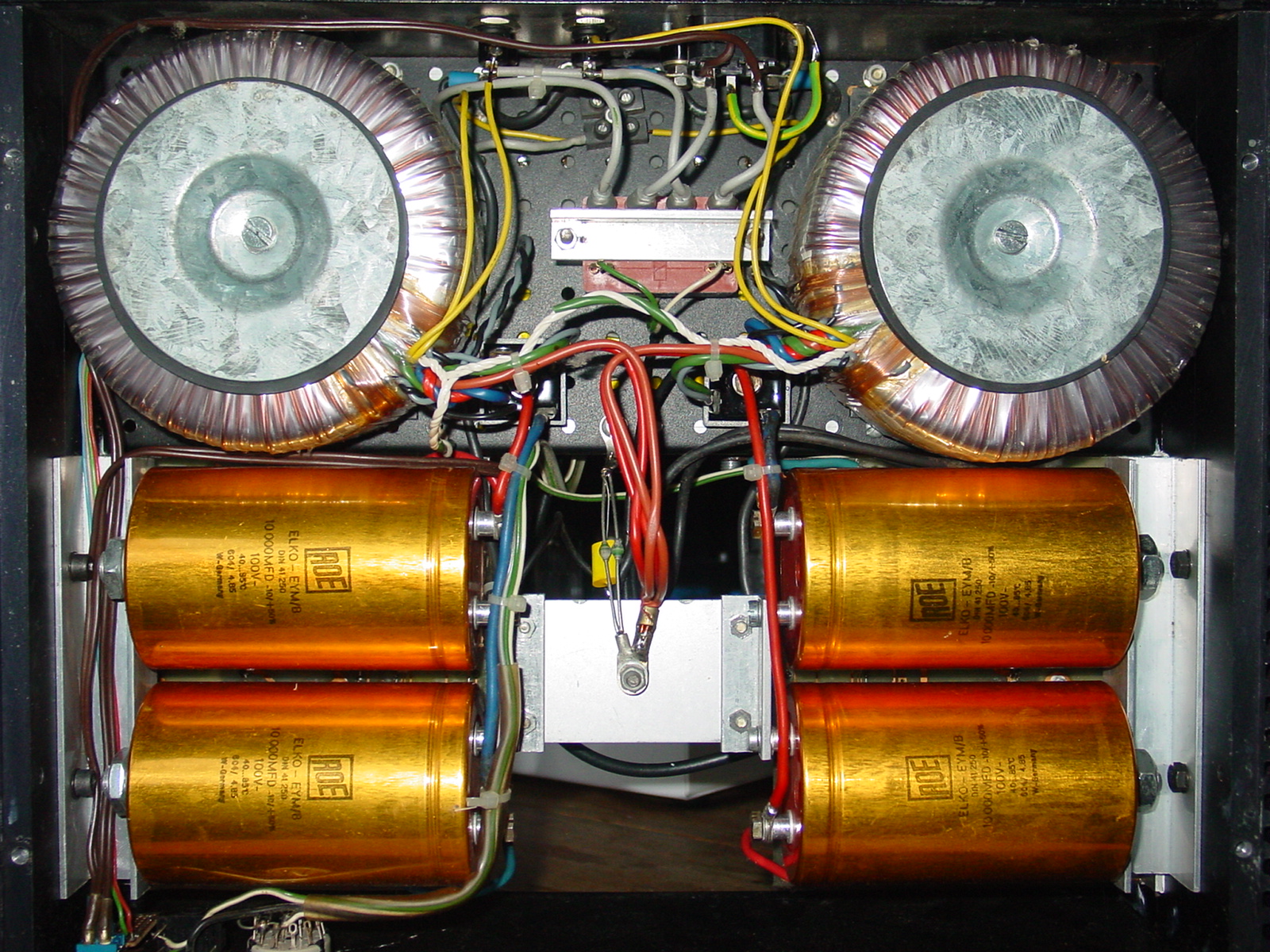

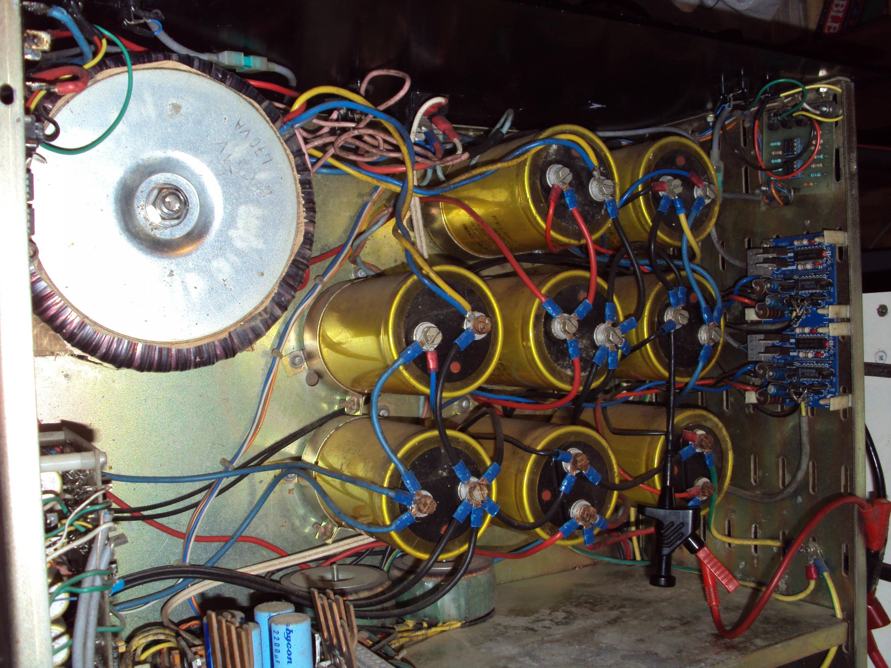

Added pictures of :
The supply: 4 rails 20mF/100V each (on the right bottom corner, the central and single link between left/right ground, case and earth
The CF4 side
A different build with the same heatsink (parallel instead of right angle) I never tried, more compact but harder to maintain (heat tranfert aluminium piece 4mm under mosfets and 12mm over the heatsink)

Welcome to DiyAudio!
If I see it correct, you are definitely using wirewound source resistors (0R22).
These are causing on all Crescendo's oscilation.
You should swap them to inductive free resistors (e.g. MPC71), or use 4 carbon resistors (also inductive free) as I did.
