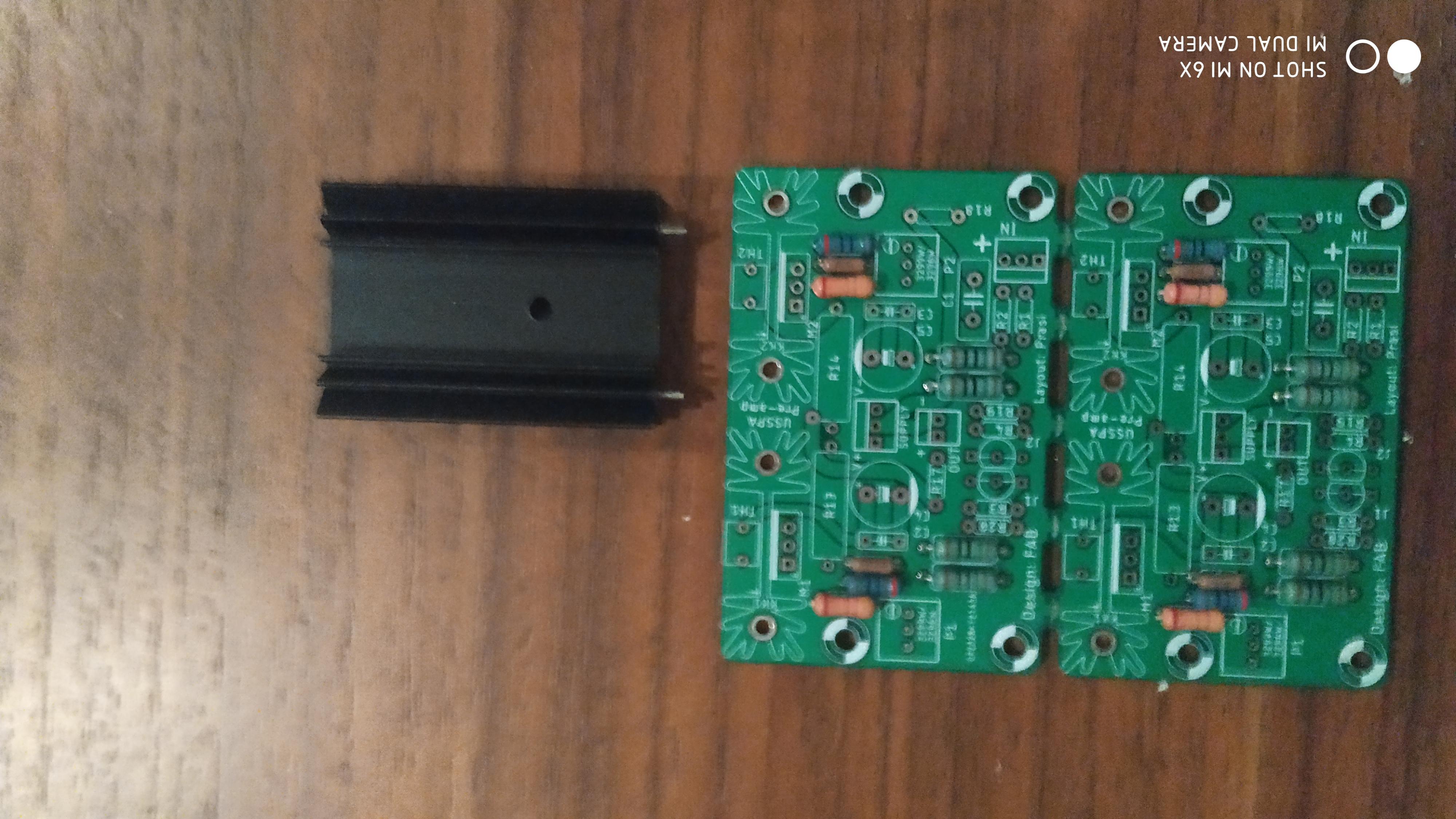

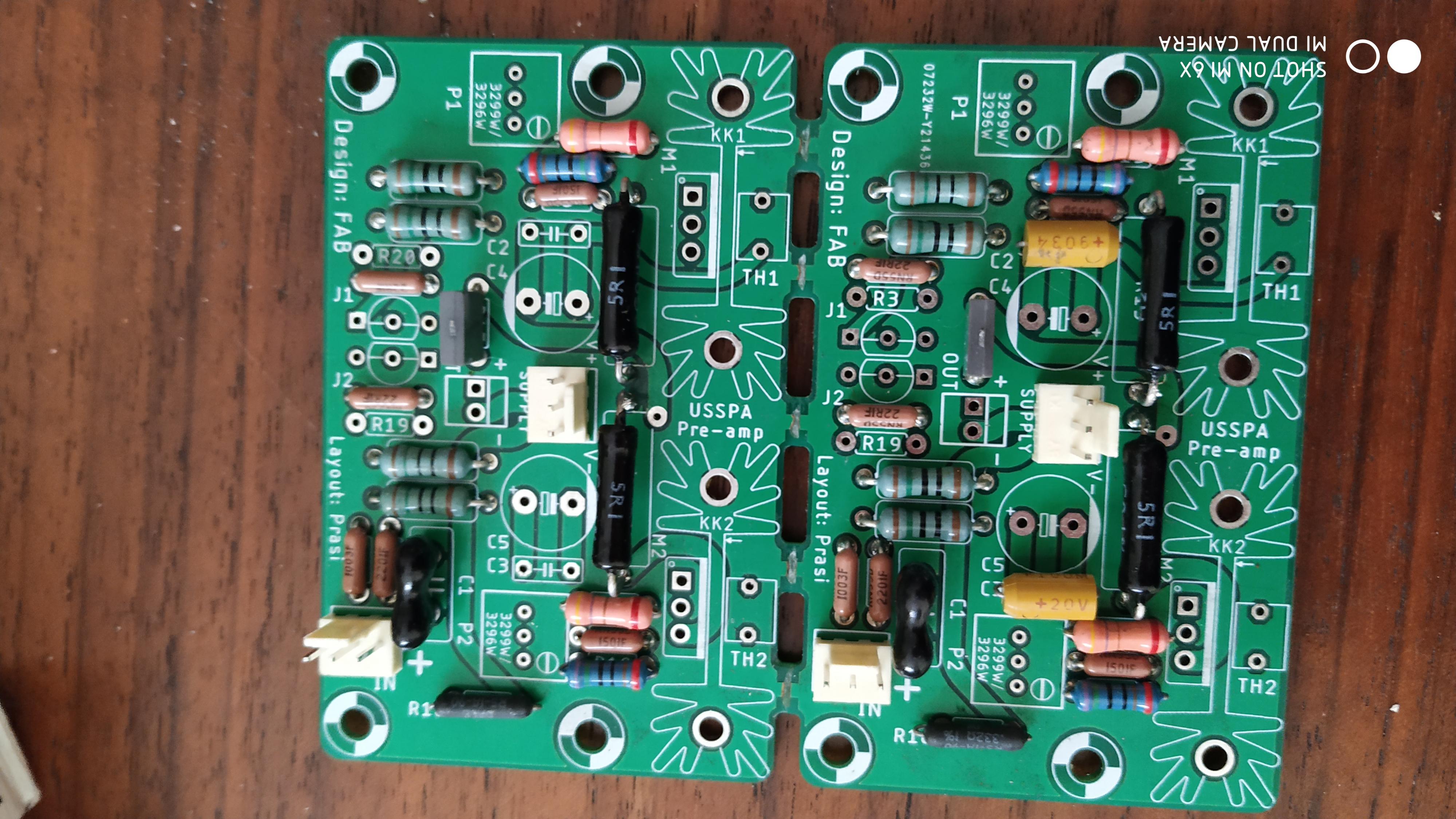

I came across this interesting preamplifier. Ultra simple symetrical preamplifier by fabaudio. I couldn't find any open group buy for it and contacted Fab direct and he graciously let me have the pcb. Thank you Fab.
This is an extremely exciting project for me because my buddy have all the transistors in stock. And he kept raving about them. But hey.. Where is the fishished goods?? IMG_20190628_200843.jpg Fab have a great design.. Let's do it!

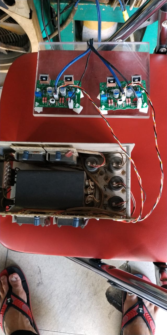

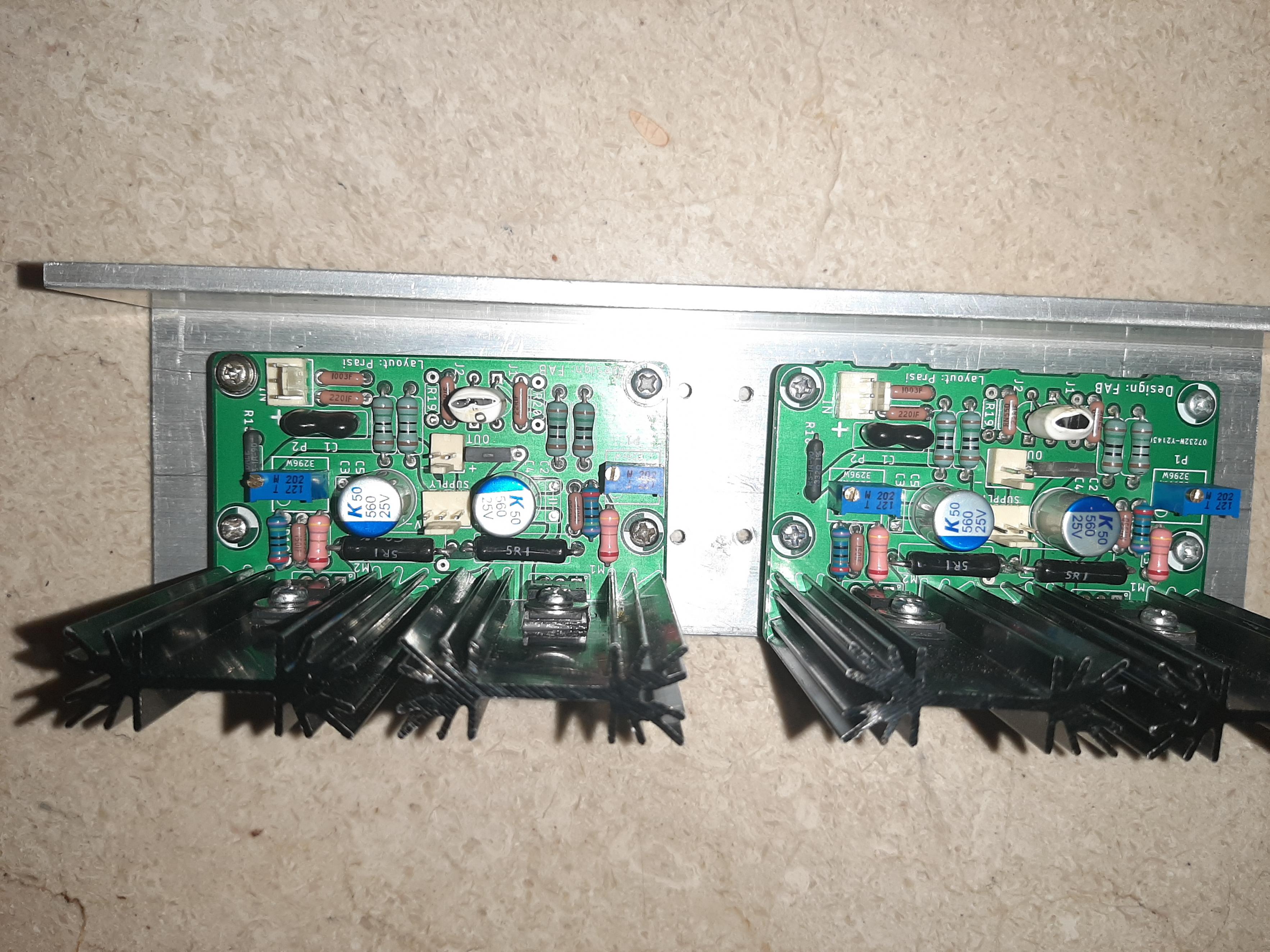

Happy to find a great heat sink locally. Start populating the board
Some of the parts is non existance locally
Like the cap and feedback R. Waiting for them. I like to use carbon film for gate resistors especially with mosfets and with my experience the sound is much more heavy and musical . The rest will be a mix of quality parts.

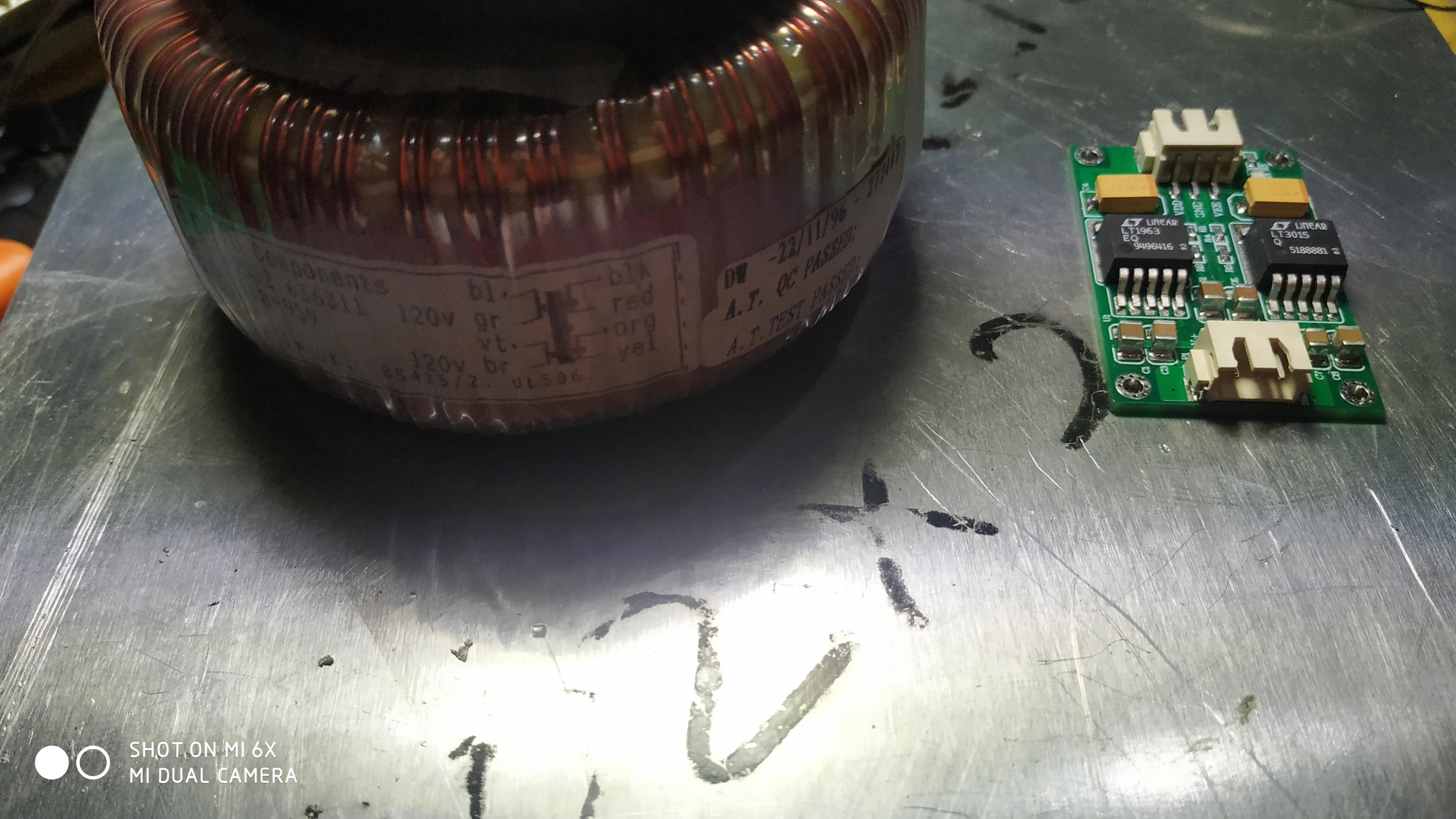

Talema toroid is ready and I'm also waiting for the supply module. I prefer lt 1963 lt 3015. As it have a good mix of quietness, dynamism and pssr. Yet will not dry out the music, ringing etc. I use them successfully in a few projects. I had tried alot.
Depending on the shipment. I will update accordingly
Chiao
Anthony

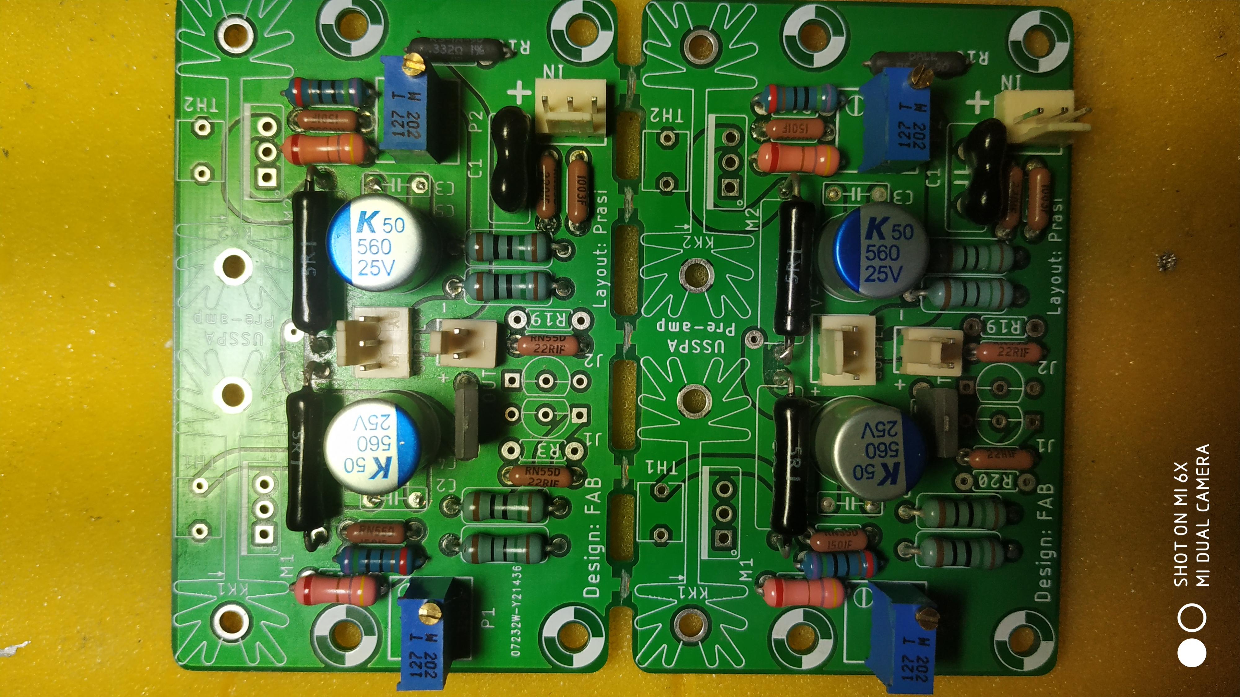

Transformer ready. Rs. Which is high quality. And i got this favourite ic. Well if its suitable. Will get 2 for dual mono.
I may run it 15v or 17v depending how it sounds
Already have both super through or mundorf main cap. Will try both to see which one better. I would probably use schottky diodes. Also depends how it sounds

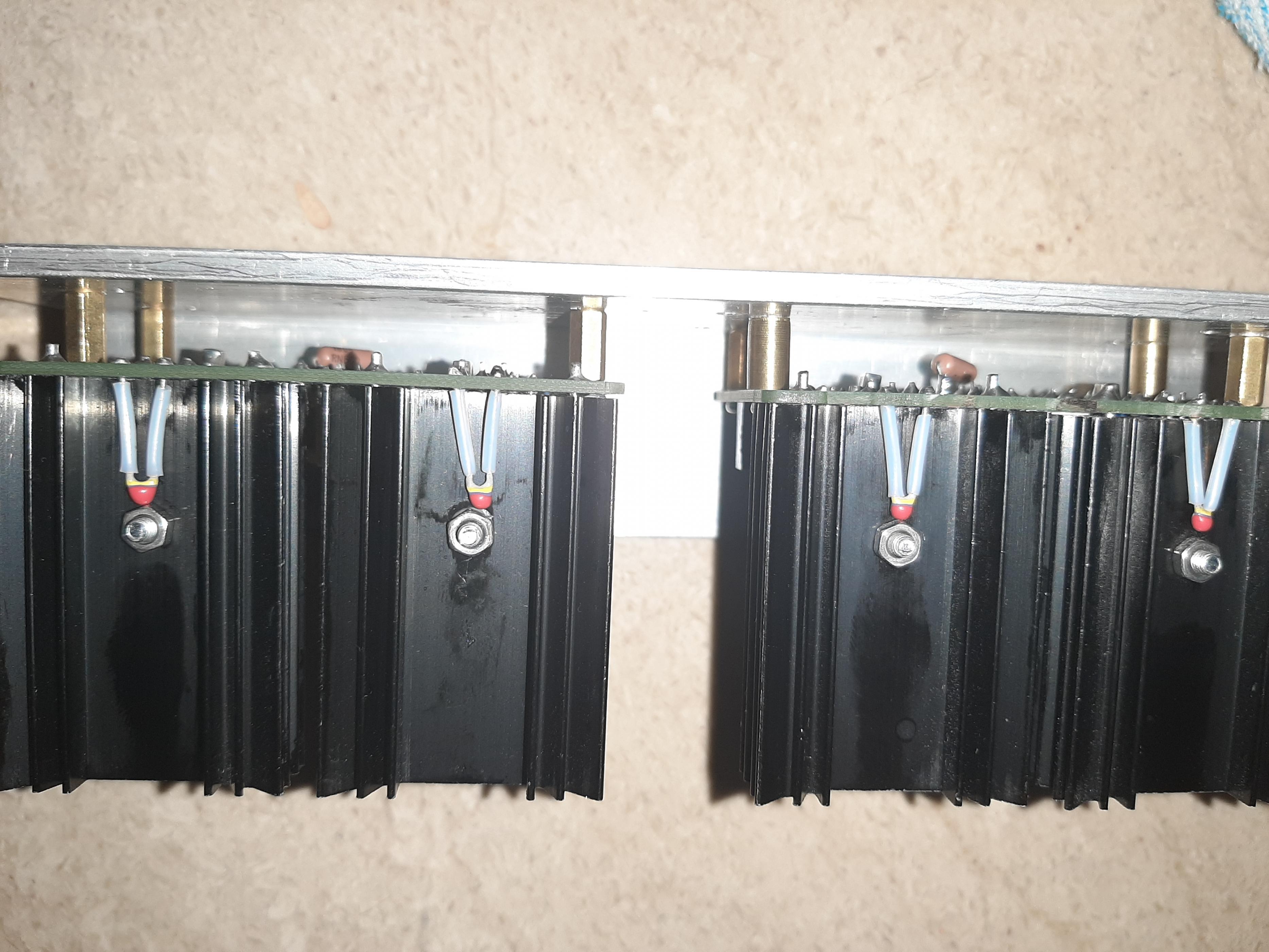

5mm base plate aluminium.

:D 20190724_230557.jpg
Finally tr matched after much hunting around the net for the unobtaniums jfets
Jfet within 3% idss
And the fets at 1% vgs
Slapping on thermal paste on them was so satisfying
Got a few mishaps with fakes and luckily a good Samaritan pointed me to the right direction.
Now I got enough of the fairy dusts for fssa amplifier:wiz::hbeat:

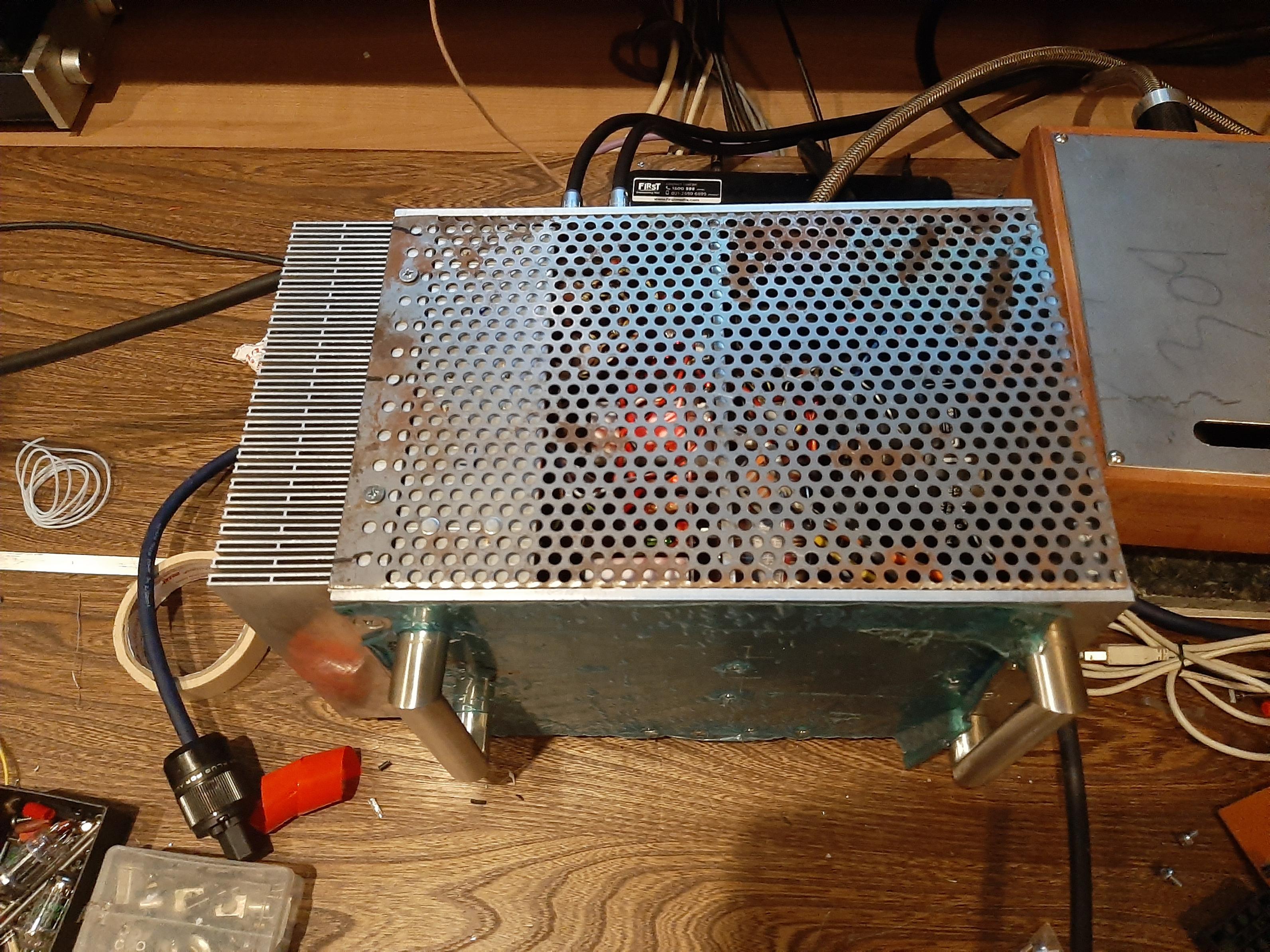

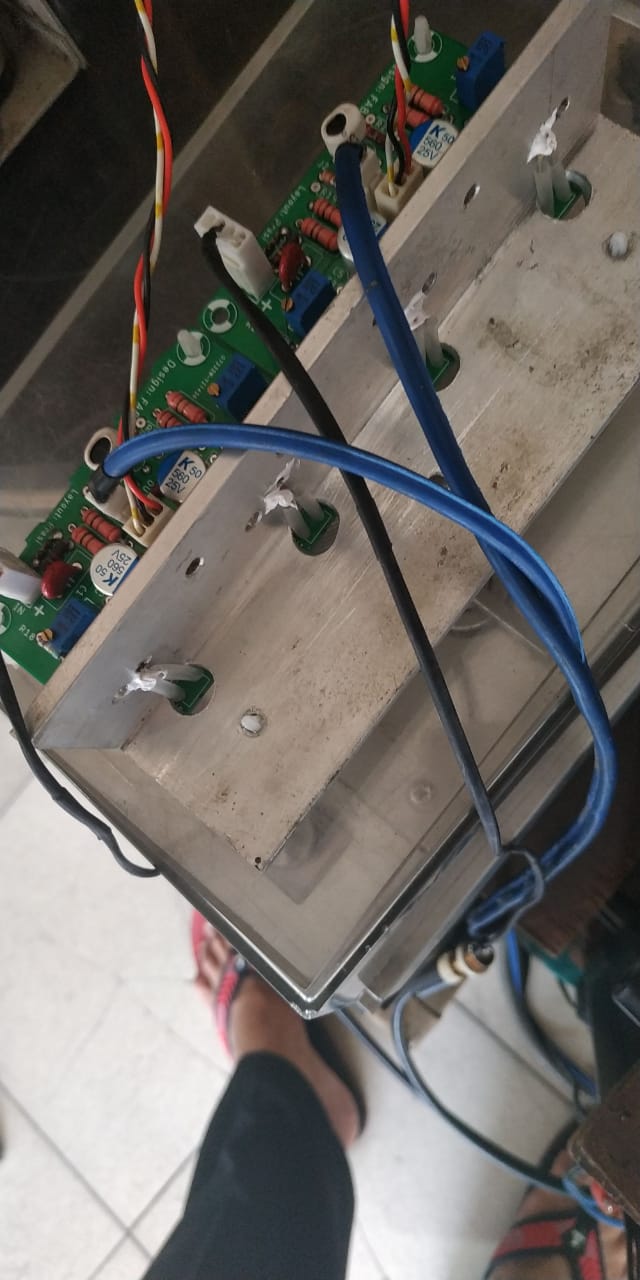

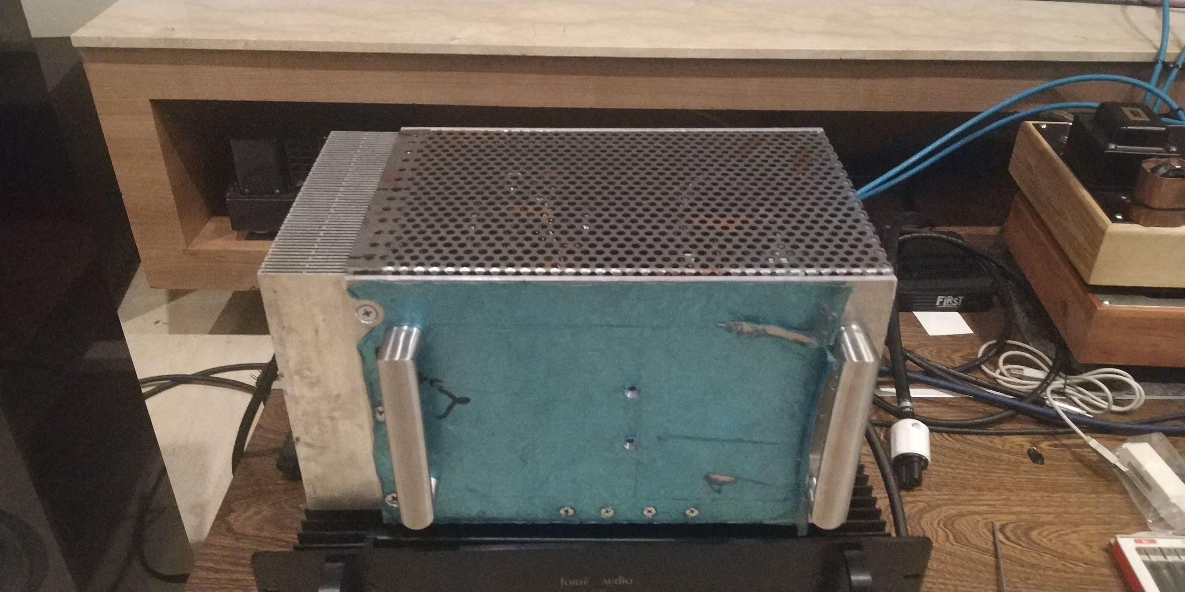

I had completed the preamplifier for almost a week.
I had installed it inside a diy goldmund mimesis clone to make it a integrated amplifier.
I'm going to do a first below 100 hours review. Break in was quite straight forward. Bias at 80ma. With a 1963/3015 power supply at 15v. Very easy to get it to run.. The documentations from Mr Fab is class A+. Smooth operations

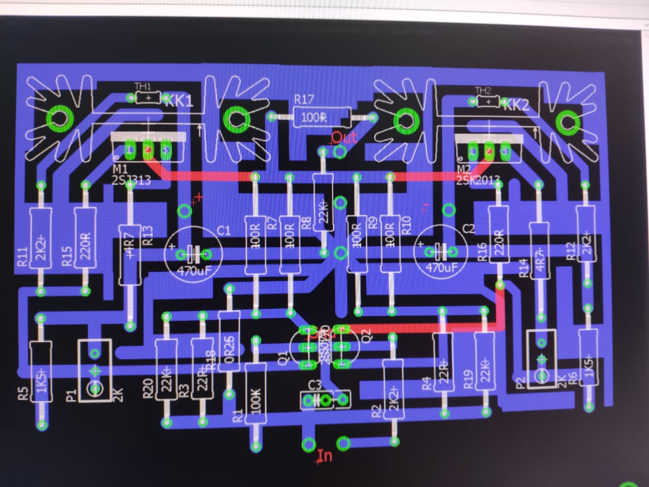

Another buddy was so angry I did not get a set pcb that he made it himself :p. He decided to make balanced for his x150 phasslab. Feeding to his kharma speakers

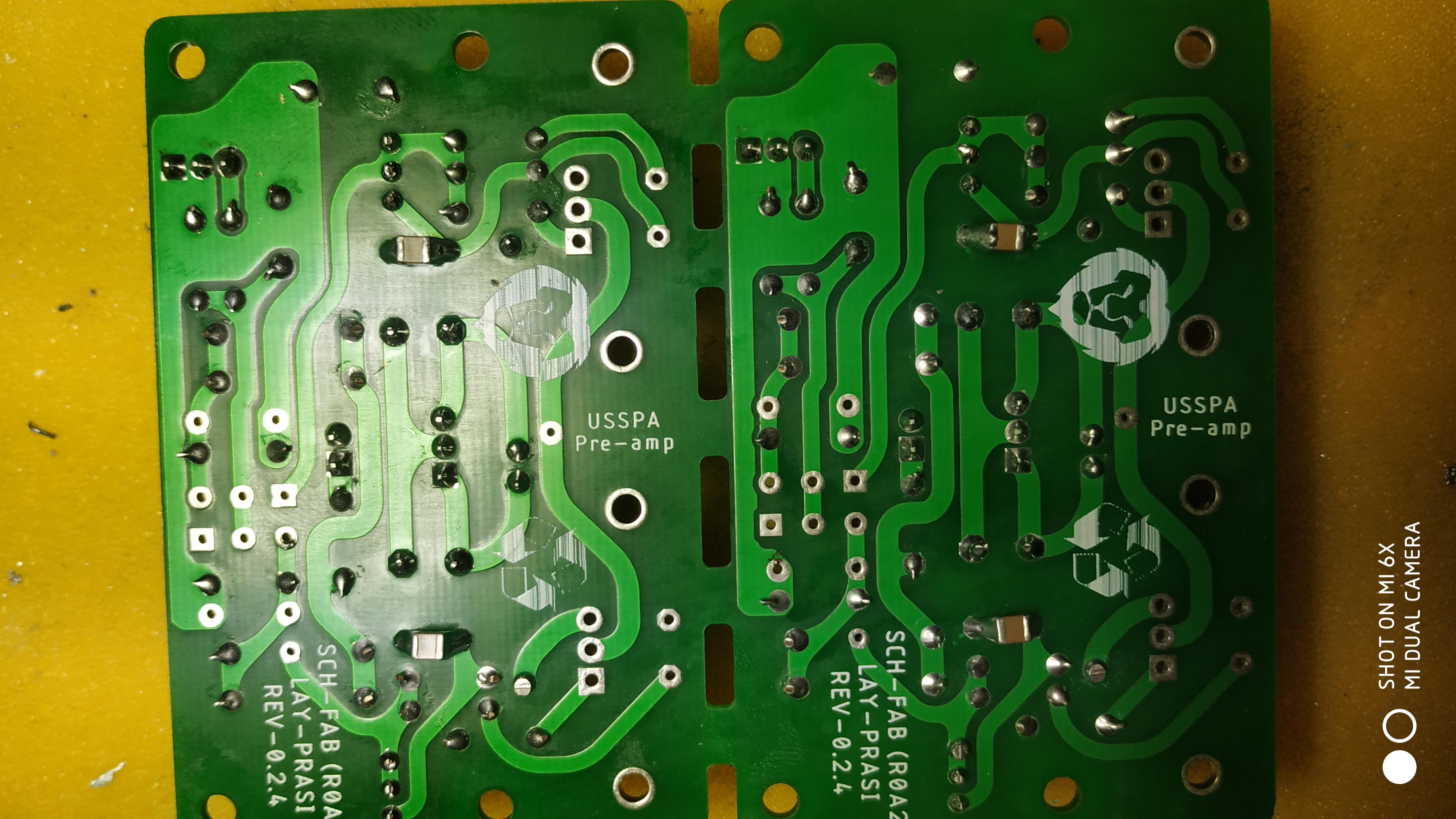

No problem for other USSPA pcbs.
I will wait until August 13th to take other members possible pcb orders and then I will send my order to the pcb manufacture for the required quantity. Ordering quantity is either 5, 10,15, 20, 25....
Price will be in the range of about 10$ plus shipping (CAD) depending on quantity. One pcb is a stereo set that can be separated.

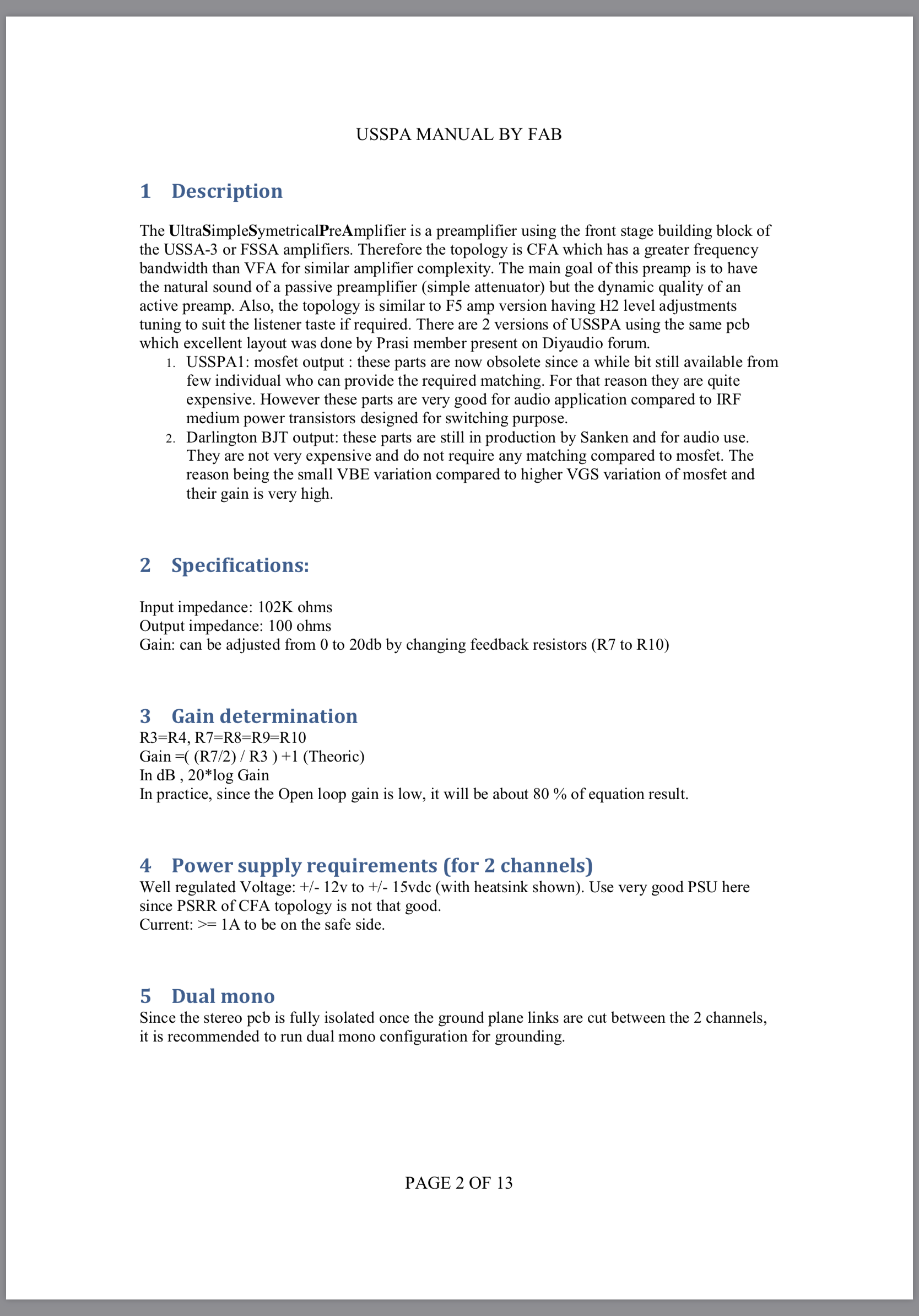

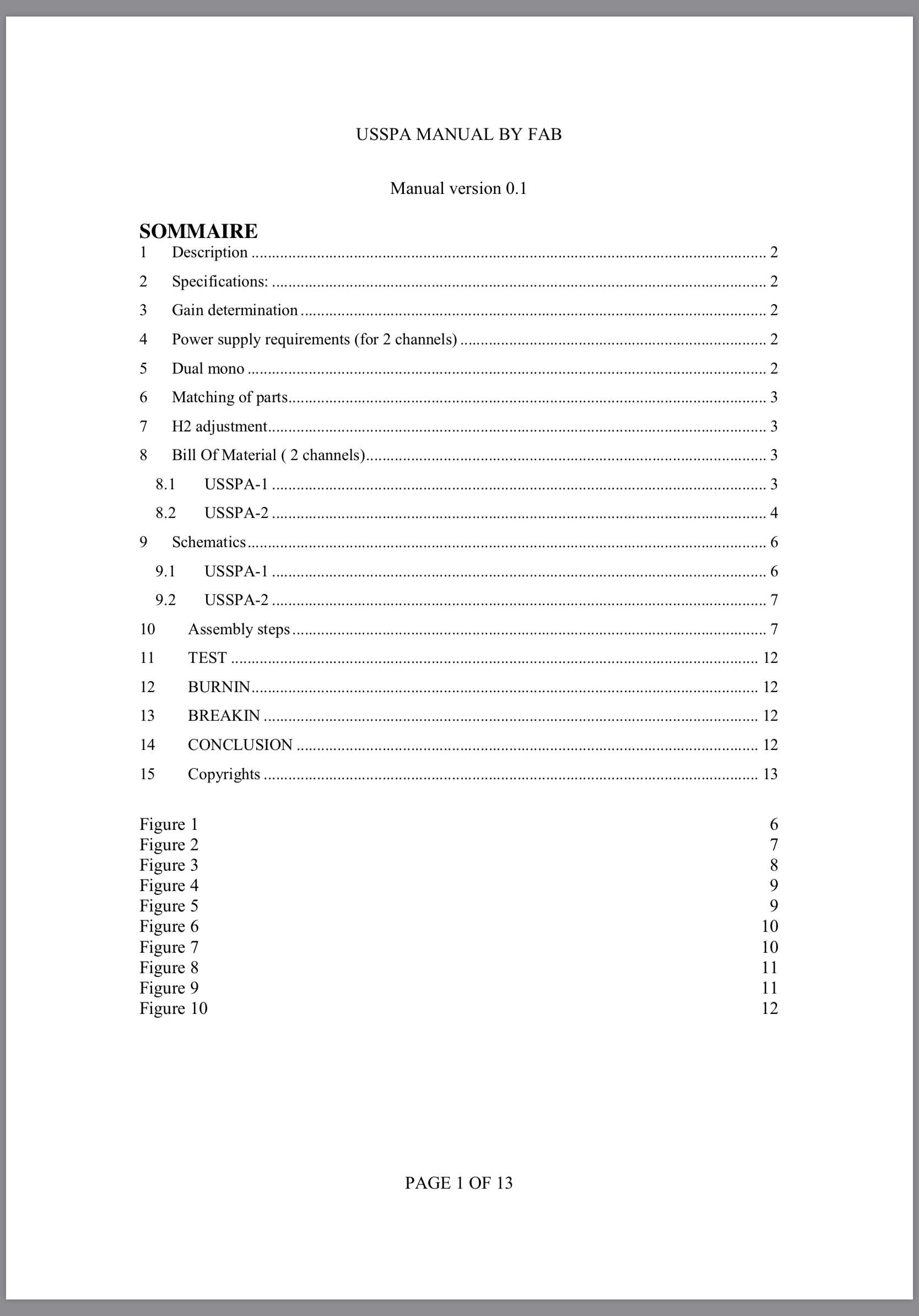

I have an assembly manual for the pcb buyers that includes USSPA1 (mosfet output) ans USSPA2 (bjt output).

Find below extract of manual. The bom includes the detailed part numbers from Digi-Key (most parts).

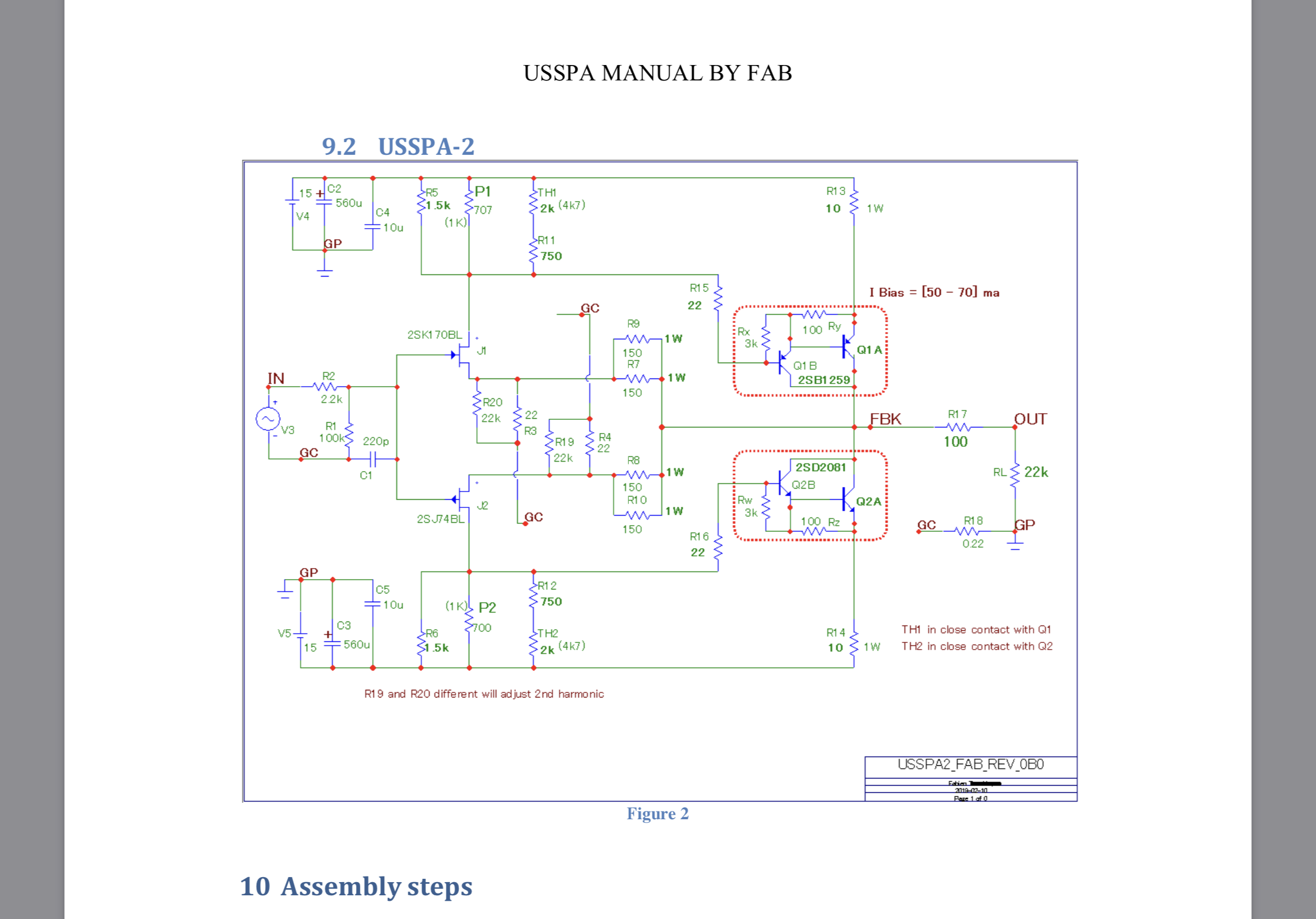

In the mean time, here is another extract of manual showing schematics of USSPA2.
