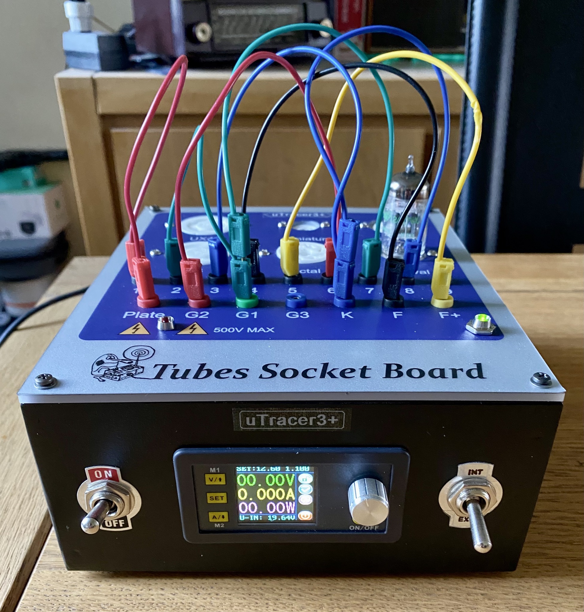

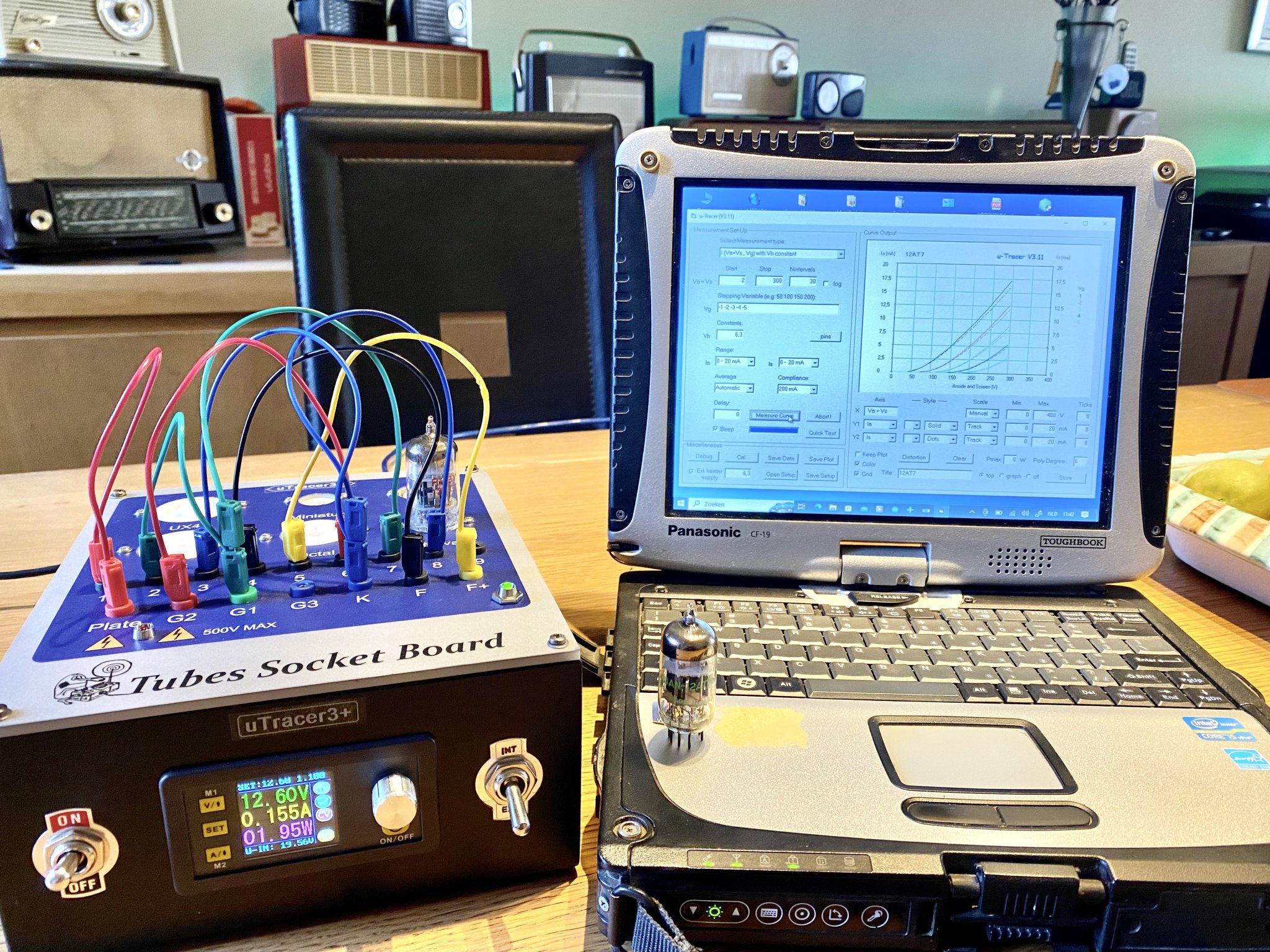

I've build the uTracer3+ ( See pics ) and would be interested in you RMS to DC converter , do you have a spare pcb or gerber files ?
Thank you ,
Danny

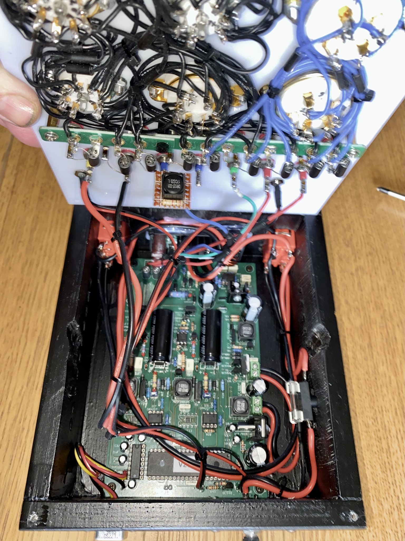

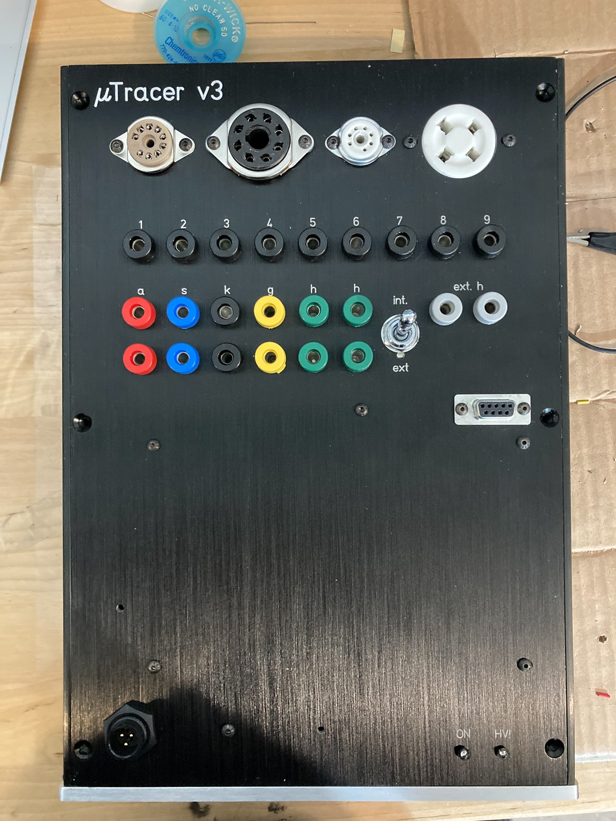

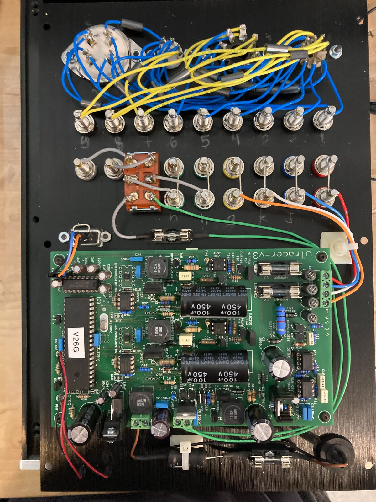

And here you see my assembled version of the uTracer together with the RMS to DC converter. At the left: the panel meter for the heater voltage. The other meter reads out the screen respectively anode voltage.
The tube under test is a QQE06-40. Due to current limitations of the uTracer, only one half (at a time) is tested. The other half is cutoff by connecting the control grid to -40V. Disconnecting the anode instead, would be a bad idea, as the screen grid will be overheated. That's why I've made the -40V supply accessible.
The small black box next to SMPS, comprises the additional filter as recommended by Ronald Dekker.
Cheers, E.
