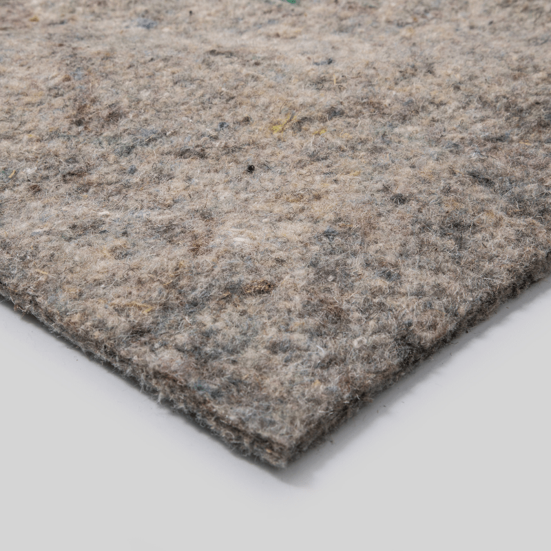

A ported box would have its internal walls lined with absorbent sheet material such as thick wool felt carpet underlay:

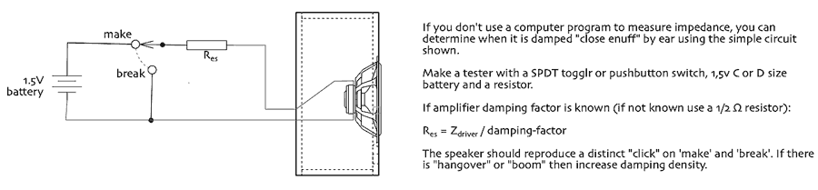

You may not be familiar with the "Click Test" which can be used to provide an audible indication of when the damping density in a sealed box is optimum.
Here it is courtesy of GM and planet10:

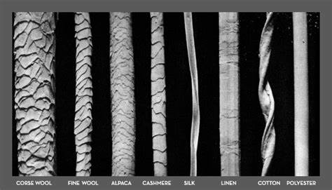

Natural fibres tend to be better absorbers of sound than synthetic fibres (such as glass fibre) because of the roughness of their surfaces.
Here's an image of wool and other natural fibres (and synthetic polyester fibre at extreme right for comparison purposes):
How much wool do I put inside the sealed box?Here's an image of wool and other natural fibres (and synthetic polyester fibre at extreme right for comparison purposes):
And because of much more varying fiber diameter.Natural fibres tend to be better absorbers of sound than synthetic fibres (such as glass fibre) because of the roughness of their surfaces.

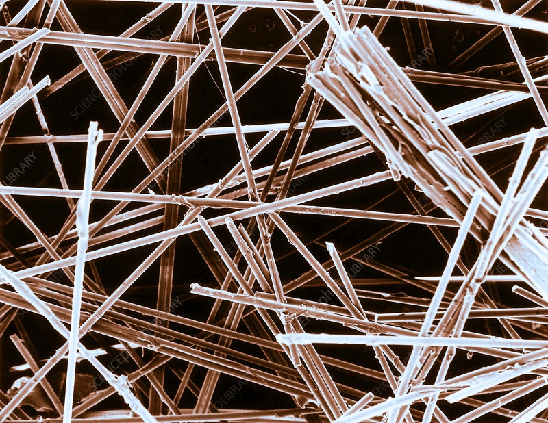

Yes, look how uniform in diameter glass fibres are:

The exact quantity of absorbent can be determined by the Click Test I mentioned in post #3.
Or you could simply fill the enclosure loosely with the wool, but only up to the point where it will come in contact with the magnet assembly of the loudspeaker driver when it is fitted.

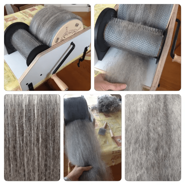

Yes to natural fibers for having all that 'bonus' surface area (as this is a 'molecular gas thermodynamic process'), but no to felting it or otherwise linking it together (carding?), as it should be loose and fluffy, and located in the center of the volume, not on the walls.I have suggested carded sheeps wool. Check out my link.
(carding?)
Carding involves separating and straightening sheep's wool with two brushes to create soft, fluffy wool which can later be spun into yarn.
