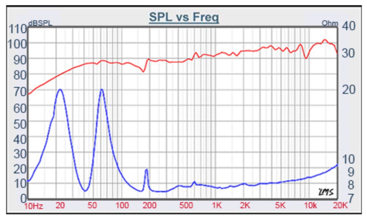

Posted response in the above cabinet needs baffle step comp circuit for sure or it will sound bright and fatiguing. Use a 1mH and 6.8ohm in parallel to start and adjust R to taste.
Tangbands suggested Eighty-one liters of enclosure can be tweaked a little to extend the bottom end a bit. I got a -3.01 Db @ 31.25 hertz for a 125 liter size...tuned to 34.8 hertz...100 mm by 200 mm Port, 279 mm long.
Yes, that rising response really should be addressed, of course a 31 band EQ could null this out & fine tune evrything, but I figure a more permanent integral approach should be tried.
