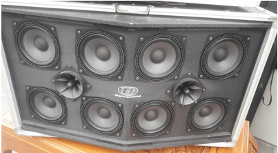

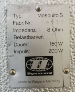

Now, some time ago one side of the amplifier died and it killed some speakers in one box.
In the box remained, I did splitted wiring inside, now I have 4 speaker left on one side, 4 speaker right on the other side. (The high is splitted as well, although, it does not do much, "crossing freq" is quite high.)
In the original config, with 8 speakers + 2 high, this is the specs on the box:
but this spec is not just some "artificial dreamworld" as on most speakers. This guy can put out some really serious sound pressure.
So, I've tried one box, splitted wiring to 2 sides with a good transistor amp and it is still awesome. It eats the largest boomboxes as breakfast on rock, acoustic. It has excellent midrange and good base and OK highs. It is not as good on music what requires a box to work in 20-50Hz, but I do not care, I do not need that.
