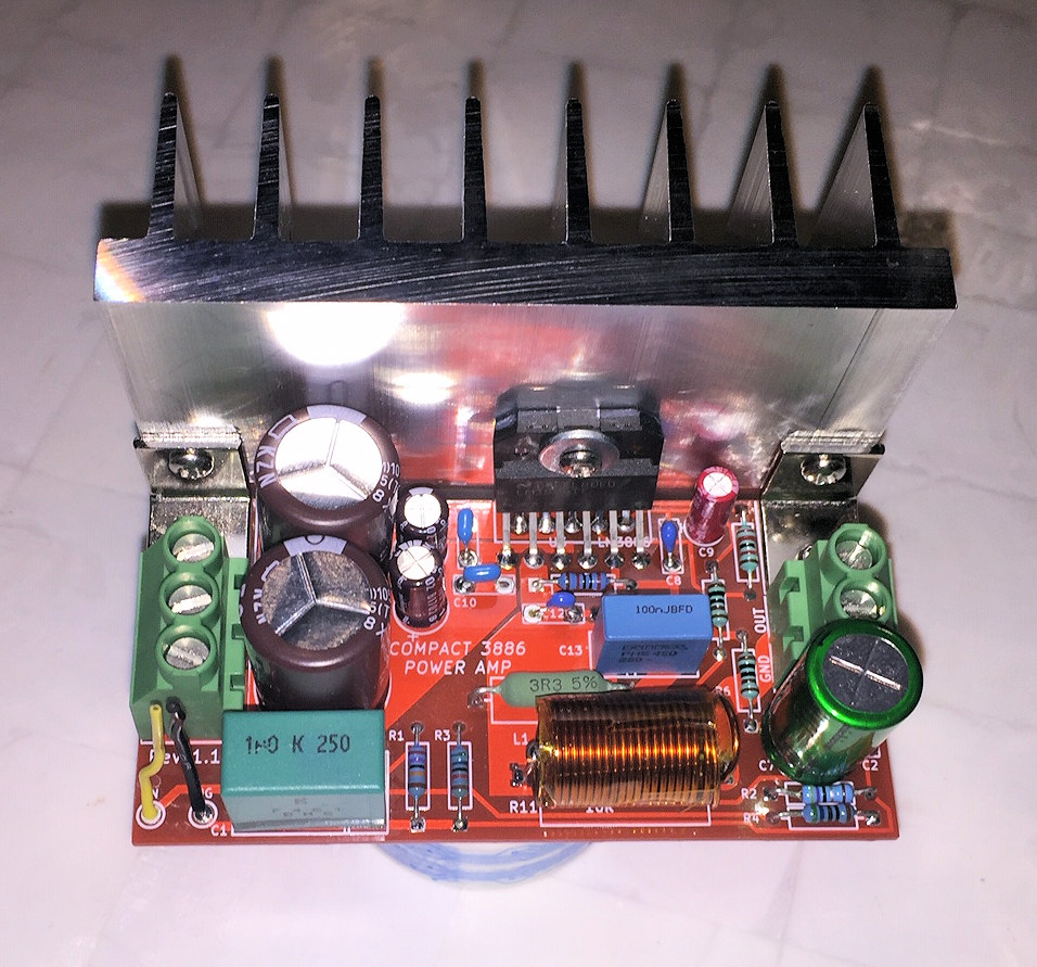

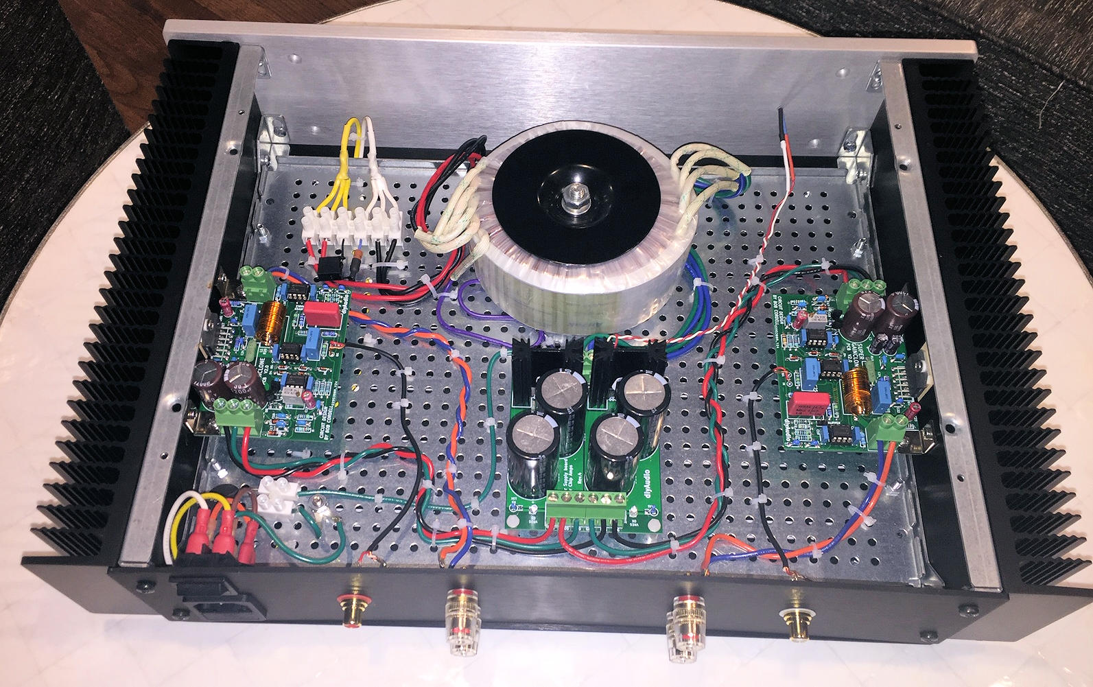

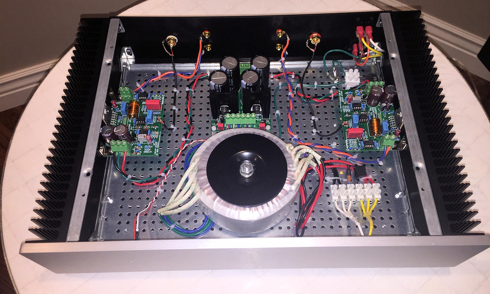

Here are some of the things I brought to Burning Amp (foreshadowed in post #8 of this thread).
The circuit schematic is on page 540 of the first edition of Bob Cordell's book, and also on page 687 of the second edition.
Bob also has a web page about the Super Gainclone design.
It was a lot of fun to show the completed amplifier to Bob Cordell in person and to receive his feedback. He's really a terrific guy.

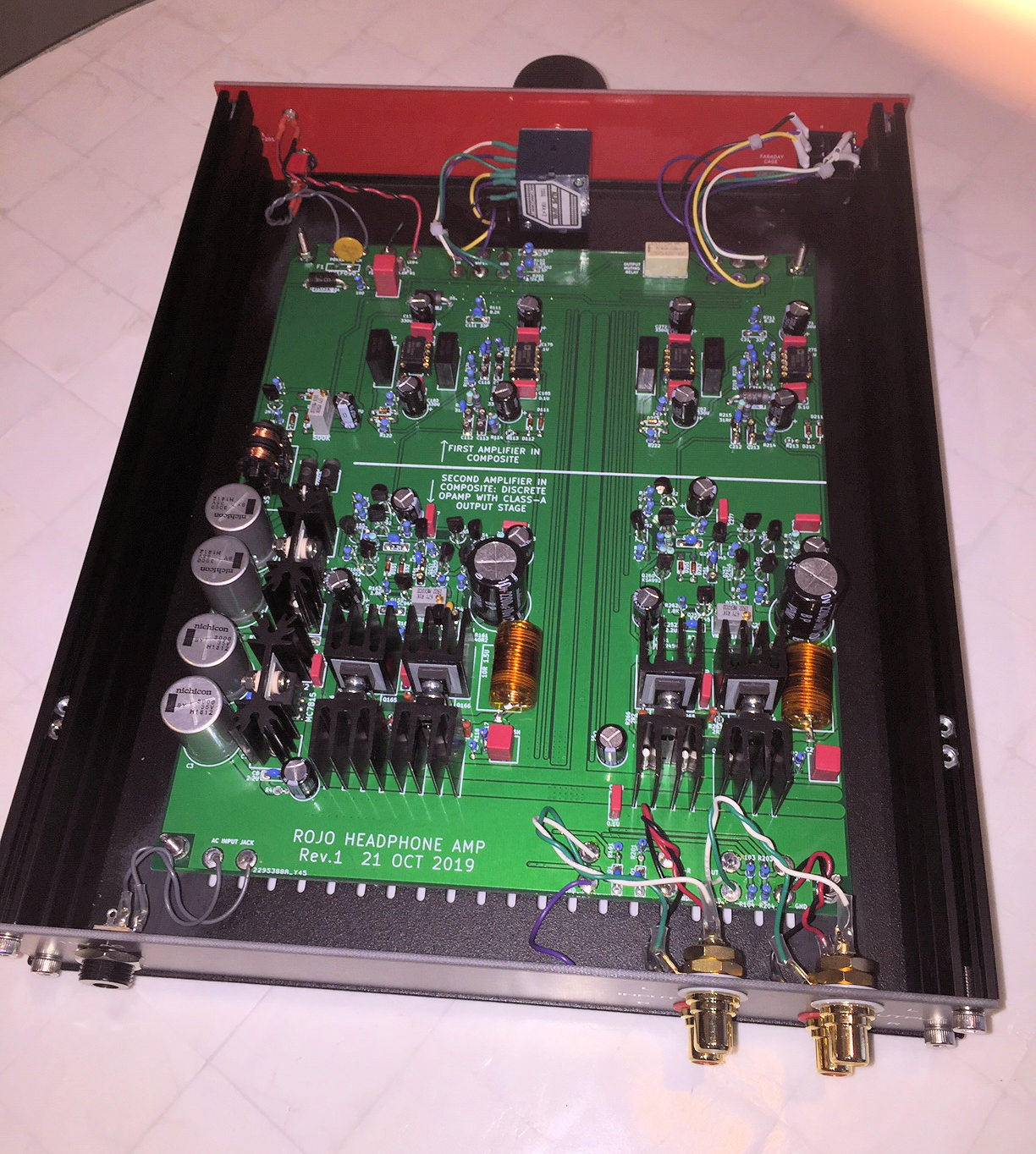

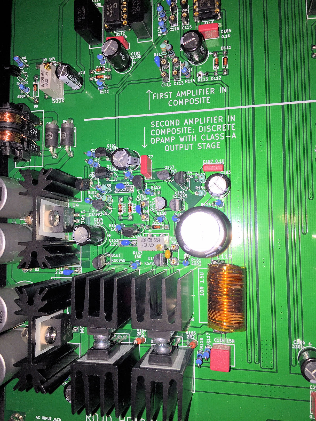

Here's another project I brought to Burning Amp; it was on one of the tables in the Volta room.
This is a headphone amp called Rojo, which I scrambled to assemble and tune up, just before the Festival. The silkscreen layer contains the date I sent PCB Gerbers to the fab: 21 Oct 2019. That didn't leave a lot of time for fab turnaround + stuffing and soldering + debugging and testing. Fortunately I got it up and smoothly running with two days to spare, and was able to demonstrate Rojo to listeners at the show, after the last of the Firehouse lectures.
The signal path is all-BJT including the front end opamp IC (AD817) and the discrete opamp back end. However I did pick a JFET-input opamp for the DC servo: OPA134.
