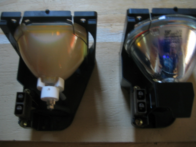

I believe that this is a UHP lamp that vents at or through the rear. This may be why you have had problems with failing lamps. My guess is they worked great for the first 10 or so minutes and then they Popped! I am also guessing that the replacement lamps DIDN'T have the little vent slotted piece that is glued to the front of the reflector.. If this is the case It looks like this lamp might work for you but ONLY If your lamp looks like this one pictured with the off yellow reflector and it vents at the rear. This was a great way to concentrate the air flow onto cooling the lamp but the lamp reflectors were so much more expensive than the sealed UHP lamps that it was cost prohibitive. I would call the company and MAKE sure the lamp you are buying looks Like this and is not a sealed non rear vented lamp. Bottom line is if your original lamp had this kind of rear piece you need to replace it with one that is similar.

Hmm, is that supposed to be off yellow? Mine isn't. I didn't realize that some lamps were; I figured it was just the picture. And mine has two notches at the front by the glass to vent, so I think it's different than the one that I linked. Also, the glass piece has some sort of metal thingie clipped onto one side. Not very big.

Yes they are different. The Philips UHP is AC I beleive and the NSH and SHP are DC. The ballasts that drive them are different. I have seen the same Exact projector body with two different Ballasts for two different lamps.
The PLC sp10N has a 160 watt metal halide lamp that vents at the rear which I believe is the NSH -SHP type
The PLC xp10NA has the 150 watt UHP Lamp that is sealed and gets cooled by osmosis
This also might explain why the lamps you are trying are failing.
Bohanna
Lamp on Left sanyo PLC-Sp20N 160 watt Metal Halide rear vented
Lamp on Right Sanyo xp10NA 150 watt Philips UHP sealed
