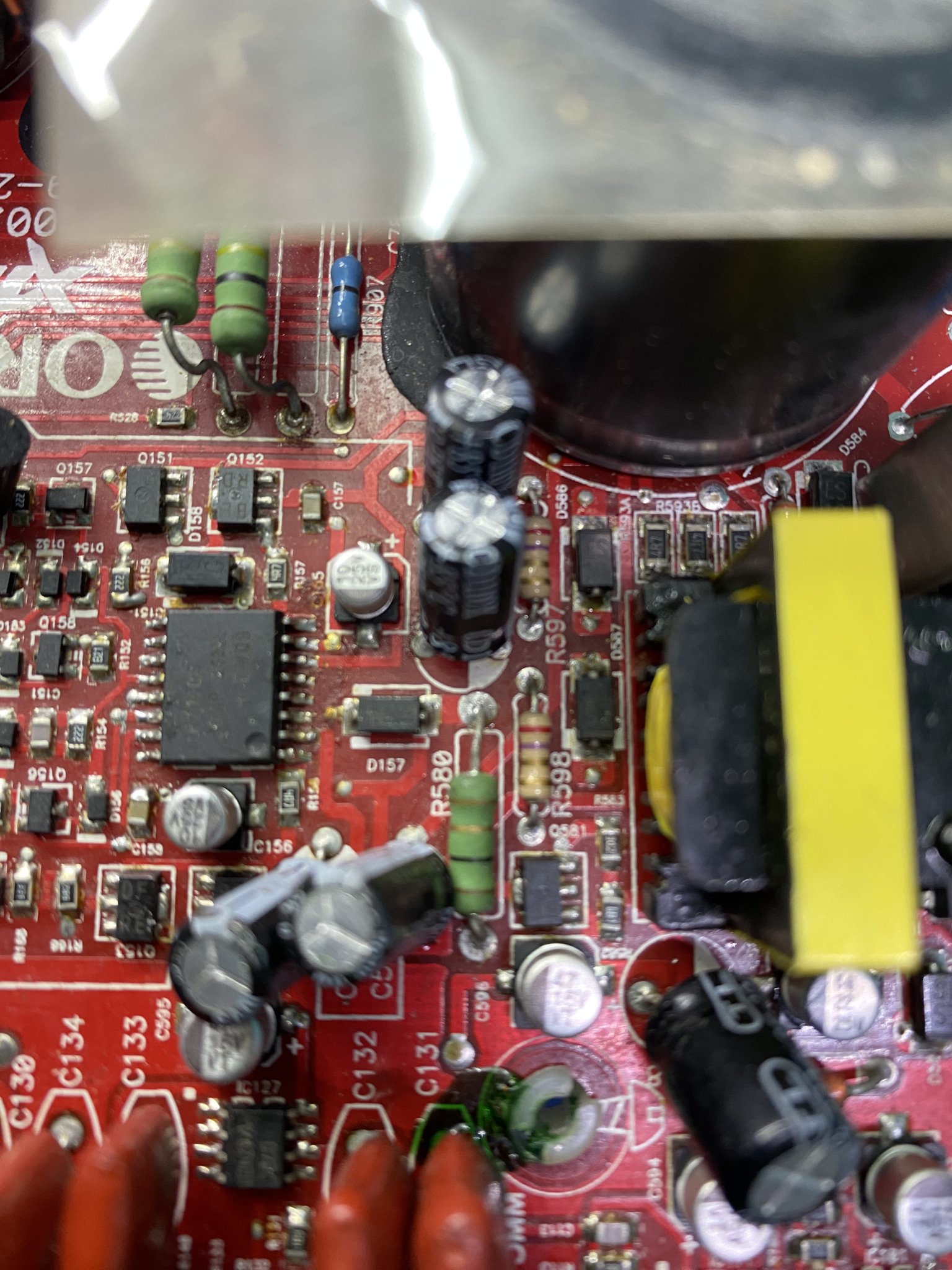

This amp has rail voltage but the voltage for the op-amp is missing.The circuit that produces that voltage is there a tap from the transformer that feeds it or it’s tap from the rail?
Does this amp have a TIP41 transistor (or any transistor) as a regulator that produces the voltage for the 2110/2113 output driver IC? Does that IC have 15v on pin 11 (referenced to the negative rail)?
