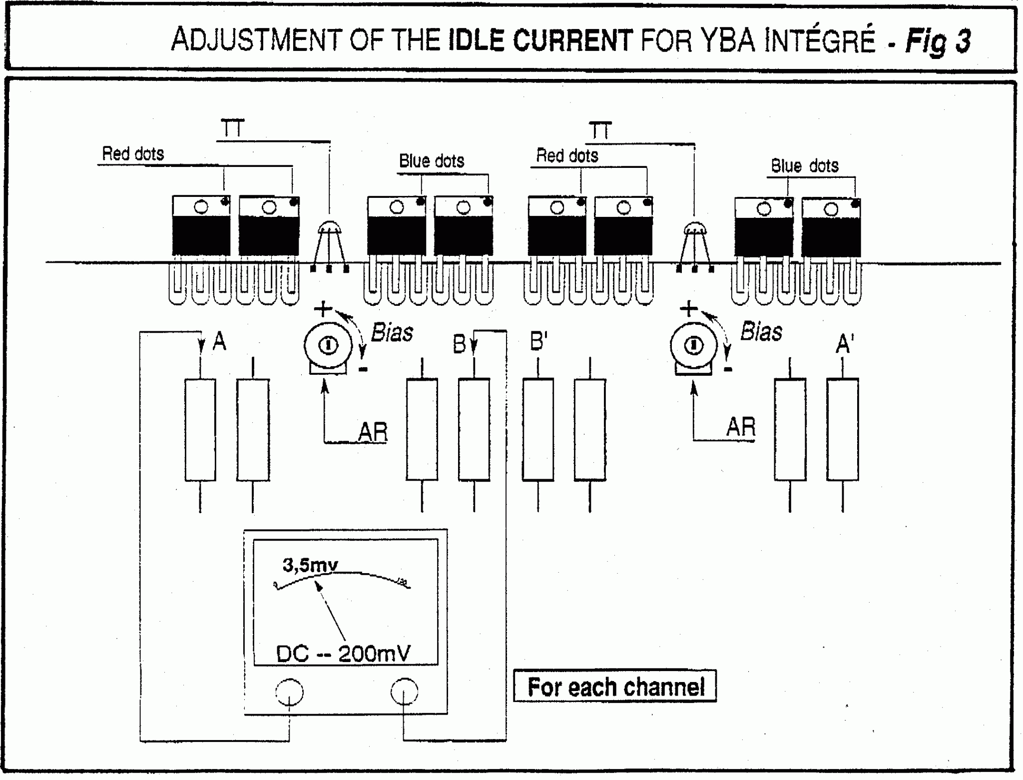

I have Yba Integre. When i rotate trimmer potentiomer for left channel to set bias, values for other channel also change? If i set 2-3mv for left channel, other channel automatic is 130mv. If i set 40mv for left channel, other channel is 105mv. When i set two trimmer potentiomet to min , on both channel i have 60mv.
Can you tell me how the transistors are located (TIP35/TIPC)
With RED dots, which are transistors? Tip 35 or tip 36?

A- where do on the board you read the mv?
B- what should the voltage be for proper operation?

Here is the answer to which output transistor goes where and how to adjust the biases.
In the DT version, the transformers are not one for each channel.
Their secondaries are paralleled and wired as one transformer for each polarity.
This way the output stage has access to more current.
The biases going down with time is a known issue.
You can recognize the issue as soon as you hear a slight fuzz in the sound.
When the bias goes too low, you enter the crossover distortion zone.
The last time I had to deal with this issue, I replaced the original Piher PT-10 bias trimmers by PTC10LV10-103A1010, which should prove more stable with time.
I am at your disposal if you have more questions.
Michel
