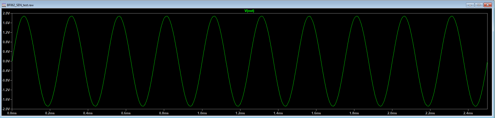

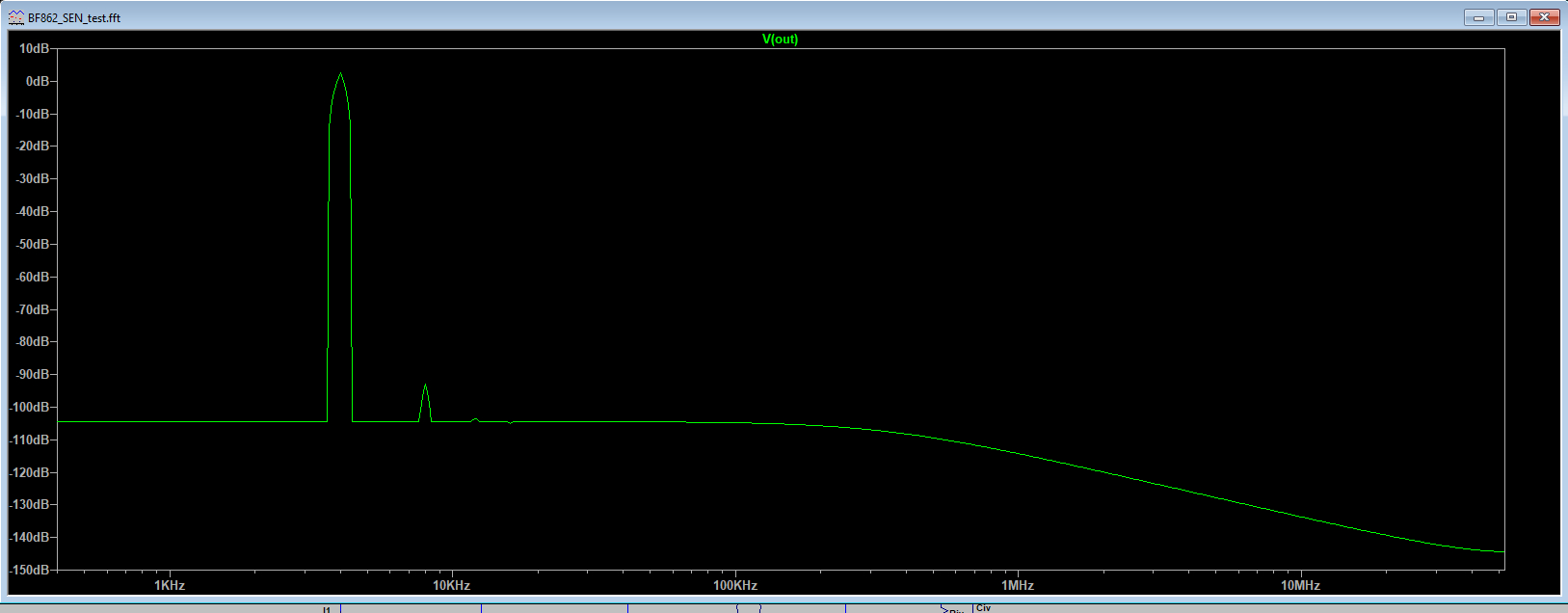

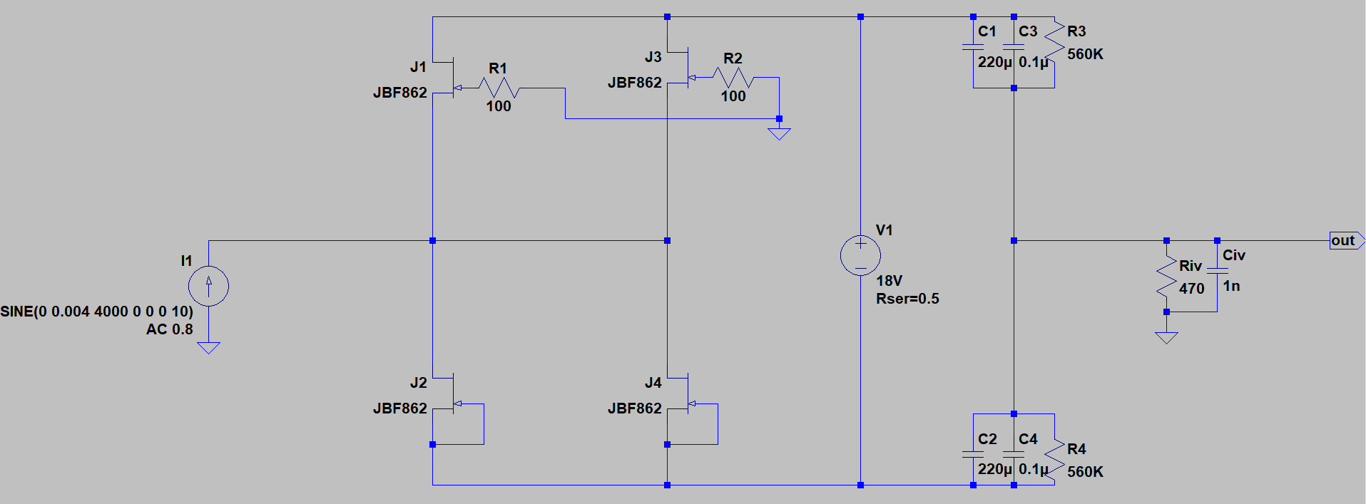

Granted I've not read the entire thread, but has anyone built the SEN I/V using BF862's?
I did a quick sim(not very good at LTSpice) adding 100R to the gates of the two fets going to GND.
Simulation looks promising, but then I'm not very good at simulation software.
