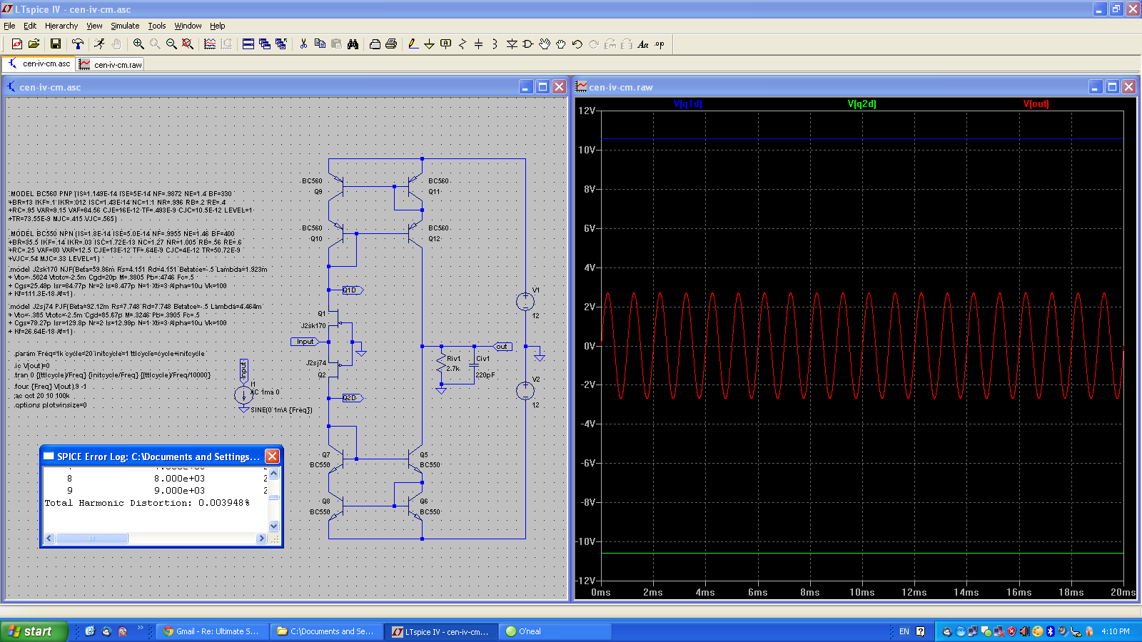

We have spiced a modified version of Joachim's circuit with complementary input FETs, Wilson current mirrors and fixed rails.
With 1mA input and 2.7k R_iv, THD is 0.039%.
The model used identical BJTs in both current mirrors (i.e. perfect match).
We'll test hardware when proto PCB is ready.
Patrick
