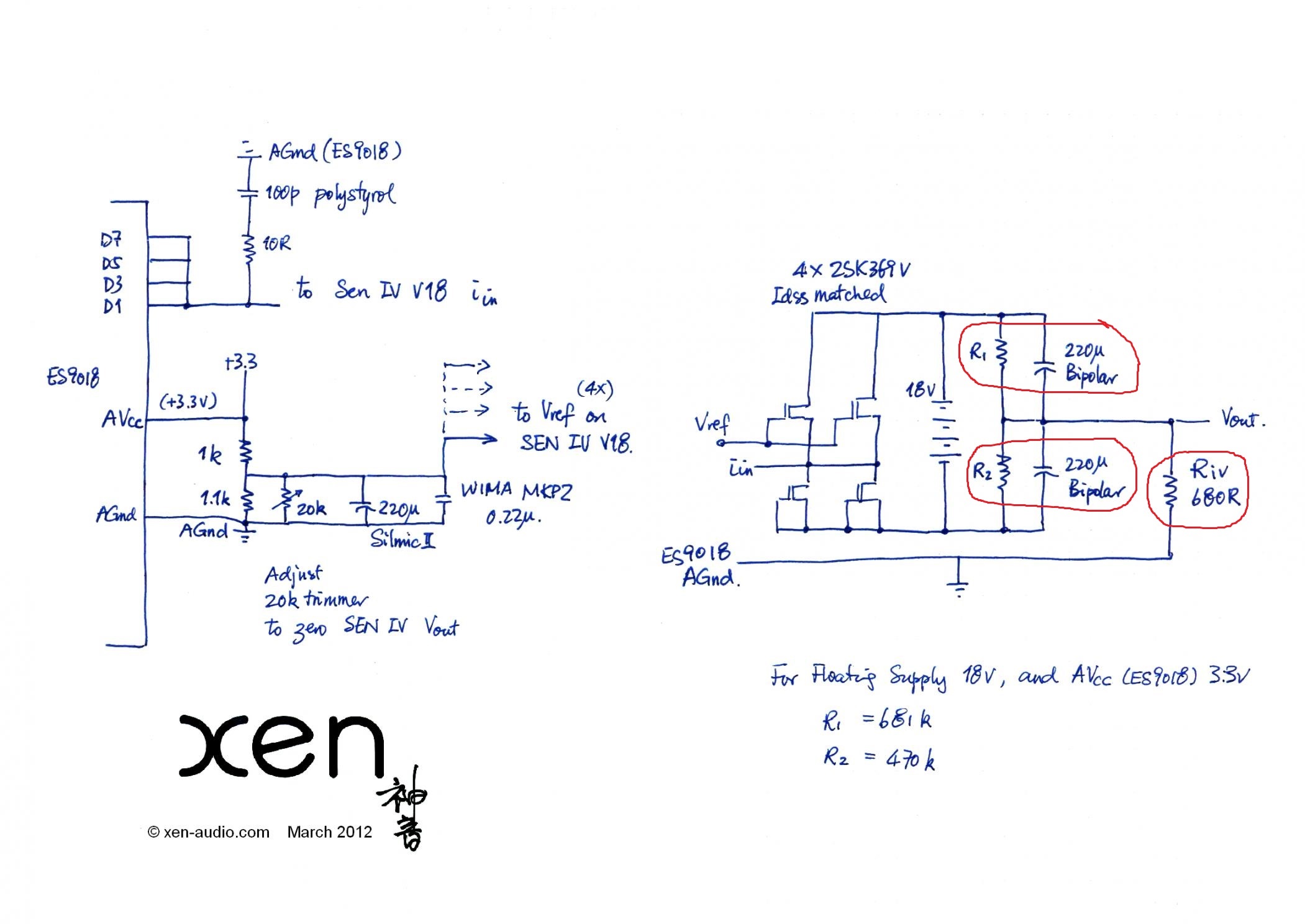

Have I to change the red marked values at the attached schematic?

I don't use E9018, so I am the wrong person to ask.
But my understanding is that 3.9mA is pk-pk, i.e. +/-1.95mA.
This I presume is per channel (one out of 8).
So as I said, it depends on your configuration.
You can always start using a low value (like 330R) and then measure the output level before deciding on the output level you might want.
Patrick
The schematics is correct and is proven to work.
So if you are not getting sufficient signal then either you wired something incorrectly, or
one or more of your 4x 18V independently floating supply is picking up oscillation.
All these have been discussed here and elsewhere (e.g. pinkfish).
Please take time to read through and understand the discussions.
If you feel that you do not have sufficient understanding of basic electronics then
you should try to find someone close to you to help.
And you need equipment to debug, e.g. an oscilloscope.
Patrick
If you have a proper signal generator and a scope, you can check the proper functioning of the IV circuit (version 18), on its own, as follows :
1. Connect the functions generator to the current input of SEN via a 1k resistor.
2. Connect func gen Gnd to R_iv Gnd (not power supply, which is floating).
3. Set the functions generator to output a DC offset of +1.65V, plus an AC sine signal of +/-1V, say 1kHz.
4. Measure voltage across R_iv.
You should be able to measure a 1kHz sine wave with an amplitude of (1mA*R_iv).
If that is the case the IV converter is functioning.
