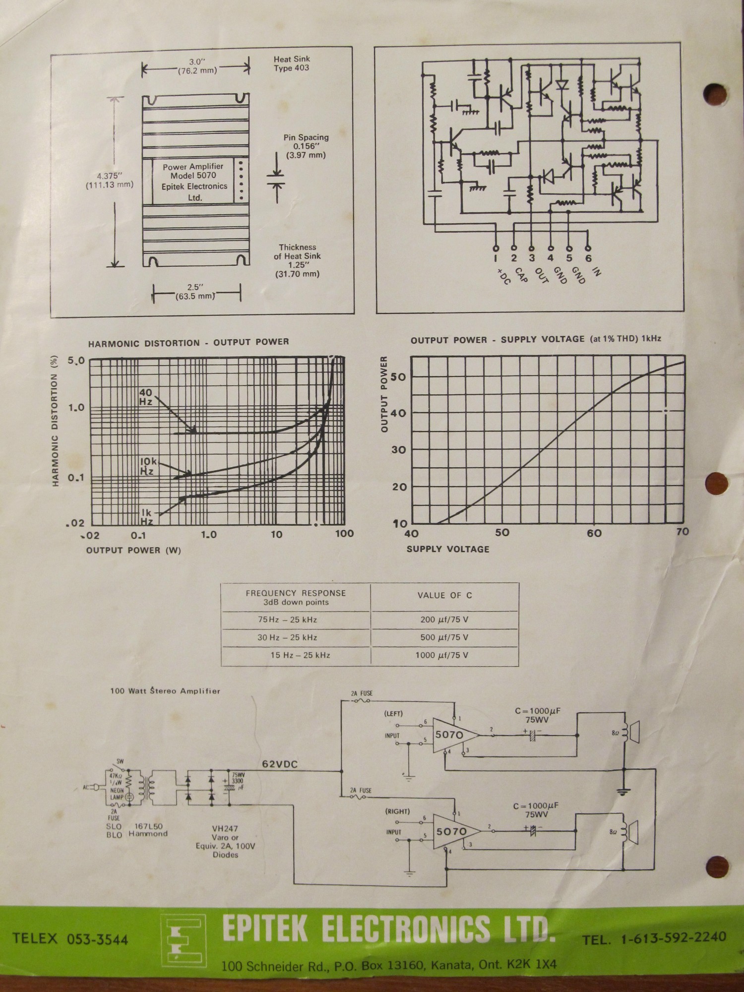

One of my Epitek 5070 modules has the negative swing side open (probably due to a short on the speaker wire. Would you know where I can find one of these modules? I also bought it back in the 70's and it worked fine up to now. It is not obvious where I can find one, even if I live near Ottawa where it used to be manufactured. I found your post (above) as a result of a Google search, which gave me some hope. I would not want to scrap the Amplifier that I built based on these.

I have seen the extent to which you have looked online. You have adds all over the place! Are you certain that you could not make a repair of the module?
Since I have found a working module through the diyAudio forum , I actually started to take the failed module apart by chiseling out the putty portion apart from the heatsink that I plan to use for other purposes. I might be able to save the two MOSFETs but, sadly, the thick film portion gets destroyed.
When I bought the Epitek 5070 modules, circa 1977, I was told they had MOSFET's.
However, true confession time, looking at the data sheet, they don't.
Regardless, I wish they were still available.
Hi mwmkravchenko,
This is a module that is made of a Thick Film hybrid circuit integrated into a heatsink with solid black putty. There is simply no access to the components.
