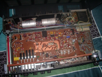

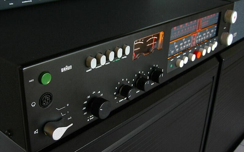

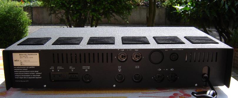

here very fine sounded receiver with 2N3055 as power devices:
Braun series "Regie"
