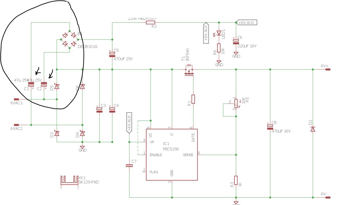

6.3VAC to 6.3VDC LDO supplies MIC5156 based tube amp upgrade.
Hello to all self-builders!

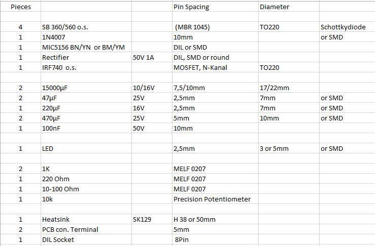

I created a modified PCB, partial use of SMD components possible (also for MIC5156),
cutouts for better air circulation SK129 heat sink, use of normal circuit board connection terminals.
When ordered via JLCPCB, 10 boards including worldwide shipping cost approx. €4.50 or $5.00!
Have fun DIYing :cool:

yes, thanks for the tip, now that you say it it's actually clear!
I took it from the (unfortunately incorrect) Eagle circuit diagram.
I know that you can edit the Eagle LBR but I'm having a hard time with that too!
I found the bipolar type Panasonic SU-A at my parts dealer and it should fit!
  • SU-A.pdf
