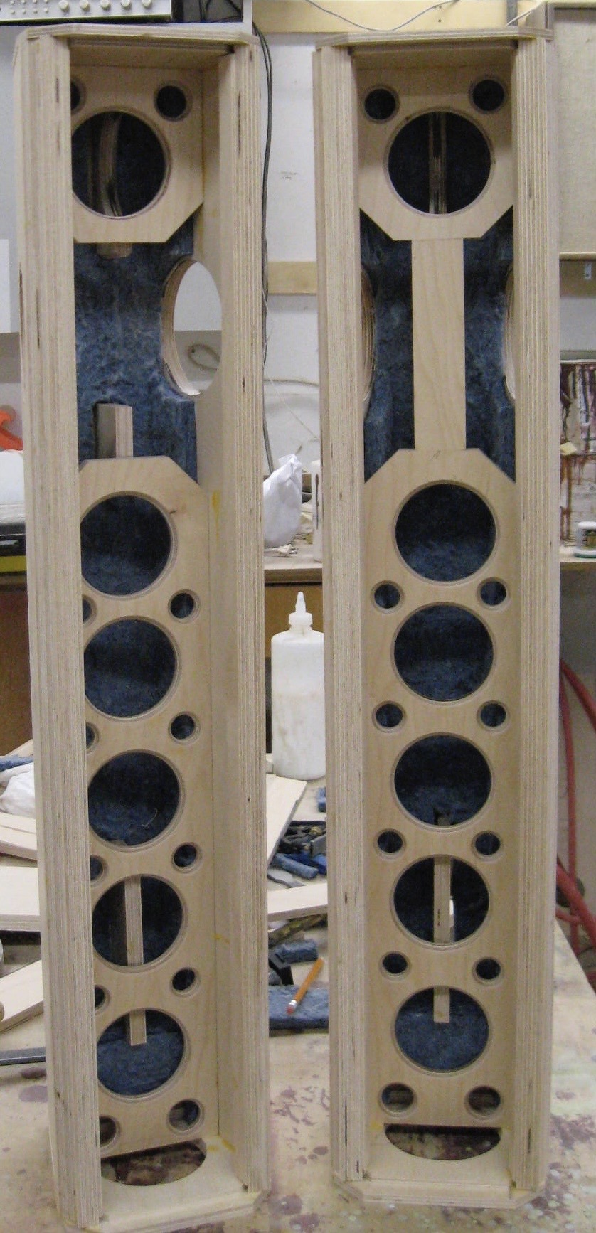

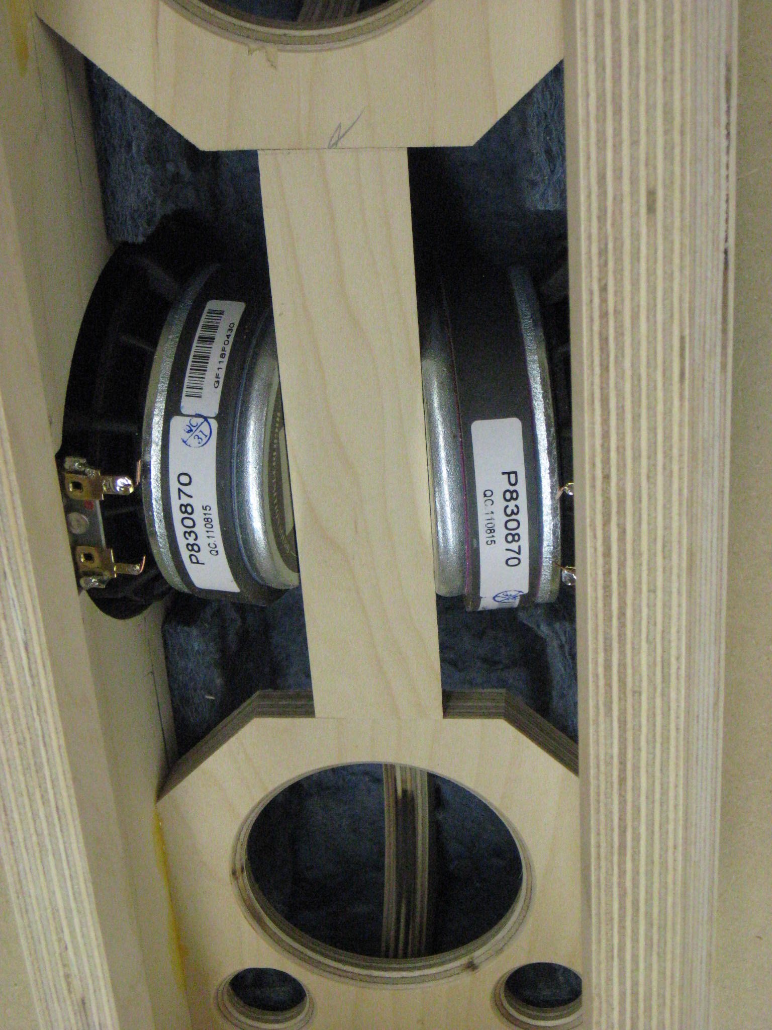

A dual mid-bass driver slot ported tower, “microwoofTs” I think Dave called it?
Those little Scan Speaks did quite an amazing job for what they were, but would still need help to deliver serious SPL or extension.
He can correct me, but I think we used a quad of the same mid-bass drivers in the Facetts? Only have photos of those at the very earliest of assembly stages, so they’d be meaningless.

Doesn’t have push-push woofers. In Tysen V1 we did that (a single SDX7), in Tysen V2 we switched to push-push 5.25”, it worked much better.

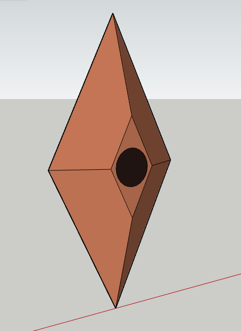

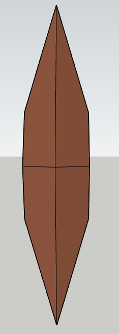

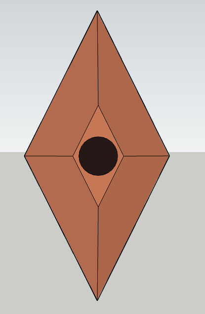

Thinking about asymmetrical extension of the truncated pyramid shape, I think it would nice looking to have low-mids done like that with the push-push configuration like this. Can the Blanda-Gronsaker be fixed to the front corner (left on the first view here below) by truncating it?
Here below a frontal view:
And a side view (the other speaker on the other side) with the truncated pyramid shape and a suprabaffle-like around the speaker:
