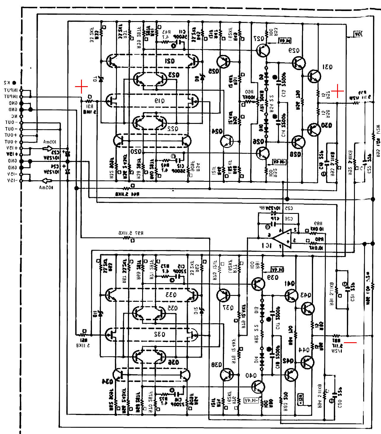

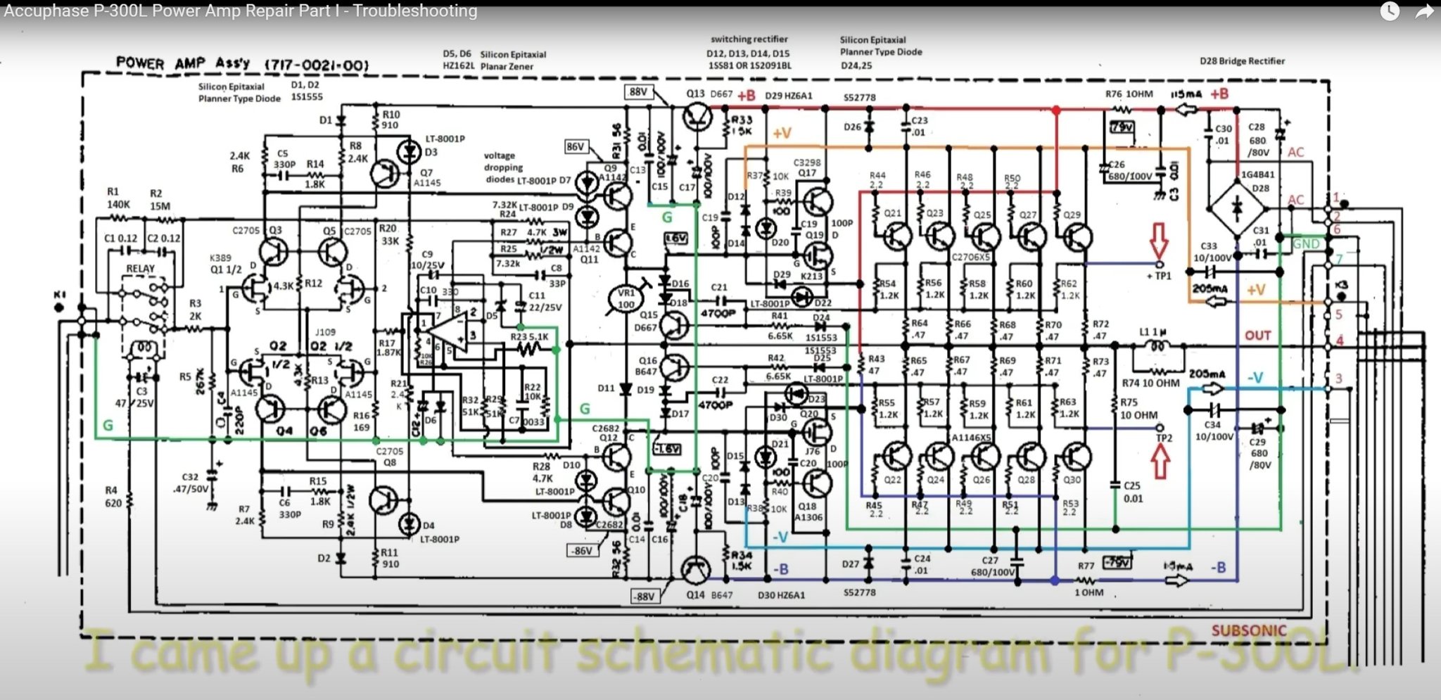

What I do have on the P-300L, is this schematic made by guy in a YouTube clip about repairing a P-300L. He drew the schematic himself based on a P-500 schematic and tailored it by looking at the amp boards of the P-300L. But is has a disclaimer that it may contain faults.
But it is missing the other parts than the amp boards. But maybe it is helpful to someone.
Credits to Vintage Audio Fan: https://www.youtube.com/@VintageAudioFan

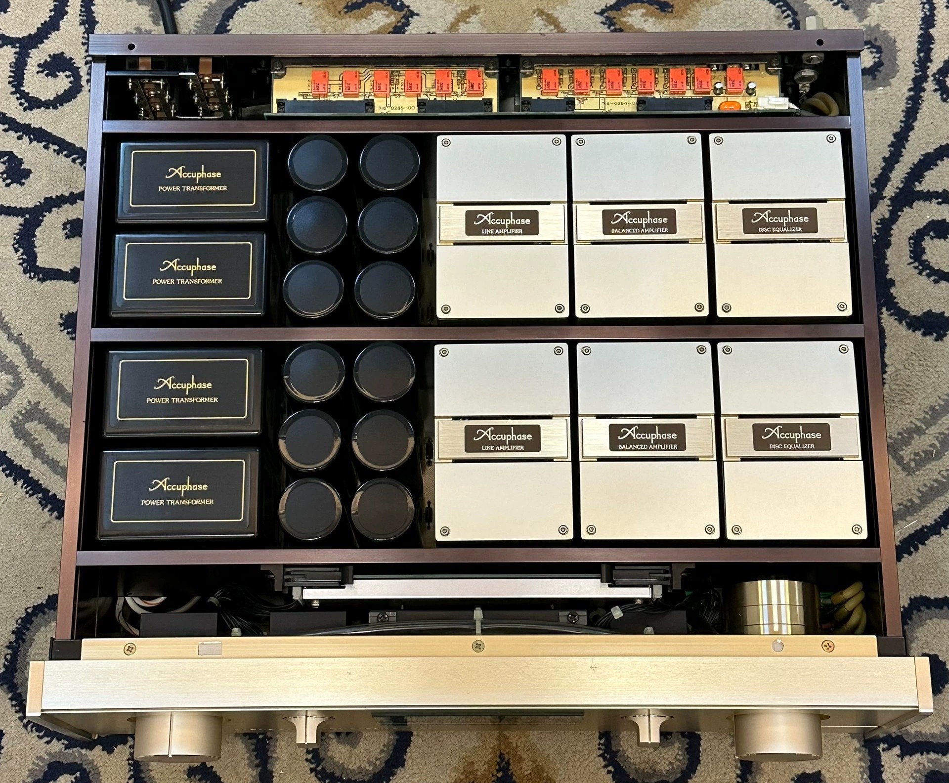

I recently bought one from Japan (100V unit) and I'm planning on overhauling it to make it future proof. It is working for now, but it's completely original. I want to replace all electrolytics, diodes (except the light emitting LT-8001P ones), zener diodes, DC balance pots, the switching relays and maybe a few fusible resistors. Just to make sure it keeps on playing for another 20+ years.

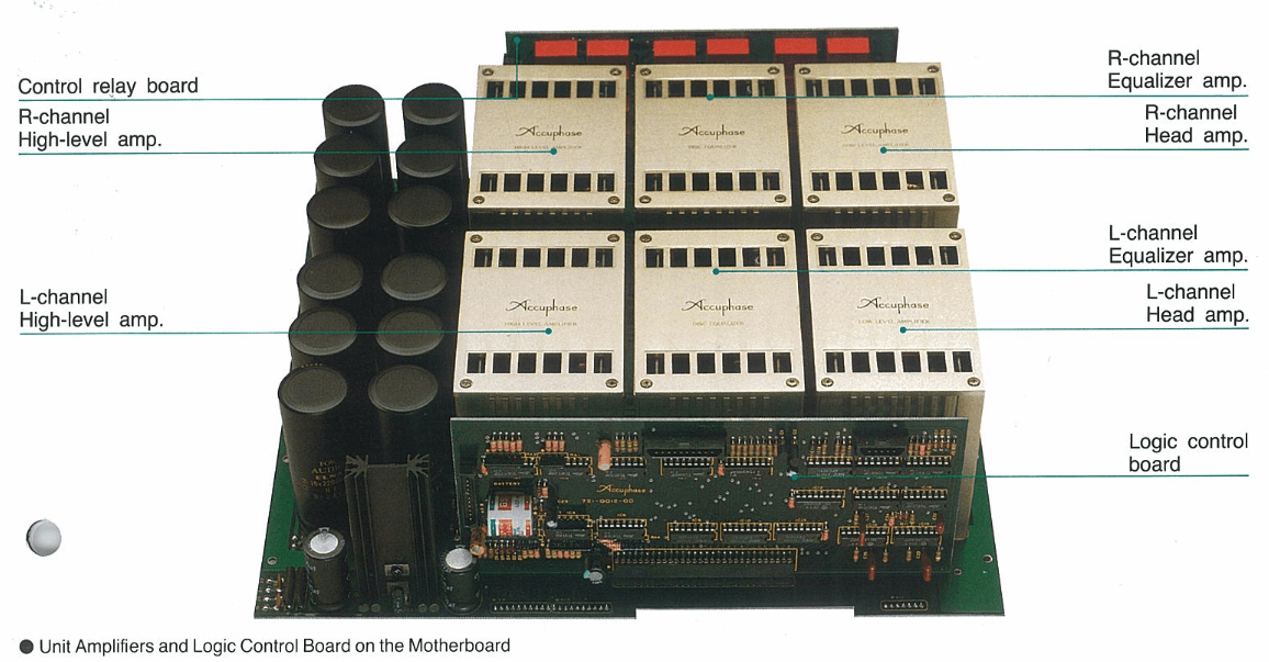

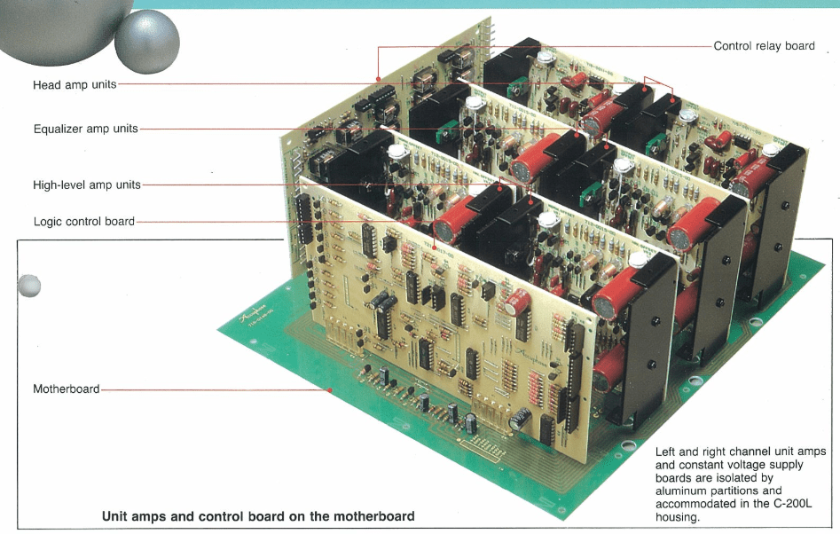

With the C-200 series and all the later suffixes (S, X, L and V), that is not the case unfortunately. There is 5 years between every newer version and when I look at the schematic of the C-200X from 1980 (the one before the C-200L from 1984), it looks completely different. For instance the X has boards of left and right channels combined, while the C-200L has separate boards per amplifier stage and per channel. And the X has only a few miniature relays, while the L is stuffed with miniature relays (around 20 to 25 pieces).
I think the C-200L has more in common with the the C-280 as far as I can see. But still, they're not equal.
C-280:
C-200L:
The main difference is that the C-280 has separate power supplies for both channels, whereas the C-200L has a shared power supply for both channels. I think it's fair to say the the C-200L is a poor man's C-280.

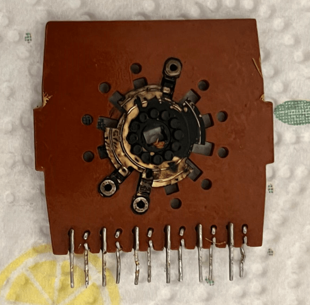

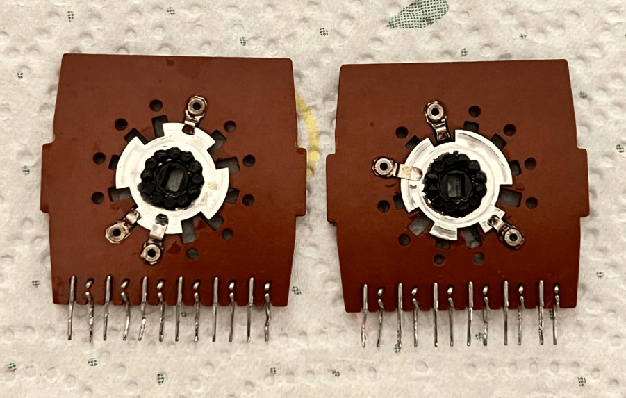

I reported earlier that the unit was working fine, but it has some troubles:
The Alps rotary switch for Stereo/Rev stereo/Mono switching before:
Both channels restored:
I think I will open a thread myself for this C-200L restoration...
C-280:
C-200L:
- One channel cutted out regularly. I've solved this by taking apart the Stereo/Mono selector switch (who even needs that switch?) and I restored the contacts of the switch. It is a classic Alps rotary switch which all suffer the same problem of oxidation. I restored a few of those in my life. It was really dissapointing to see the the engineers placed relays everywhere for signal switching, but the audio signal goes through a simple switch for this function.
- The right channel has lesser output. I have to set the balance pot to 3 o'clock to have equal volumes left and right.
- It runs pretty warm/hot, but the may be normal due to it operating in Class A.
- The subsonic switch creates a gnarly hiss/crackle over my tweeters when pushed on and off.

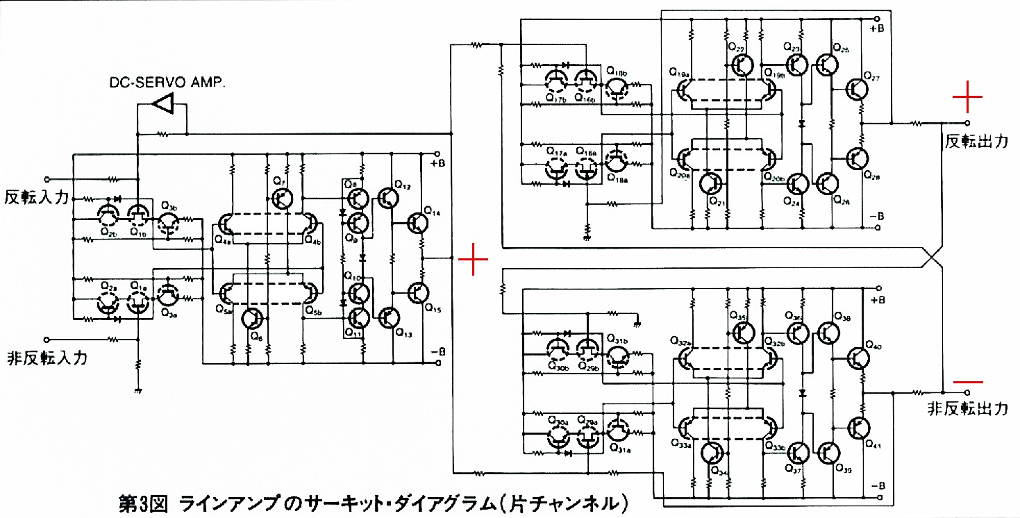

Balanced Line Driver with Floating Output
