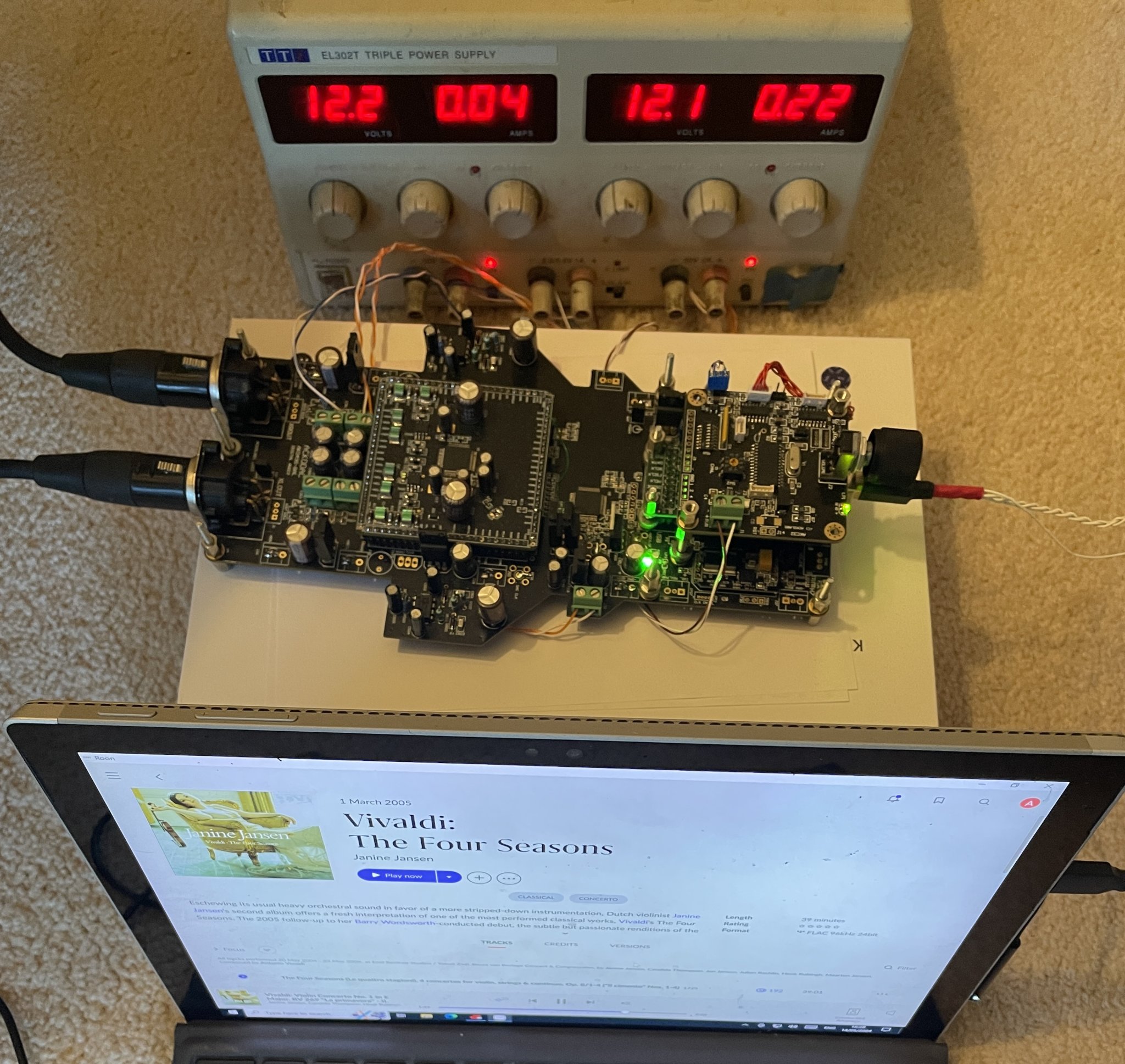

Firmware development for the controller completed and loaded onto Controller. Marathon effort to effectively control two chips of this AKM dac, including dual mono mode. Early tests indicate successful ‘lock’ and some control functions working as intended - no audio feed yet. Next step, to confirm all registers set properly and then live tests
Designing is not an easy thing. Good Job!Thanks for your support and patience. yes taken some 2yrs of work on a fairly complex design but rest assured very easy to setup for the standard configuration. Planning for production now so won’t be long
How it sounds? I'm only listening in mono mode. I'm curious how single chip in stereo sounds.
Testing… @DSD256
DAC needs +/-15V master supply (9-15V). On-board regs distribute to all different sections. Simplifies power supply arrangement. If preferred, on-board ones can be bypassed for choice of external supplies for just about every section e.g. batteries, ultra caps etc..
There is also a DSD Volume bypass mode that is more direct and possibly even higher performanceTesting… @DSD256
