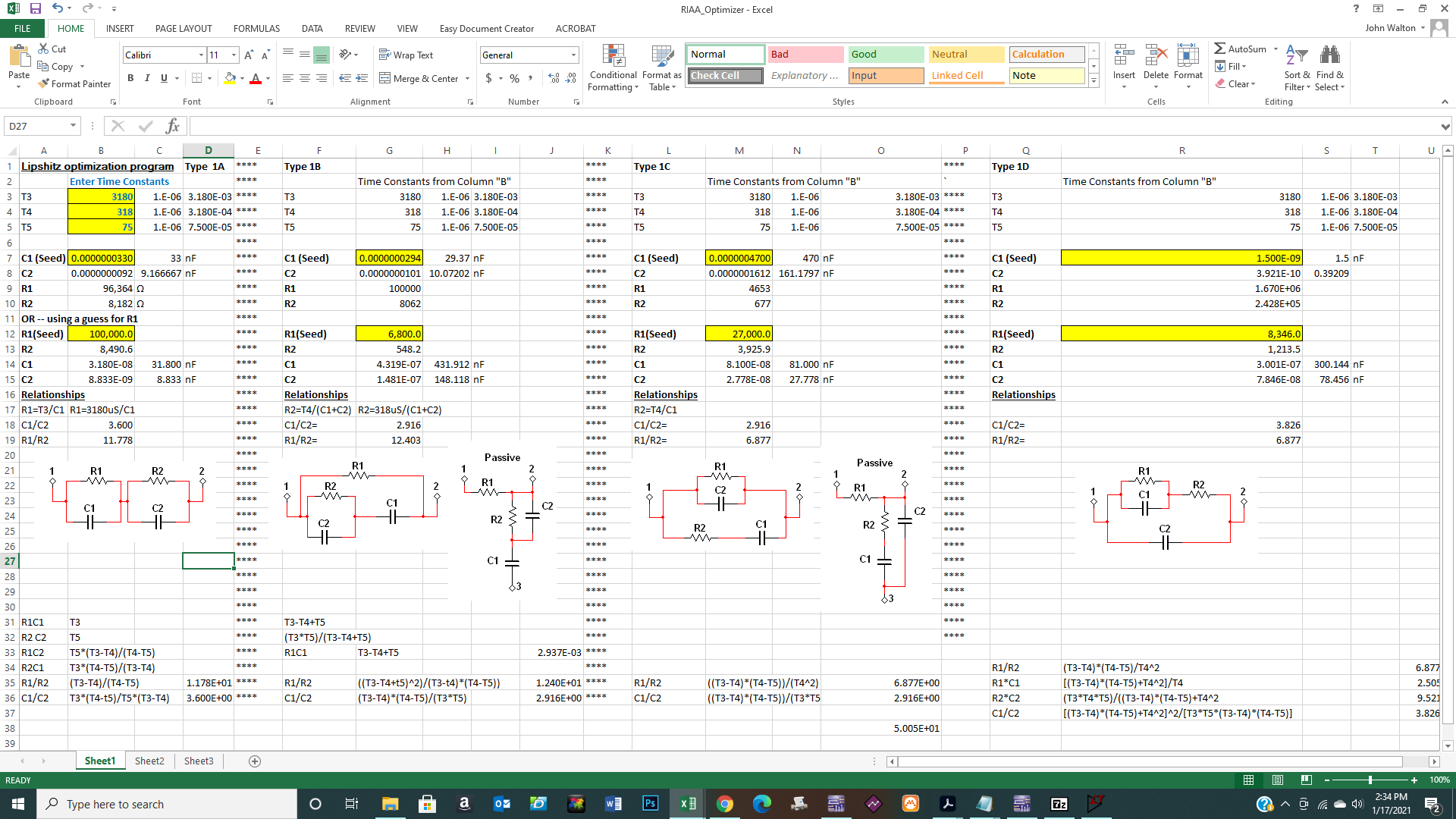

Thanks for the file, nice! I downloaded the program, it is very complex, but, starting from the file, I can start simulating.

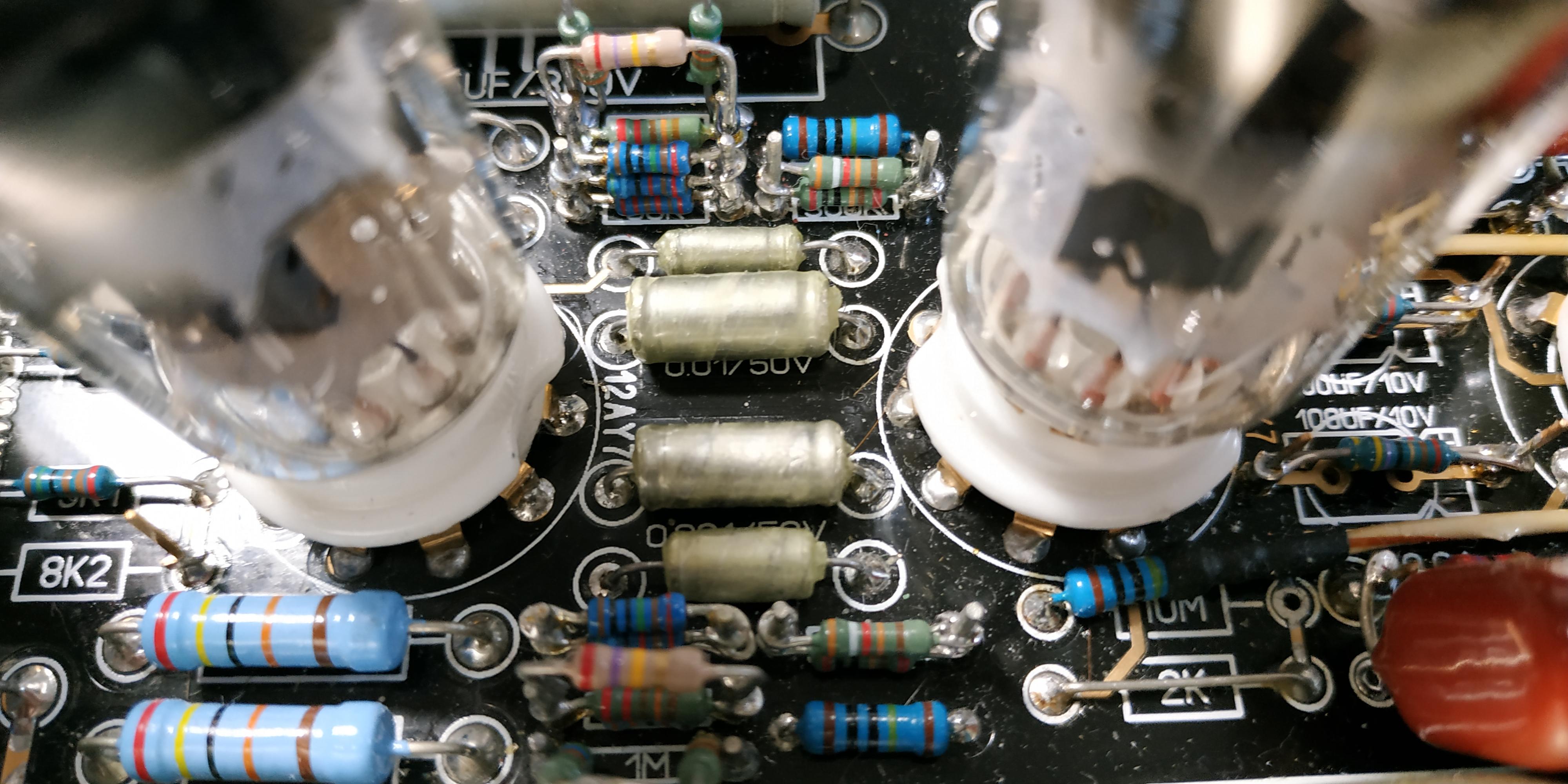

I have an EAR834 clone, in which, due to heavy load reasons, I have implemented a 6n6p as follower cathode. Excellent results. :D
I wanted to implement the AR sp3/6/8 riaa configuration, in order to be able to operate more freely on the working points of the V1 and V2 stages and because I think it is "better" for other aspects.
The AR riaa configuration is with new AR component values ​​and connected to the cathode of v1.
Everything works fine. :D
The only problem is that now I have the same gain as AR, which is about 35/36db against almost 50db of EAR.
For my audio setup, 35db of gain is low.:(
And now the milion dollar question:
Can this AR riaa configuration allow you to have a gain greater than 35db?
In my setup I would like 45/48db.
Or, to have this gain, am I forced to go back to the EAR riaa, connected again to the v2 grid?

The problem is that on a pcb they are complicated implementations.
I struggled a lot to adopt the fully functional AR riaa.
I struggled hard with layout-related swings (noises, whistles, triggers, high frequency oscillations).
A simple question:
how many components must compose a passive ria between v1 and v2. I ask to think about the space available.
AR riaa is with 2 cap + 2 resistor (except it needs parallels)

That was a bit inconsiderate response by me -- 1b and 1c can be used for active and passive. The resistive elements become the feedback resistor in the network active RIAA comp network. This being said, you need to know the impedance to get all the bits right.
If you are going to use 1b or 1c in a passive "sand-state" network the anode impedance becomes part of "R1"
Lipshitz paper deals with this, quite difficult to dilate without the paper.
