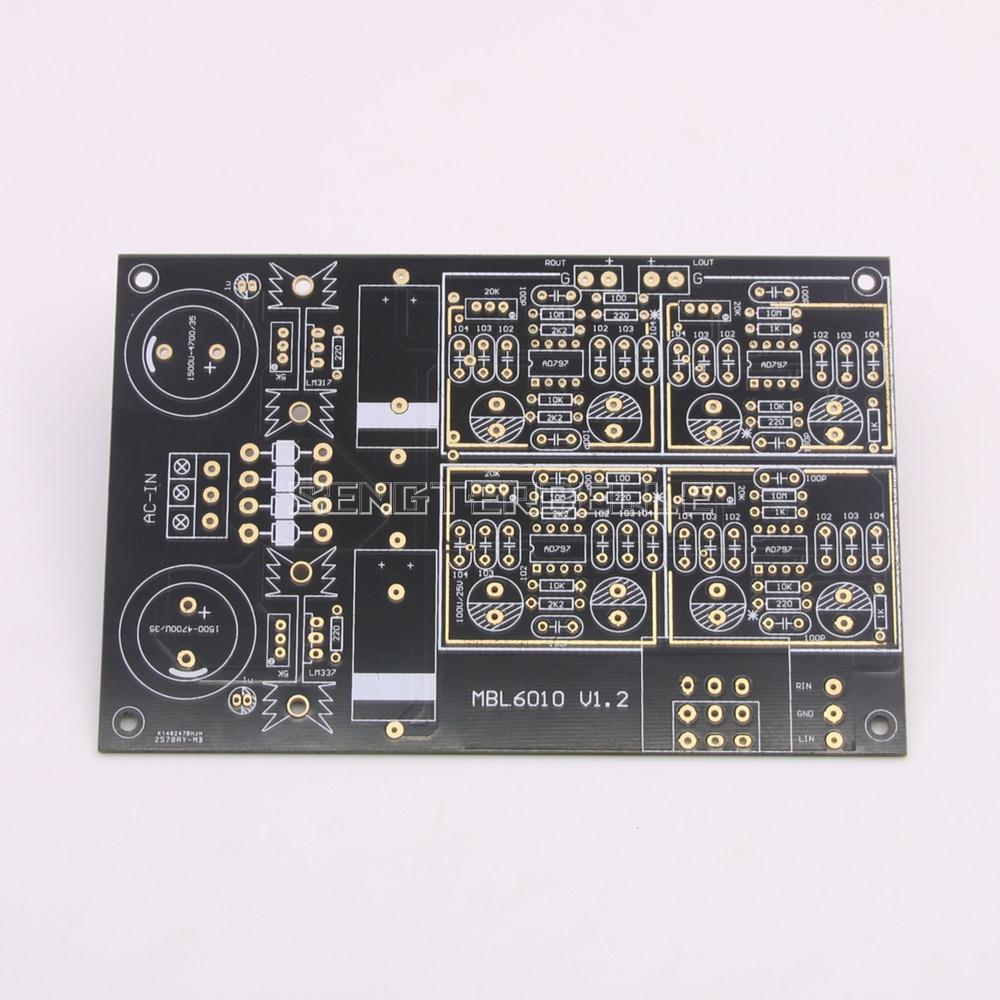

Meanwhile, my package has arrived too and I have tested the board. The board sounds good but as it is almost certain that components are all fake I have initially decided to desolder everything and rebuild it with genuine components.
However, I've found a better solution: bare boards of the same 1.2 version (shown on image 1 below) are also available <HERE> and I will build it from the stratch as the board itself seems to be proprtly designed.

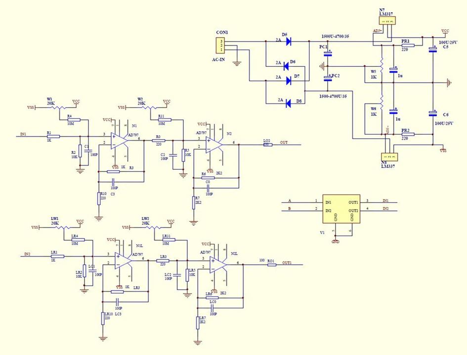

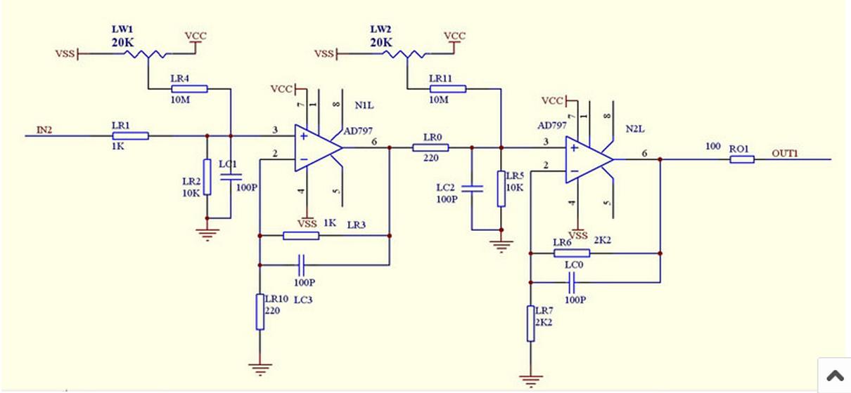

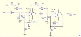

I also have stumbled upon the schematics of the board (shown on image 2). below.

There is no need to use an external power supply since the existing on-board power supply is adequate, you just have to make proper adjustment. Originally, the board is set to +/- 15.00 VDC. I have adjusted voltage on two 5K potentiometers that are located behind the heat sinks. Now, it measures +/- 17.5VDC. You can measure the positive rail voltage on the IC pin #7. Similarly, the negative rail voltage can be measured in the IC pin #4. Adjust the voltage slowly because response to changes at potentiometers is slow.
Furthermore, it is necessary to set voltage drift to zero at all four ICS. As usual, the Chinese instructions are wrong.
Here is how to adjust voltage:
Before you start, observe the board: there are four rectangular areas: the lower two are for the left channel and the upper two rectangles correspond to the right channel.
Also there are two small holes on the PCB between these two 220 uF axial capacitors. You can use them for the ground probe during measurements.
1.
First set the input potentiometer to max volume to have good response to subsequent changes. Otherwise you might see no changes at all if the input potentiometer is set to zero.
2.
Start with 20K potentiometer LR4 which is located in the lower right rectangular area at the board See the attached schematics. Adjust voltage at IC pin #6 to zero. I have measured that voltage at the left side of 220R resistor located in the lower left rectangle on the board.
3.
Proceed with the 20K potentiometer in the lower left rectangle and measure the voltage at + output of the left channel and G. Now the left channel is adjusted.
4. Repeat the same procedure for the right channel.
Now, the device is ready for use.

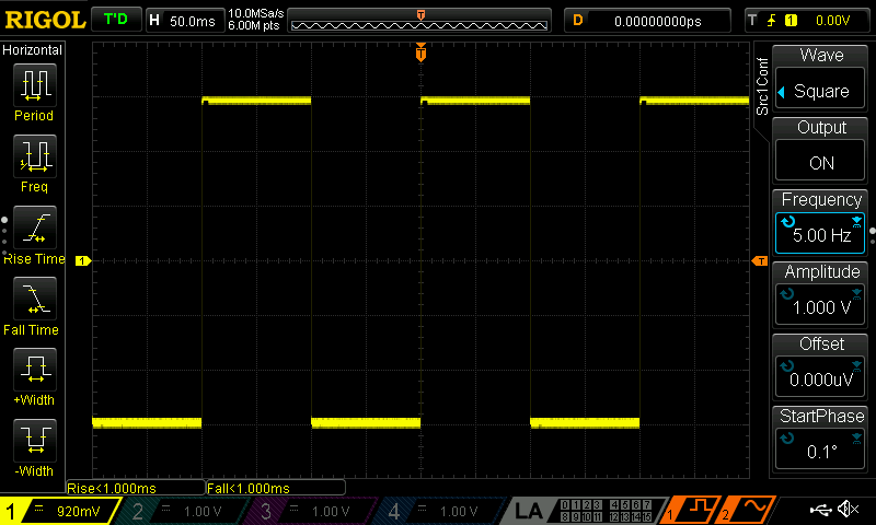

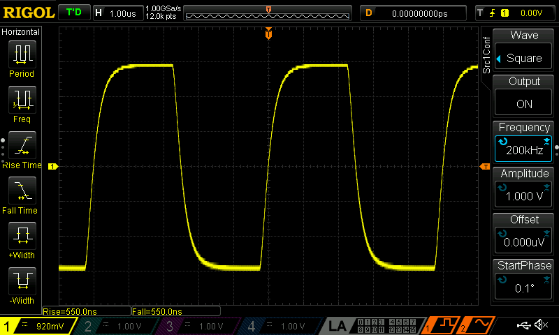

I have made some measurements which indicate that the preamp is virtually "a wire with gain" over a very wide range of frequencies. It has entirely flat response between 5Hz and 200KHz.:eek:

Now, let me present a couple of measurements at the extremes: 5Hz, and 200KHz along with the response to 10 KHz wave.
In all three cases we have 1V square wave at the input.

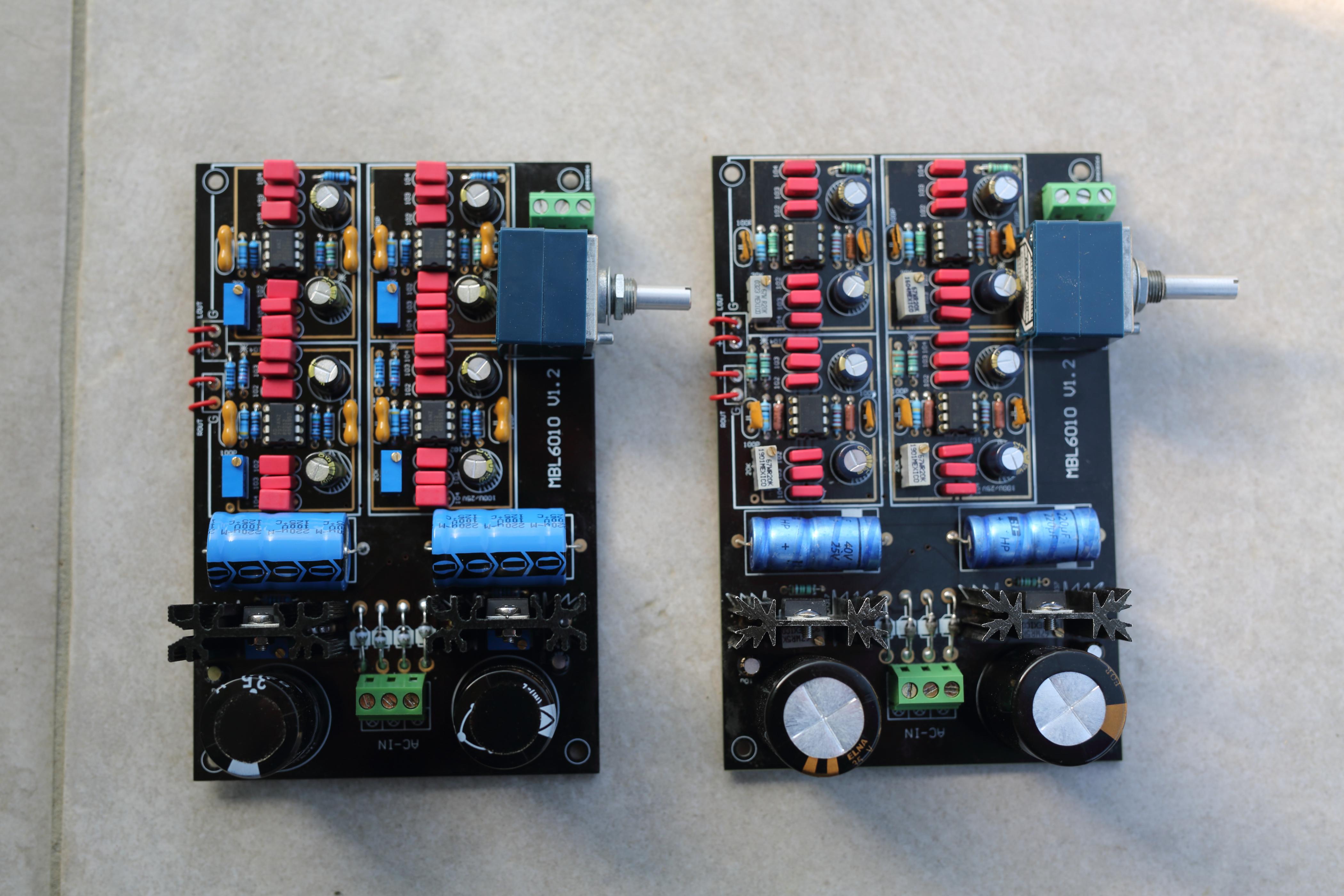

I haven't made partial replacements. I have changed everything, altogether: with components purchased from Farnell (reputable UK supplier from Leeds). Just the bare board was from China (Aliexpress).
Meanwhile, I have returned to the original +/-15.00 VDC because there were no benefits from the increase of the rail voltages to +/-17.5VDC. Also, the data sheet indicates that the maximum value is 18.00VDC.
But...
I am confused with your information that your board does not have regulated power supply. Are we talking about the same board?

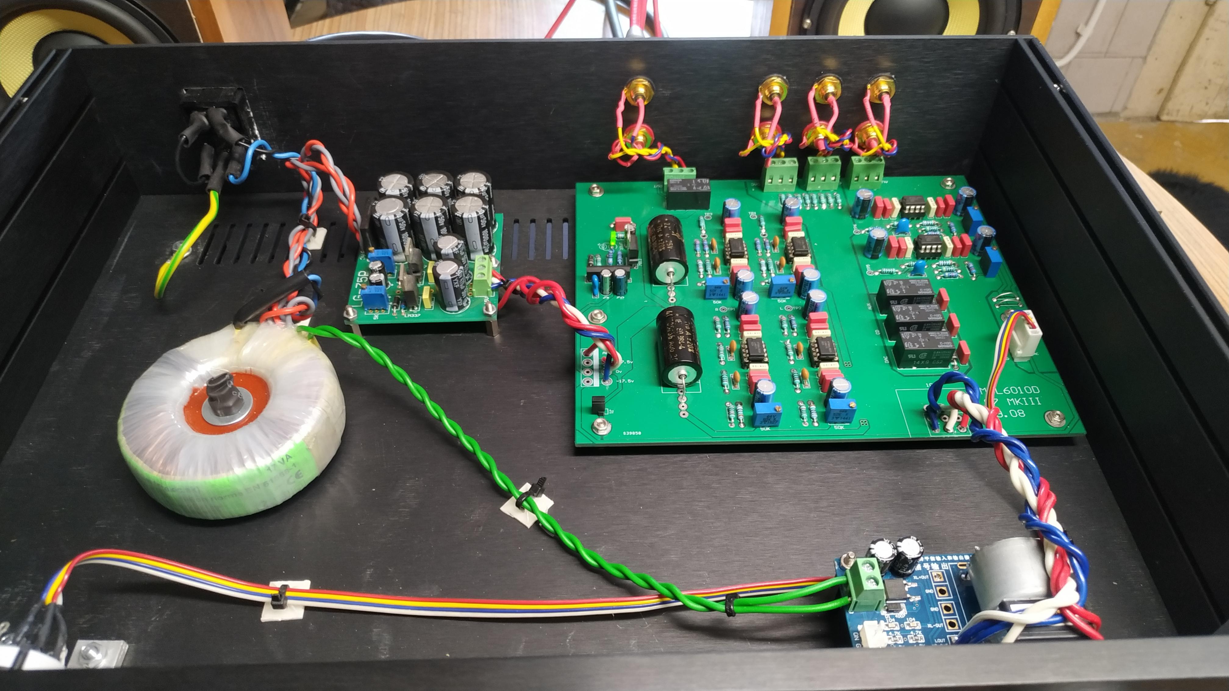

Below, I have attached a photo of Chinese board (right), and the board I have assembled (left). Note the different parts.
Regards. :)
Hi, One of the problems we have with this thread is that we are often taling about different board.
I upgraded my P/S because I was getting a little hum, now it is dead quite, however my Pre Amp board did not use 317/337 voltage regulators & had no voltage adjustment on the power supply of the board.
I have now replaced the cheap & cheerful V/C with a Tocos unit, which has opened things up a bit more & noticeably improved the top end.
Cheers
Ah, I see now, we have different boards: this is yours:
HIFI MBL6010D Preamplifier Preamp Board Tone adjust Fit For NE5532 NE5534 OPA 228243292918 | eBay
