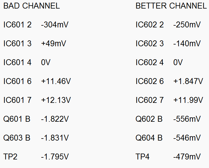

Here's the measurements you asked for.
I wonder if both channels have the same problem, but one isn't as bad as the other yet.

Thanks. Interesting readings.
In the bad channel, the servo opamp appears to be desperately attempting to correct the amp's offset error, but it's more error that can be corrected.
In the better channel, the pin 6 voltage suggests the servo is within control range, but results are not good.
Do we have a data sheet available for the ADCOM 3A opamp? It looks like it's a bipolar opamp, or is defective. I say this in view of -140mV on pin 3 in the better channel. The design uses large 4.7M bias resistors, so your meter load resistance is affecting measurement. I suggest using the meter to measure between pin 2 and pin 3. You should see only a few mV.

A new opamp may fix the better channel. There may still be other issues. I believe the bad channel also needs a new opamp, but I'm less optimistic that it's the only problem. But working opamps will simplify troubleshooting.

Yeah, your op-amp inputs, pins 2&3, should be the withing a few mV of each other if it's able to satisfy its feedback and DC operating point. The "BAD" channel op-amp looks like it's op-amping as hard as it can, with the inverting input so far negative of the non-inverting, it's doing what you'd expect, sticking to the positive rail. The "BETTER" channel op-amp indeed looks defective, it should be going more positive than that. There's nothing really loading the output but a 1.5M resistor, so if it wants to go positive there should be nothing stopping it.
The ADCOM 3A is actually an LT1006 and there's no good reason to use anything else. The AD820 is also proven and pretty much the same thing but more expensive. Don't pay more for low-offset parts, it only make a couple mV difference at the amp output.
Also, you can isolate this issue by simply lifting one leg of that 1.5M resistor on the output. Then you can see what the amp is doing without the servo confusing things. You should see some offset at the amp's output, no idea how much, but it should be in the same ballpark on both channels, same polarity.
