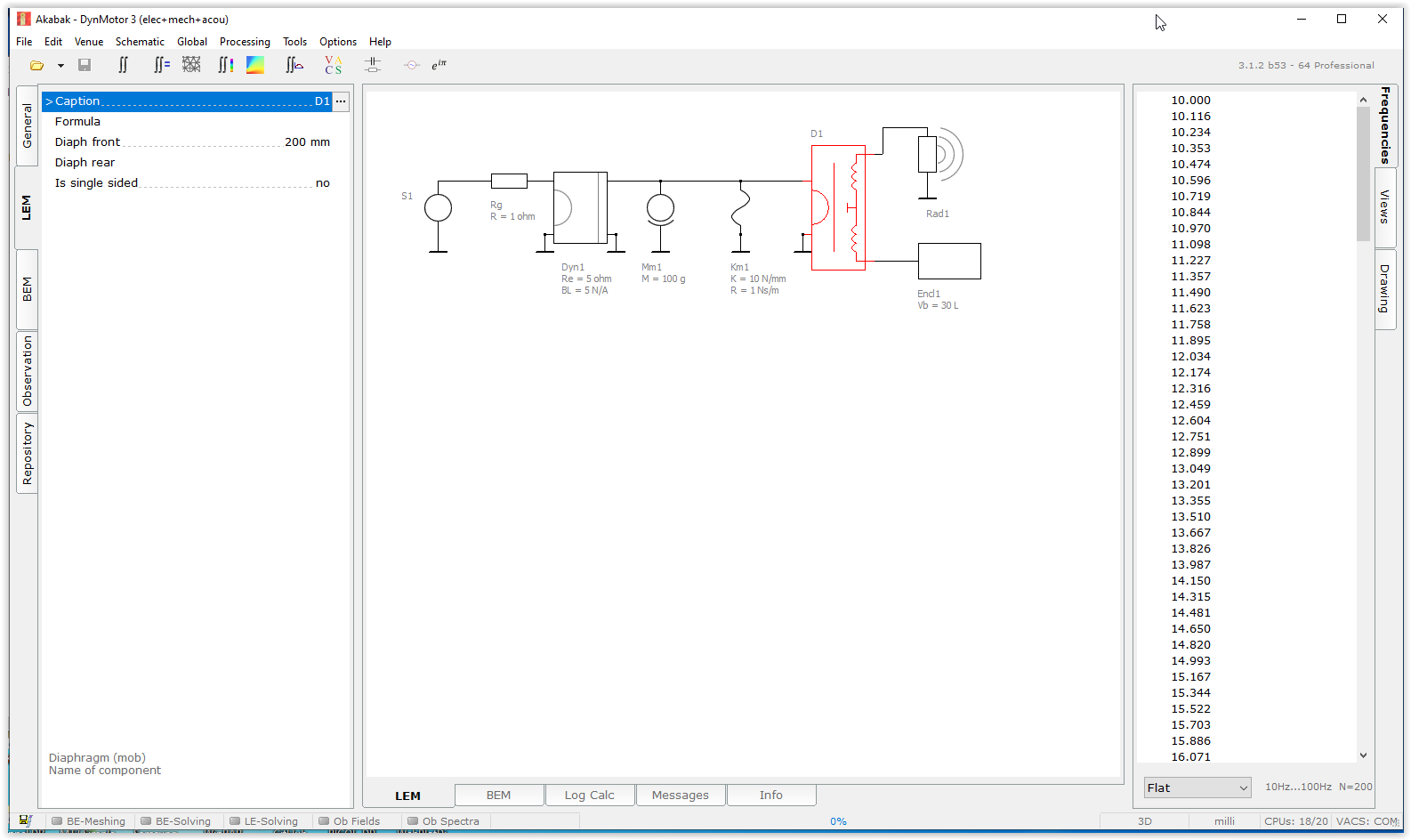

I just upgraded my ABEC 3 to AKABAK 3. The most difference compared to the former is the GUI. This is a big improvement to the original script based input for some users (me too). :)

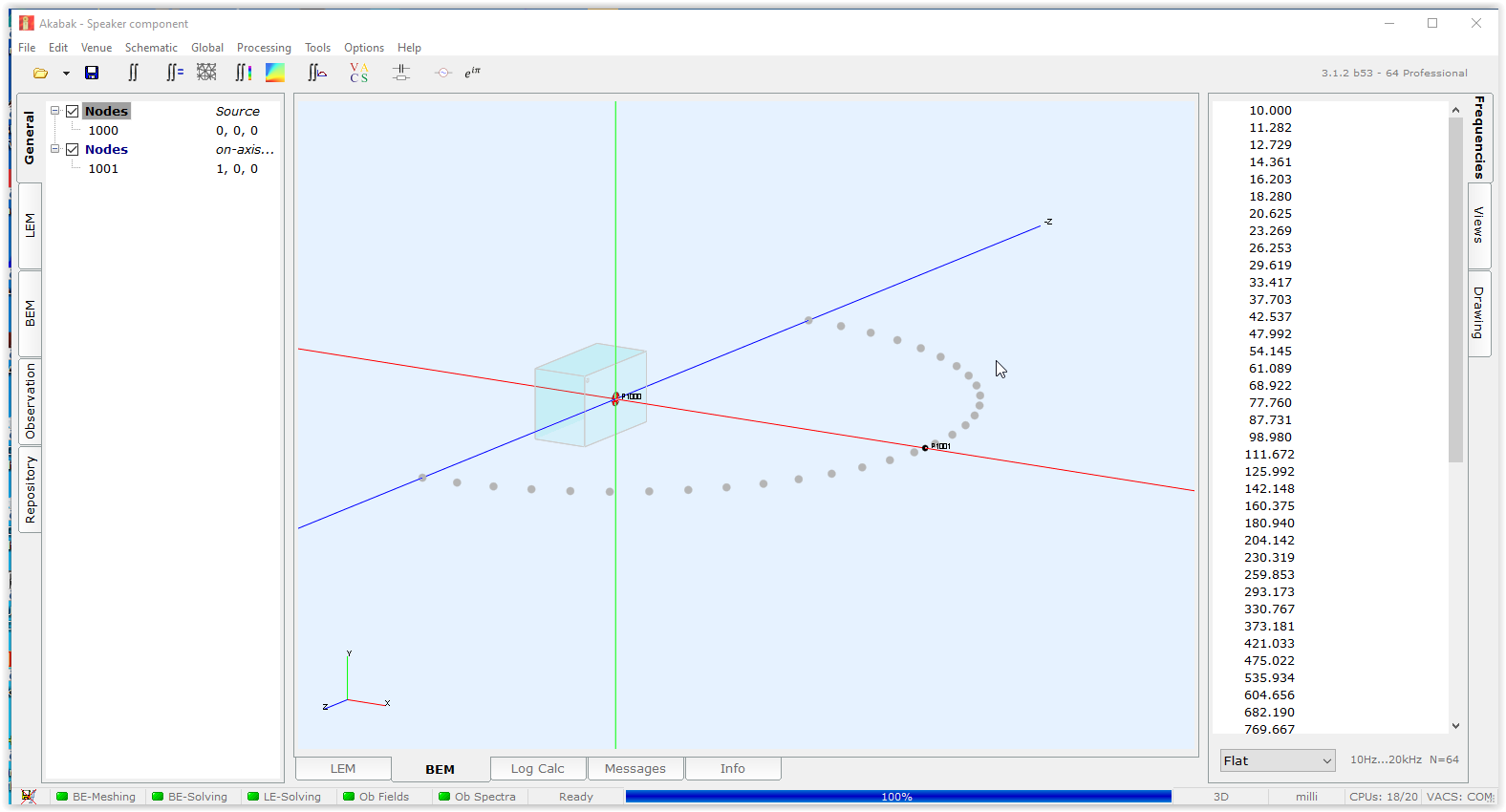

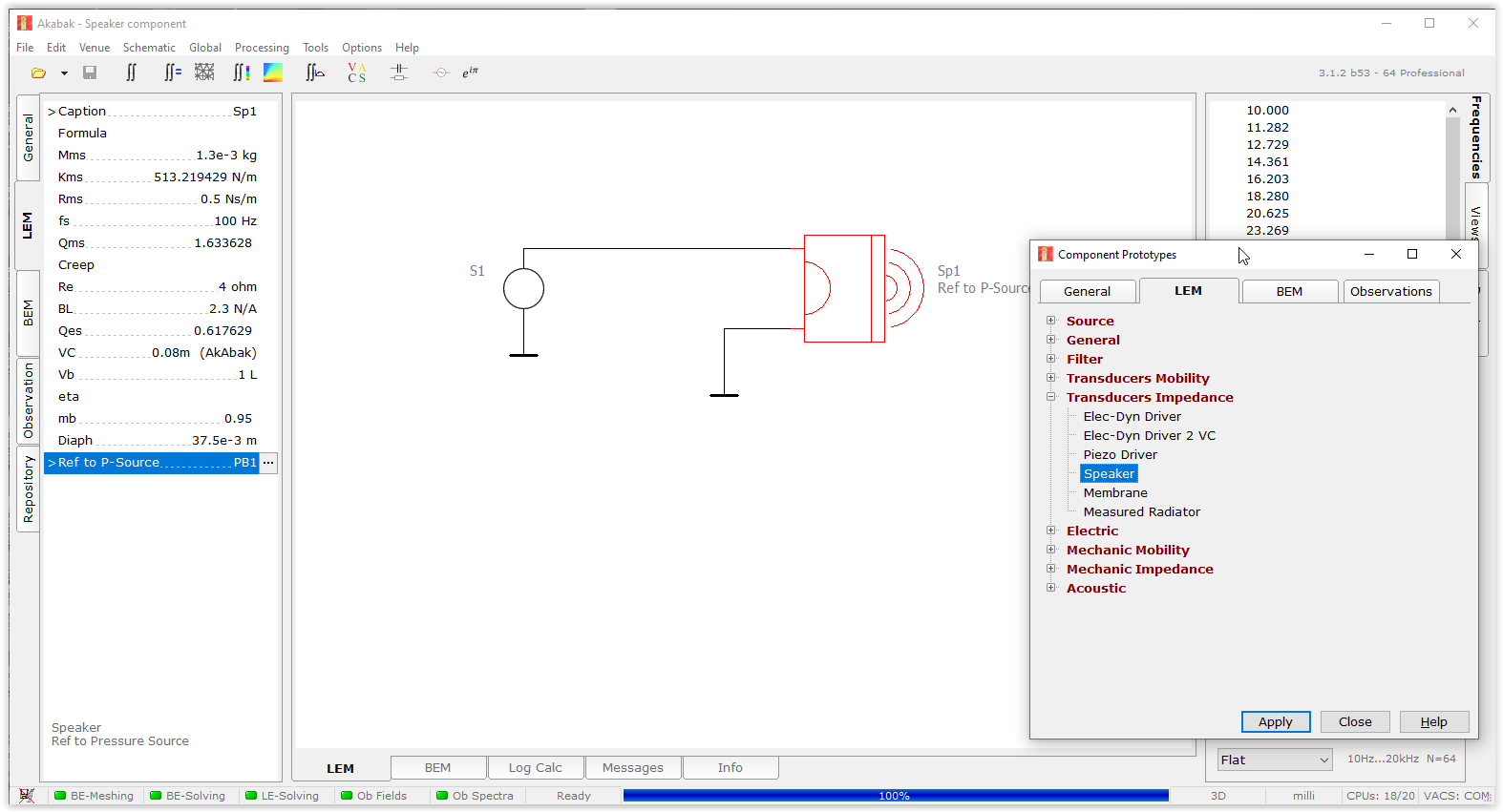

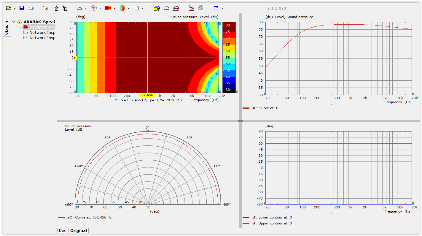

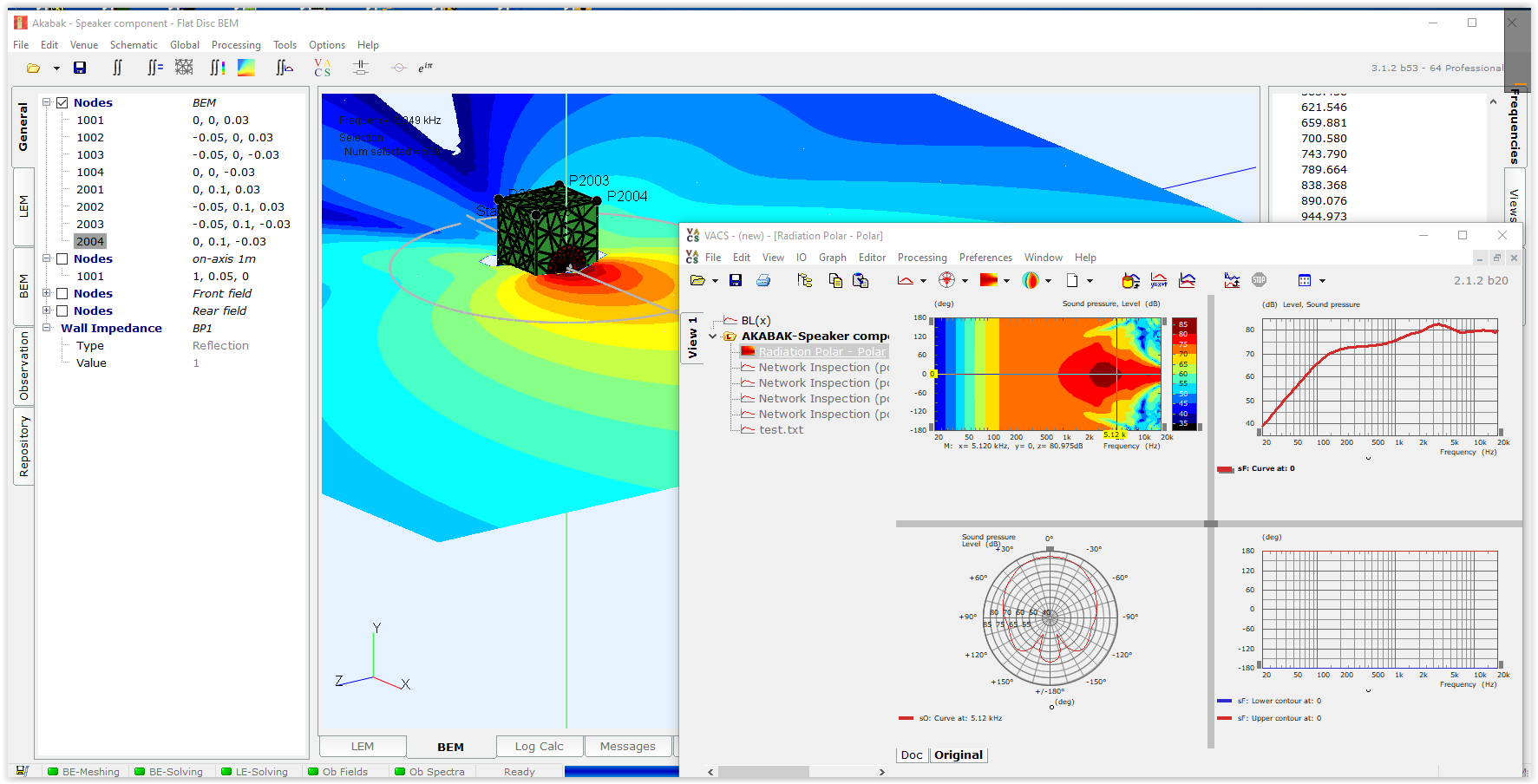

Speaker component example
A simple example for using Speaker component.
In order to generate polar plot and SPL at 1m, we need to add some stuffs for direct sound analysis.
The AKABAK file is attached as a zip file.
  • Speaker component.zip
I've used v2.1 - the script based version (when it still runs on Win7 desktop)
I guess your are referring to the legacy AkAbak.
AKABAK 3 is a new version of ABEC 3. It is not a new version of the original AkAbak. I spent considerable time to learn ABEC 3. Newly added GUI of the new version would not flatten the learning curve. However, it is useful and improves productivity once you are familiar with the "language".

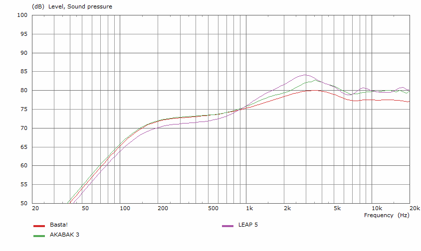

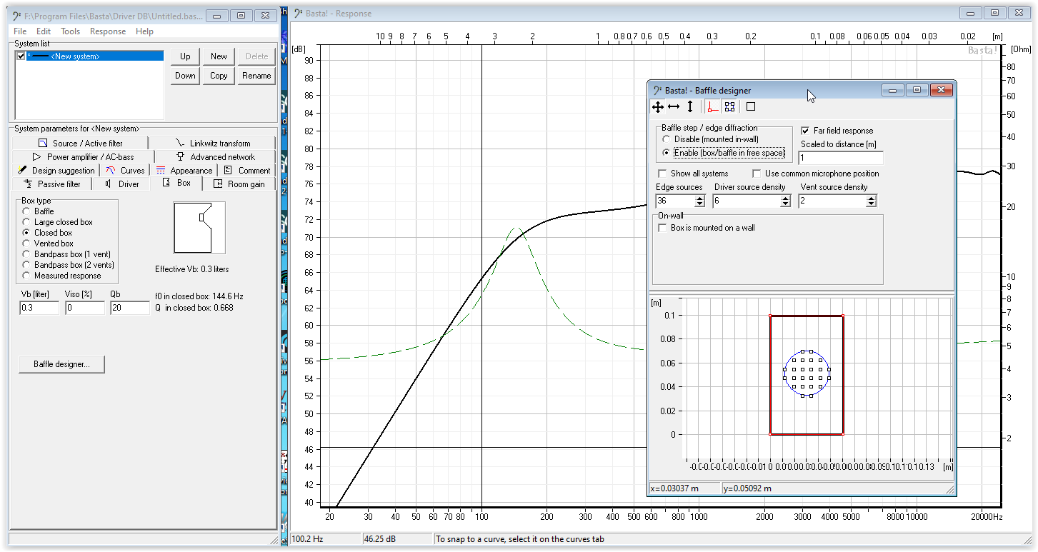

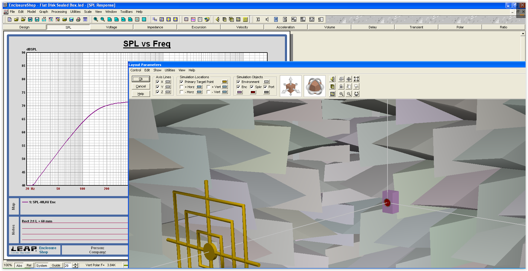

The following pressure box simulation is compared to LEAP 5 and Basta!.
The driver is a flat disc of diameter 37.5 mm. The sealed enclosure dimension is 0.06 x 0.1 x 0.05 (0.3 L). No filling is used. Free-space (4pi) is assumed.
Mesh size of AKABAK 3 is 0.02 m. The same scale is used in LEAP 5 diffraction resolution length with order of 4 selected.
Although Basta! diffraction is likely less sophisticated, its SPL tracks the trend of the other two.

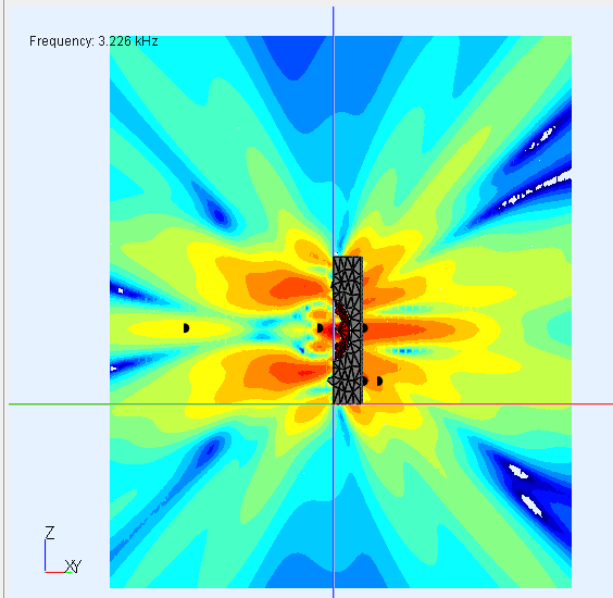

Simple sealed box simulation
The aim of this exercise is to familiar the design flow of AKABAK. A simple sealed box with a cone loudspeaker driver is used. In contrast to the previous pressure box (direct-sound analysis) example, we move into the “heart” of the software – BEM. There are more steps needed to accomplish it.
The enclosure and driver dimension are somewhat arbitrary. Outer dimension of the enclosure is 100 x 170 x 110 mm. Uniform wall thickness of 5 mm is assumed. Symmetry along z-axis is used. Hence, BMR parameter dialog is as shown below.
We therefore only need to define nodes of one-half size of the box and driver. Note we need to define both nodes for external and internal walls as depicted below.
Nodes for setting observation fields and points are needed as well. Two subdomains are used. Subdomain with EIType = exterior is used for the free space (enclosure external). Subdomain with EIType = interior is used for enclosure internal.
Neumann boundary type is set for enclosure external elements. On the other hand, wall impedance is selected for enclosure internal elements.
Shell component is used to model the driver front surface which is belong to the enclosure-external subdomain. The rear driver surface associated with the enclosure-internal subdomain is inherited from the front surface.
Lumped-element schematic is illustrated in the next figure. The parameters are somewhat “typical” for a 4” driver.
BEM and field mesh size are rather large to minimize computational time. Once the model has been solved with error, we can increase mesh density.
Enclosure internal ad external nodes.
Node for observations.
BEM exterior subdomain.
BEM interior subdomain.
Observation setting.
Result.
The file for download http://akabak.pansonaudio.com/Sealed LE+BEM Box 1.akp
Let me know if you find any error. Have fun!

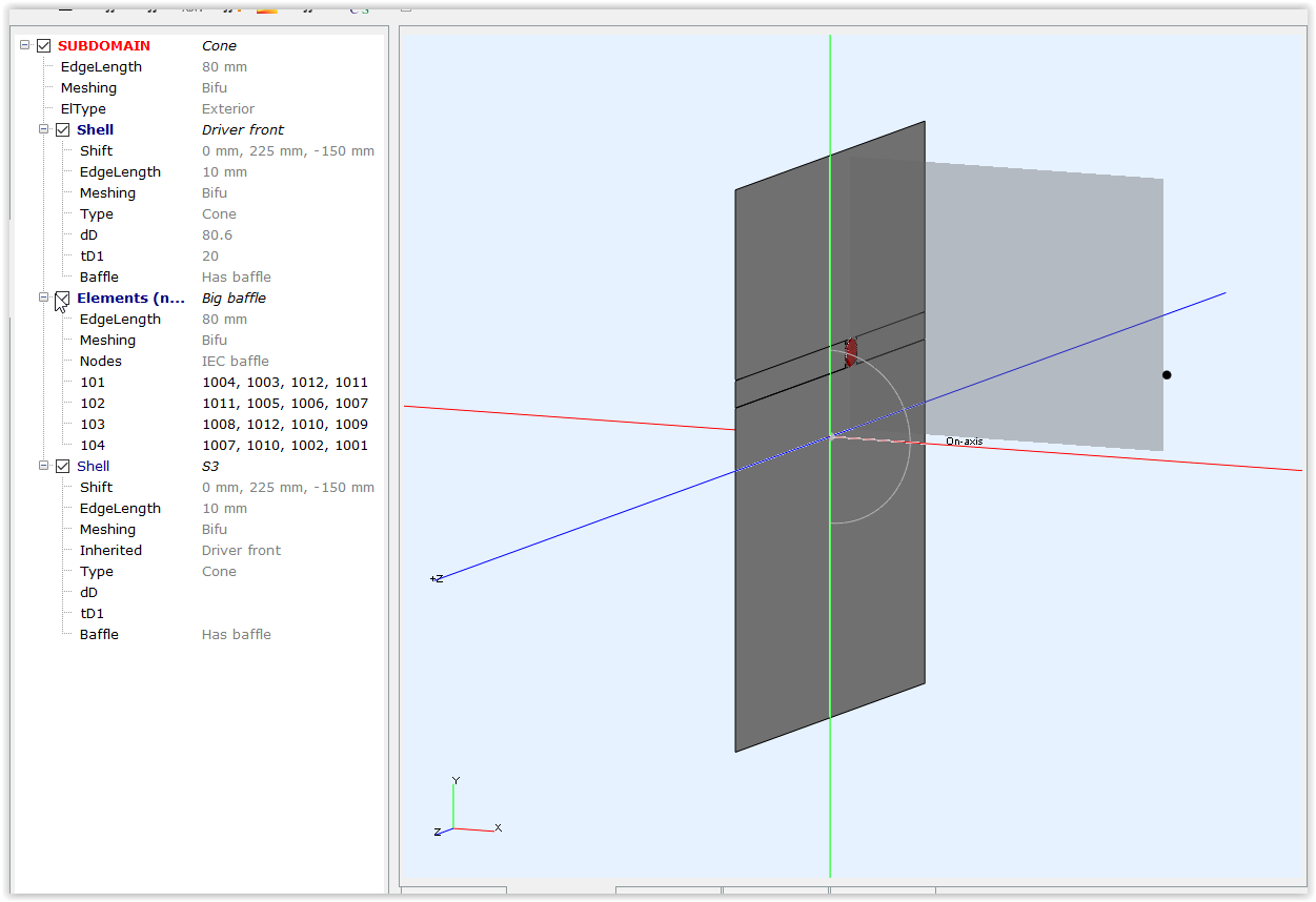

You may not need to exterior and interior subdomains for the overall OB. I made something similar before for IEC baffle. Please take a look of this project. Note that it is not completed and error free.
You can use shell or diaphragm element of AKABAK to model the driver. The enclosure should have a hole for the element to "mount".
