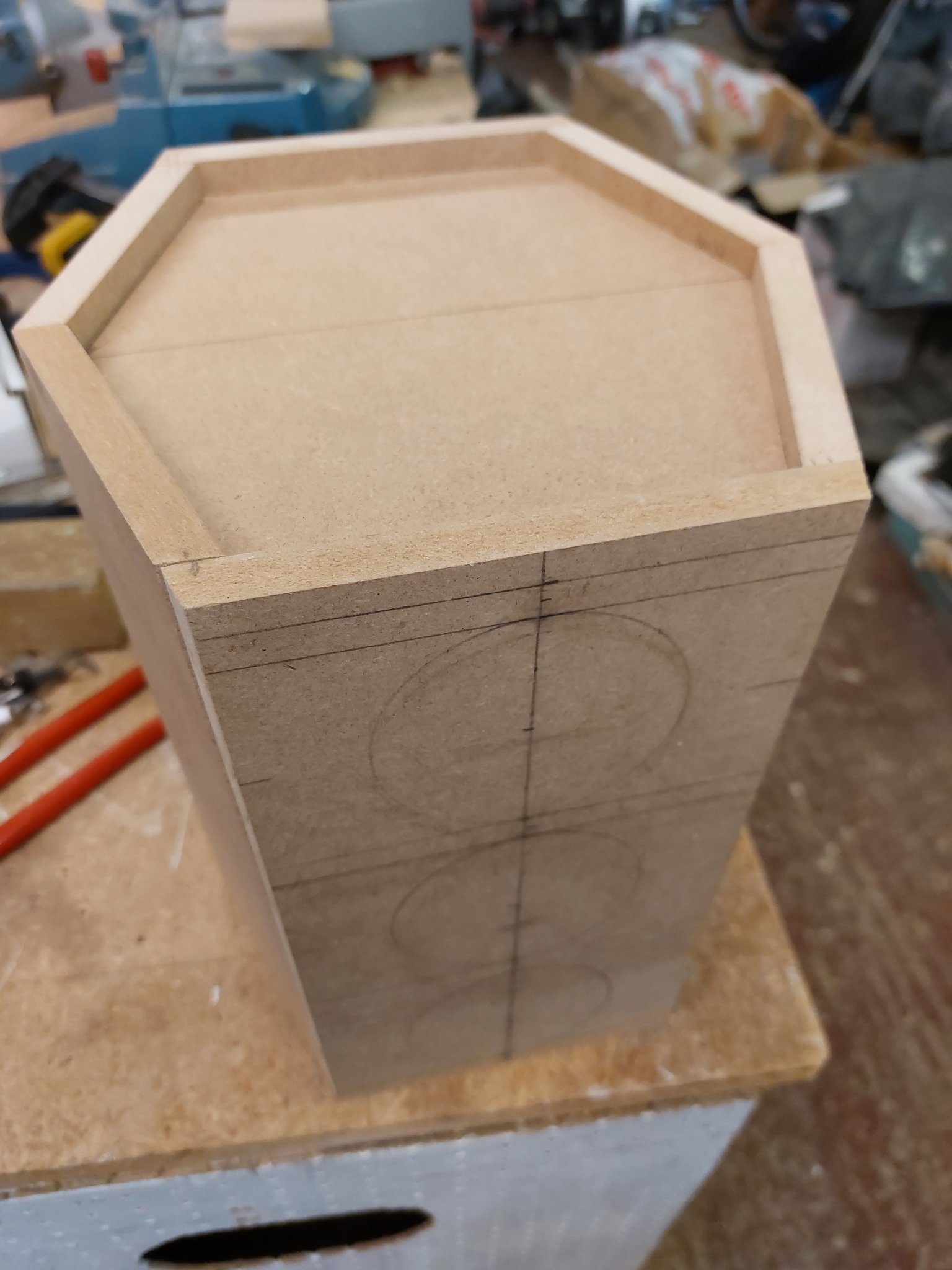

1. Bearing in mind the hexagon reduces panel sizes, is 12mm MDF thick enough or a benefit with thicker? Should all panels be the same, thicker baffle is a problem with back cut away.
2. Each cell will be sealed, does that solve some of what i read as a potential problem
3. What wiring lessons have been learnt
4. What might an optimum stuffing be?
5. Should i build a working cell and test it, bearing in mind i know nothing about that procedure?

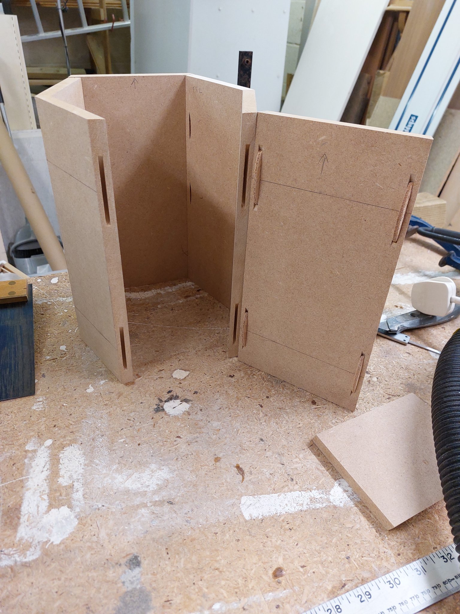

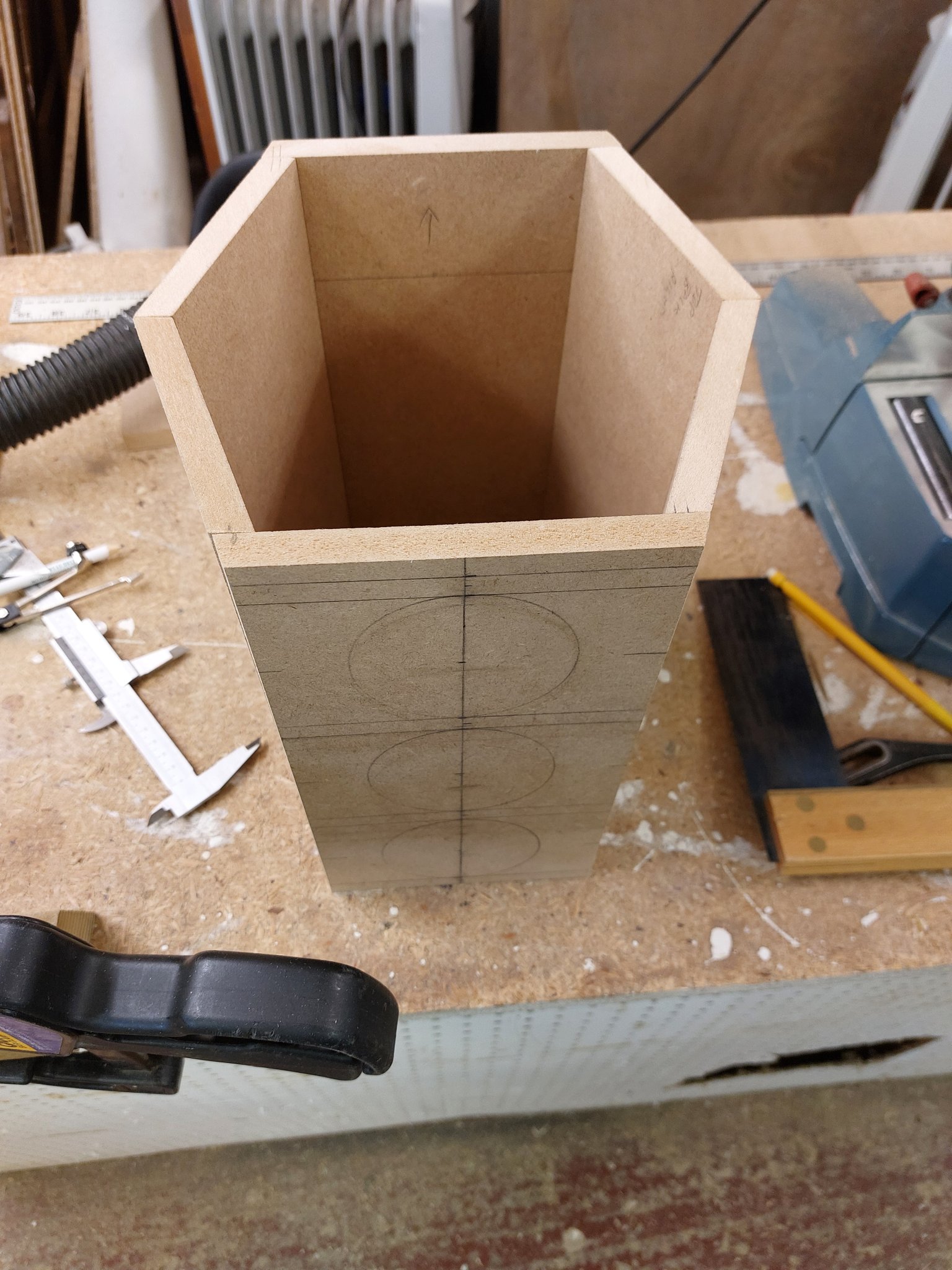

Right now i am working out good ways to assemble the cabinets, teaching myself how to make repeatable angle cuts etc.

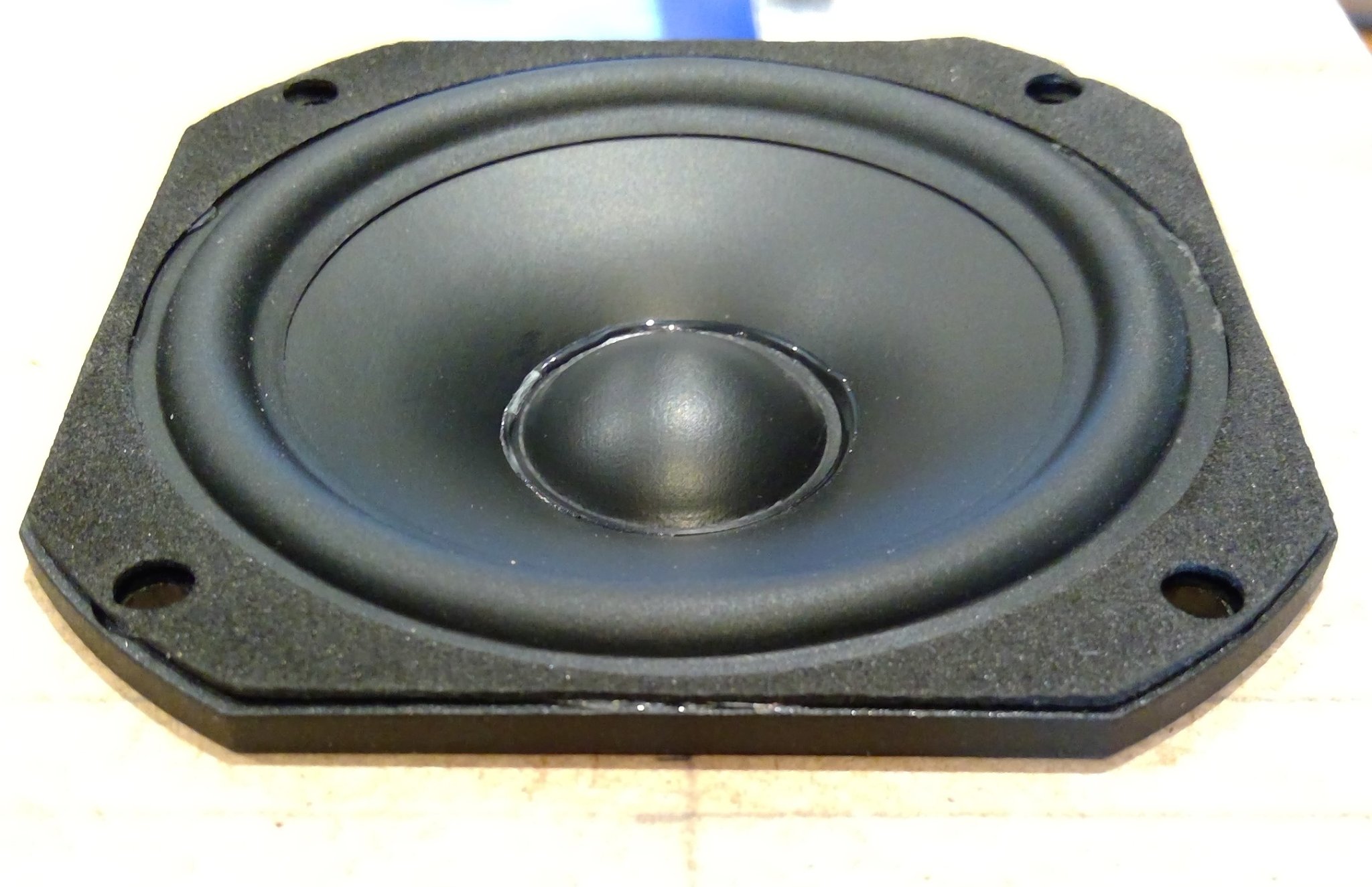

I have, as many other I know, made such arrays and the drivers are so closely in specs, that you would not gain anything by maching them. Wesayso have measurements of the resonans frequency of his fifty drivers on his thread.Fifty drivers?…..and you would assume that all fifty were consistent?…….i‘m guessing you don’t have a firm grip on the reality of manufacturing.
Not that many drivers have a proven track record for production consistency like the TC9. The consistency of these have proven to be way above average.
More than one threads with impedance tests are available.

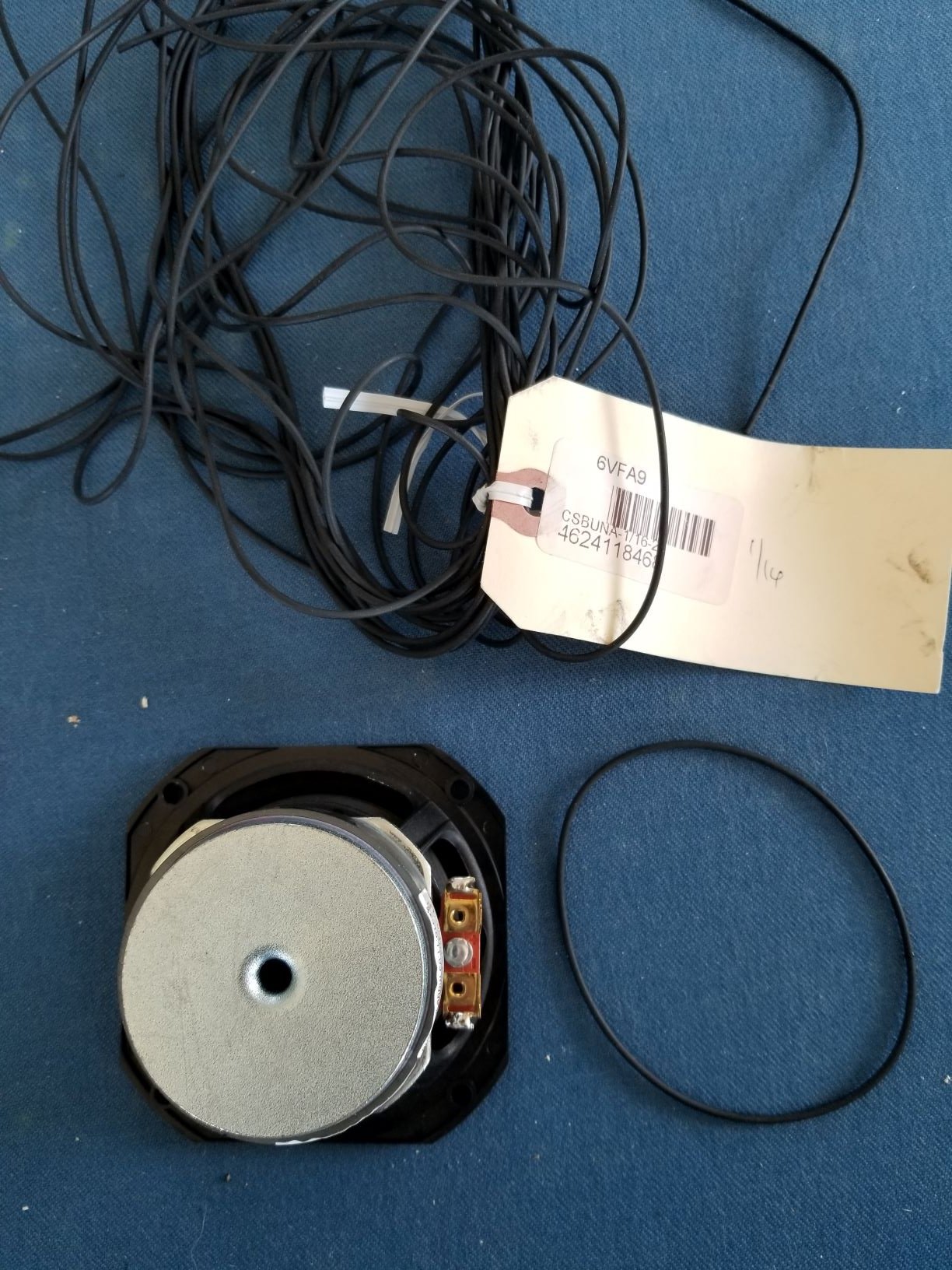

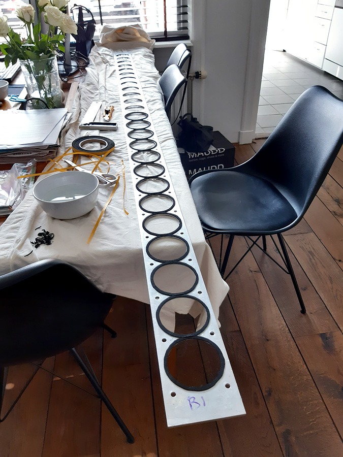

I made O-rings out of 1/16th inch rubber cord. Super glued ends together. Worked well and was pretty easy to do. Took about an hour to make 50 of them.That seems a very sound proven background to depend on!

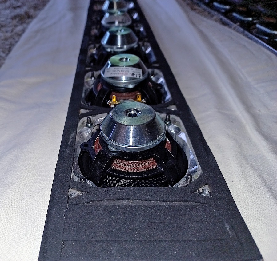

For mounting, i am currently thinking something like a self adhesive neoprene tape as the back of the chassis has no gasket.
Anyone have a recommendation for this please?

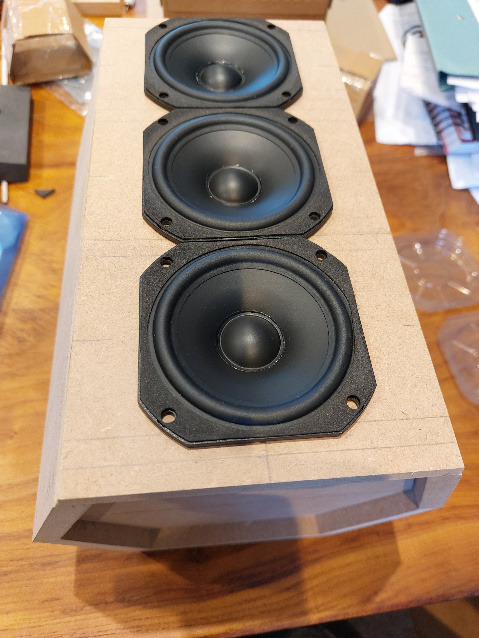

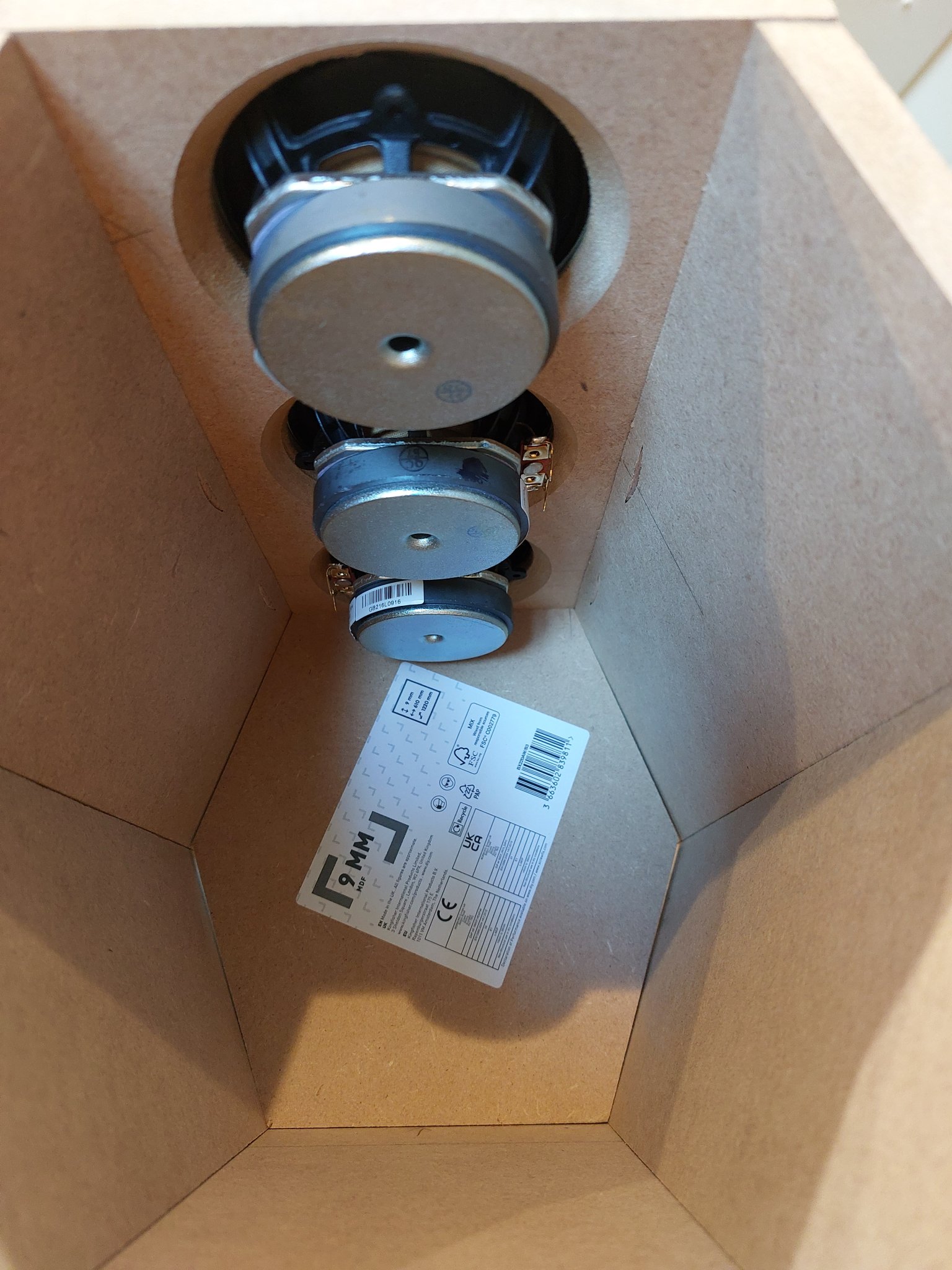

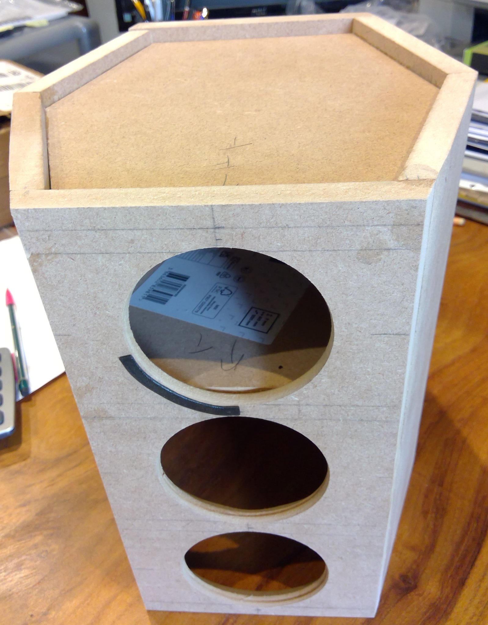

Meanwhile here are the drivers in the mock-up, all fairly easy to do, i only did one divider plate, but think i have proven all the techniques now except how to line the cabinets. i have the felt i've used for lining before, just need to consider how best to attach it. i currently intend to glue all parts permanently but this means i cannot get in there again as the driver hole is smaller than my hand, if i make the back a removable piece its a PITA? if i used neoprene tape i could do the back as well, if its thin...
You bet.Thanks@Mark100, it seems that would need to be quite soft rubber to flatten out nicely, is that correct please?
The rubber is pretty hard really. I just didn't crank down the mounting screws, because I didn't see the TC's frame as all that strong to begin with.
After some fairly careful measuring, I don't think it matters much how well a sealing surface is formed...., I say just do what works easiest.
