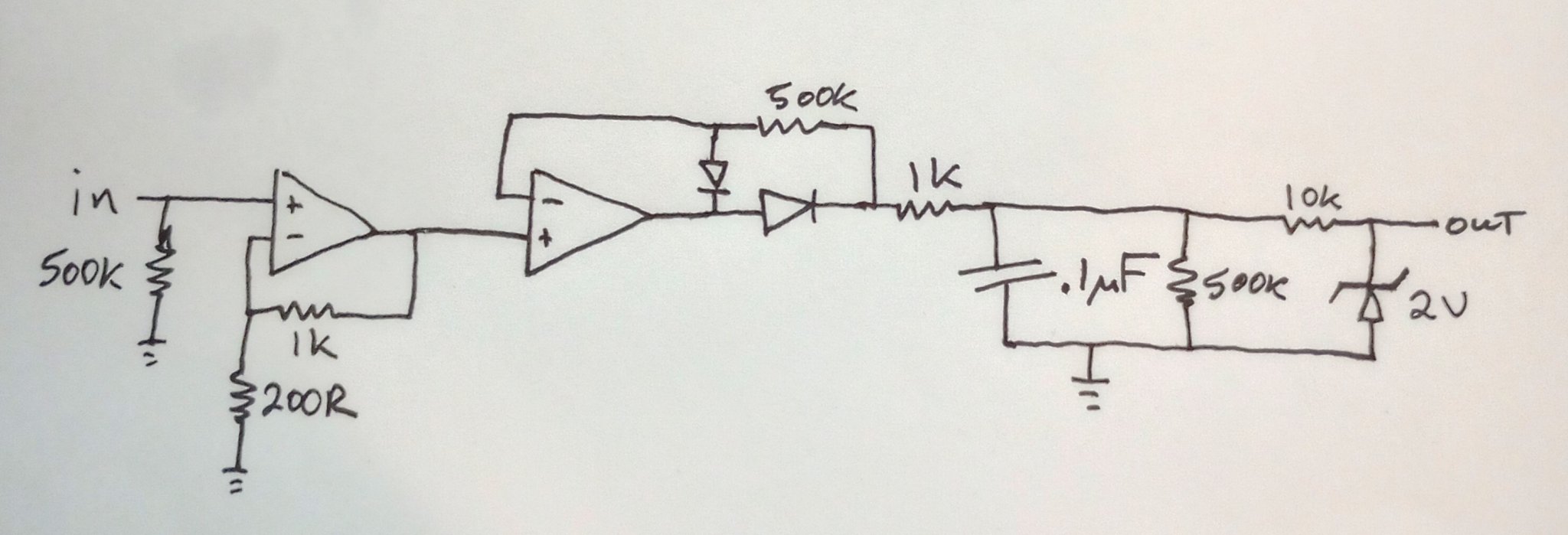

Yeah, I've just got the switch permanently wired to GND so mine will bias over and over. But that's not necessary if you want more control of when bias happens. You could also make a circuit that detects silence and tie it to that input, if you feel like your amp needs silence to bias properly (maybe a good idea for a class AB output stage).

Next on the list is silence detection and shutdown for an unattended amp. I think I also want to add a switch to turn on/off the display backlight. I might want it off or very dim in a dark room.
