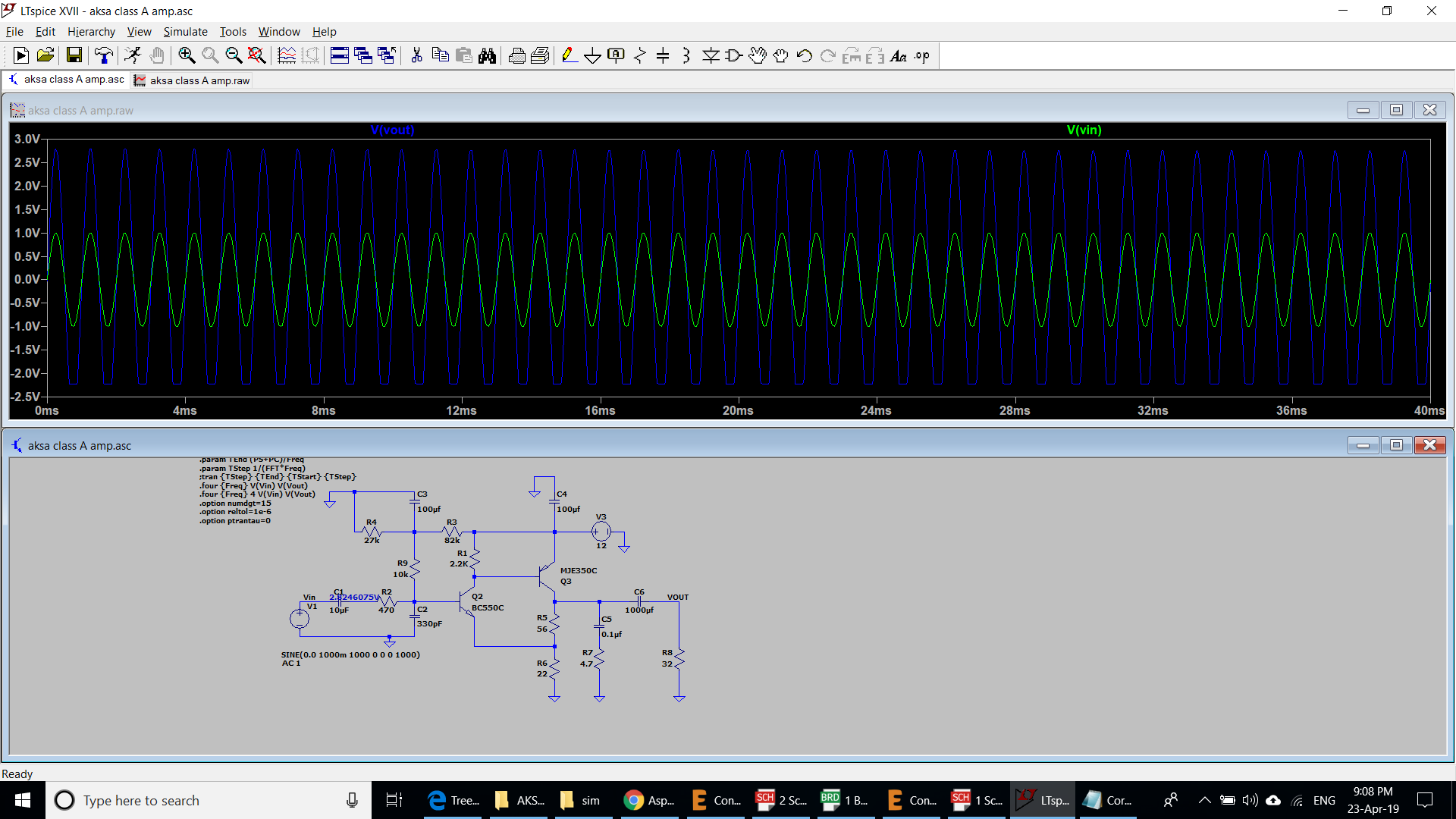

I tried changing some stuff in the schematic posted by Nico Ras. This is what I finally built on a breadboard.

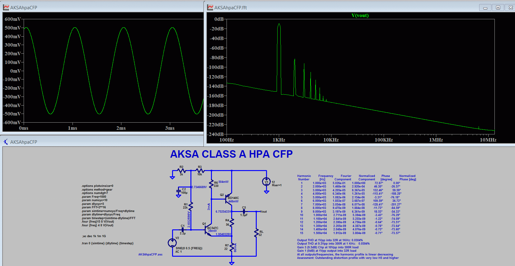

I have reworked it for best performance, but there are limitations with only 12V and a stiff 32R load. Both limitations increase the THD but the harmonic profile is still very good, with typical THD of 0.03% at 1Vpp into 32R load at 1KHz. H2 is dominant.
At 32R load you are limited to an output of about 2Vpp. At higher impedance loads, such as a 280R Beyerdynamic, your output voltage rises to 9.2Vpp, which is very loud indeed.
Your resistor divider for the input voltage reference is a little off, and you should use a bias resistor of 22k, rather than 10k, to minimise changes to the divider reference voltage.
The adjusted schem is attached. Nice circuit, sounds wonderful!
Hugh

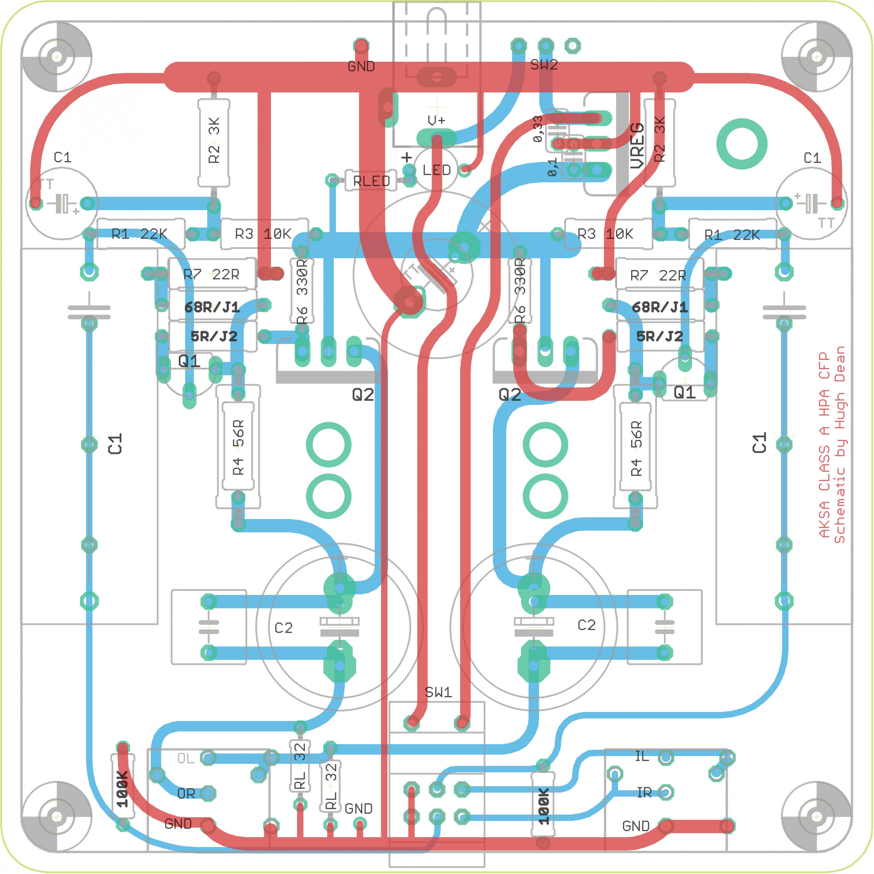

made a quick layout on an existing szekeres pcb i designed some time ago;
it has in/out jacks and a 7812 voltage reg. on board (86x86 mm)..
- both 56R and 22R resistors have options for paralleling..
- Q2 has options for TO-126 and TO-220 packages..
- there are space for 5R-68R-100K resistors for compatibility to BF862-2SA1837 version. 5R and 68R should be jumpered for the latest BC547/BD140 version.
thanks again.
regards,
Naim
