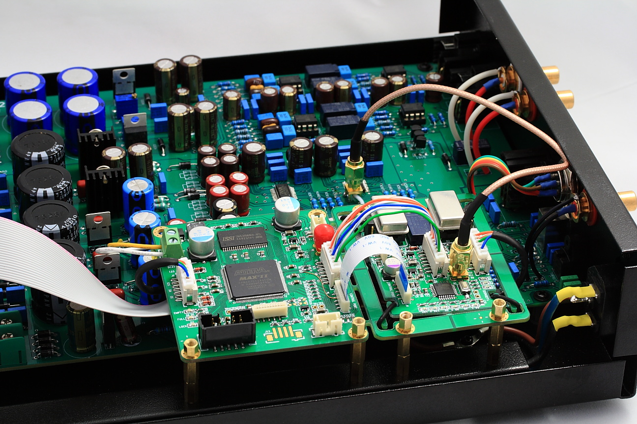

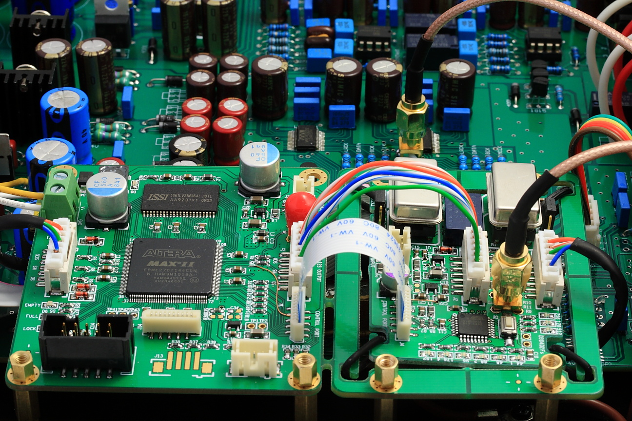

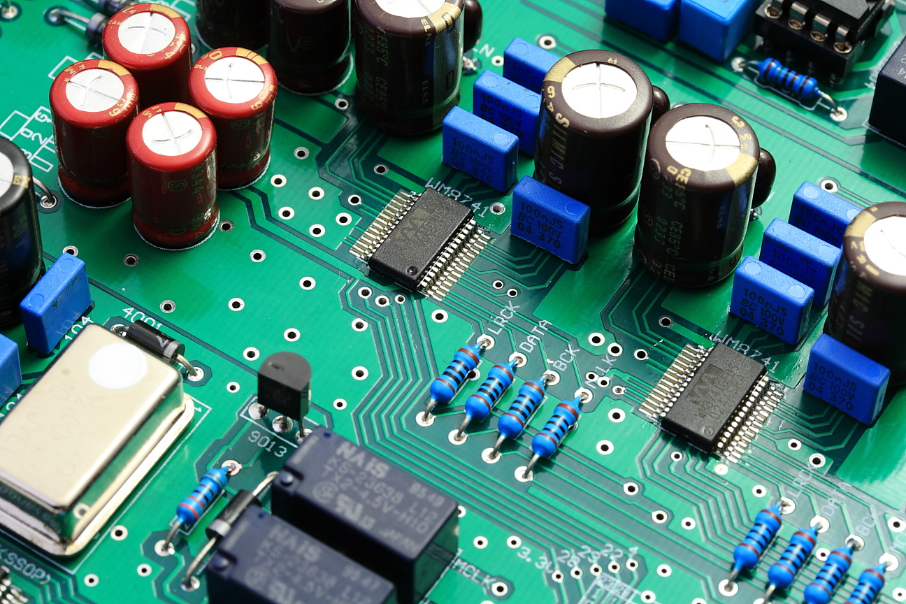

First mission: Modding the WM8741 DAC

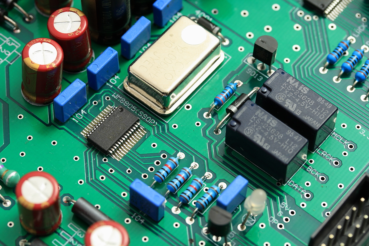

I have a WM8741 DAC. It has two WM8741 working in differential mono mode and a WM8805 DIR. I was full with expecting but got a bit disappointment on the clarity I don’t know why. I suspect it was the LPF design problem but I didn’t confirm. I am gonna mod it by my I2S FIFO now.
On board, there are two relays switching between internal and external I2S sources. Just disassemble them by a SMT soldering station and bridge the I2S signals by input and output cables linked to the FIFO. The MCLK goes separately by a 50 ohm coaxial cable. I make use of an on board 5V LDO power the FIFO. The FIFO board together with the frame of the clock board was fixed to the base by 4 screw standoffs. I attached the pictures. Things look pretty easy.
I ran it by a $3 oscillator just to confirm everything is OK. It sounds almost the same quality level as the WM8805 did. Not like my AD1955 DAC which sounds quite different with and without the FIFO. I think there might be two reasons: 1, the WM8805 has better jitter performance than DIR9001 and need the FIFO equipped with a bit better secondary clock to get improvement; 2, the WM8741 is not as sensitive as AD1955 to the MCLK jitter. However the clarity problem is still there, I believe it was analog problem and has nothing to do with the digital audio signals.
Anyway, I’ve already started collecting the oscillators other than $3 ones :D for the later on testing and evaluation. I’m gonna try different clocks the next steps.

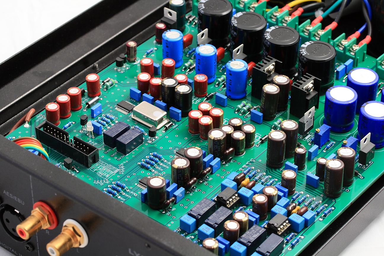

Hi Ian, I look at you pictures, DAC is very poorly designed (maybe by audiophiles:D)
what type?
nothing surprisely
8804 has 100Hz LPF corner frequency, 9001 - 10kHz (absolutely dont reject necessary input jitter), 8804 with external good generator has jitter <50ps RMS (find the time I measure exactly), 9001 - 50...60ps RMS. 9001 very poorly designed, very sensitivity to "glitches", dont work stable.
Approximately 50 times lower
this DAC is all complete problem)

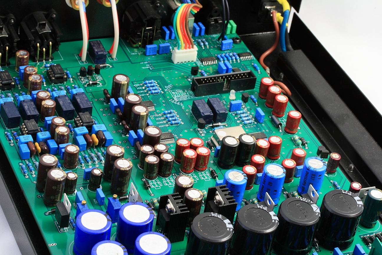

I also have this WM8741 DUAL DAC, too
I think there're some problem on LPF, If you see input point before Opamp you can jump these signal to external voltage gain and use them.
Too many different sound and more liquid if you use only 16BIT function. After I used >176.4KHz there'remany noise and error signal I don't knor why ?
Lyricxx Audxx ?
Anadigit
Thanks Anadigit, Yes we got the same toy. It seems the designer made a lot of effort, but he didn't get the right answer, as well as went through very careful test.
Thank you so much for those suggestions, I'll go through the LPF and the whole analog section this weekend to see if I could make it better.

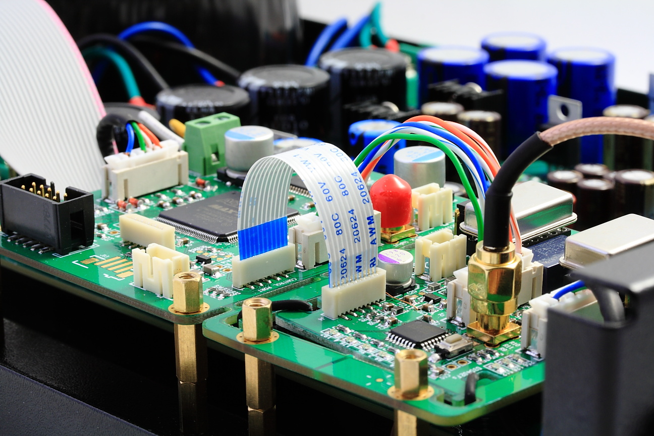

Start to design the second clock board: double XO clock board MK2
Thanks guys, you made a lot of good points. I did some consideration. Now I’m thinking about design a new double XO clock board MK2 to make some improvement
And the start up time and retrace of a crystal should be understood. A good oscillator actually takes a while to stabilize. usually the specs are not guaranteed until the oscillator has run for a period, like 24 hours. Some really take weeks or months before they have really settled. Switching oscillators on and off between tracks may really compromise their performance.
Very good point. This issue was confirmed in my test. For a same oscillator, running it for a longer time (says more than a hour) will make it sounds better than just power it up.
as you see for old LS series Phase jitter is only 0.12pS RMS:) but all this is very dependent from PSU noise (for CMOS devices especially)

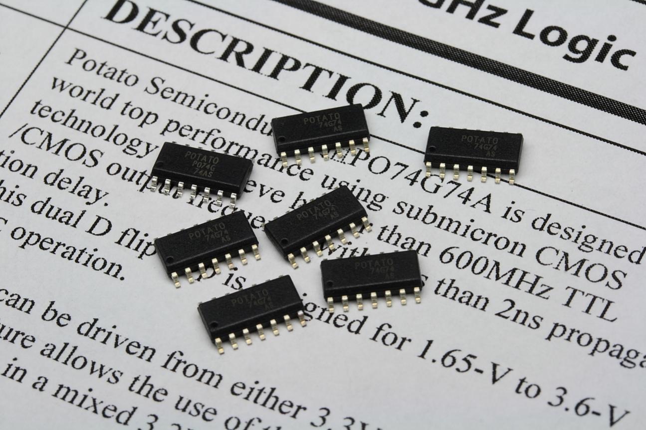

Here is a potential alternative for fast low noise SSI logic Potato Semiconductor / The GHz TTL/ CMOS IO Interface Logic/ Potato IC The stuff really works and meets the specs, probably better than the specs.
Although Nazar_lv mentioned that the flip-flop for I2S re-clocking introduces very small amount of jitter, but obviously the GHz flip-flop has much better performance and it 'really works'. I got some of them(PO74G74) last weekend. I'd like to try it to boost the I2S re-clock function. At least, the NOS DAC will benefit from it.
1) The clock switching based on input signal sample rate change should be instantaneous.
Good point again, I will do it.
3) Using a relay to switch between clocks may not be a good idea. For starters, it is not glitch-free.
I already took the relay glitch into account when I was design this clock board and it tested without any influence on the performance. But true, it's not glitch-free.

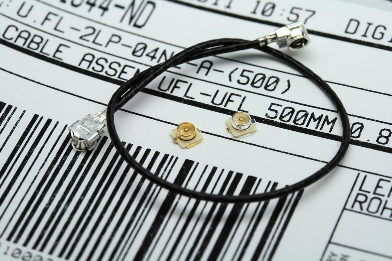

Hi Ian, very interesting indeed!! nice job on the pcb, what size micro coax are you using? ufl or wfl connectors? i ask, because all i2s inputs on my gear is using wfl
Very good recommendation. I found the SMA clock connector as well as the coaxial cable I'm using right now was too big and not very easy to hookup to the digital audio projects. The U.FL(3*3mm), which is widely used in many new RF applications, would be much more compact, and the matched coaxial cable is softer as well. Although the bandwidth is not as high as the SMA(up to 18GHz), but still more than enough in my applications. I got some samples of them and will be switched to this new RF connectors later on. The W.FL (2*2mm) seems too smaller for me. If you really need it, you can use some U.FL to W.FL jumpers.
Although two things I didn’t like to do when I was designing this double XO clock board:
1. Running two oscillators at same time;
2. Buffering the clock;
But it seems I have to make some compromise to make it more ‘audiophile’.
The new double XO clock board MK2 will have the following additional features:
1. Replacing the relay with low jitter dedicated clock distribution fan-out buffer to implement the frequency switching and to drive the clock coaxial cable;
2. Running the two oscillators all the time with low noise LDO and separated power EMI suppression filter;
3. Re-clocking the I2S signals with the low noise 600MHz PO74G74 flip-flop;
4. MCLK and three I2S signals will be connected by additional 6GHz U.FL RF connectors.
