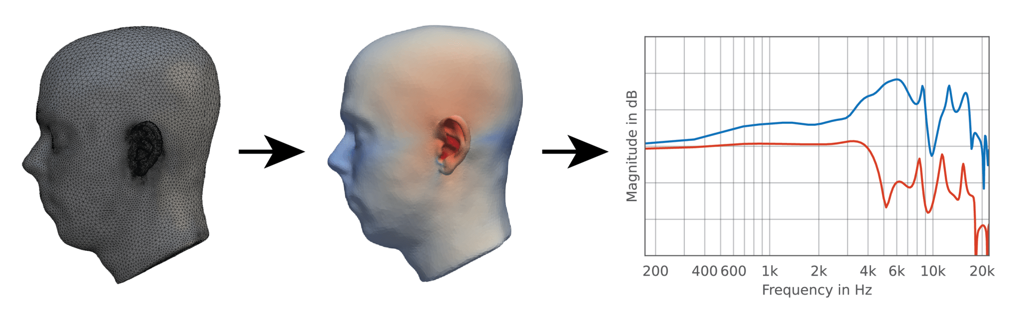

please alos consider this;
https://mesh2hrtf.org/
very fast multipole bem code by Berlin Technical University, inially designed fot hrtf with many elelements but als generally usuable and
"add-ons for Blender for geometry preprocessing and tools for Python and Matlab for post-processing and visualization purposes"
