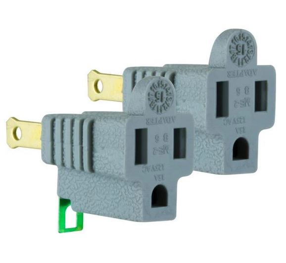

Many old houses in the USA only have two wire outlets & for those houses the third wire ground is completely useless.. The neutral (white wire) is somewhat referenced to ground. The black wire is definitely hot.
https://inspectapedia.com/electric/Electrical_Outlet_2-Wire_Connections.php

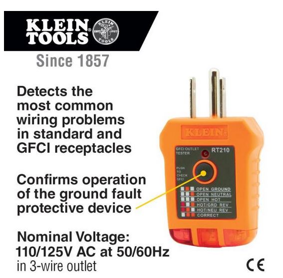

Unfortunately, most simple testers will not detect a potentially lethal mis-wire, the reverse polarity bootleg ground (RPBG).With a two wire to three wire adapter and a tester, one can check the wiring.
A bootleg ground is a wire jumper connected between the bonding screw terminal to the outlet's neutral connection. This practice is a NEC code violation, but a standard 3-lamp receptacle tester will report the outlet as correctly wired, often passing electrical inspections.
An RPBG has hot and neutral wires connected to the opposite terminals (reversed polarity) with the jumper or pigtail connection (bootleg ground) placing live voltage on all grounded parts of all equipment plugged into that outlet, thus allowing people to come into contact with a deadly voltage with a current path back that will not trip a normal circuit breaker, or a GFCI.
Further information on the RPBG can be found here:
Failures in Outlet Testing Exposed | EC&M
A non-contact voltage tester (NCVT) can be used to detect RPBG outlets.
